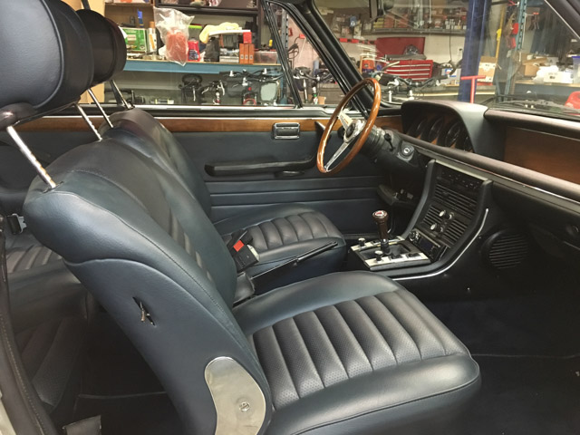

The armrests and the ashtrays are black (shouldn't they be blue?) The armrests are kind of hanging off the panel a bit. Haven't even tried to tighten up anything though. Could just be a loose bolt?
I would try tightening them up first. There are some screws visible on the underside of the armrest and one under the chrome caps up top. Early e24 armrests fit but they had a (rather nice looking IMO) chrome backing plate between the armrest and the door panel. I've assumed that the parts are identical but I suppose it's feasible that they are slightly off. Maybe that is what you area dealing with. I'm picking up a set of tan e24 arm rests to go with the map pockets that I mentioned, so I'll compare and contrast. I'd actually like to install those chrome backing plates on my car. I think they look sharp. I'm also snagging the aluminum strips from the door.

Also, I have quite a few blue arm rests and my target car will be black. If I have a decent pair perhaps we can trade. I also have the blue inserts for the ashtrays, and would much prefer black. If the chrome on your ashtrays is in good shape, I'd say swap the inserts. There are little tabs that hold them in place. Lastly, I need to hang onto mine but you are missing the little caps for the manual mirror adjusters.
I found the map pockets in a box that came with the car. Looks like someone tried another type of vinyl on them, so they don't match.
The vinyl panels are also just plain-Jane. The fish-scaley bit is missing off the top.

Ahh, I now see there was supposed to be the chrome trim between the vinyl seam on the sides.
There aren't a lot of people parting out seats so this one will be hard to find. I'll eventually turn two sets of fronts into one, but not for some time. I know that my aluminum strips are pretty thrashed on my project car. If you want to try something cheap and easy to replicate the look, consider using chrome edging trim. I haven't tried this myself but I was thinking about this as an option to make e24 seats look more like e9 seats.

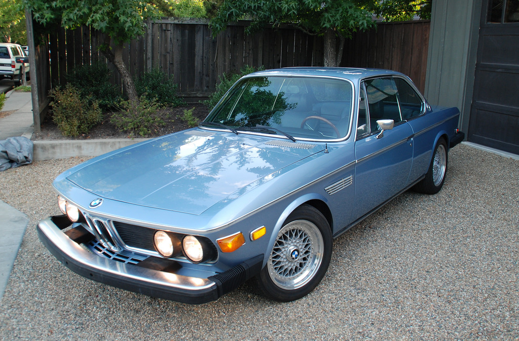

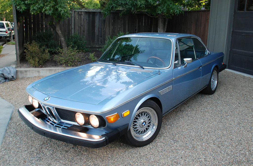

The ad:
Looks great doesn't it?!
Well that was at the car's peak in 2014. Wasn't used much since that picture, sat around and got flabby, or maybe I'm confusing what happened to me when we had kids...
It received the papal blessing from none other that sfdon, who said it had good potential. (Just like my grade school teachers would say when they were trying to be nice to my parents about my school performance.) Anyhoo, I didn't grow up to become a criminal, so Don's advice was well taken, and I purchased the car.
My son and I smuggled it across the border one weekend and I managed to get it licenced in BC with only a few hiccups, none that were insurmountable. The plan is to buff it up a bit and keep it going as a driver. Being born with all thumbs and living in the frozen tundra will limit what I can do, but ignorance is bliss.

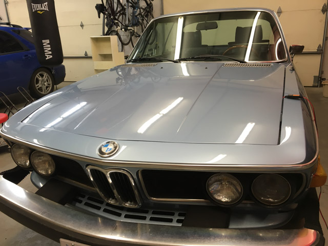

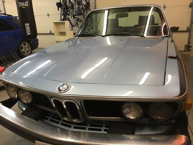

The car:
She has seen better times, but hopefully there will be many more to come. One bad eye, vinyl interior missing a few bits and '74 bumpers, but good structure.

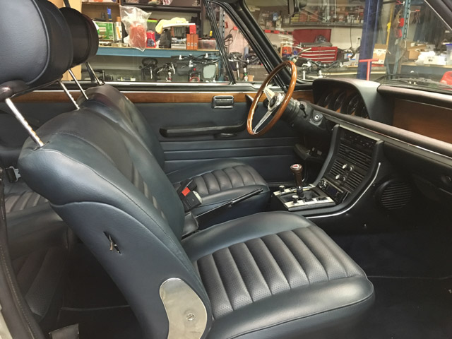

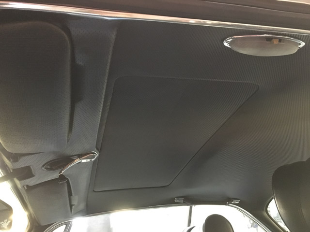

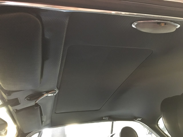

It has a dark blue headliner. Has anyone noticed that before? I've only seen white on other cars, but what do I know.
The previous owner was very practical. Did a great job re-upholstering everything, but chose vinyl.
Also chose map pocket delete, no door chrome strips and later model door arm rests. Oh well...

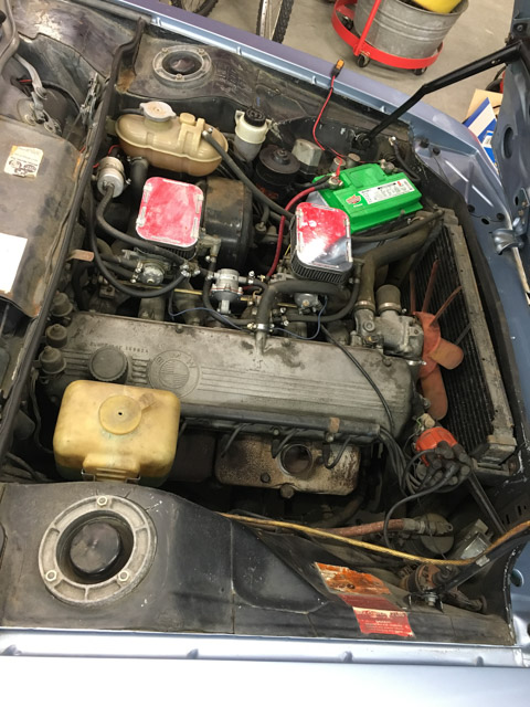

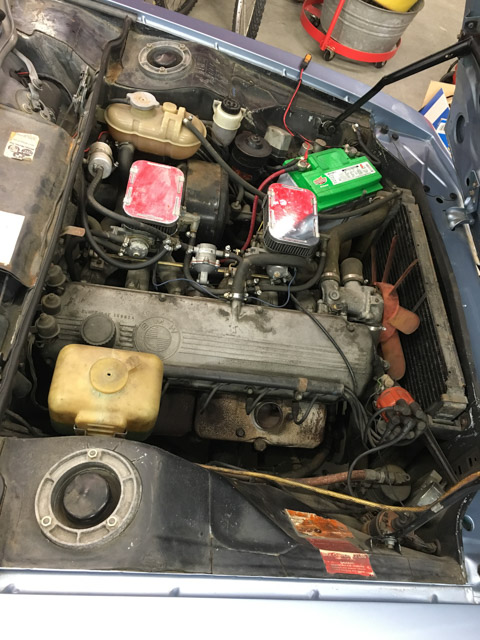

The engine bay is messy, but I hope that messy is something I can do!

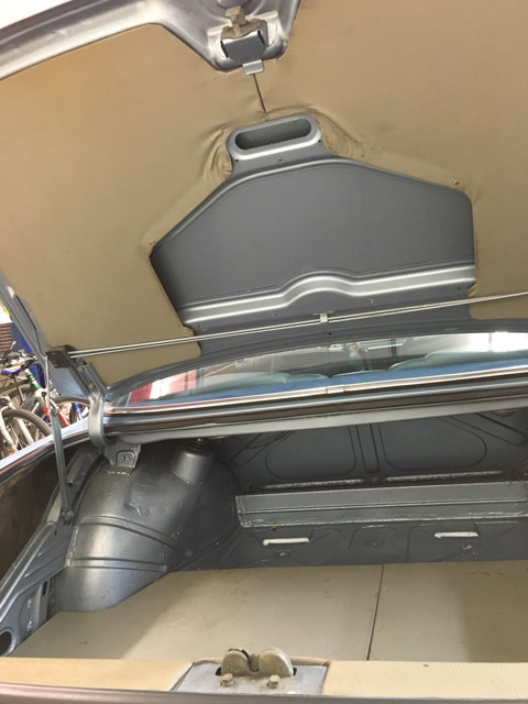

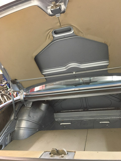

The trunk is also missing a few things, but the journey is part of the fun.

Nice looking car! Your stalling might be related to your brake booster. Does it stall when you are stationary in your driveway and you push the brake pedal?
Tested some theories with the stalling.
It's better with new gas.
The car does not stall when the brake is engaged while stationary.
Checking the state of the Webers will be a winter project.
I have a suggestion for the stalling: does the clutch release all the way? Might just be a matter of bleeding the clutch slave cylinder.
Also, you should have a one or two power-assisted stops still available after the engine quits, unless there is a vacuum leak that affects the power brake booster.

Yes the clutch seems to release all the way. I'll check on the clutch slave cylinder though. Thanks for the thought.
