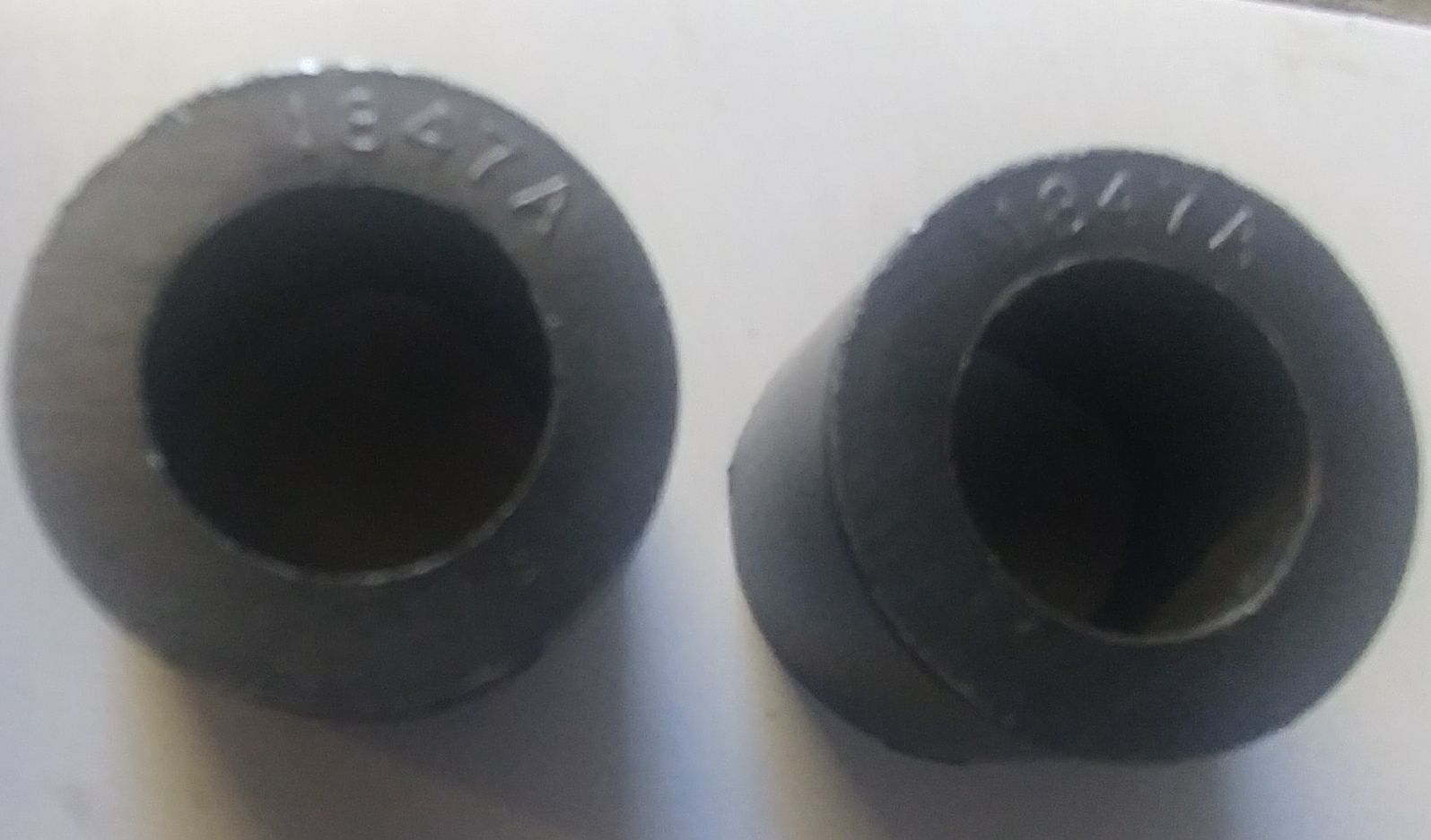

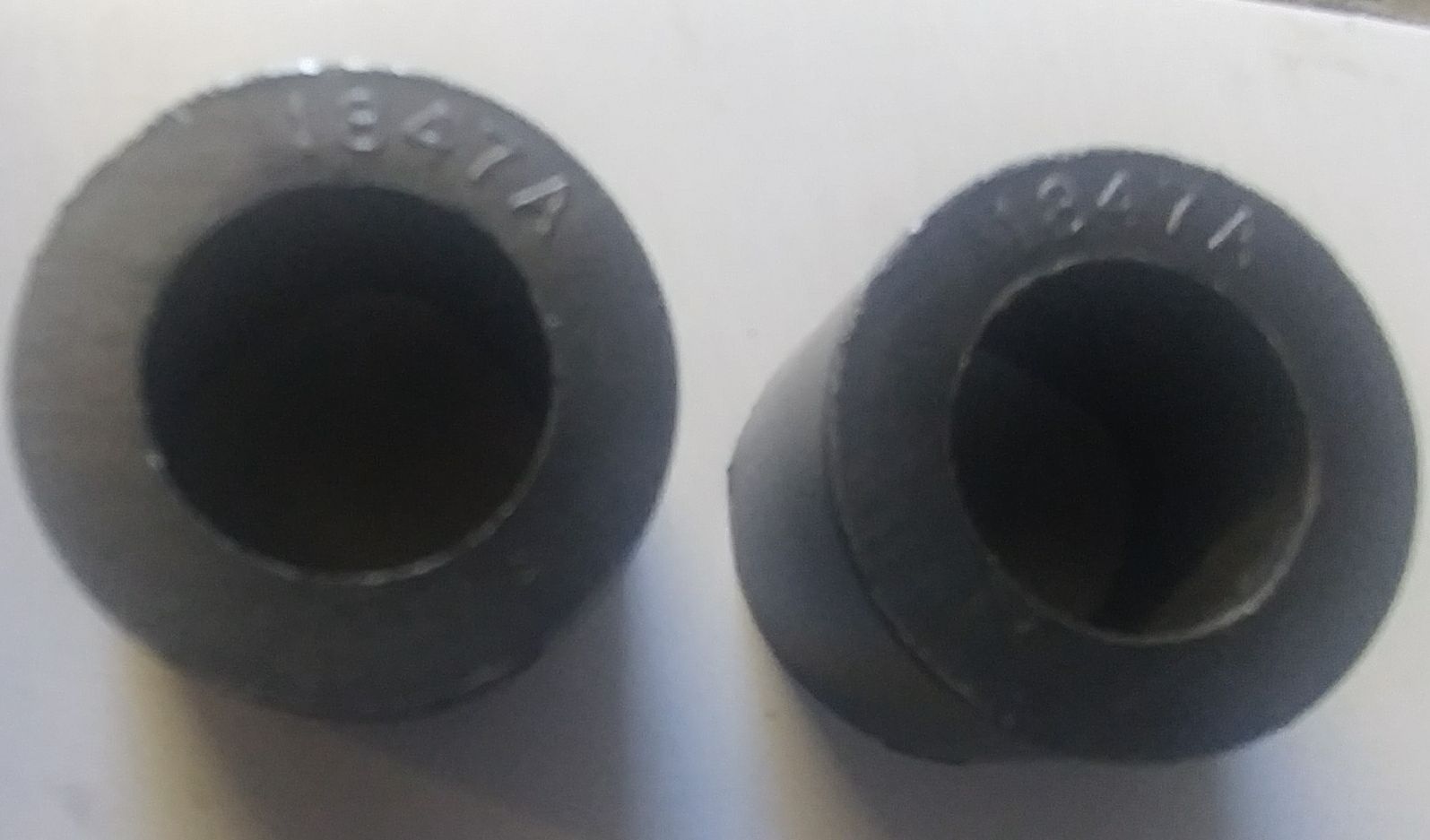

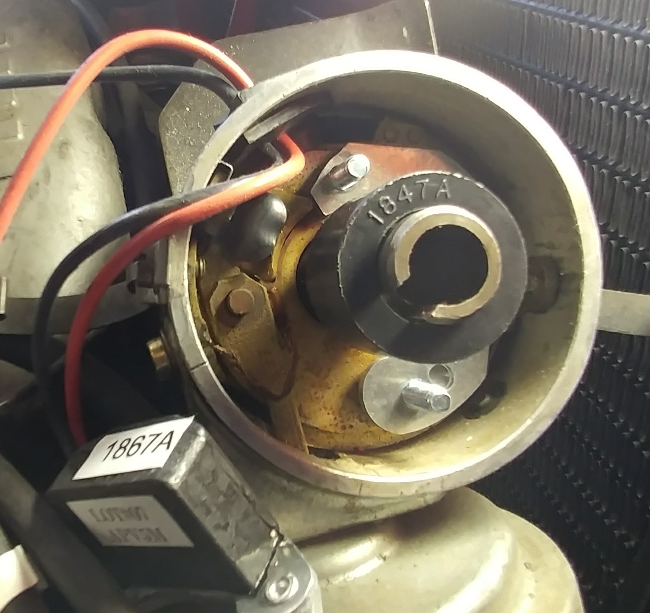

I ordered a 1867A and something not right.
That black plastic magnetic thing won't fit over the shaft. Maybe my dizzy needs some other model?
Funny how the box says 1867A, but that black plastic thing shows 1847A???
You guys who have ordered and used the 1867A...what does your magnet say?
Does it say 1867A or does it say 1847A like mine above (which is weird).
Kind of odd that the instructions that came in the box says "FOR PART NUMBER 1847V", yet the box shows "1867A"

I think the pats got mixed up w/this, which looks similar to the 1867A:
So I got a magnet sleeve for a 1847A, and instructions for a 1847V, and the actual ignitor piece w/the correct 1867a. Odd that my dizzy housing has a round hole for the wires, yet the grommet for the 1867A piece was square.
For sure the Pats got mixed up .......and we gave away Brady. Your parts got mixed up too. Sadly, quality control is not what it once was. Yes, you need to fit the square into the round hole in this case.
Man, this is ridiculous!
I ordered a 2nd 1867A kit to in hopes I'd get a diff magnet that fits.
Nope.
