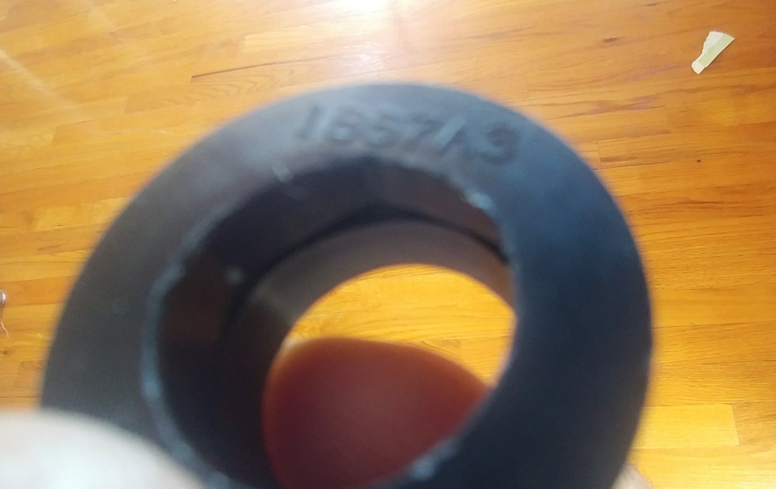

I ordered aa 1868 Pertronix Ignitor kit as per their catalogue and the ignitor ring spins on the distributor rotor shaft (way too big in diameter; it does though have the 6 points needed for a 6 cylinder distributor just not mine). Interesting the 1868 kit is suppose to fit mid-70s 6 cylinder BMWs, Ford and Mercury!

1867A for carbed cars, 1868 for injected cars

Well dang it. I bought the wrong kit. I'll order the proper kit 1867A online.
