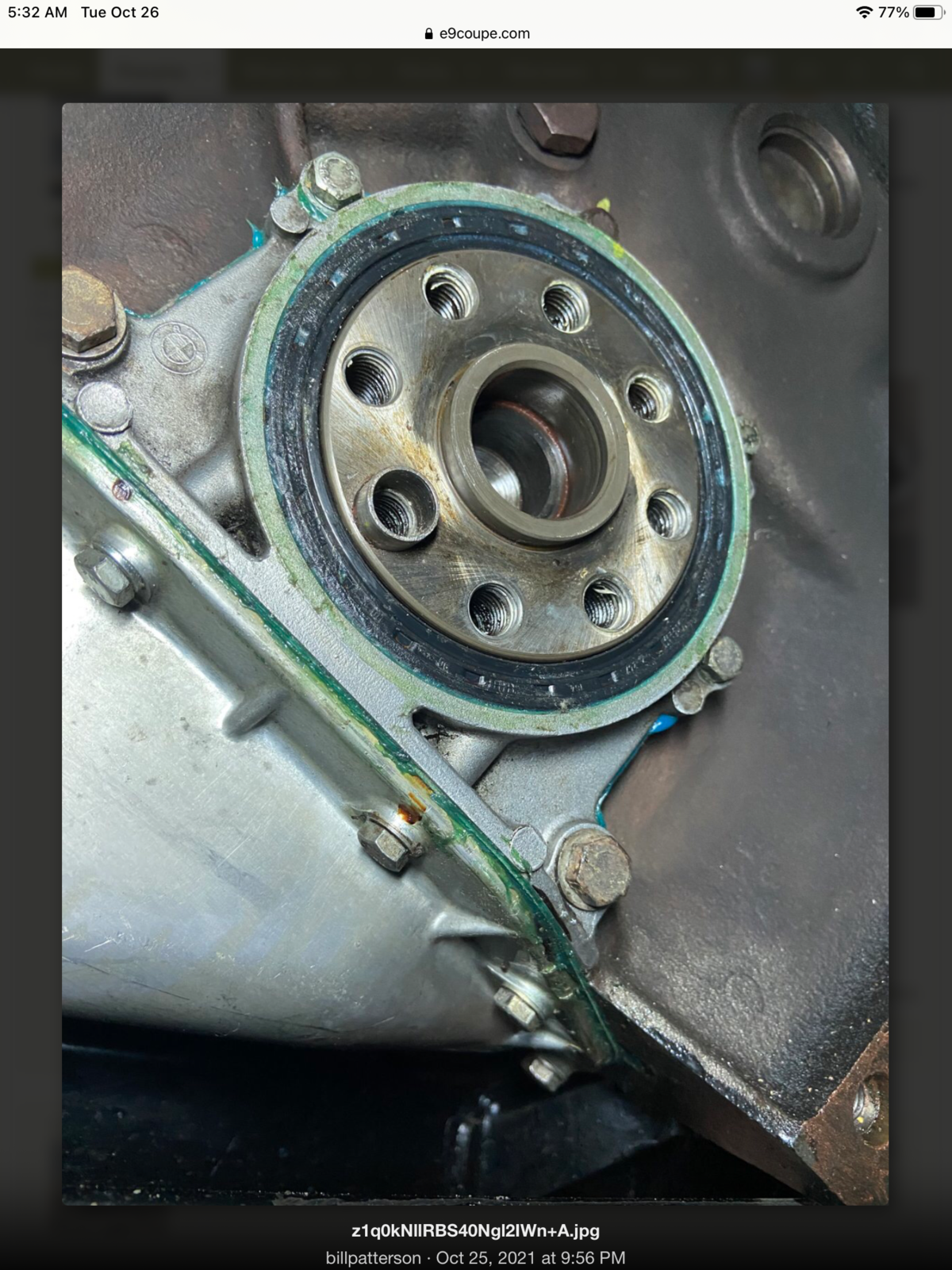

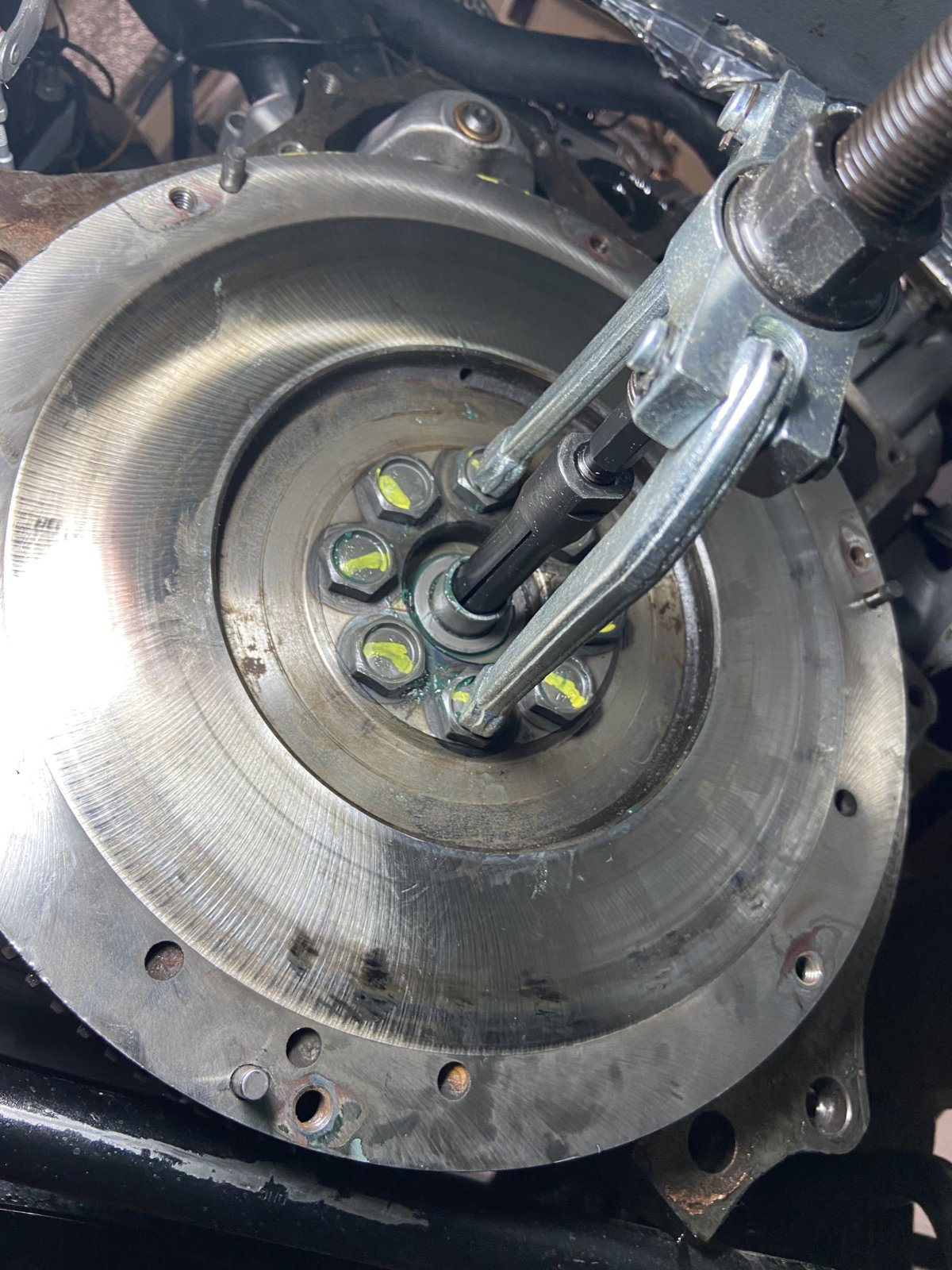

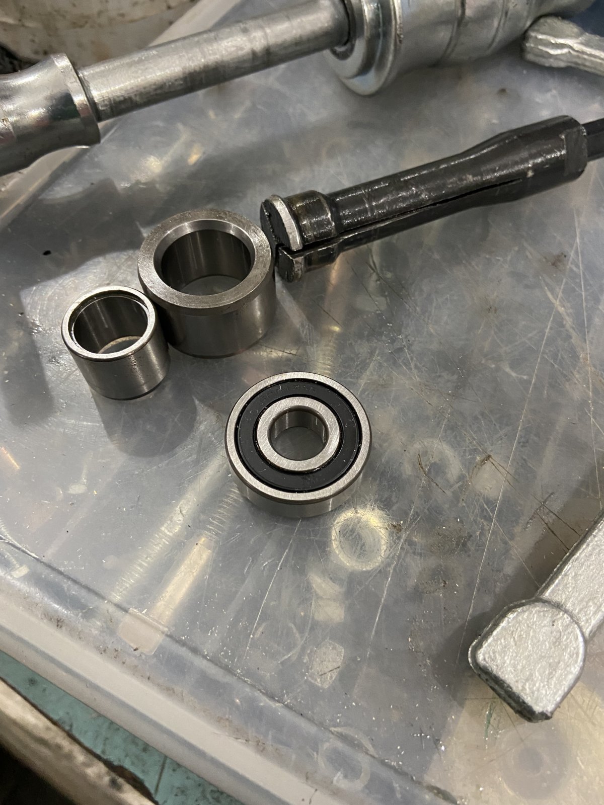

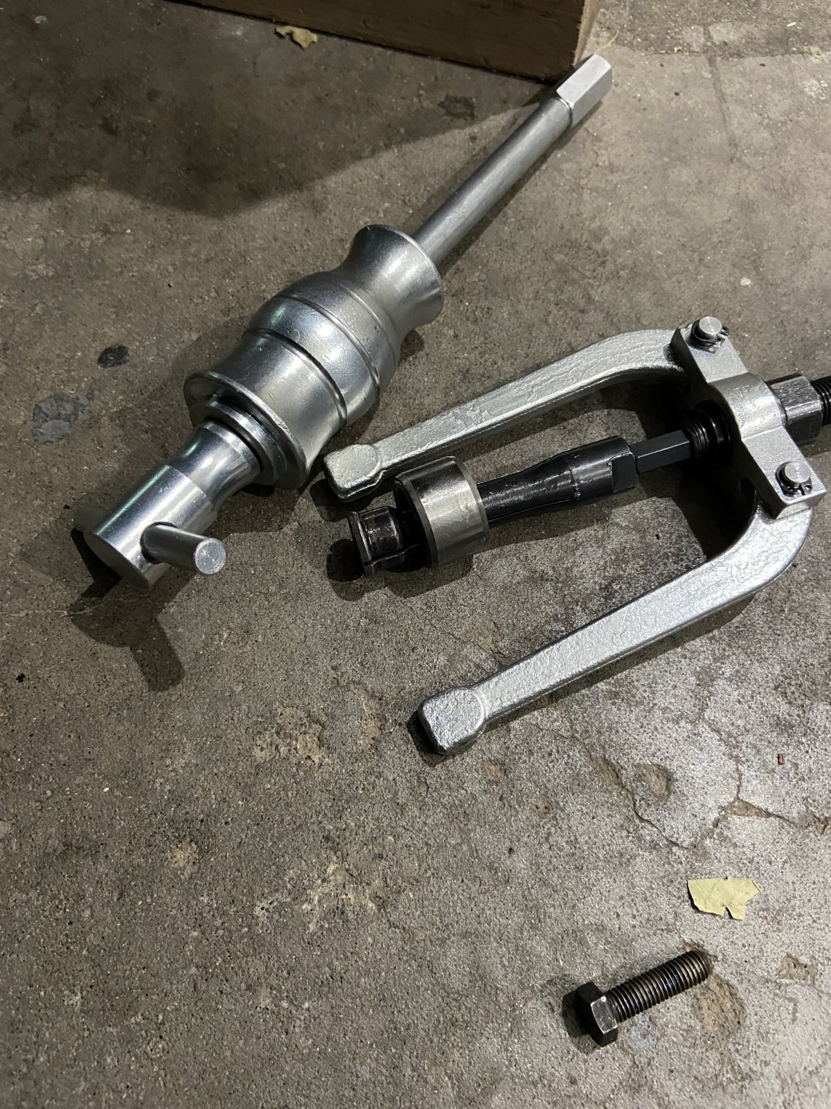

I have removed the blown needle bearing case and the sleeve it was seated in. It was a struggle with a poor quality blind puller but they're out and ready to reassemble with a sealed bearing...yeeeeehaaaaa :)

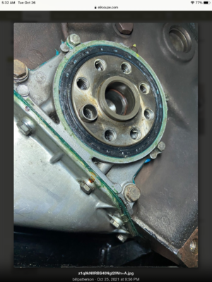

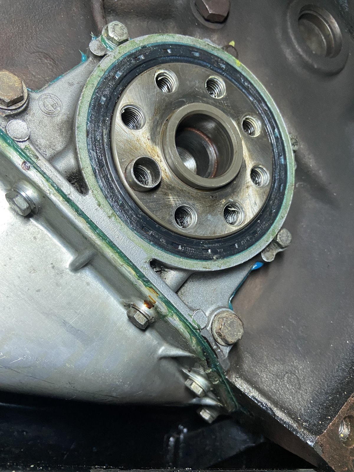

And now a perfect pic by you of the step in the crank that determines how deep the bearing can be installed.
