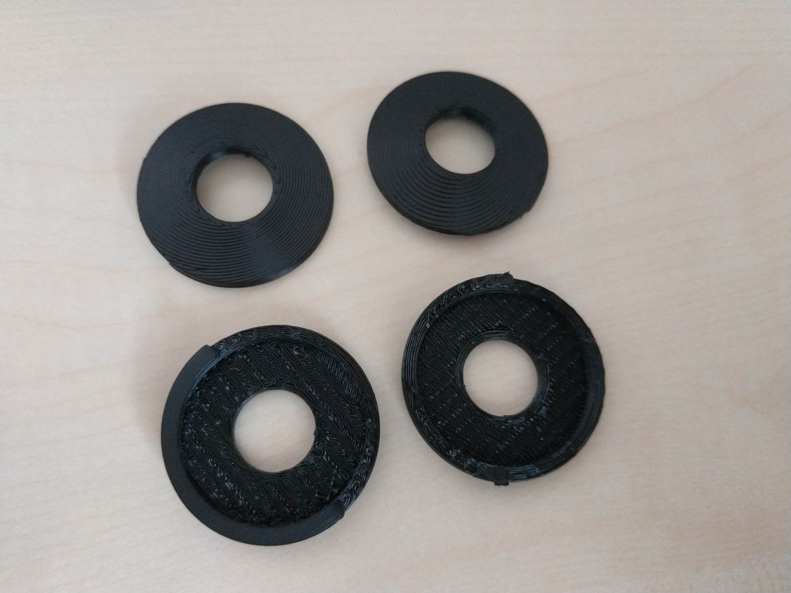

With great help of @deQuincey, first sample's batch of prototypes has been made and shipped back for comparison.
First impressions:
- FDM-prints (filament-based) require a lot of sanding to make item nice for painting due to the size of the part and due to non symmetric design of the part
- It is possible to keep part as is but it is not nice for us (nor @deQuincey, nor me).
- to catch proper shade of blue (in case of specific needs) but also other colors is tricky and might not be a business case at all so black should be the best way to move one with (as BMW OE)
- OE part hole diameter is far too big (no idea why) and would be nice to have it trimmed (to fit nicely). Question about tolerance of the door panel with the wooden trim.

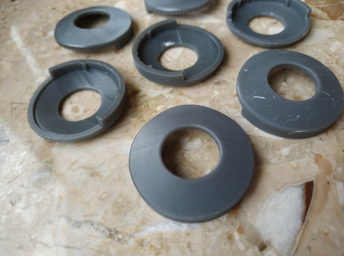

I will be ordering SLA samples to avoid difficult sanding. Might be they would require prepping and painting.

SLA parts would probably be in grayish or greenish colors and need surface preparation and paint. I could paint some black but all depends on potentially interested people from the forum.

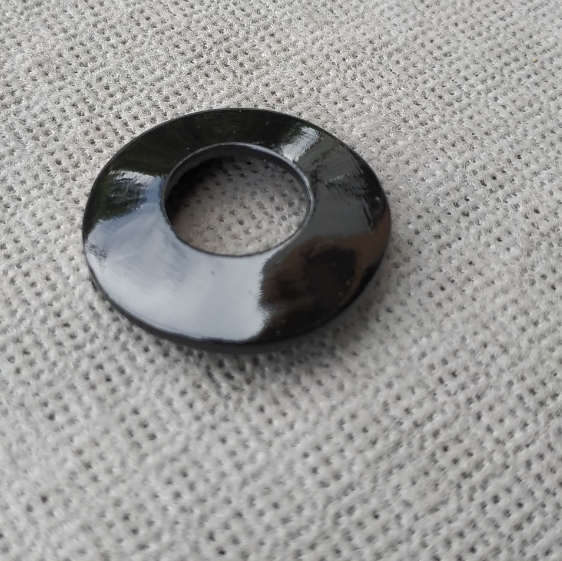

Update...
With Good People help I was able to make trial run with other 3D print
I will paint then in the next days to see the final effect.
Material can be darker (close to deep black) but I took what my Friend was at that time to make trial run.
For people sensitive to details, hand rework can be done of course to make it perfect.
If someone would like to receive as is I can ship at least one pair. Please drop me a PM.
Those look really nice Krys , especially compared to your first batch. What did you use to make them so smooth? That does not look like the typical output of a standard 3-D printer
Thank you Bo!
I have used different printing technology - SLA (laser-based resin hardening) in place of FDM (filament-based).
