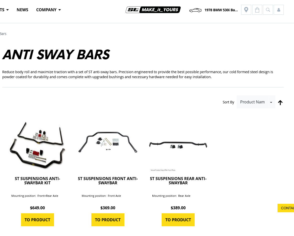

I did have an issue finding those ST sway bars, Carl no longer has a line on them from La Jolla (if I recall my last conversation with him on the subject). I still think that is the case but may have changed. Does anyone know who is selling those? I looked around and it was a dead end. If not, what are you guys running instead of ST? I want the full kit with new bushings, etc. like they used to come. It was a simple install. Sorry to hijack this thread, a little off topic.
you can still buy them from Suspension Techniques - as i remember we use the e12 bars. fronts - 50015 / rears - 51015 / full set - 52015

Scott, thanks for the ST link. I am going a little crazy because I know I would have looked on ST's site for these, maybe my key words using "E9" instead of "E12" didn't pop anything up. I forgot they are designed for the E12. Or is it possible they didn't sell direct to consumer a while back and why independent shops like Carl's used to offer them for sale? Now you can buy direct?
Anyhow, nice to know they are still available and I do remember adding the thicker front bar and rear did make a world of difference (to me at least). My guy is a good fabricator and welder but any measurements would help if someone is able to provide that for the rear tabs and exact location where to weld them on the subframe. I'm surprised BMW stopped using the rear bars in '74, wouldn't the car need to be corner balanced without them? Or still should be corner balanced after adding the rear bars? I remember a buddies CSL didn't have front or rear I don't think but it was nicely corner balanced. I could be wrong on not having a front one, but I know it didn't have a rear sway bar.

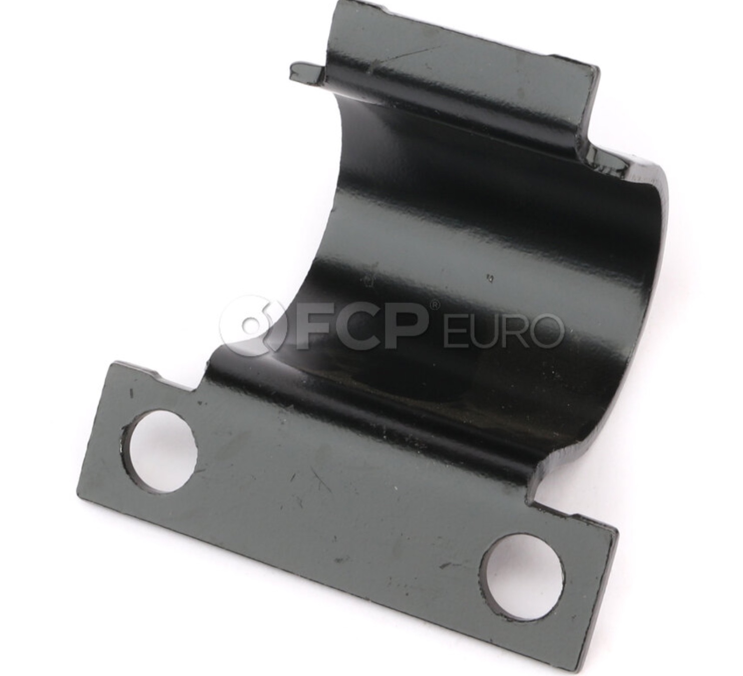

Couple questions and again, sorry for veering off topic a bit on this sale of the E9. But do you have a sketch or anything of the metal you fabbed to weld to the rear subframe to accommodate the rear bars? It looks like it just needs the two holes to mount bushings to the plate. The plate that D Calkins took a picture of, looks like about 1/4" thick metal and like 2"x2" with that lip on the inside? Maybe to help with welding it on or? I peeked under the car with a flashlight and don't see those tabs on my '74. I remember my Bav had the rear tabs and no sway bar, so that was an easy mount with the ST package.
There should be nothing to weld. Unless someone removed those tabs from your car they’re normally there from the factory wether the bar is there or not.
I used these brackets, new bushings and new Ireland Engineering end links. Everything bolted in place. Took maybe half an hour.

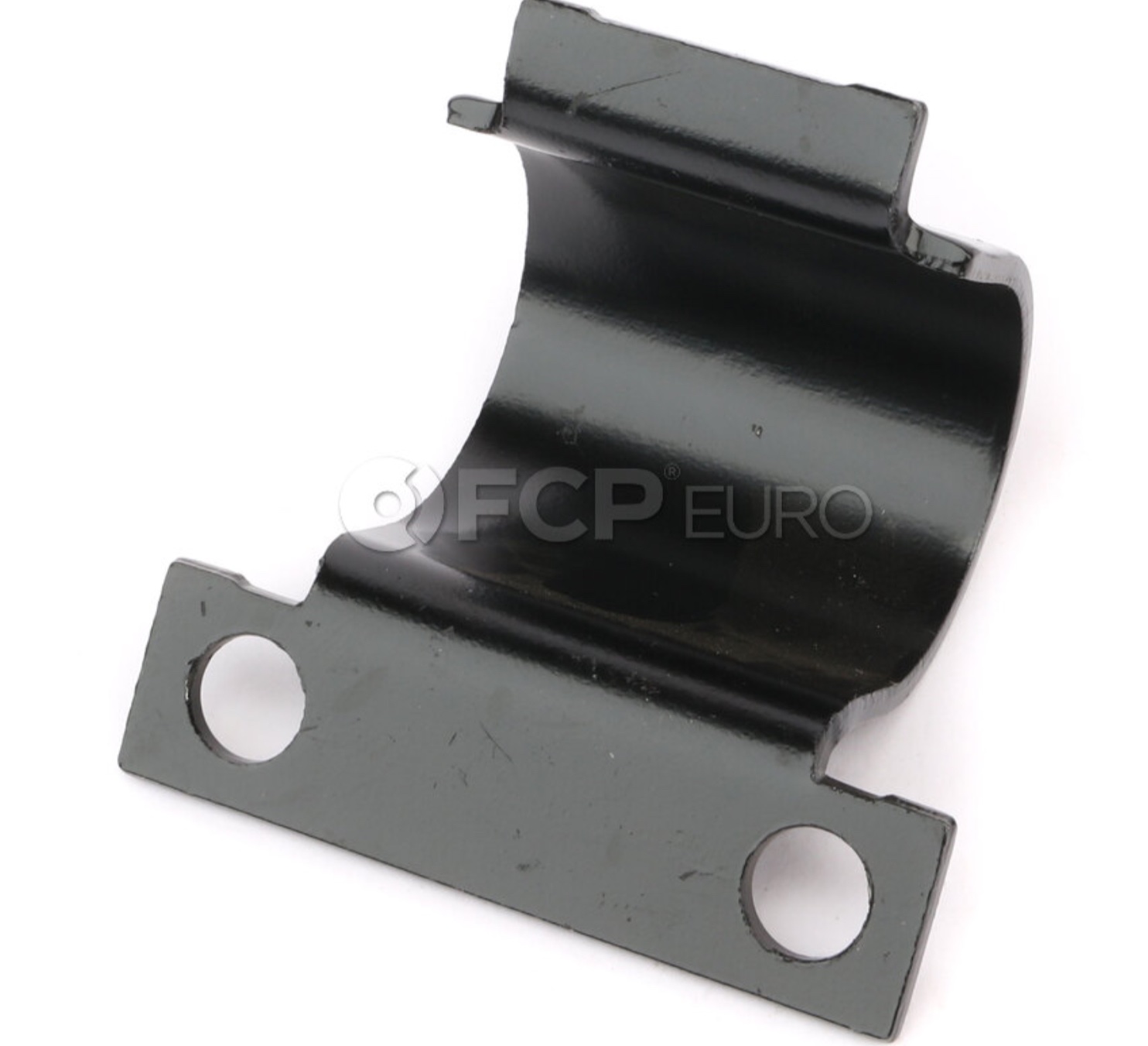

There we go, right on thanks. Peeking under the car but not jacking it up I don't see them. Going on lift next week, will poke around a little more. Anyone else with a '74 that doesn't have the tabs? Good to know they are available if not there, thank you!
