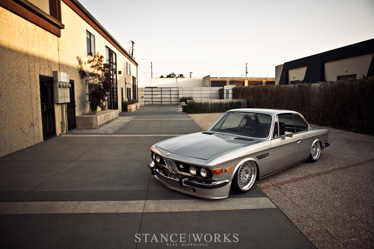

Christian Heine's car's BBS RS wheels are 17" per the Stanceworks article. Look in the picture just below the close up of the mirror. I happen to have a set of staggered style fives with near perfect faces, polished lips, new centers and new Continental rubber. PM me if you are interested.

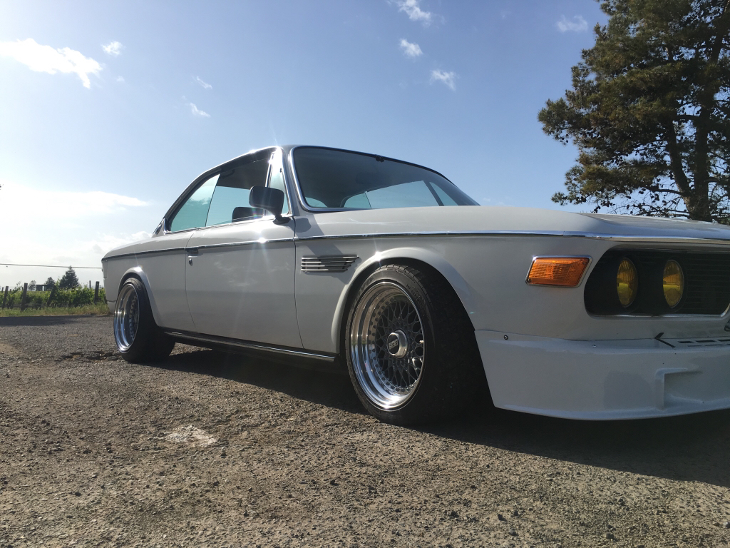

Here is my car with the 17" staggered style 5's :)
To overcome the concern with the rubbing up front, my tire sizes are 205 up front and 225 on the rear on the 8" and 9" rims respectively. The slight stretch ensures that they tuck under the fenders.
