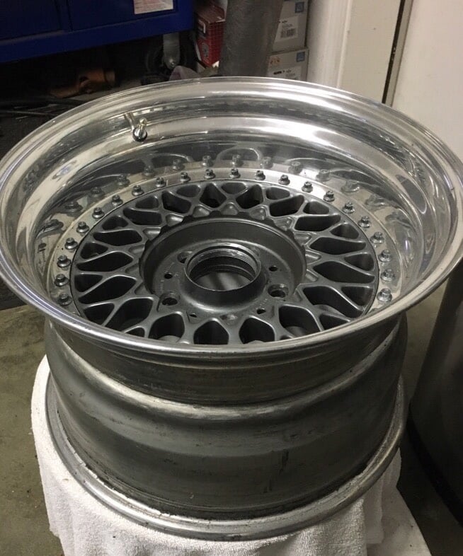

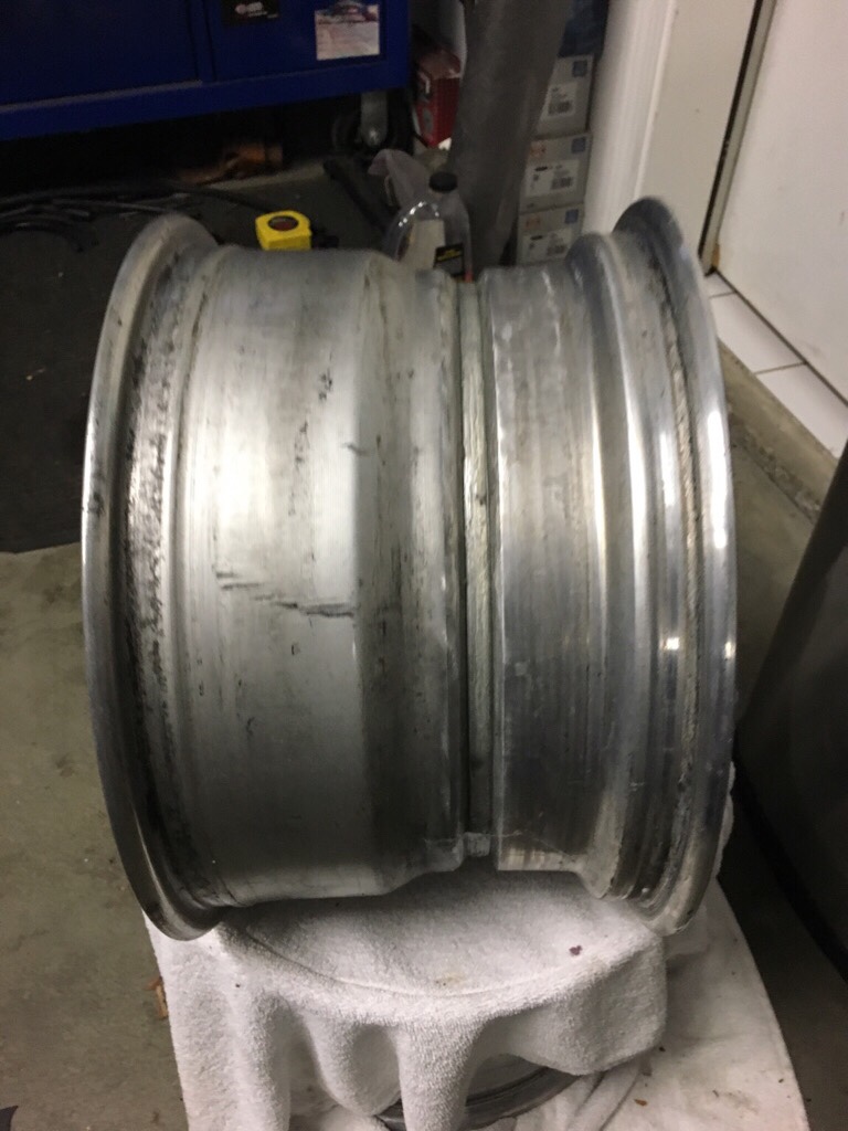

Oem 005 RSs / fronts
1 1/2" lip , face is 1/2" barrel 5" total 7"
Oem 006 RSs/ rear
1 1/2" lip face is 1/2" barrel 6" total 8"
I replaced the front lip with a 2 1/2" and the rear with a 3 1/2" ... 8" and 10" total
Toyo r1r tires 225/45 & 205/45
Remember you take the measurements from the inside of the lip not from the outer lip.

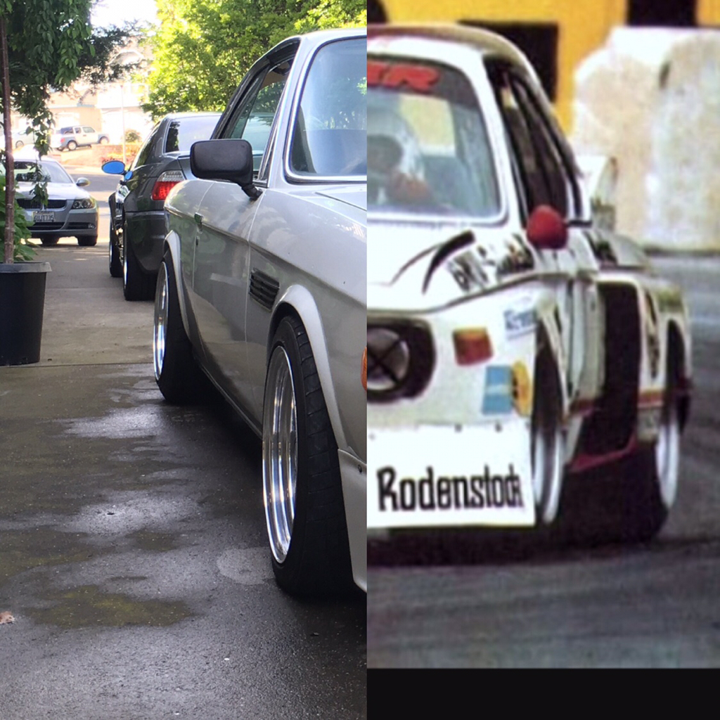

I don't know why i was thinking RS006 - 2" Lips. My mistake.
You must have SOME rubbing on the rear. 10" RIM???
Don't have to, because tires are stretched. Standard tires for 10" wheels should be 275mm (Barry have 225mm); 8" standard 235mm (Barry's 205mm)
Being low also helps with the camber...
Anyway, here is a site that shows the various size tires on various size wheels. Not everyone's cup of tea but you can have some moderate stretch without looking too crazy...
https://tyrestretch.com/list
Big 10"
No rubbing , when you hit a bump or dip the rears camber in and into the wheel well.
