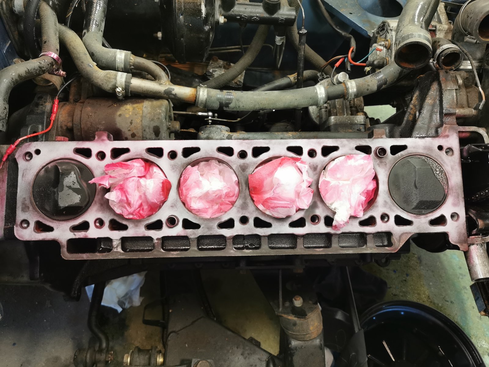

Checked the block with light and Crick 120 crack detector. Found nothing.

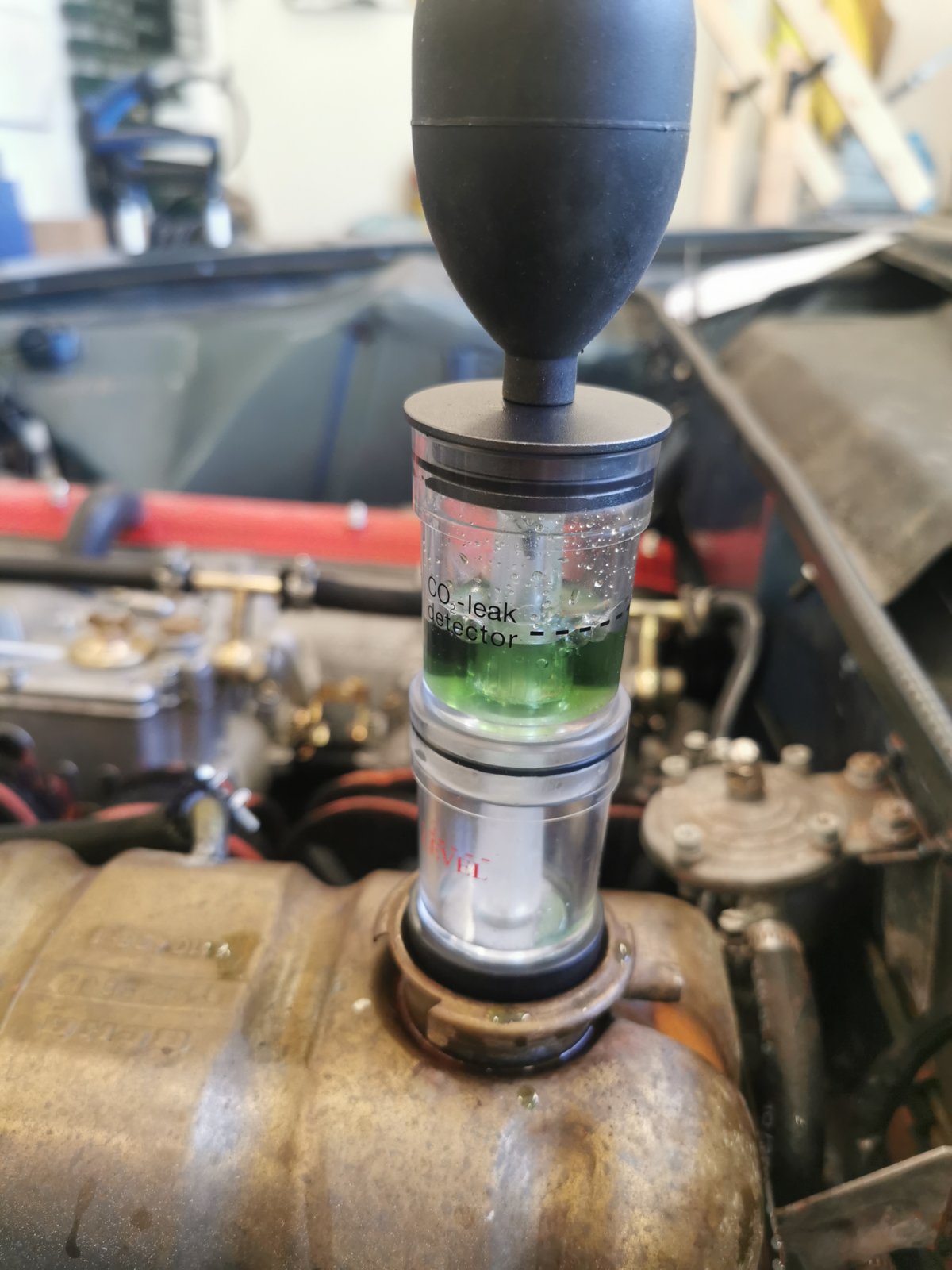

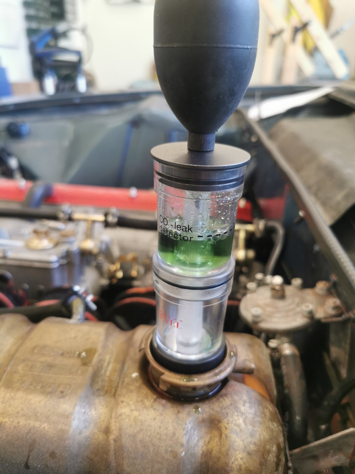

My exhaust coolant tester turns green though. Dont know what to make of it?

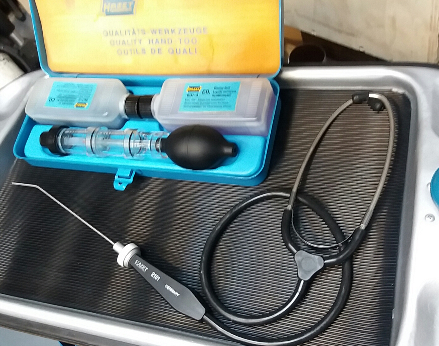

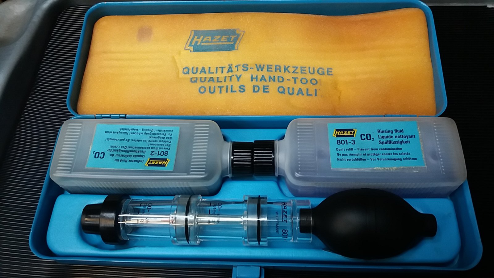

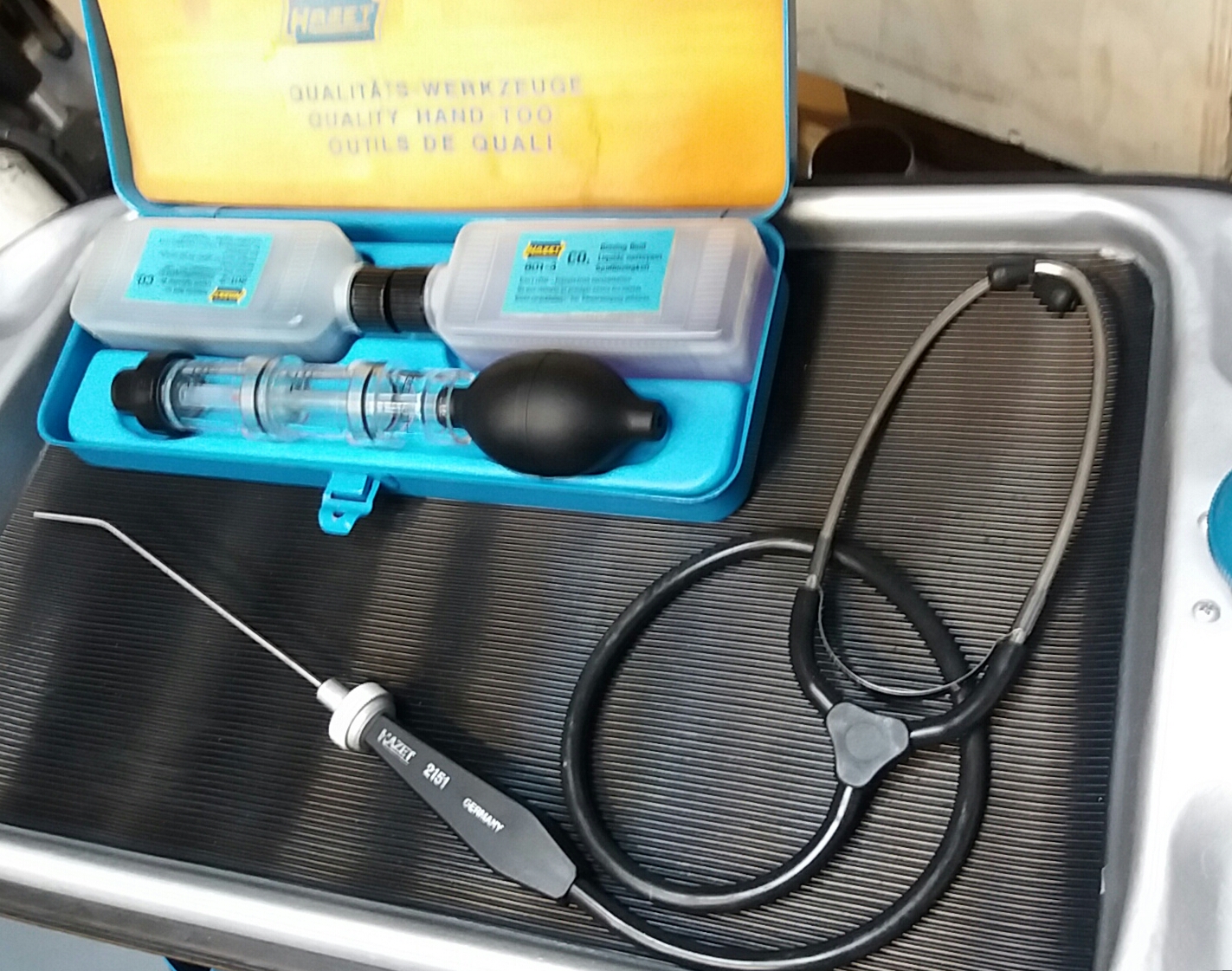

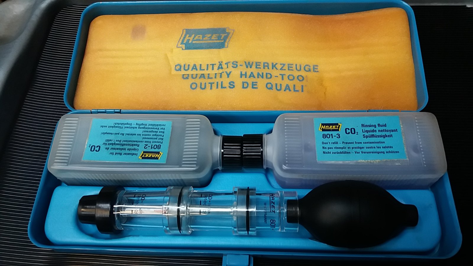

love that tester,
have you read the instructions very carefully ?
i recall it was a bit complex,
i.e., your reservoir overspill hose is not closed, may be it will have some relevance?

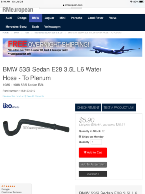

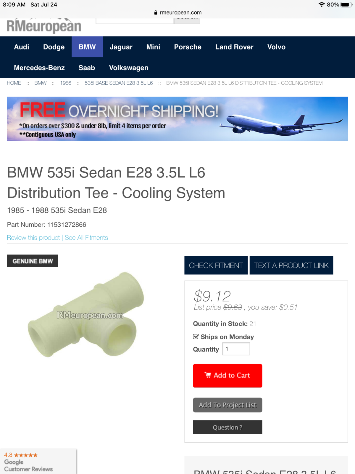

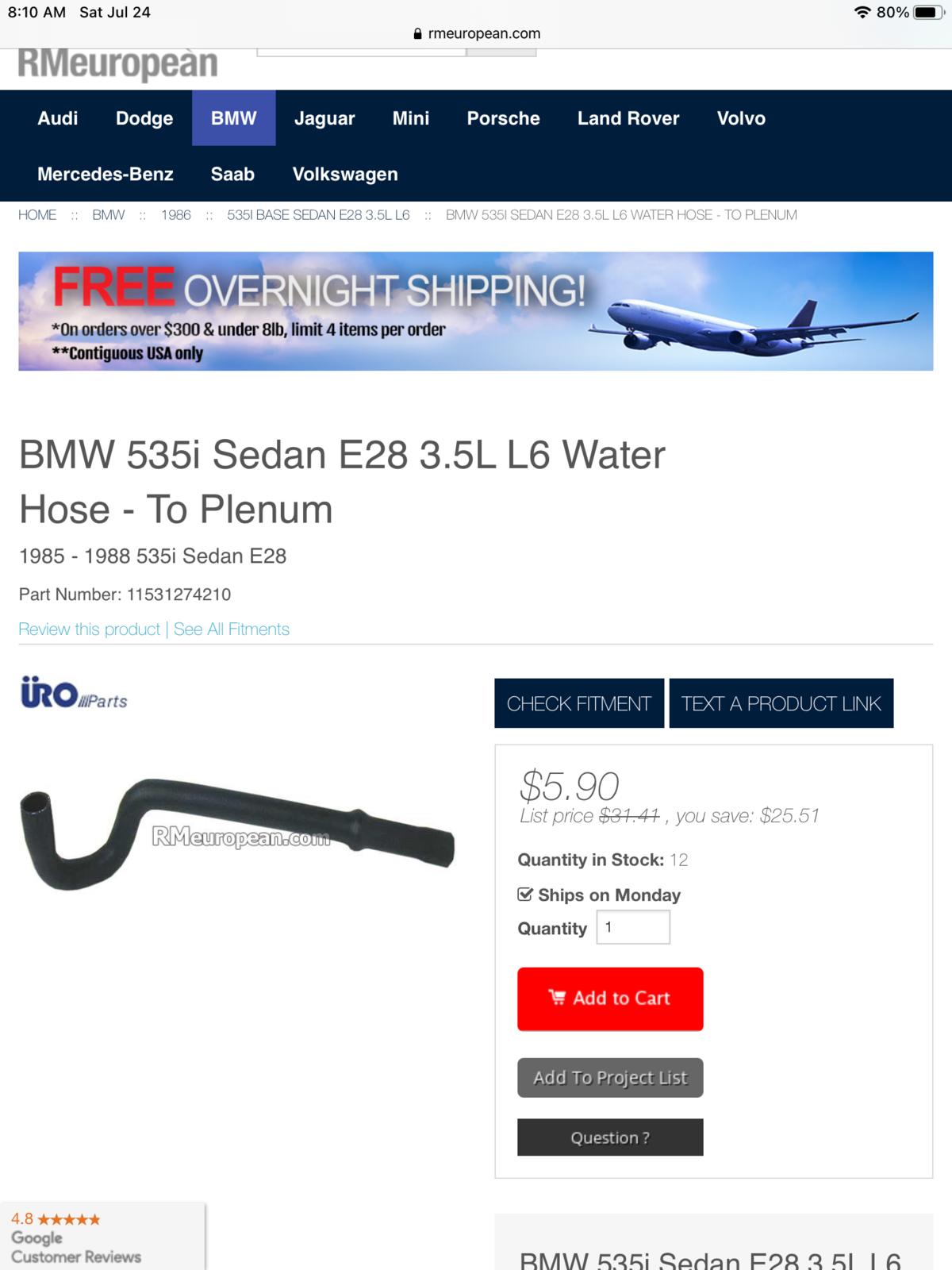

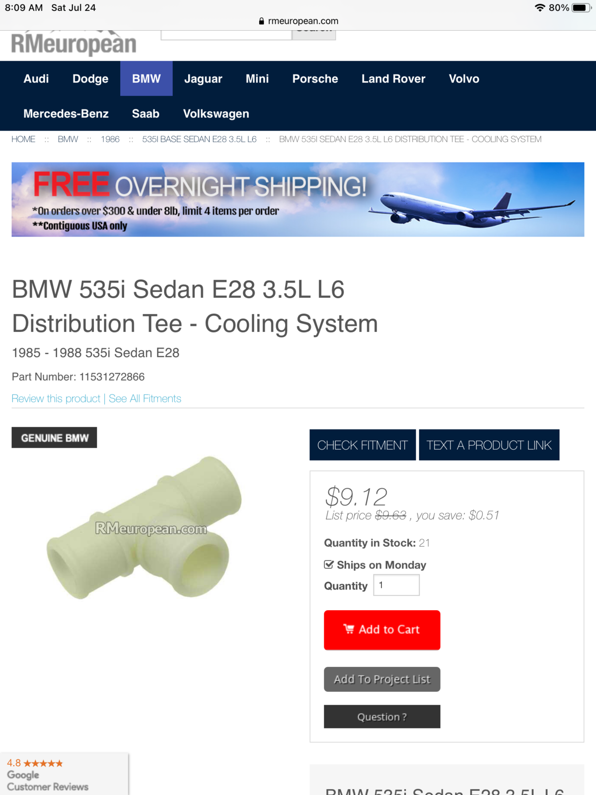

also- less than 20 bucks will fix that cooling hose setup.

Hmm, the bottom cup is not supposed to be filled on my tester, if I understand my manual correctly. It leaves a lot to ask. Perhaps that can affect the result Also? Attaching a hose to the overspill and leading it away from the car actually improved the result a bit.

Are bubbles good or bad?
bubbles are required, in essence you are suctioning the air from the reservoir, if that air contains an excess of co, the blue fluid, aka listerine turns to green,
the first portion is control, the second is the test
if the first turns green not problem, the second is the key
you need both cups with fluid to the level in my setup
