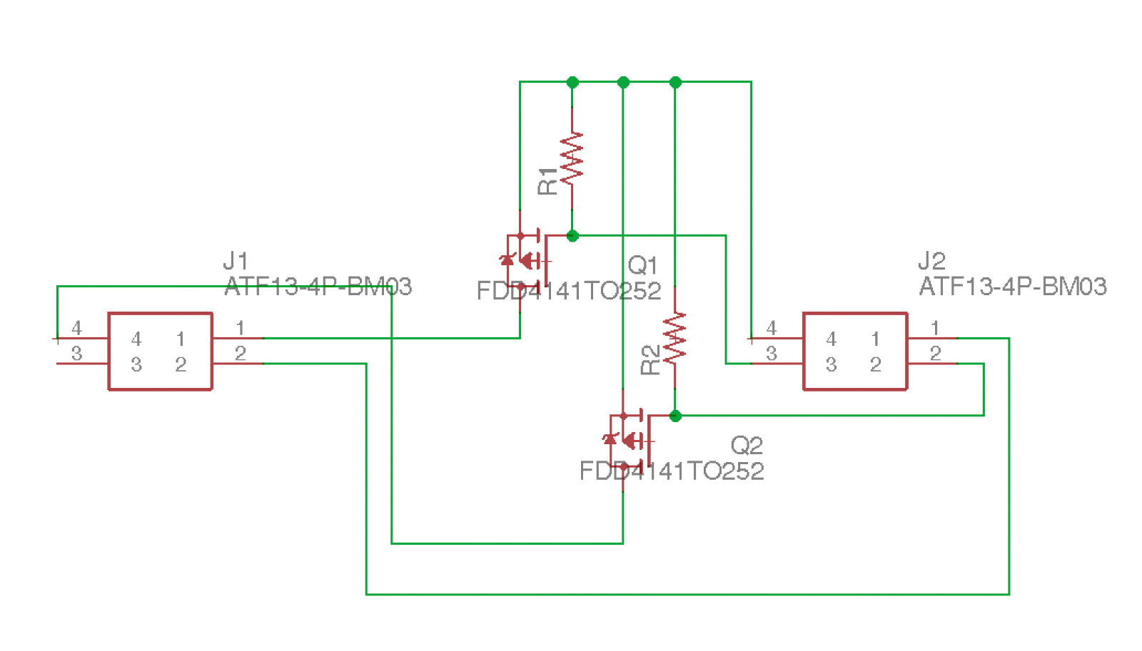

I have been noodling on various alternatives to this approach. The first is to use power MOSFET transistors instead of relays. This is much simpler and more compact, because the transistors are small, and simpler to control than a relay. Conceptually the approach is the same, but this approach results in a smaller assembly that is easier to mount inside the door. the other advantage is that the window switches use "negative logic" which means they simply ground the control wire, so there is no need to battery power to the switches at all. Here is a circuit diagram for this:

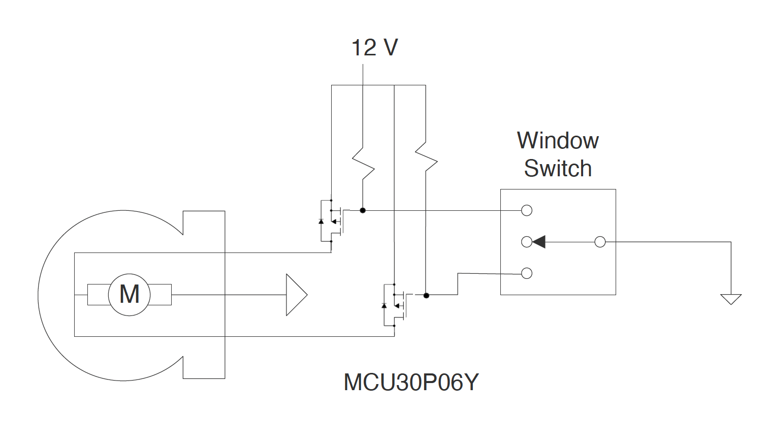

I have also been wondering how difficult it might be to substantially improve this system by inserting a small microprocessor into the mix. There are literally thousands of micros that can be used. By far the simplest and cheapest is one of the Microchip PIC family. These small (14-20 pin DIP packaged) devices can include A/D converters, serial ports, and many other features. Programming them, while fun, is a bit of a chore, but the program only needs to be developed once.. Using this scheme with the MOSFET circuit above, it is possible to apply the window switch signals to the PIC, apply some software logic to them, and then control the MOSFET motor control transistors. This opens the door for a full suite of window control features that we all take for granted in modern cars:
Auto up
Auto Down
Anti Pinch
Auto stop (top and bottom)
Auto up/down cancel
etc...

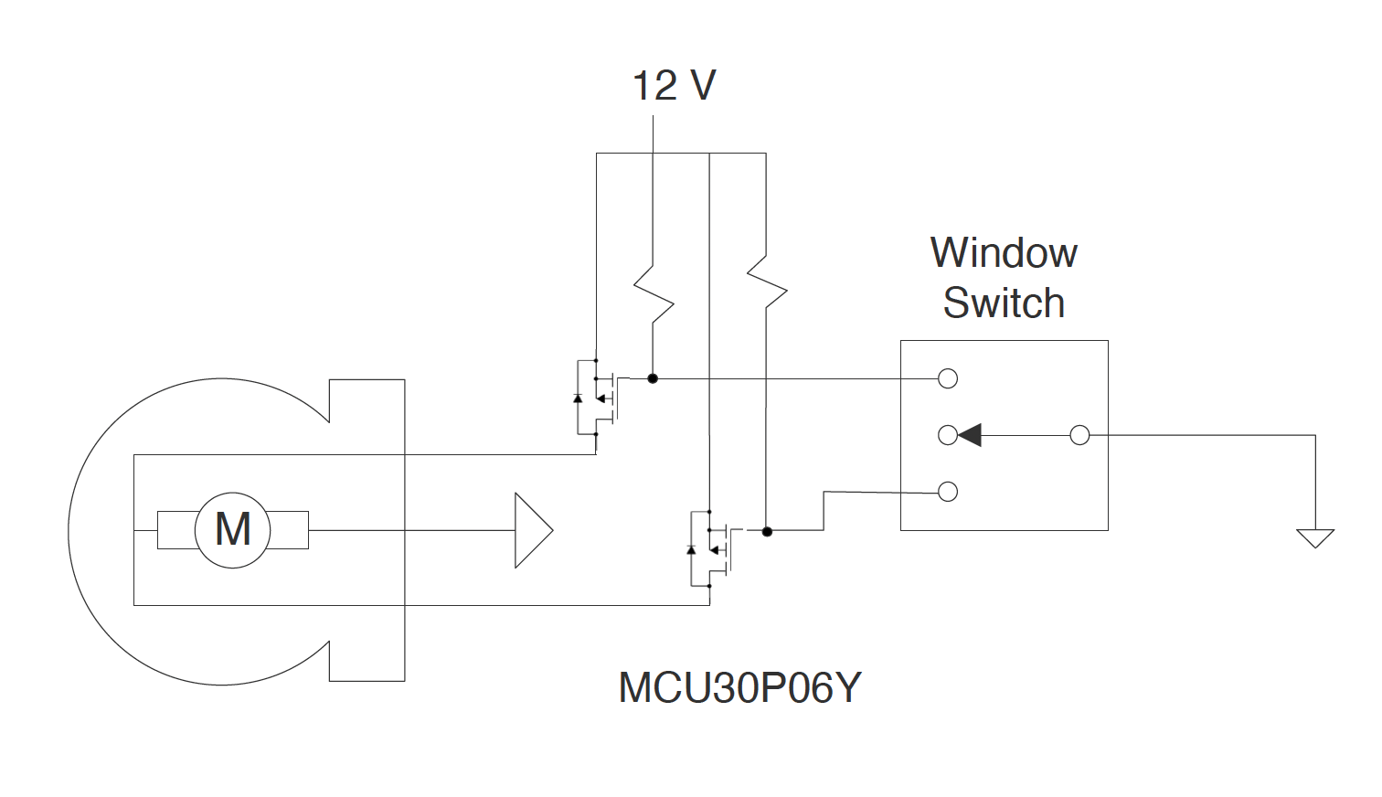

Here is a notional diagram of this:
The ACS chips are current sensors.

I am about to disassemble mine, so I'll try to get a simple MOSFET prototype together in the next few weeks. Not so sure I want to go a s far as a full "auto-up/down" setup, but it seems like a small relay replacement module that attached to the motor would be a welcome improvement! If it works, I'll send you a set!

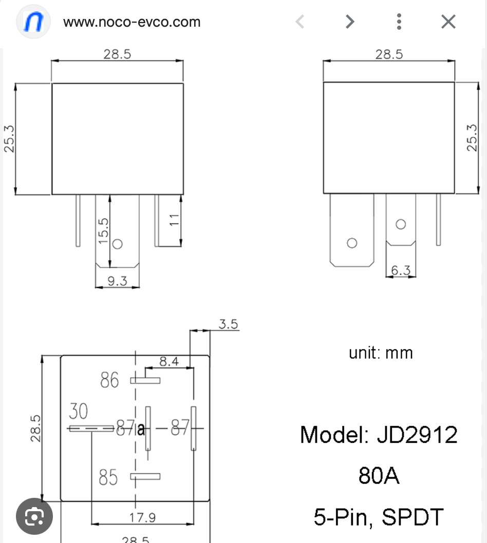

Here is a size comparison. Seems much more reasonable to locate in the door than relays:

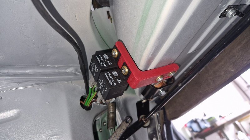

Regarding your doubts against installing relays inside the door you may consider to install them near the A-column like on this pic courtesy of Uli Venhorst from our german forum.

There is no question that a MOSFET would be smaller than a conventional relay. But honestly, the availability of volume inside the door and rear window areas of an e9 is not an issue. It's pretty easy to package a couple of normal-sized relays into those spaces. Micro relays, as Socrates recommends in post #7, would be even easier (as long as they can handle the motors' current draw).
Admittedly if you want to add power window functions controlled by a microprocessor, MOSFETs would be easier to interface with the controller.

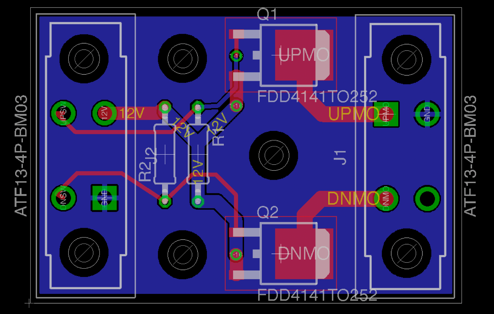

So here is a MOSFET based relay replacement for one window. This board measures 1.25 " x 1.85" (32mm x 47 mm). It is designed to use two 4-pin Amphenol sealed automotive connectors (one for the switch side and one for the motor side). My plan is to use some clip-on TO250 heat sinks that I may epoxy in place to assure they don't come loose. I'll probably also conformal coat the board. The two pairs of outer holes are for screws that attach the connectors, and the three inner holes will be for mounting using small standoffs.
