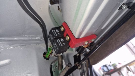

Regarding your doubts against installing relays inside the door you may consider to install them near the A-column like on this pic courtesy of Uli Venhorst from our german forum.

There is no question that a MOSFET would be smaller than a conventional relay. But honestly, the availability of volume inside the door and rear window areas of an e9 is not an issue. It's pretty easy to package a couple of normal-sized relays into those spaces. Micro relays, as Socrates recommends in post #7, would be even easier (as long as they can handle the motors' current draw).
Admittedly if you want to add power window functions controlled by a microprocessor, MOSFETs would be easier to interface with the controller.
