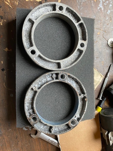

I noticed that my front end is a bit higher than the rear end in discussion with a couple forum members it is clear that there is an aluminum spacer 31331113721 on each side to meet the FMVSS bumper height requirements. It was recommended to remove this which would level front to rear. It looks very straight forward just remove the three nuts and jack the front end to lower the strut assy.
Are there pros and cons to removing this?

These are 20 mm thick as installed the top of the strut was level with the shock tower once removed the black rubber strut sits proud of the shock tower hole by about 20 mm. My front end measures a good inch lower and I don't have the feeling the front end is higher than the rear. As advertised it is a very simple process to remove. Thanks all for the advice!
