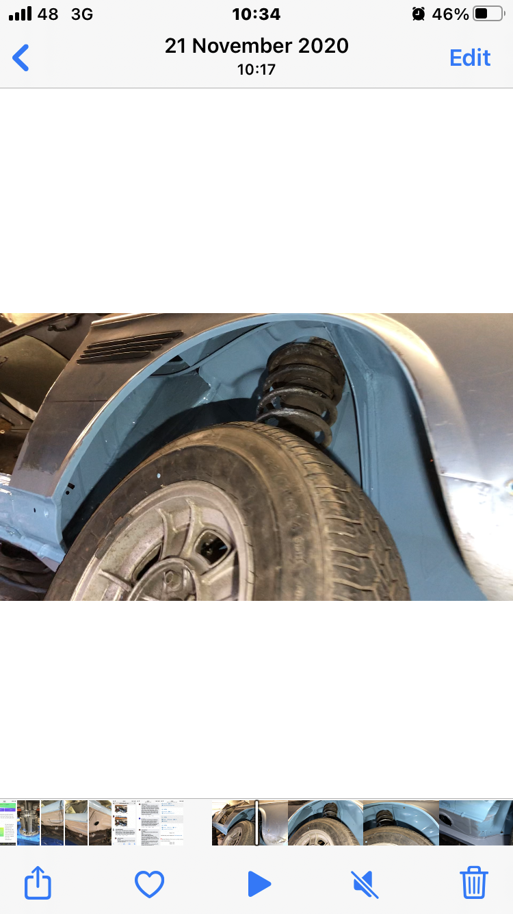

I am wondering if anyone has had any wheels rubbing on the wings / fenders when the spacers have been removed.
I would think the standard wheels are probably fine , but if you were running maybe 16” wheels would you be too close then ???

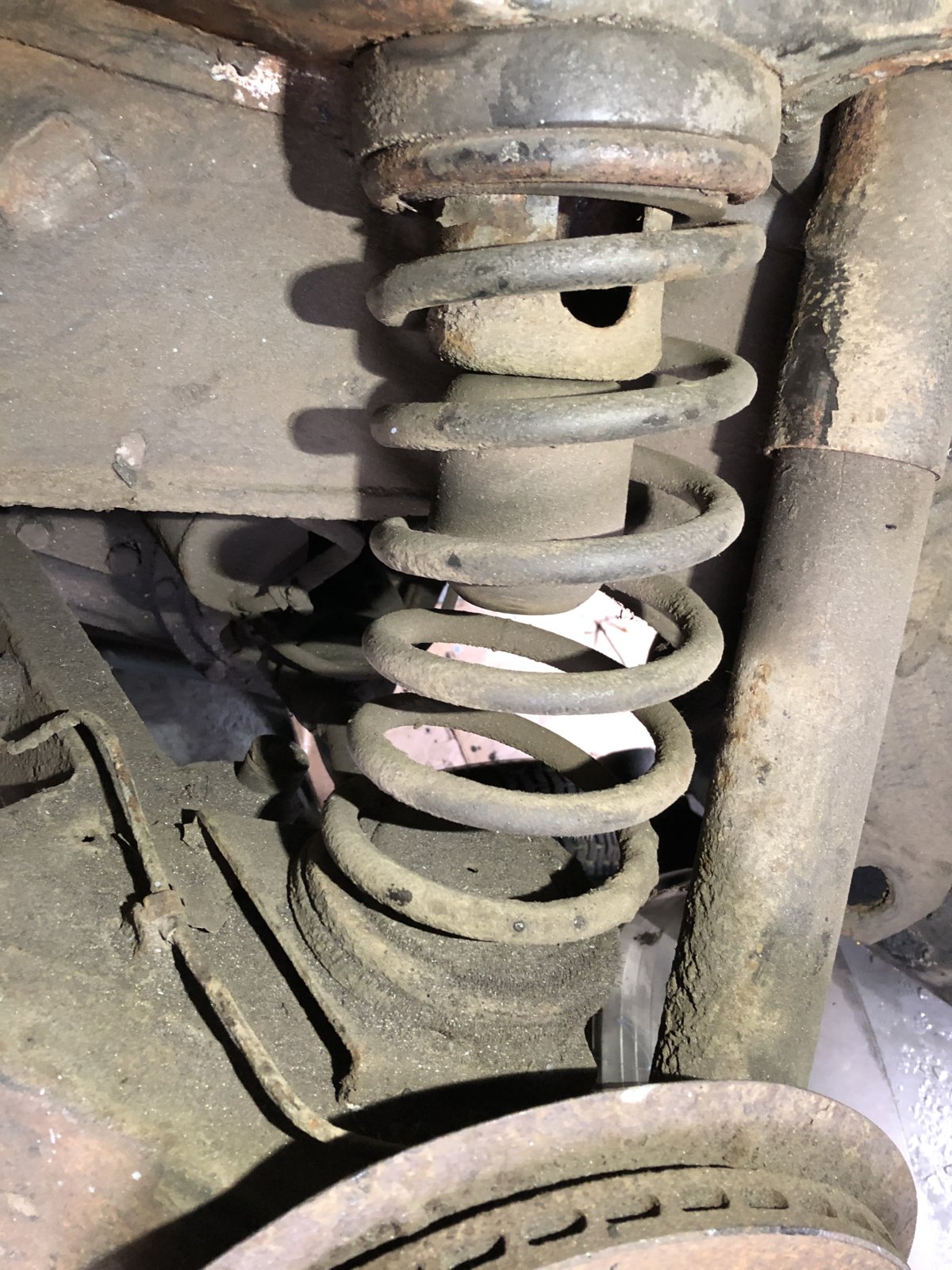

Which bit is thicker or thinner on the rear spring ?

My 14" rims and 205 tires rub from the lowering springs, not spacer removal. Roll your fenders and you'll be fine with stock wheel/tire combo.

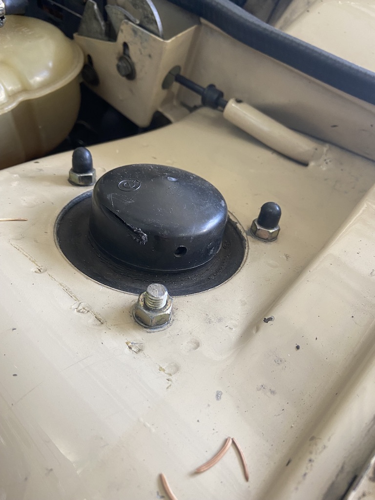

For folks who are doing this, PLEASE do not forget to cut the studs or replace with shorter ones...you will not like the damage that can happen to the hood when the studs are too long. I don't think it always happens, but there is a risk.
Yes I used a die grinder and cut the bolts back to fit the new strut position. I have not had any issues with the tires interfering with the springs all my tires/wheels are original size.
I bought shorter studs from the local dealer. It took just a few minutes to replace the long studs with short ones.

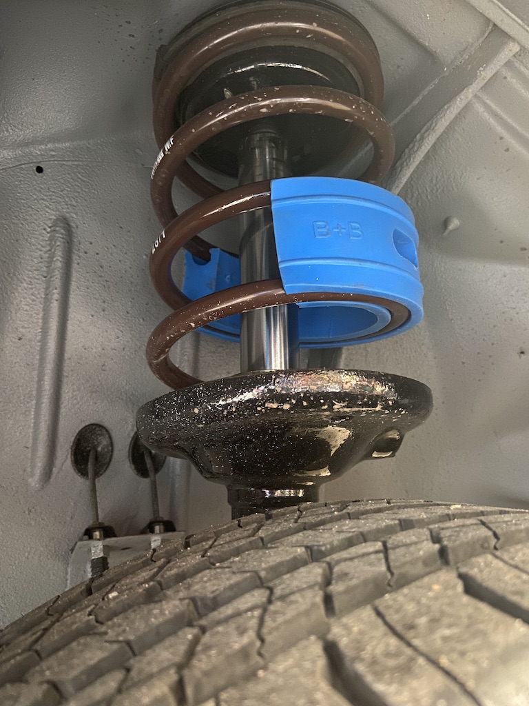

I too have installed HR sport springs all around, Bilstein shocks x 4, and removed the strut spacer. I found the front stance to be a tad low. I rolled the fenders when I did this so I've had no rubbing. However, I also cut the strut bearing bolts so they would not damage my hood. This was the limiting step to me adding height to the front of 'Heidi'. I wanted to add a custom milled spacers 1/8" spacers so I could add increments of 1/8" between the strut and body. BUT my bolts are too short. So....the option I found when searching for 'coil spring spacers' has worked great! I wanted to add back 1/2-3/4". The pictures below tell the story. It was a super fast and I think a slick solution. Sorry...the picture of the car with the 'to low' stance is not the ideal angle though you can see less tire.
I seem to recall that the spacing of between the coils of the front HR sport springs is wider at the bottom and narrower at the top; if my recollection correct, then these spacers would also be adjustable; you could add more height by moving the spacer up. Mmmmm.

Coil spring spacer/buffer,
