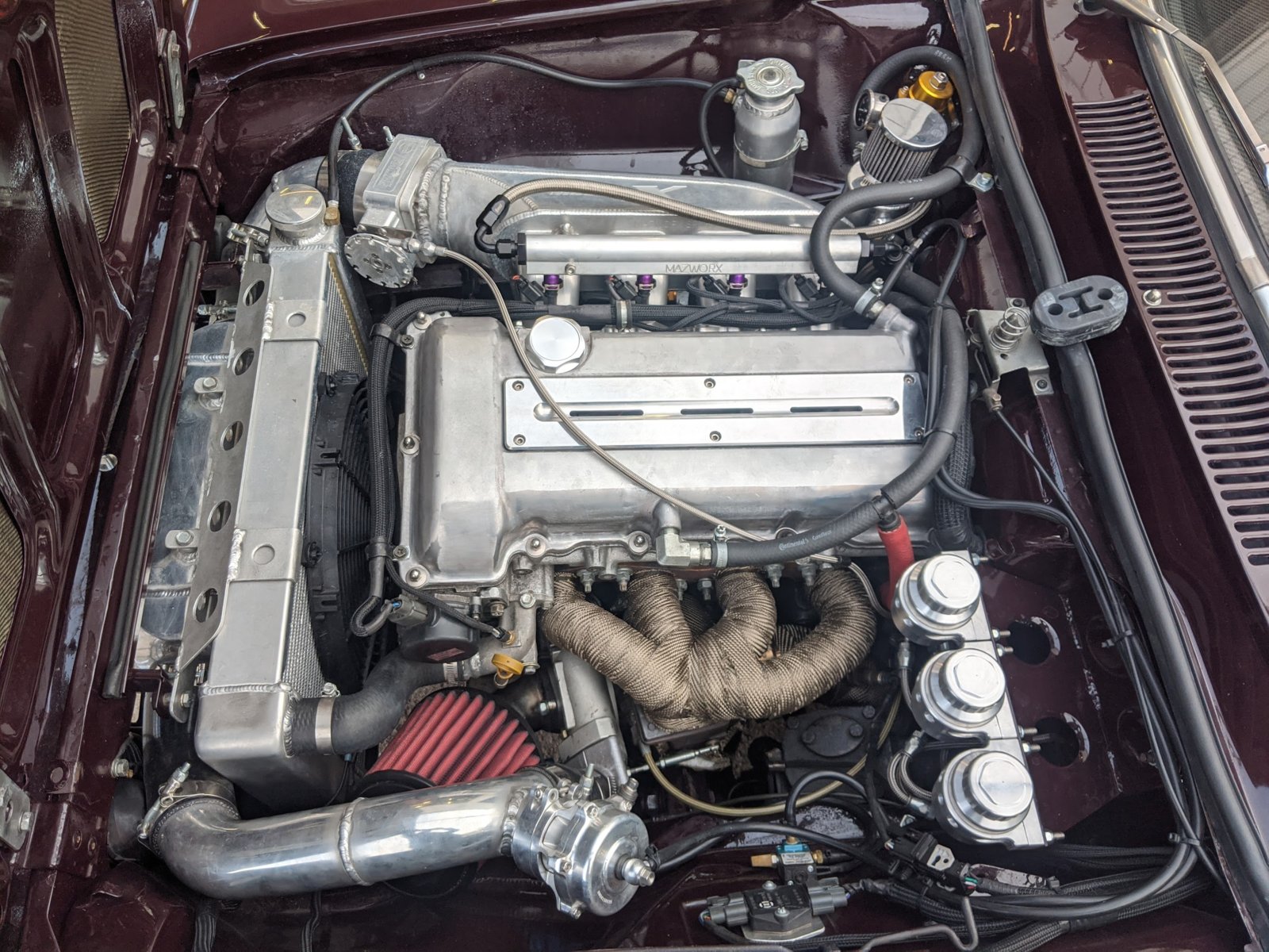

Just for reference, here is a picture of the engine bay in the Alfa that we built. 400 whp on wastegate pressure, and 550 whp if we turn it up. The car weighs 2000lbs. No need to go this fast with the BMW, just looking to take it to the next level. If parts don't exist, we build them. Building these cars to my specs is my hobby, I get no joy out of restoring cars. I just like to hotrod old European cars
