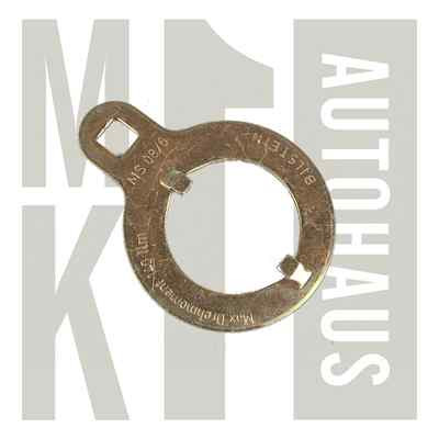

Carmine, I have never used that tool. Just use a large plumber's wrench. I usually tighten after the strut assembly is put back on the car but not yet weight bearing. There is enough room between the spring coils to fit a wrench and the housing is held fixed in place to allow some torque.
