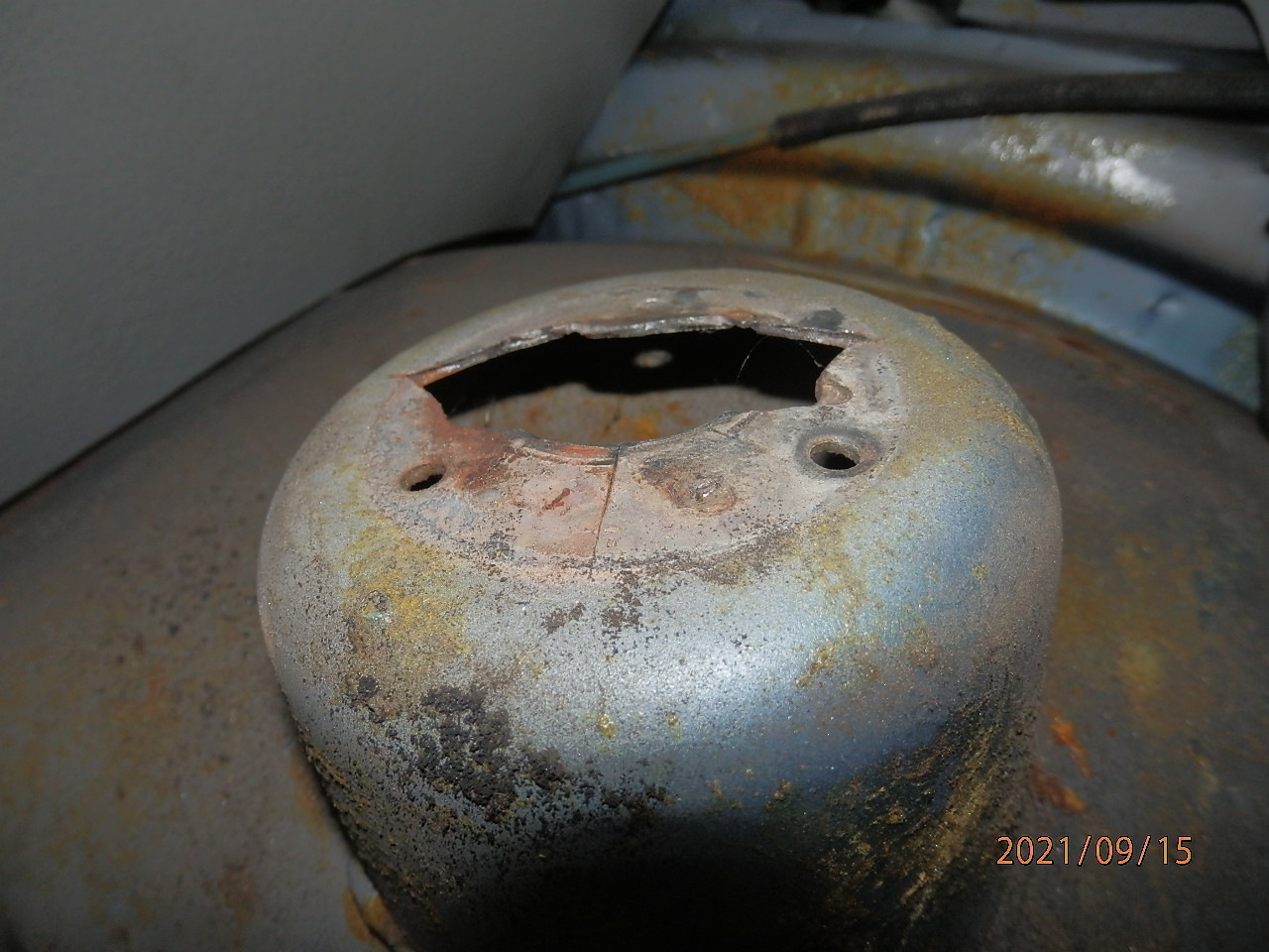

This morning I went in search of a noise from the right rear, it didn't take long to find the source! Hope I can post a photo, haven't been here in a while, but just in case I can't I'll try to describe my question.
It seems that the shock has pushed a 3" plate that was spot welded to the top of the shock tower out. I went thru the books I have and expected to see the coil spring around the shock, but found the shock and spring have two separate locations which made the dissemble easy. In any case, what is the correct repair without replacing the entire tower?

I noticed here that the torn steel tracks exactly from spot weld to spot weld on the part in my second photo.

I also wonder about the three holes in the top of the tower and in the plate in my second photo. I was thinking of turing up a ring that would be a tight fit on the diameter inside the top of the tower, and bolt it thru the three holes already there. With a corner rounding end-mill on the rotary table I could match the roundness of the tower. Being all the repairs seem to be using the existing tower to weld to, I think this idea would be just a strong.
Question: Is the shock tower truly round inside? In one of the links the part made to be welded on looks oval

And your inital question ( "what is the correct repair without replacing the entire tower?") is actually answered twice: in the threads linked by HBchris and Arde you see various options how others have solved it. Members here are often too polite and don't want to push one solution or another, as you may have limitations that may render some options are less practical then other solutions.
The second question "Is the shock tower truly round inside" is only one day old....
Pls forgive the members here for not living with the forum open 24hrs; most of us prioritize driving & tinkering over forum questions . The answer is YES. truly round. That also could have been found in the threads linked: various options discuss turned elements: most lathes have a hard time turning ovals... Also suggested was to weld in tube sections.
As above; it's not easy to define here "what is the correct repair method" as you may have (just par example) easy access to exact dimension steel tubes. Or you perhaps have a lathe.

I do have a rather complete machne shop, and was trying to get this job done without welding. I can weld, either gas or electric, but didn't thing my welding "looks" good enough for my e9, the car is extremely clean, not perfect but nice.

As the "heartbreak" kid in the thread @HB Chris posted, I definitely wanted new metal up there, if you inspect closely the original metal is folded and thin, very weak after all the years pounding. Now my towers are indestructable. They're covered by the elephant skin anyway.

You're saying "someone should" but then you post photos that make me think someone already did! So what's the story on the parts you pictured, looks like some pretty good lathe work.
The ones in teahead 's post are made by a member. Same images are in the threads posted earlier.
They are not available.of the shelf anywhere, but as you mentioned that you have a lathe, you could make them yourself: the dimensions are also in the threads linked.
