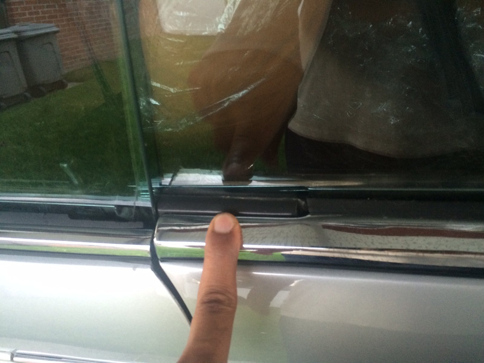

Hello everyone,
Today I have spent over 9hours trying to fix the aged rubber "block" on the bottom of the rear side window. First I tried fitting it to the glass like it was supposed to. But when installing it to the car, this block sits about 1/2inch (1cm) below the weather seal that is on the chrome window trim. I had to cut the block to fit it correctly (the old one I removed was also cut).
But I can't figure out how this is supposed to look when installed correctly.
I can't check the other side because that piece is missing there.
Does anyone have a picture of how these pieces sit correctly when the window is closed?
Thanks!

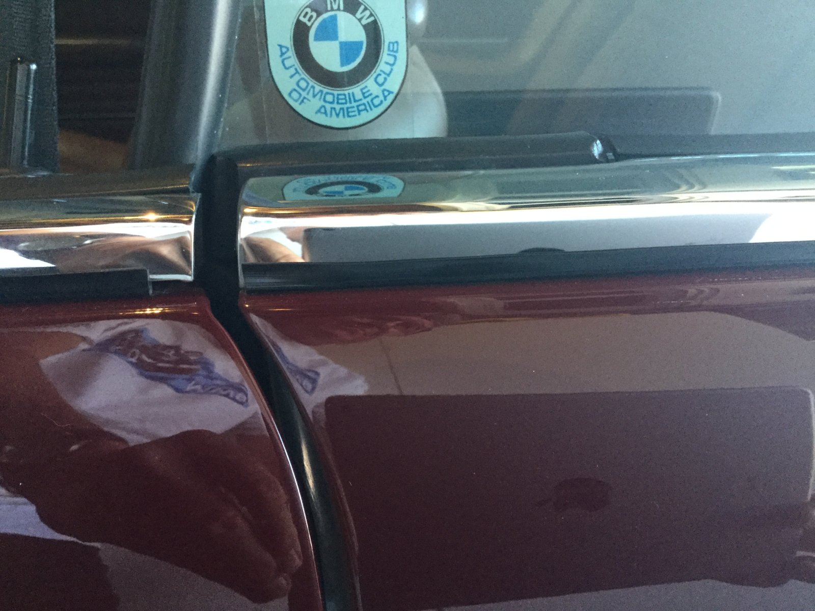

Maybe this will help.

Hi Chris, It seems like the end of the piece, where it meets the other seal is a bit crooked. And the vertical trim is also pushed towards the front on the bottom where it meets the rubber block.

Here’s my passenger side with door glass up. It’s does have a slight notch in it on leading edge. On driver side the vertical seal has a small fold from wear but it is vertical.

That is the correct piece, those are the pieces I instLled. But I need to know how these actually fit to the other rubber seals (below the window and in the verticle chrome trim on the side of the window.)

This is interesting. I had to install my rubber piece on the edge of the glass, while in your picture, it sits 1cm from the edge (nr1). When I do this, the rubber piece is too far back and hits the rubber weatherseal on the bottom when the window rolls up and down (nr2).

Well remember that I removed the Aluminum trim that runs vertically on the rear window. It has a rubber seal on it. This trim piece keeps the front window sealed with the rear. So the rubber block in question needs to be rearward of the trim piece.
