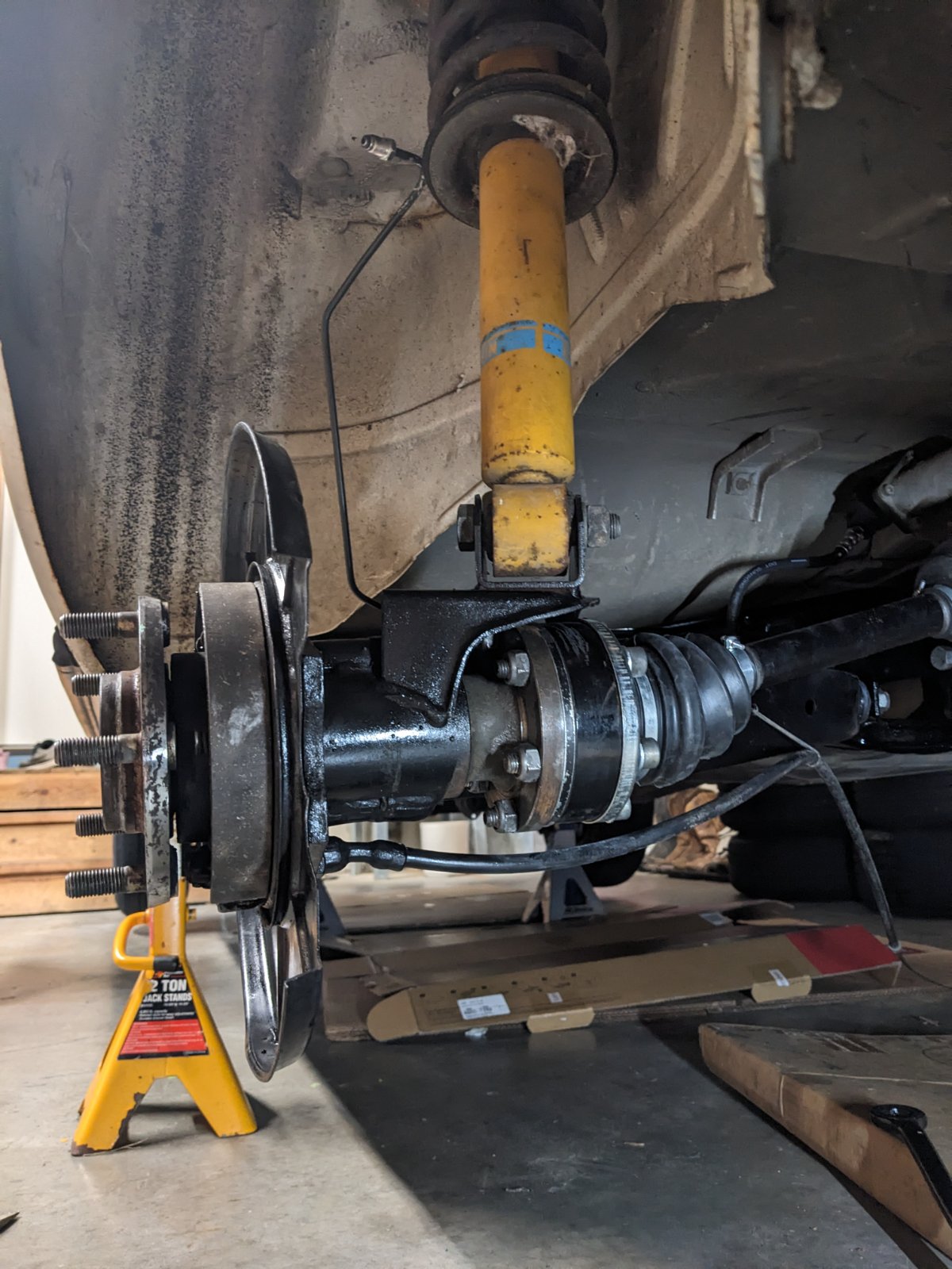

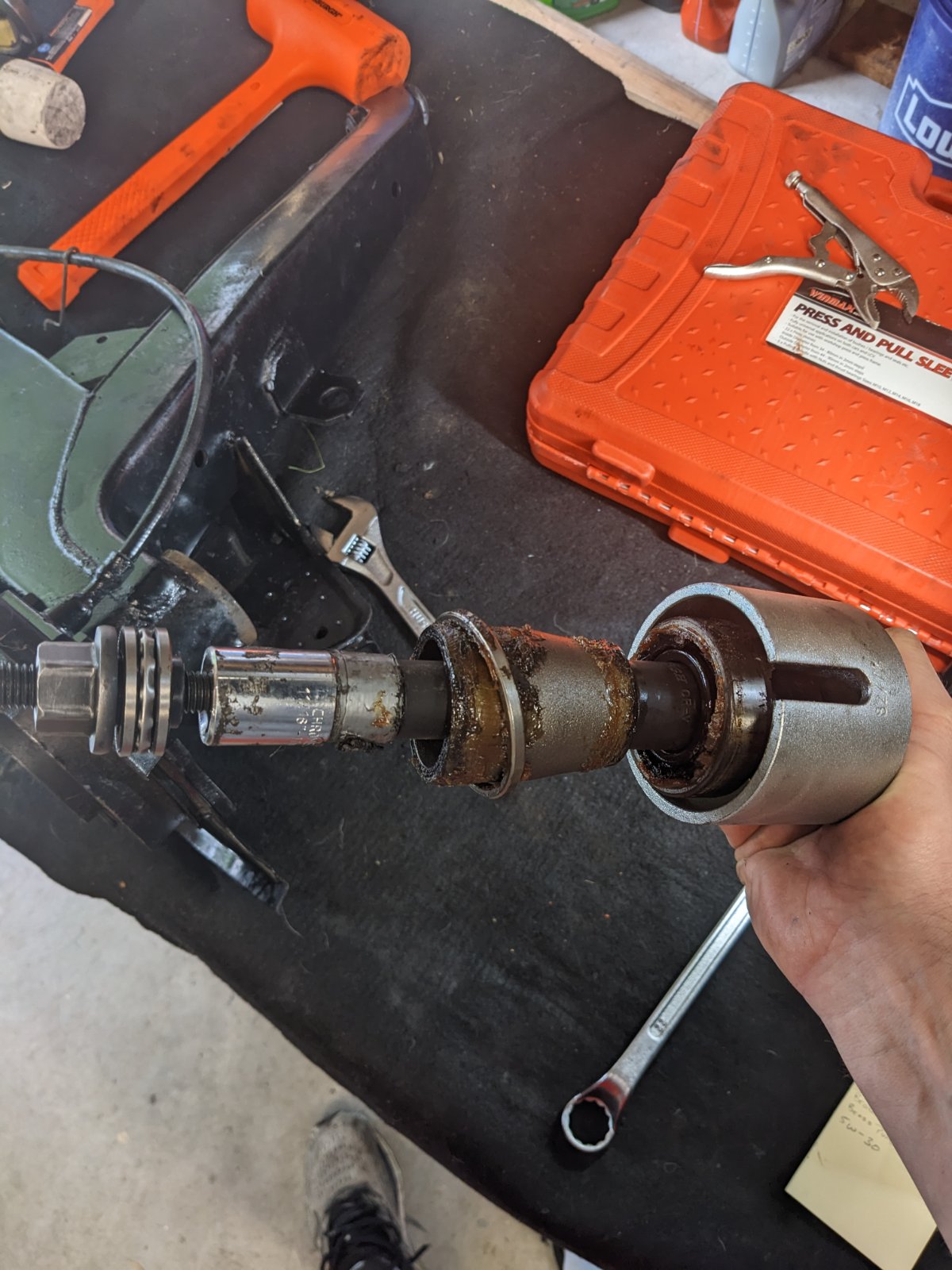

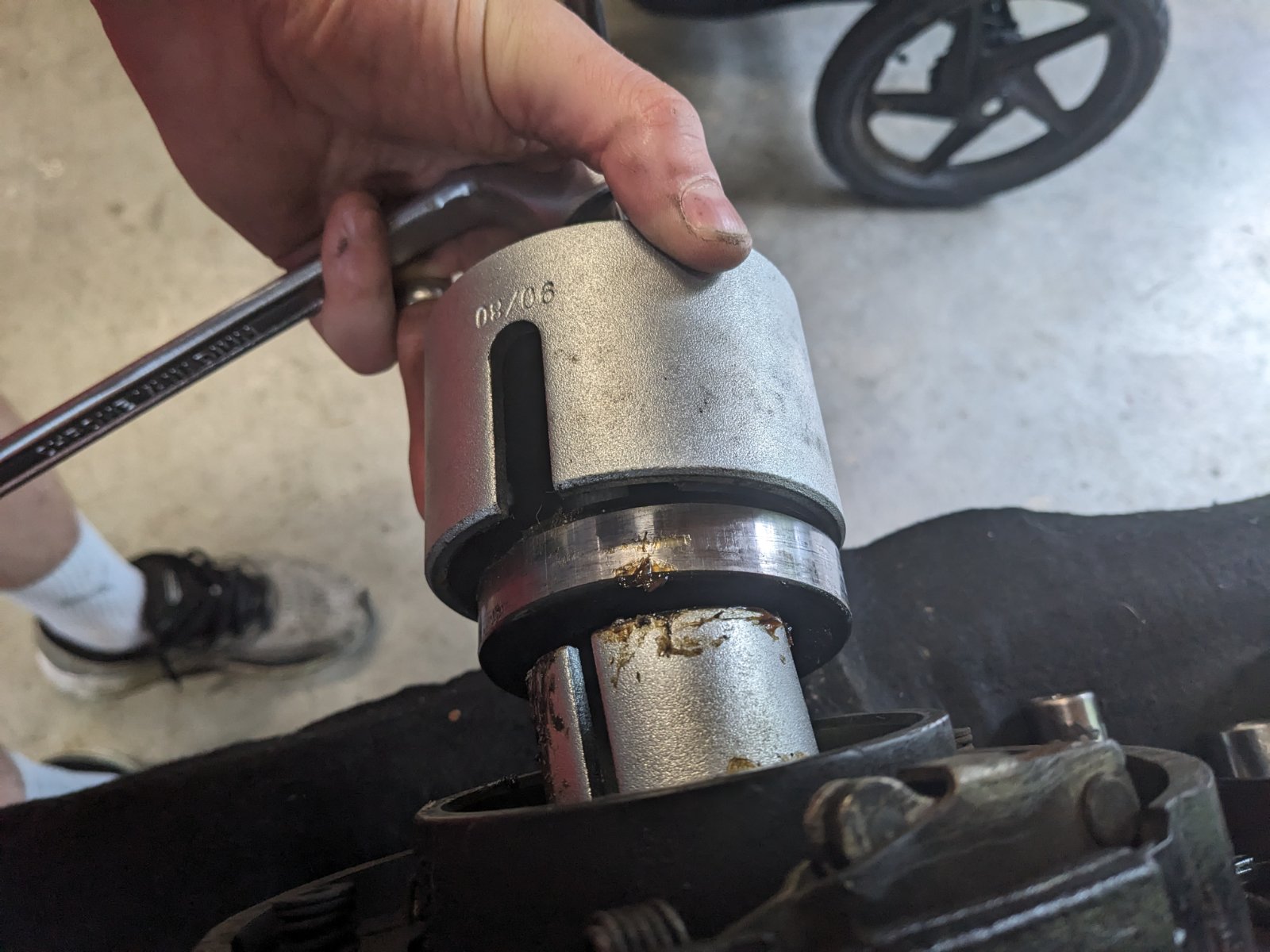

Im easily convinced to come help when a couple beers are included. Currently waiting my bearings to arrive in the mail. Will update later today, going to try and knock out the old ones
Both bearings out. Easy oeasy with my pull/press sleeve kit

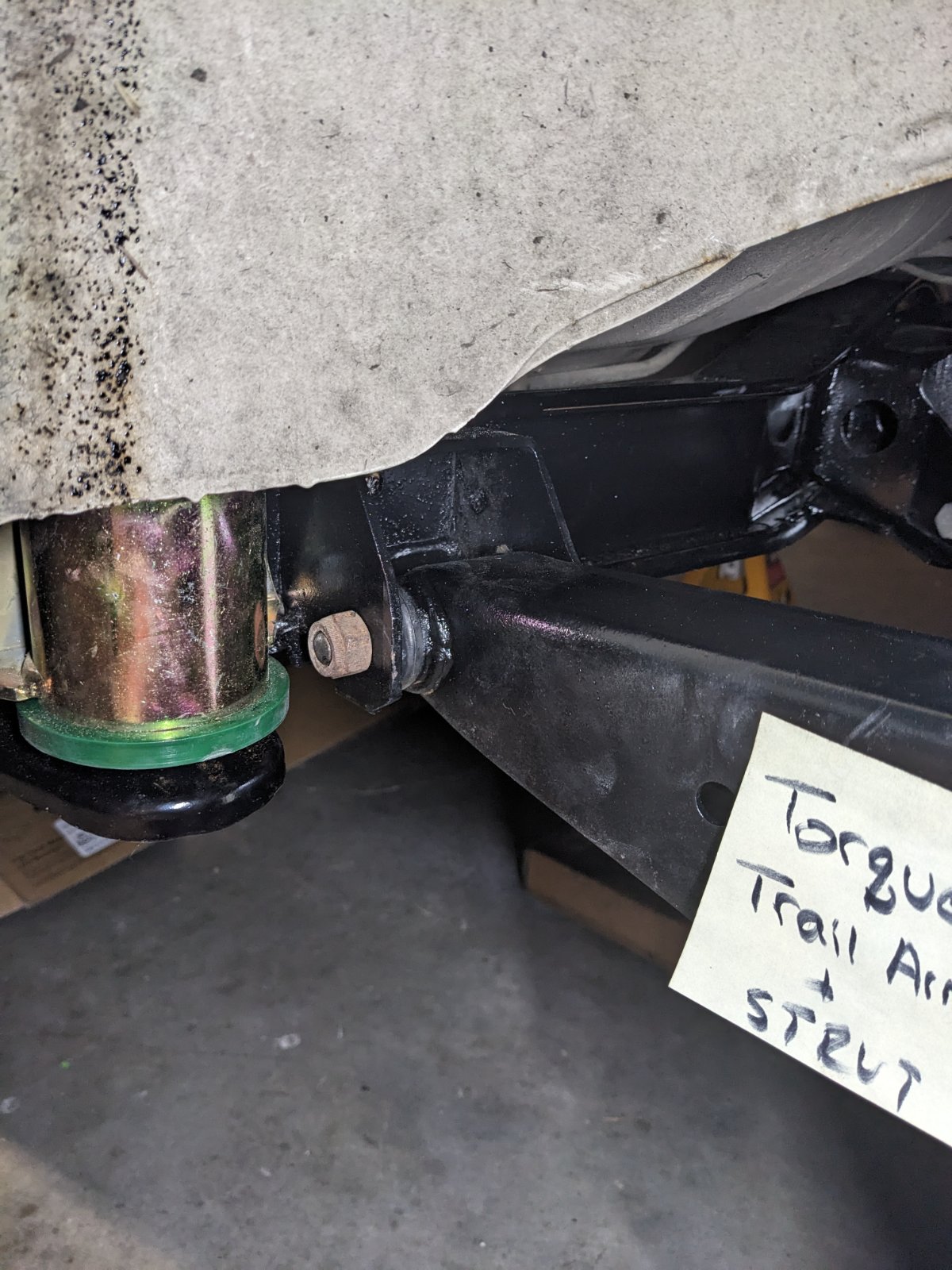

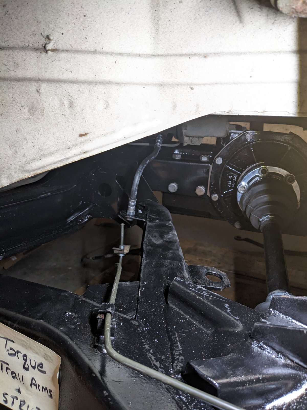

Progress feel good...
Resealed and painted diff back in along with new diff mount bushing, painted subframe, trailing arm bushes, new IRE Eng. poly subframe bushes, re booted and painted the half shafts. New parking brake shoes, rear brake lines, caliper seal kits installed...well at least in the driver's side.
Still waiting on those wheel bearings to get the other side done. Heavy lifting done for the passenger side though s everything has been painted and bushes already installed, so will be quick once those show up.

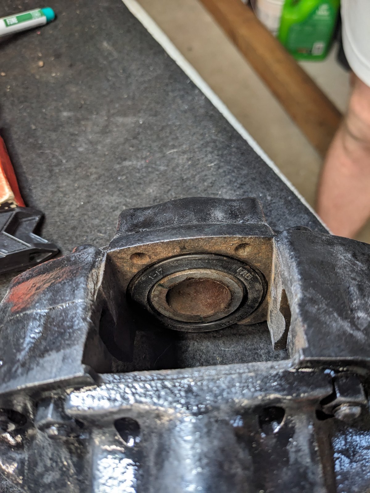

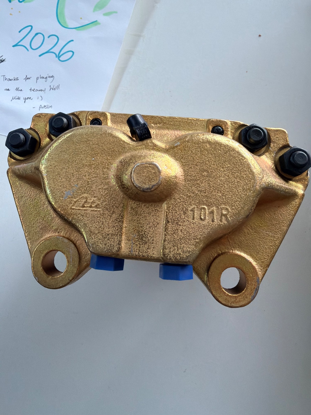

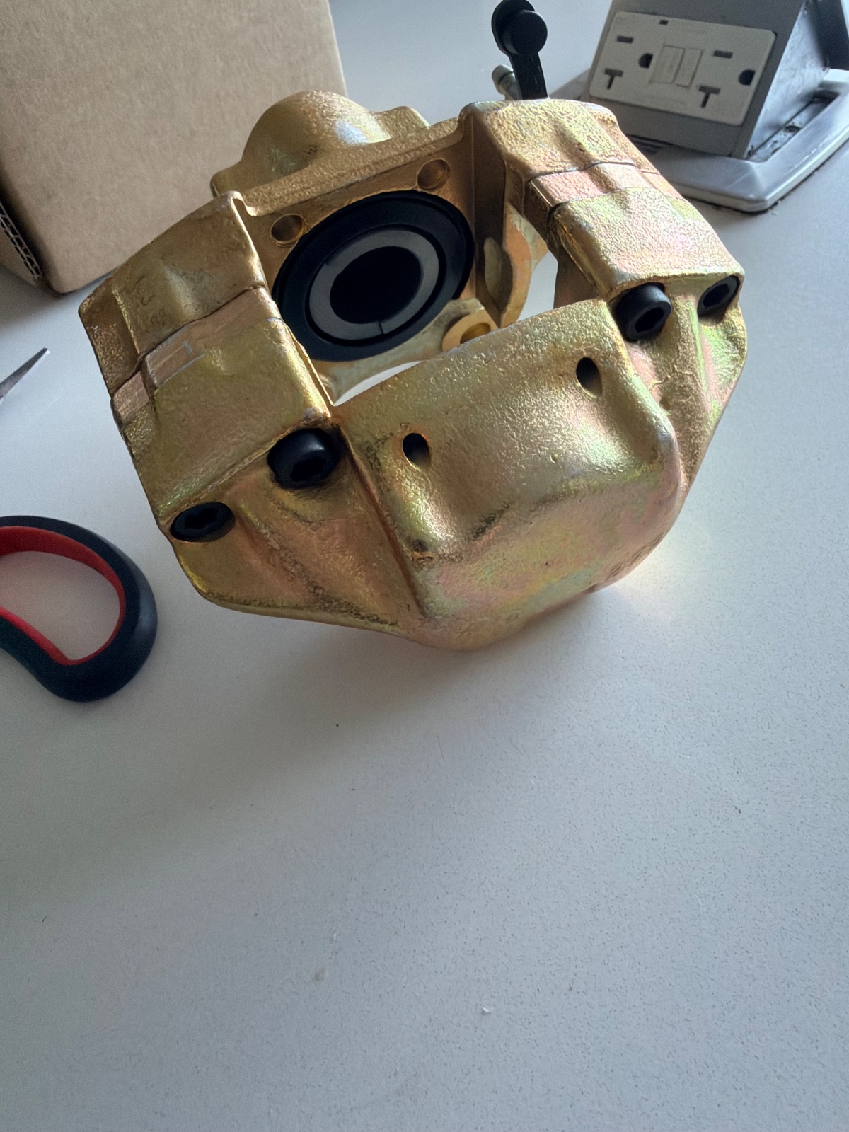

For the calipers, I did them myself first, then decided to send them to CaliperHQ. They returned looking beautiful. It’s a nominal expense, but did seem worth it.

Love the note to remember o torque the bolts!! BTDT!!
