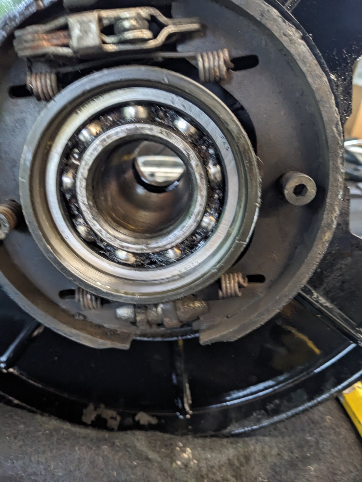

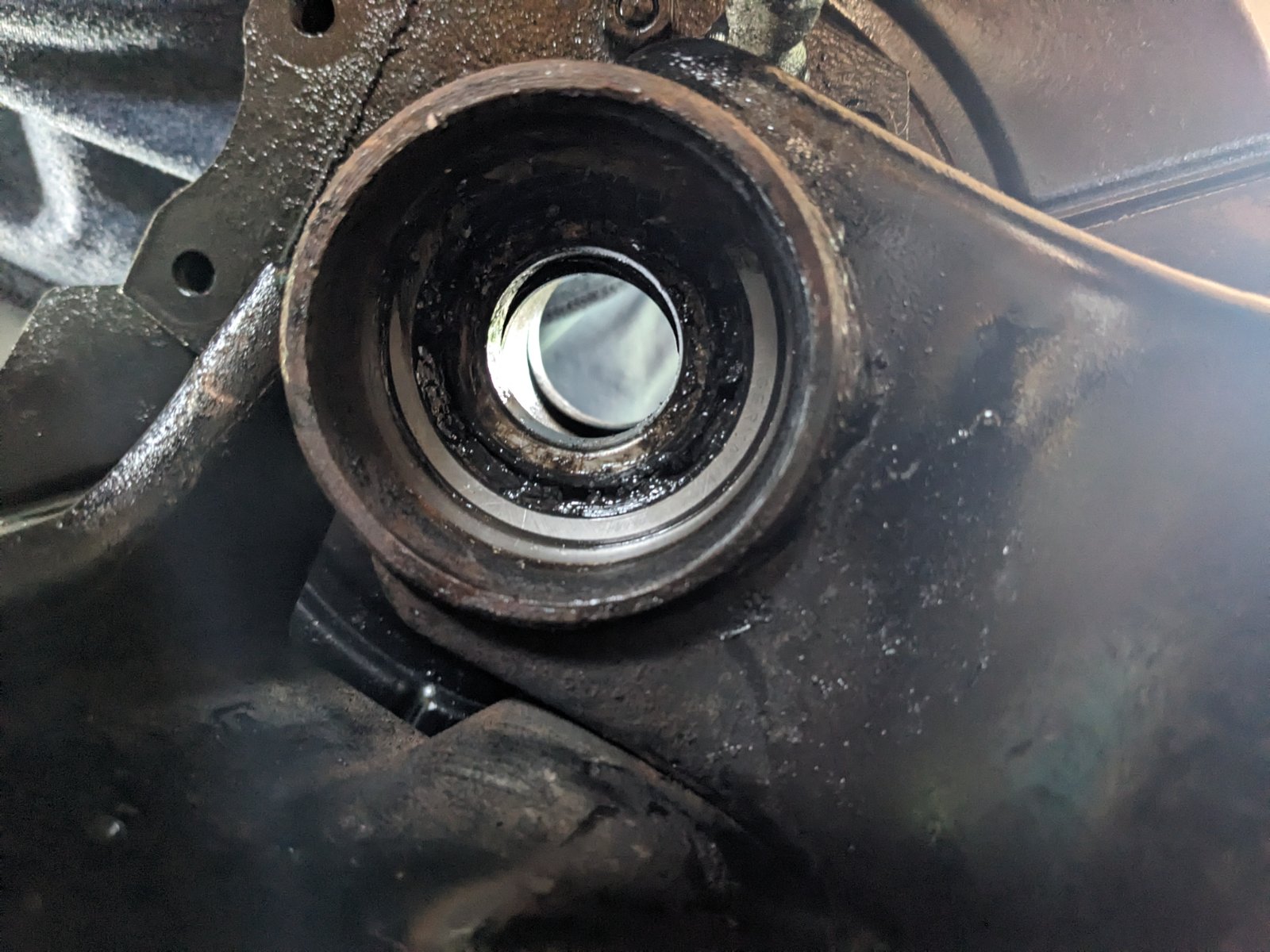

Hi is out along with inner and outer seals. Question is now what is the best method to extract the bearings???

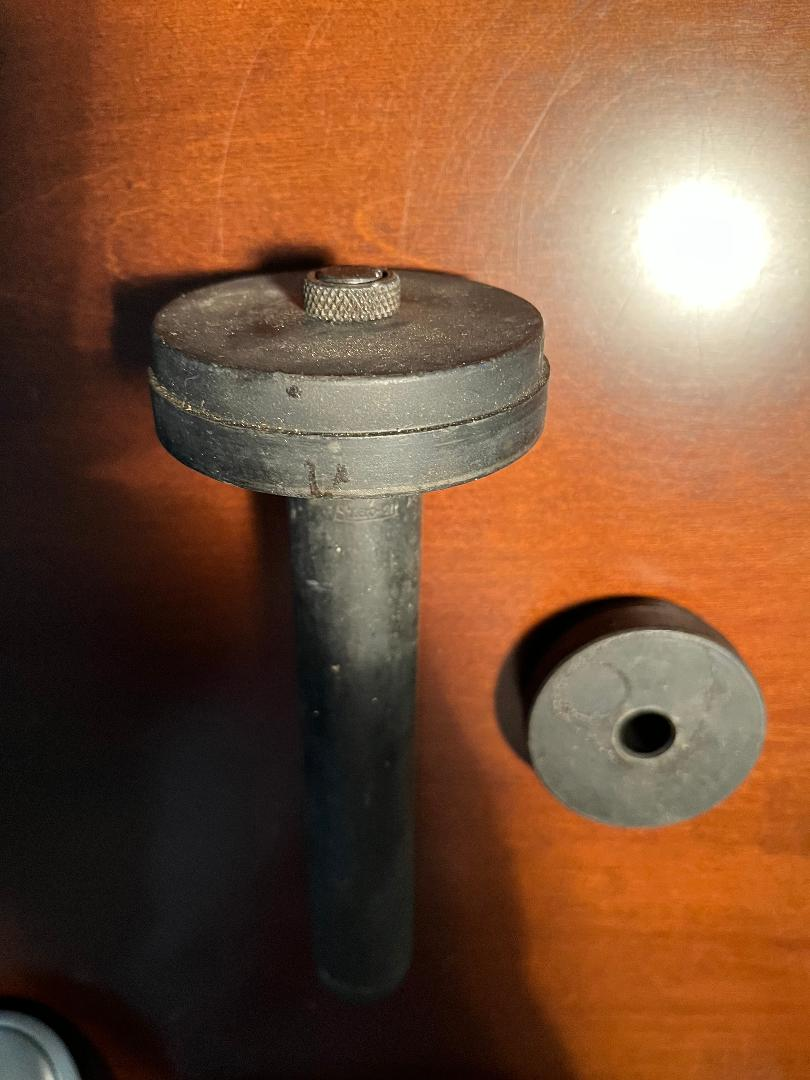

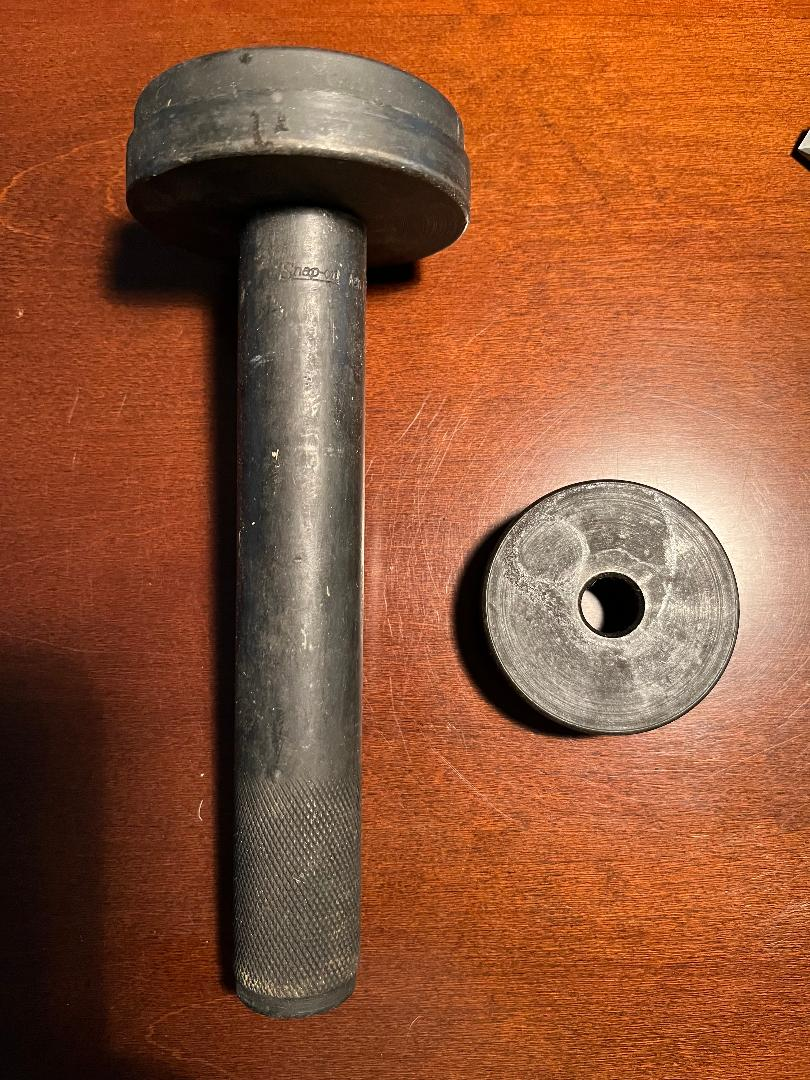

i used a bearing driver - snap on 1257-1 handle and 2 discs - small one is 59.5 mm / 56.5 mm (they are stepped) and the larger one is 72.5 mm / 75.5 mm. i bought these years ago when i changed the rear bearing on my e3. as i remember, i drove the little one out with just the handle ... and then used the small disc thru the hub to drive out the big bearing. the big disc was used to set the big bearing.
With the larger spacer sleeve still in the bore between the two bearings. How would you get a tool like that in there from behind to knock out one of them?
I think I used a drift pin to tap the little bearing out and the hub is bigger than the handle and I think I used the handle to knock the big bearing out. It’s been a number of years since I did this

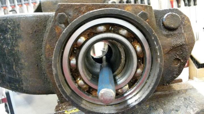

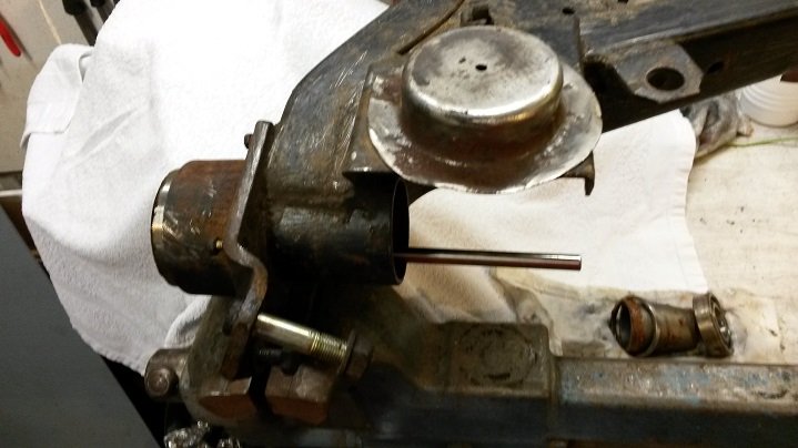

Easy peasy. Just drive them out using your favorite piece of steel.
In my car they came out really well. Tap gently, and replace the driver to a different position after every blow - as if it's a clock; tap once on 3 o'clock then 9, then 6 and 12 and continue untill you feel/see it moving. If it skews and locks itself, then hammer it back to a neutral (parallel to seating face ) position.

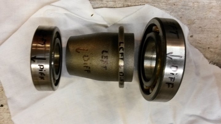

Note the order and orientation of the two distance parts
Thanks @eriknetherlands this is helpful. Is there a certain order for reinstall?
