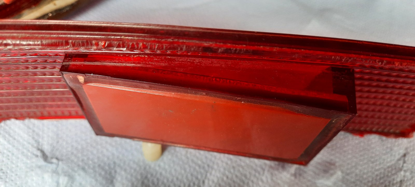

hello everyone,
i remove my broken lens with electric hotknife, everything is ready to glue but we don't have liquid fusion glue in FRANCE so do you think we could use hot gun glue or epoxy glue ? thanks

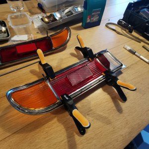

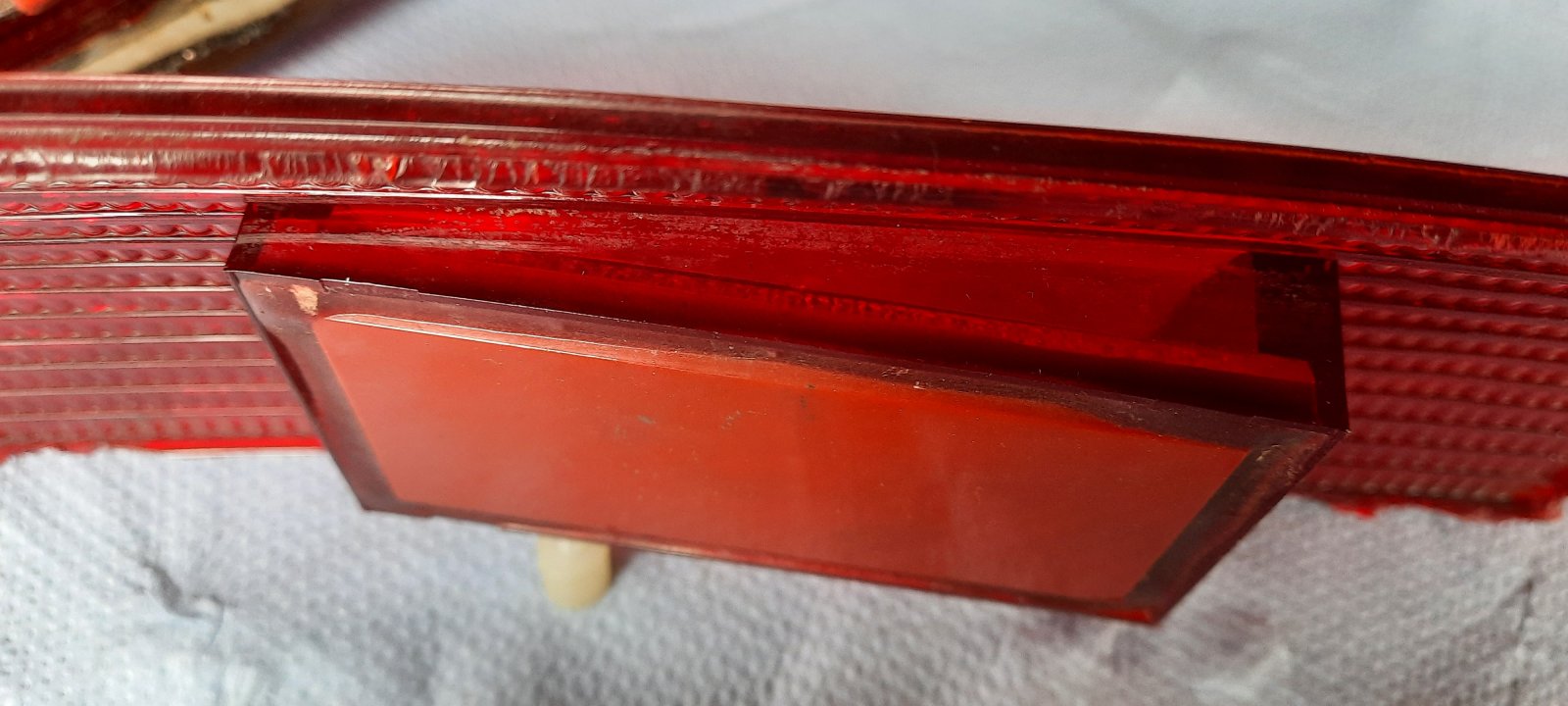

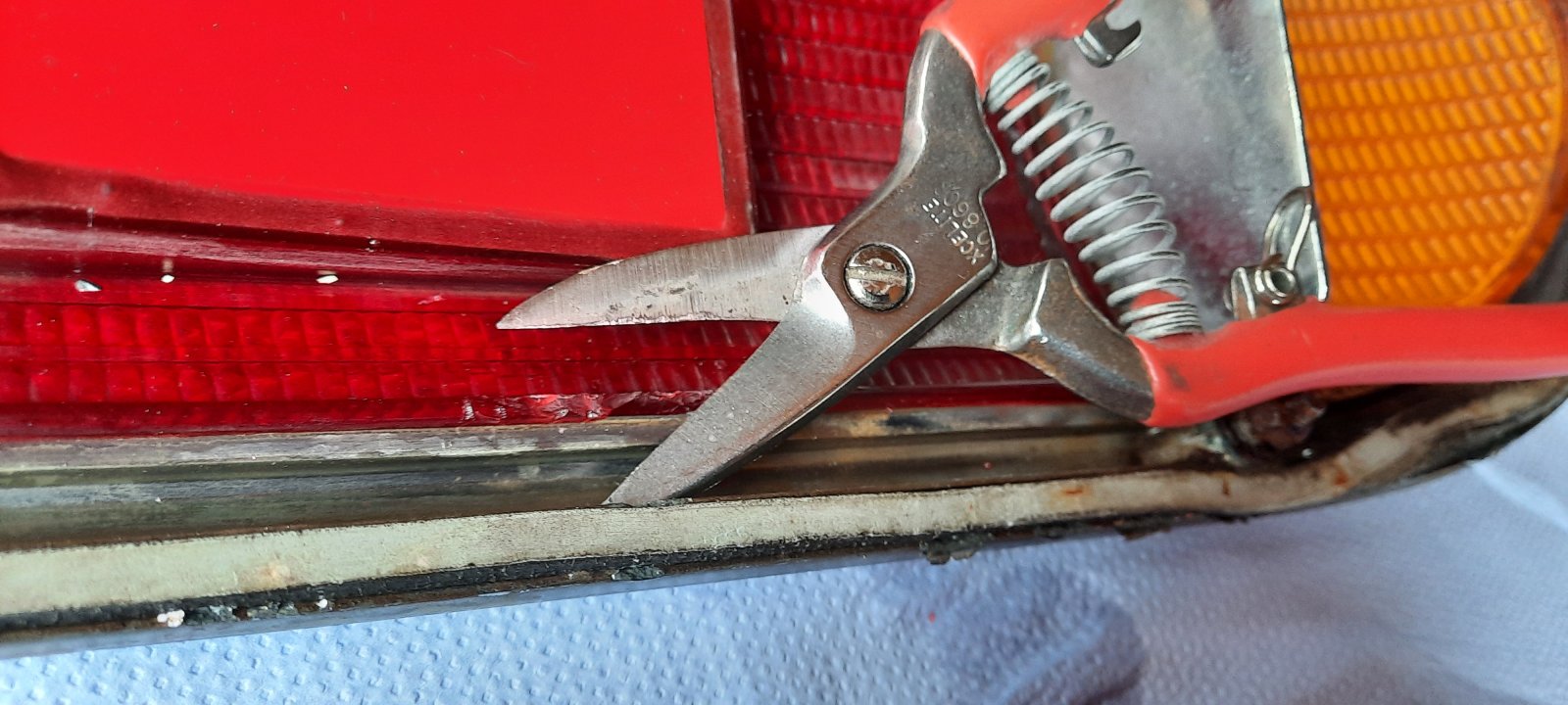

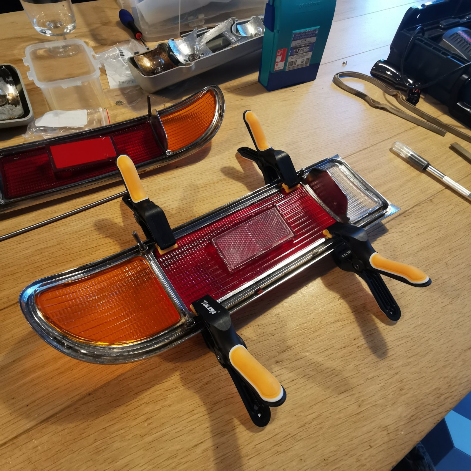

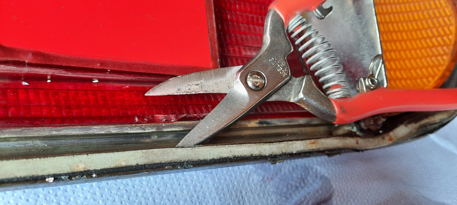

Hi everyone,
I'm using a special strong cutter made by Excelite. It's rather bursting than cutting these overlapping hard edges.
I use ceramic filled compound with good gap filling (e.g. Located EA3450 or 4090 from Henkel) to put the lenses back in place20230923_160336.jpg20230923_160347.jpg
Regards
Thomas
Hi everyone,
I use ceramic filled compound with good gap filling (e.g. Located EA3450 or 4090 from Henkel) to put the lenses back in placeView attachment 168735View attachment 168736
Regards
Thomas

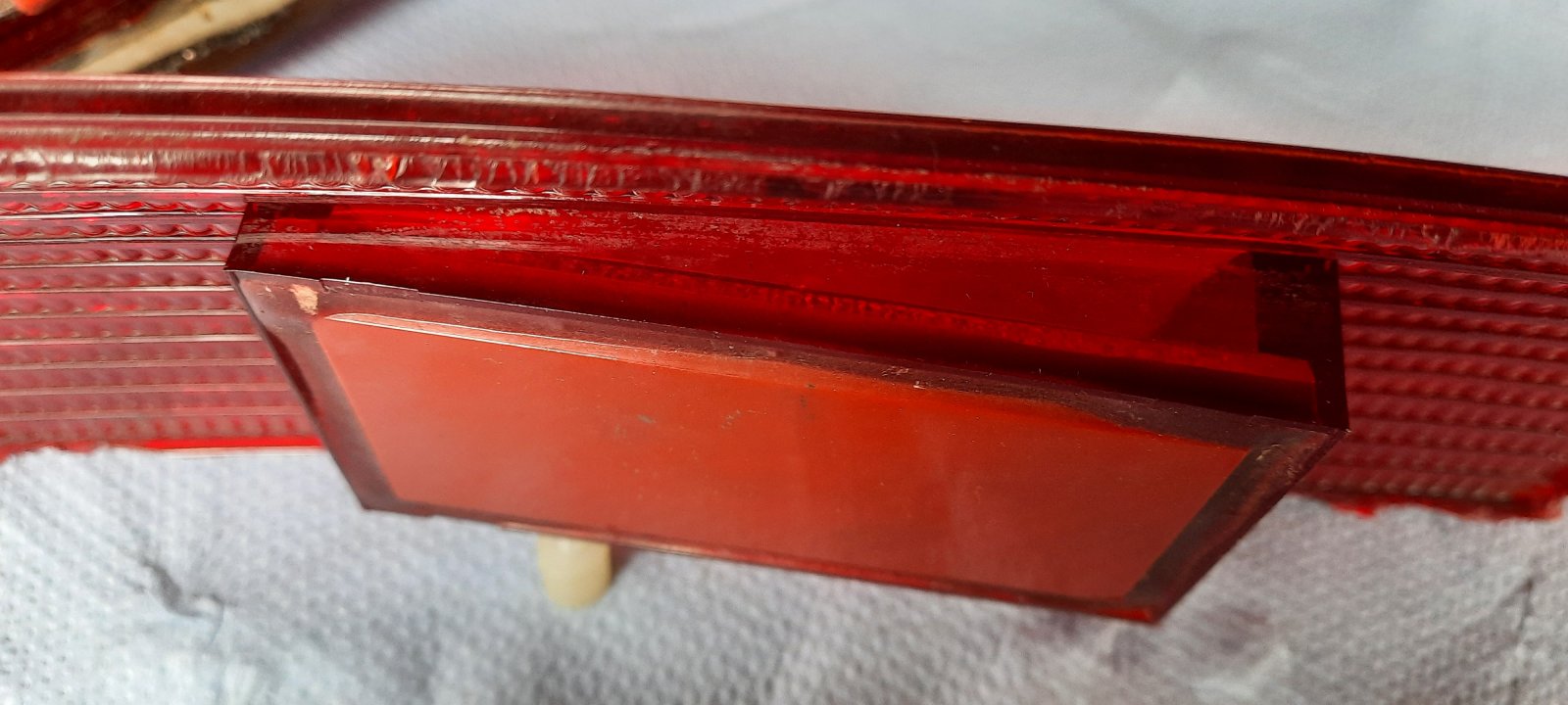

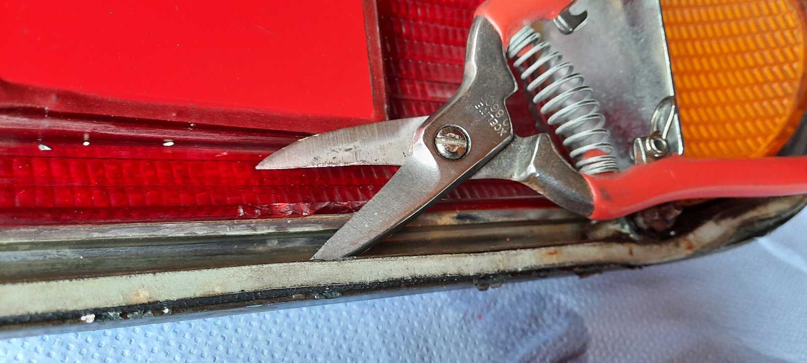

Hi everyone,
