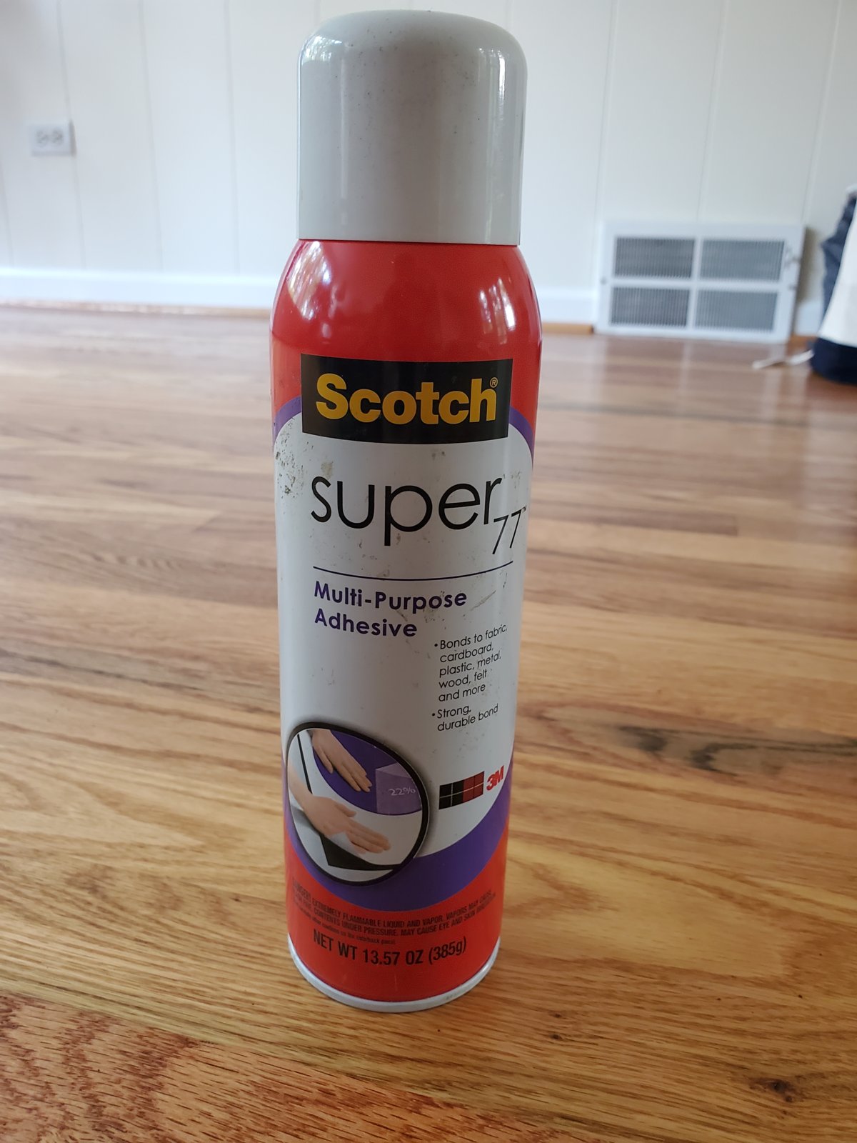

Steve(hose) - I've made replacement vapor barriers in the past, but I've never found the right adhesive to make them stay on very well. What do you suggest for gluing it on the door?
Thanks,
Dan

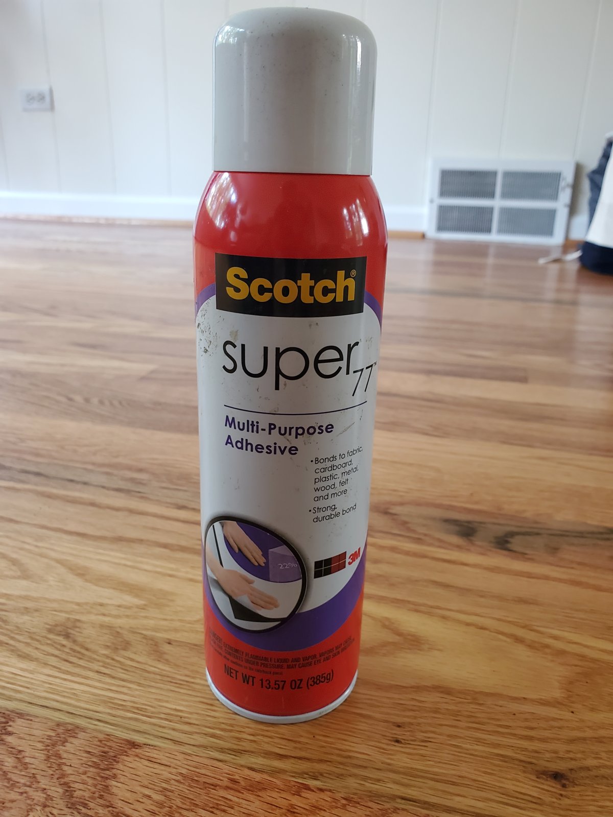

Thanks,
Dan

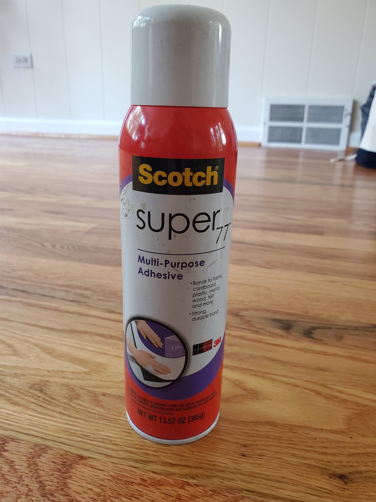

Thanks,
Dan
Umm err I just used thin strips of duct tape. If I were to do it again (or when I do, it's jsut a matter of time), I would use a brushable adhesive on the metal frame then apply the barrier, spraying something seems too messy to me.
I know I am a walking advertisement for 3M strip caulk but I run a thin continuous bead on the door and use that to hold the vapor barrier. Not perfect but does allow removal to get to stuff and then reseal. Trash bag as mentioned or paint section at HD or Lowes for 2 or 3 mil plastic sheet.
