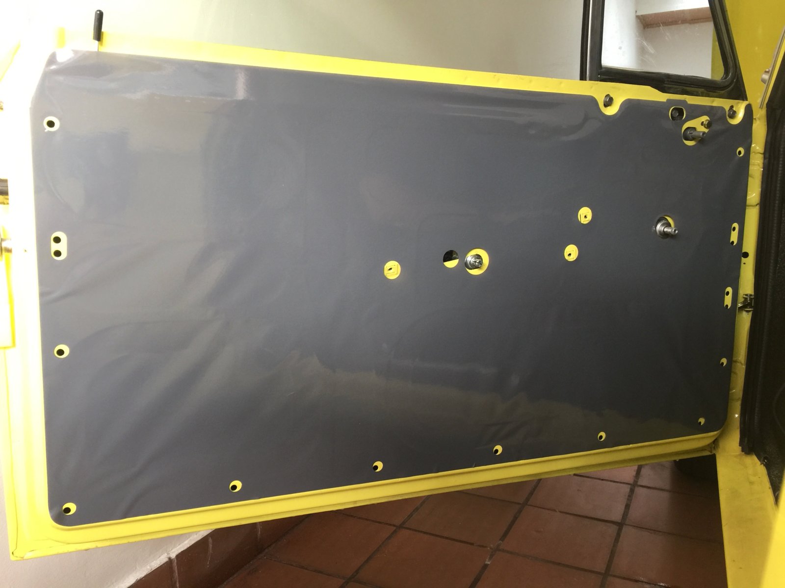

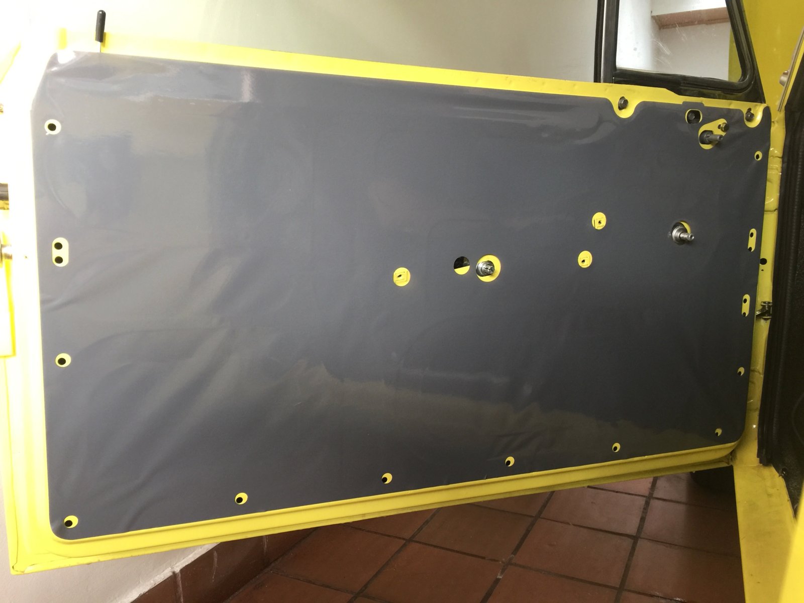

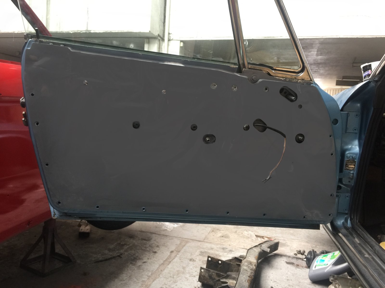

Thank you @Dick Steinkamp. Yes I reproduce a vinyl vapor barriers for old BM´s

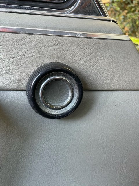

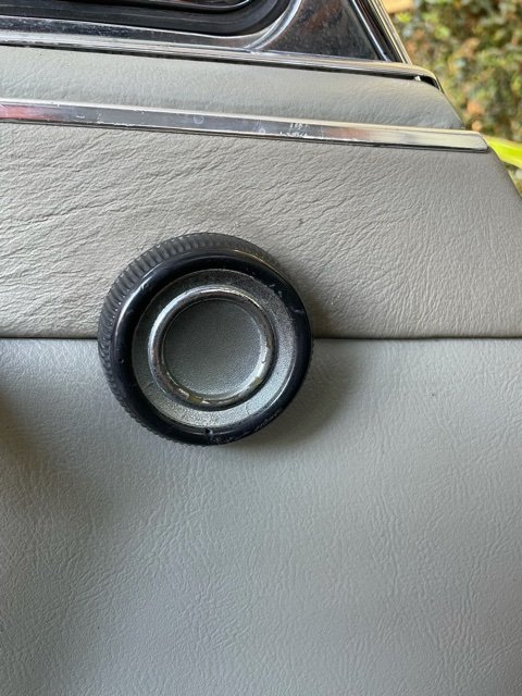

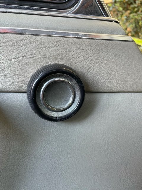

That's a replacement panel...factory would have wood, 1/2 way up above the knob, where yours has textured vinyl...I'm guessing here, that you don't have wood, and someone made an all-vinyl panel with a hole for your vent knob, in which case, yes, the knob would have to come off. As Chris described, and then the center screw.
It feels like the vent knob will keep the door panel from coming off, but I will try to take off the door panel with the knob still on. I think it was originally wood on the door panel, but in bad condition and the previous owner just upholstered over it. So now it's my task to figure out how to get it off. So far everything I've tried has not worked...
Keep trying, turn the knob until you find the hole and position it at the bottom and then push it off with an Allen wrench.
It's a little hard to tell, but it looks from that one picture, that they probably subbed a thin piece of plywood for the original wood (looks too flat to be over the orig wood; it would have a slight bow, or swell outward at that point...), and upholstered over that...not a bad alternative to fugly wood.

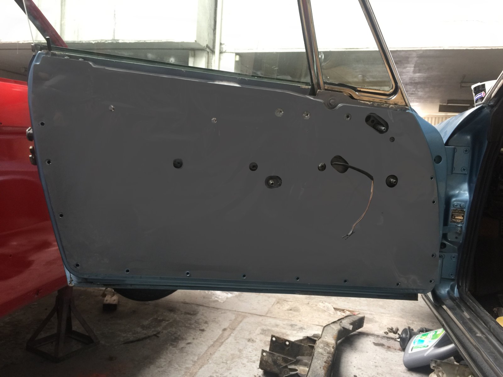

Steve(hose) - I've made replacement vapor barriers in the past, but I've never found the right adhesive to make them stay on very well. What do you suggest for gluing it on the door?
Thanks,
Dan
Using heavy plastic sheet cut to shape I have used simple rubber cement to hold the sheeting in place.
It tacks well, provides a uniform seal and when the panel is replaced it wil be secure and weather resistant.
Be generous when applying and the vapor barrier can be adjusted when fitting...not a one shot application like most other methods. And rubber cement is easily removed should access be needed again in the future. No stretching or tearing of the vapor barrier.
Done this for over 20 years. Pulled the door panel on my Volvo P1800ES last month and after 8 years and it was still perfectly adhered.
Foolproof

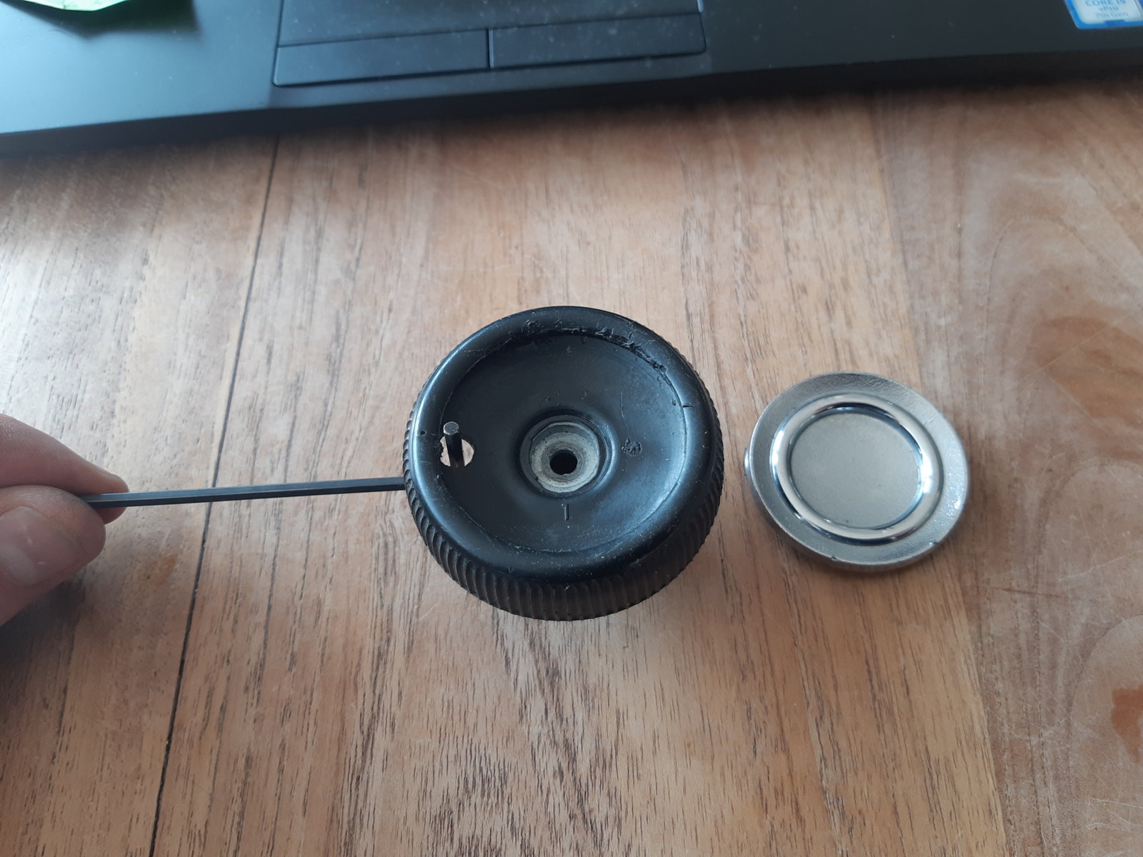

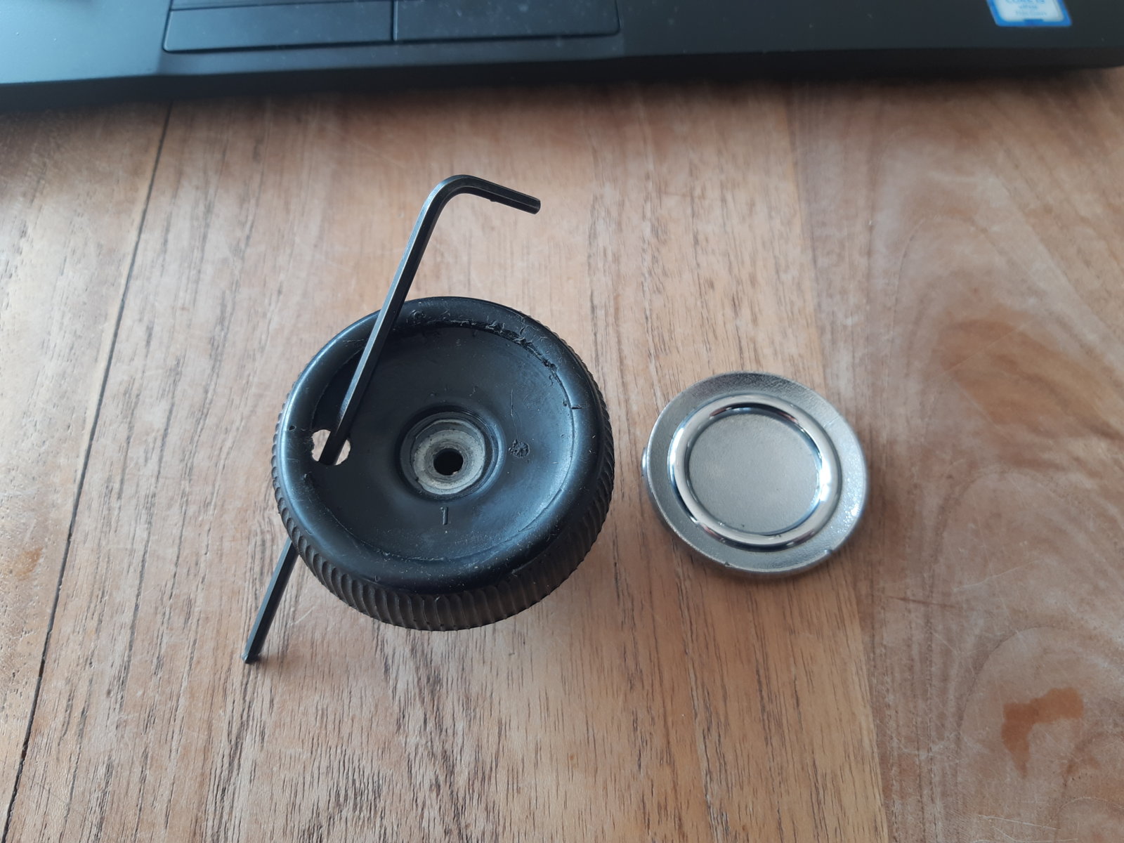

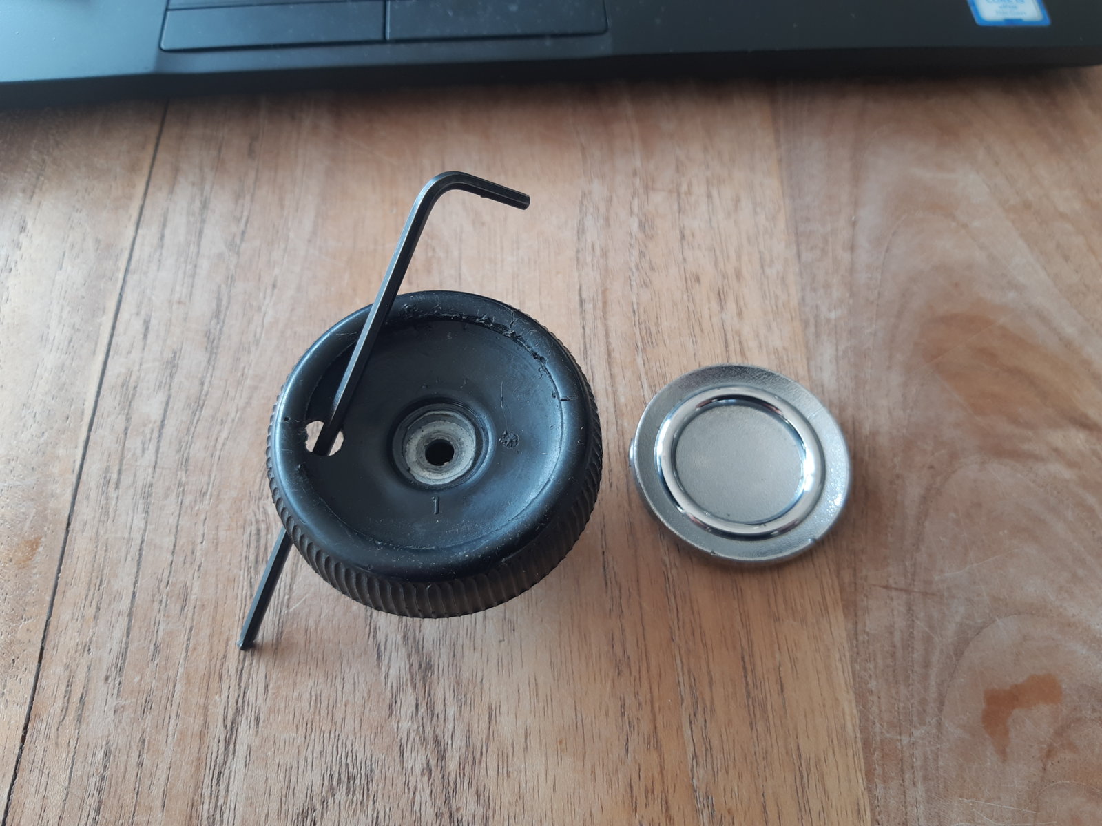

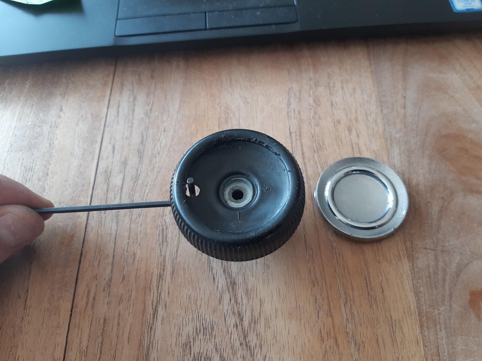

fyi, image here to help anyone out who find this thread while using the search function:
Finding that hole with the allen wrench is not as simple as it seems, at least for me. Also, does that need to come off to get the door card off, IIRC I did not have to do that (although I learned that retrospectively)?
As stated in this thread before, the vent window knob does not have to come off to remove the door panel ( the soft board carrier with the embossed vinyl part, holding the map pocket)
Reason is this: the embossed vinyl part of the door panel pulls away, downward, from the vent knob. Hence the vent knob can stay in place if you want to access the inner door only.
The top section that has the wood, chrome strips and window felt remain attached to the door structure after removing the doorpanel. the top section is a separate metal carrier that can be unscrewed from the doorframe with 3 tiny crosshead screws, hidden under a felt lining. to access these 3 tiny screws, you need to first remove the doorpanel.
