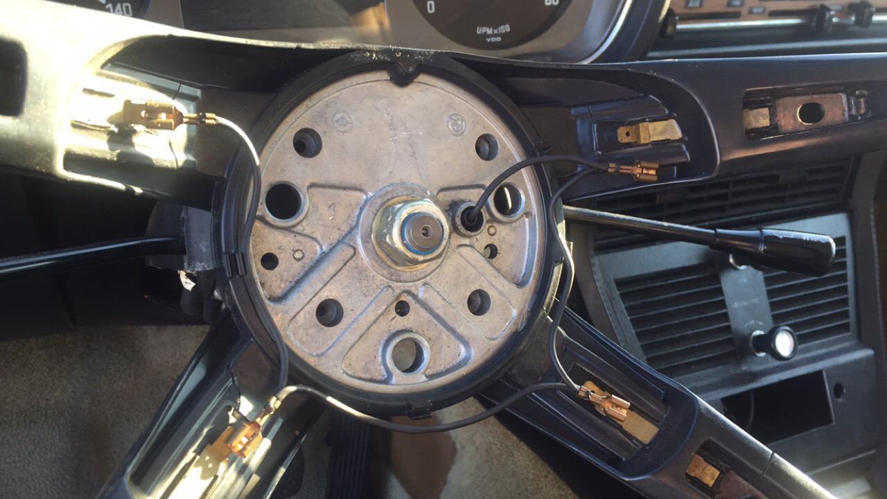

Anyway, my main question is where do you guys get torque specs? My car came with the blue binders but they seem to not have all the specs. I'm looking for the steering wheel torque spec and I've skimmed through the manuals, but there doesn't seem to be any torque given for the steering wheel on the page about removing/installing it (image attached). Maybe there isn't a torque? I believe on most cars it is 30 to 50 ft/lbs. I've also attached an image of the nut in question.

Nobody uses a torque wrench to tighten a steering wheel nut.
use a 1/2 ratchet and put some oomph into it.

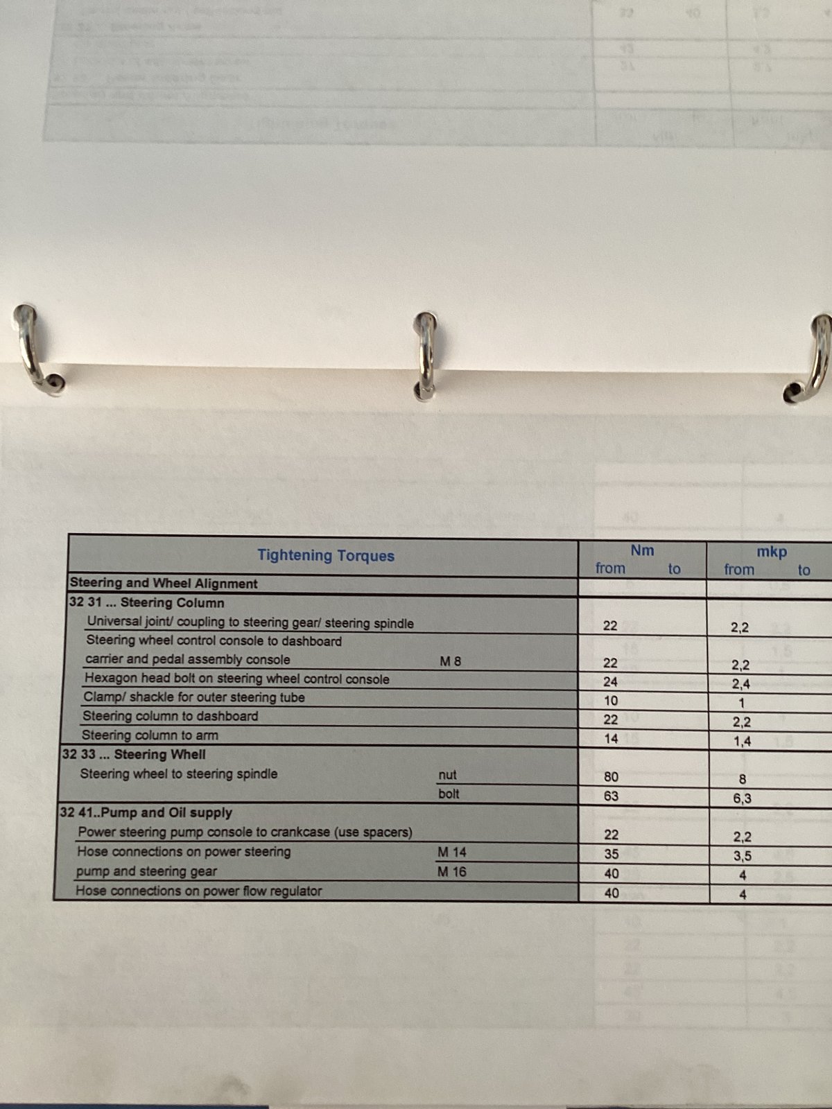

The autobooks manual on this page is a great resourse. It has torque specs in the back just before the electrical diagrams: https://e9coupe.com/forum/pages/published-sources/

I will definitely be coming back to this later, it looks like it has everything I will ever need including the steering wheel torque. Hope it doesn't become too bothersome answering the same questions over and over by newbies. Appreciate it.
