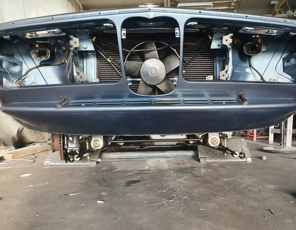

Restauration 3.0CS Automatik Baikal blue

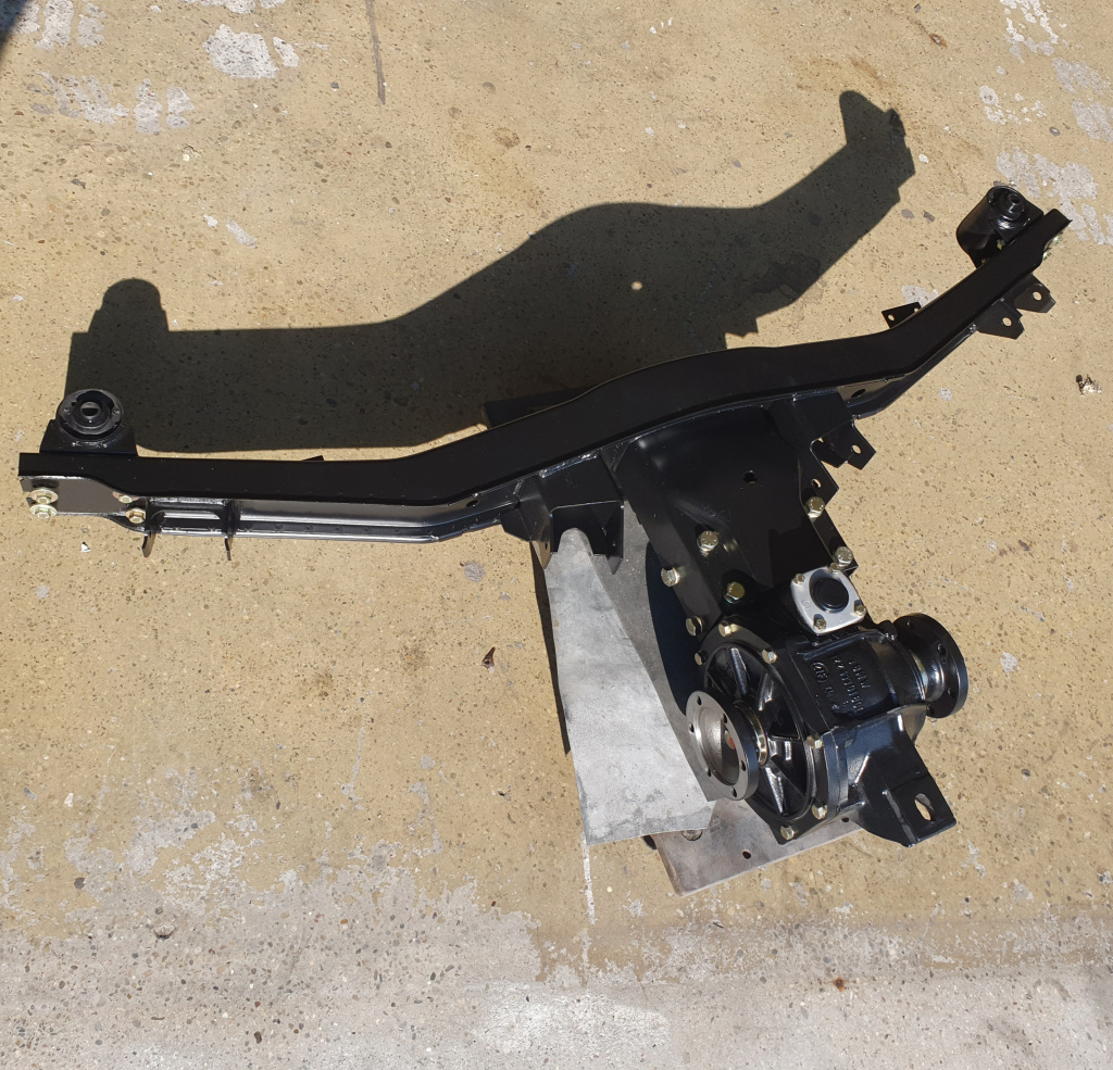

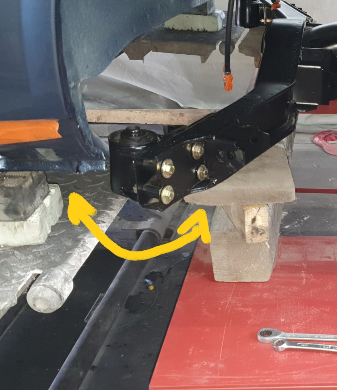

Motor and front axle back in they're place.
Let's go to the rear.

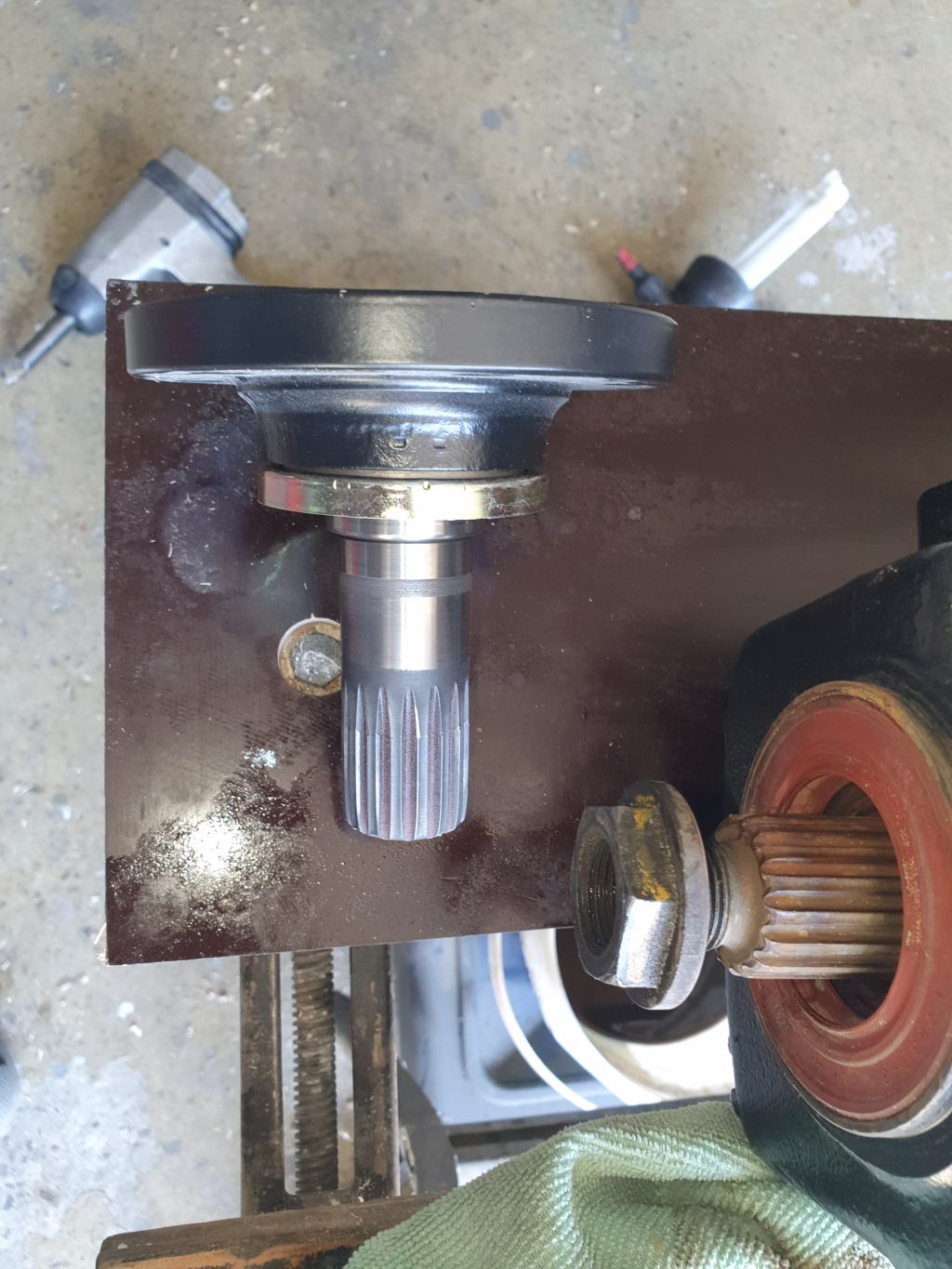

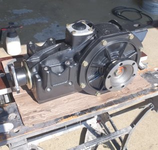

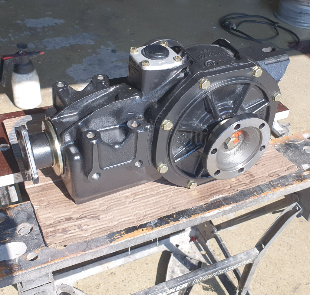

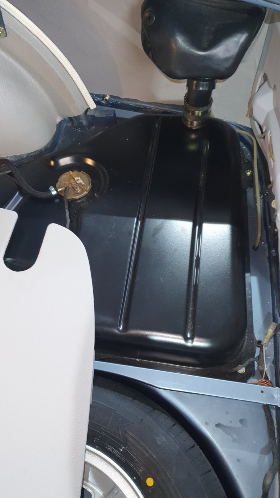

Diff. fresh sealed. 3.45 S 25%
The half shaft looks like new, another proof for the low mileage from the car.
Only 71k mls when I bought it.
Breiti

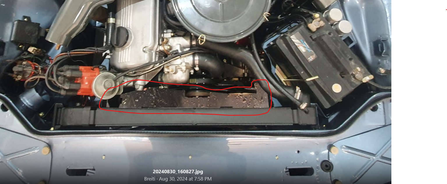

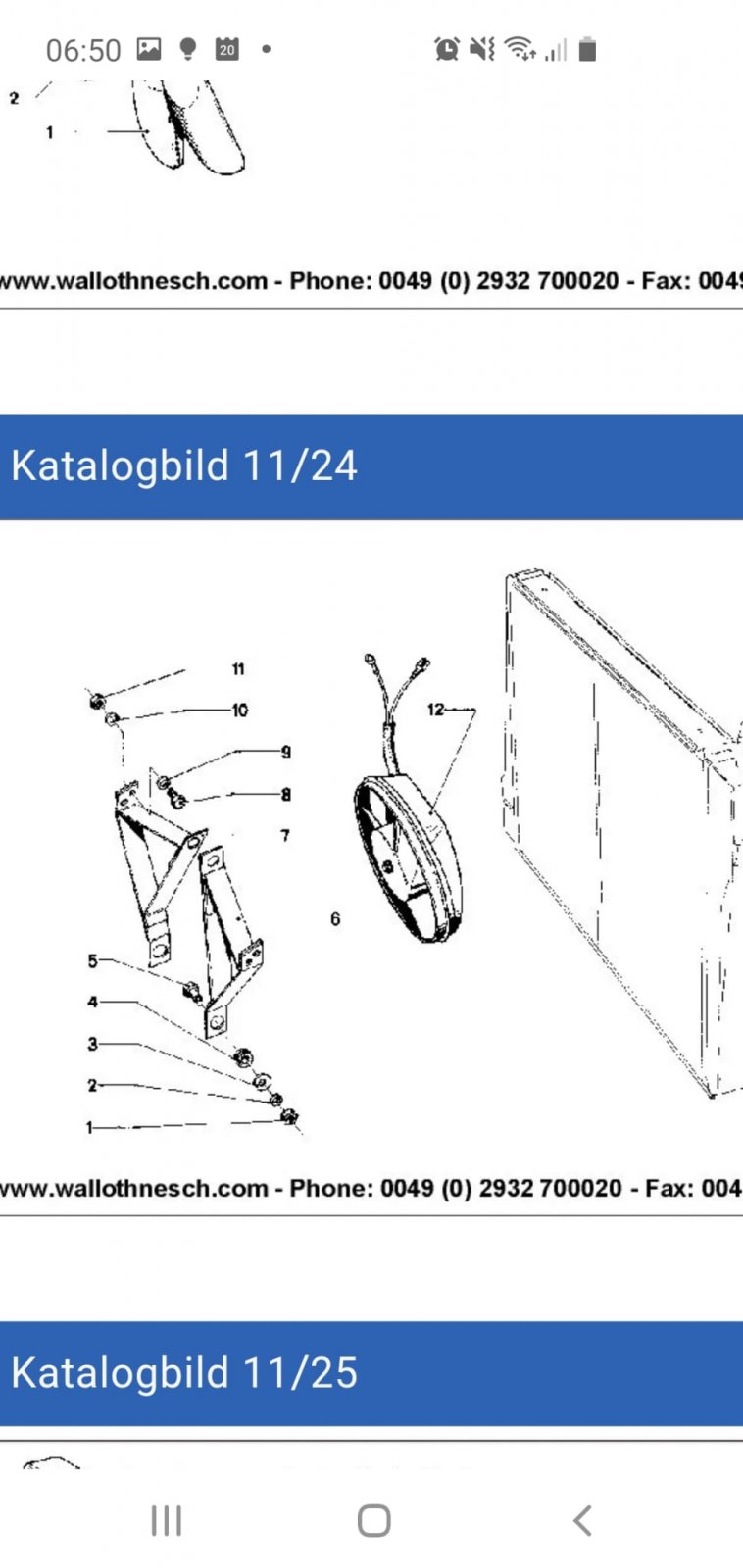

That is the original bmw fan?
Or did I understood the question wrong?

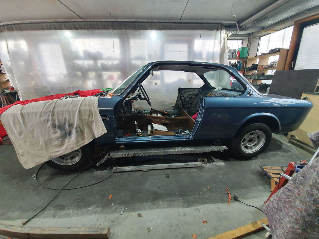

After a while I will share a particular of success...

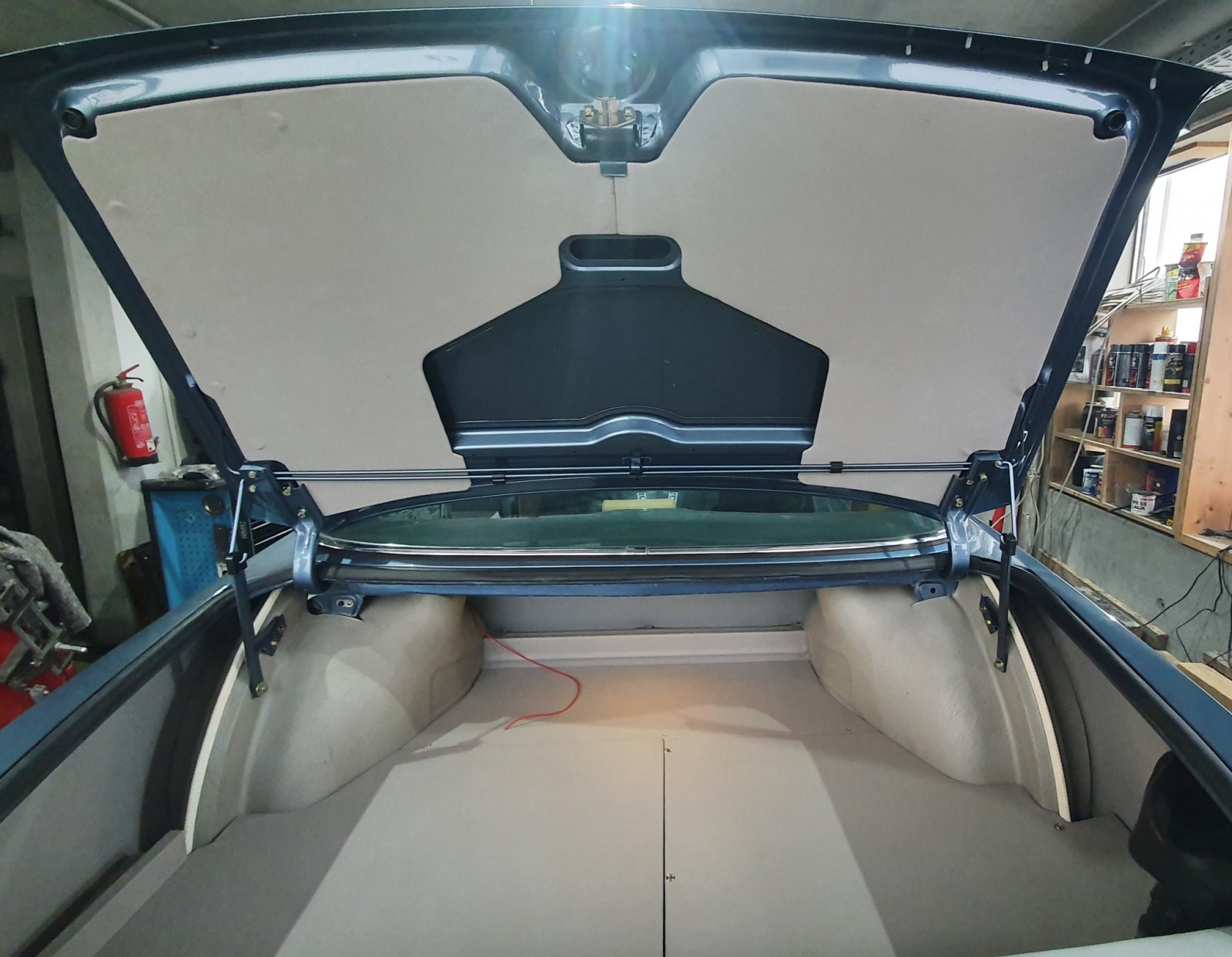

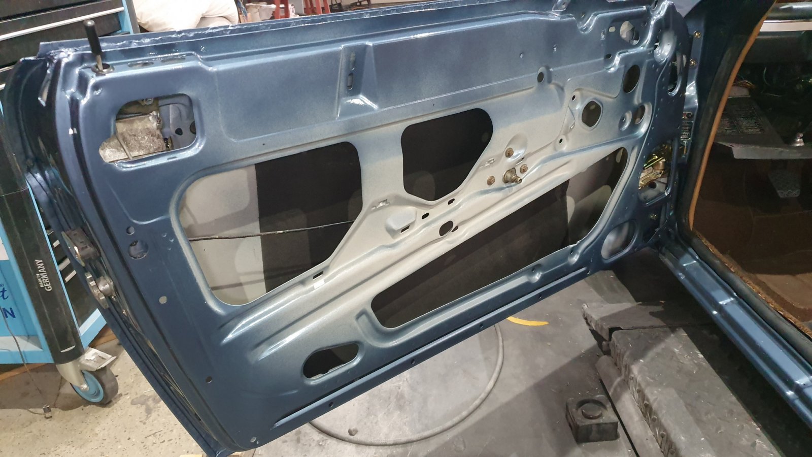

One side are finished.
The alignment of the windows are a nightmare. So much possibilities to align for trim and window.

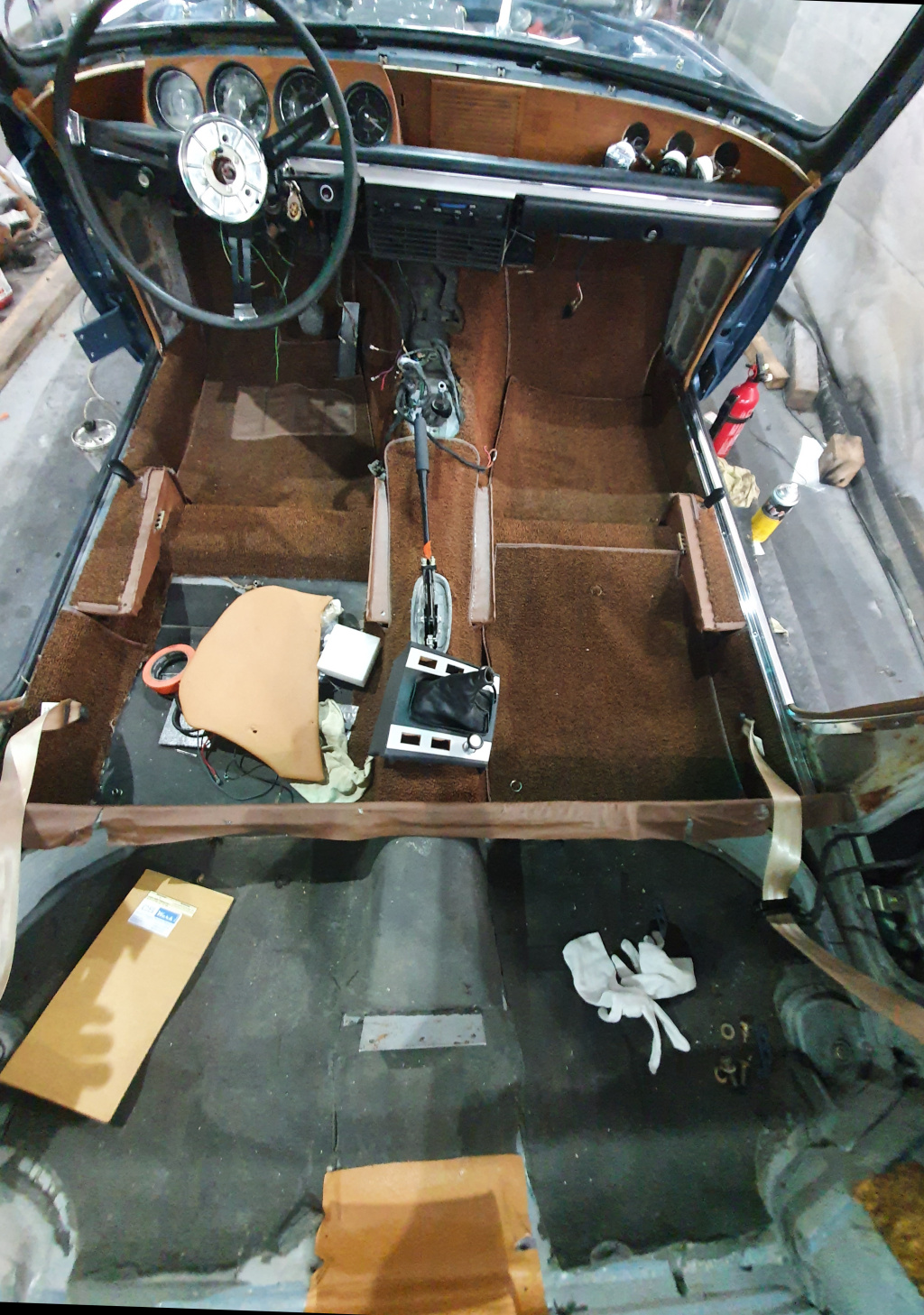

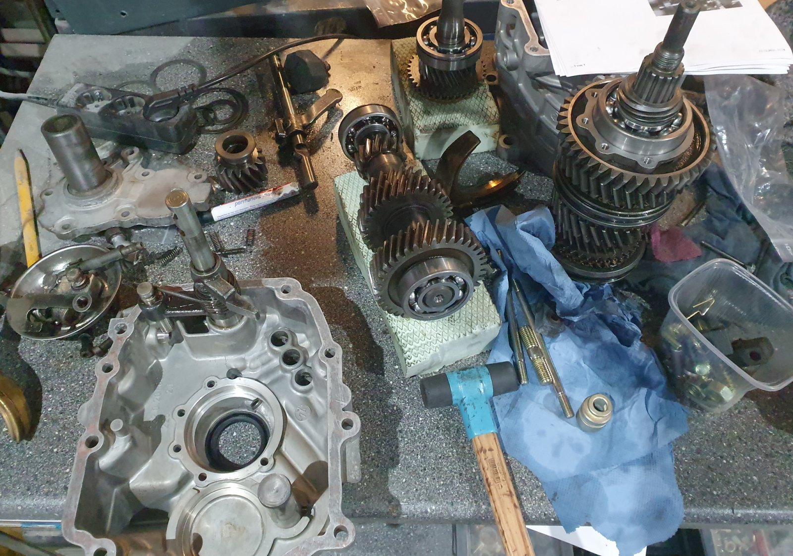

Unfortunately, I still fighting with the clutch. As you guys remember, I convert from automatic to shift stick.
Also I searching a long time at a wiper issue. No intervall and no end position.
Bought the car with that issue.

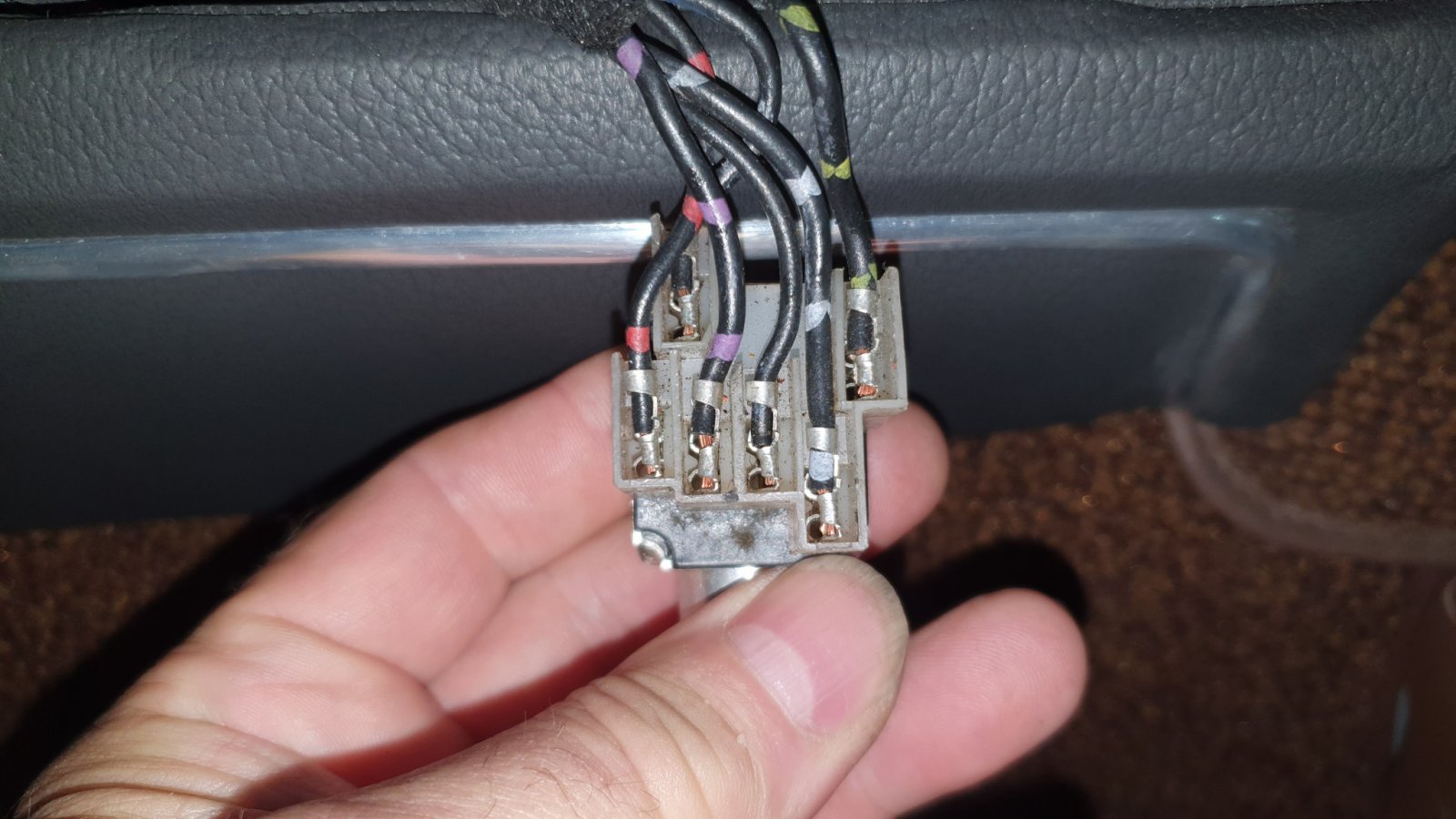

After a long search, I figure out, that somebody before me interchanged 4 wires in the intervall switch. Crazy
Breiti

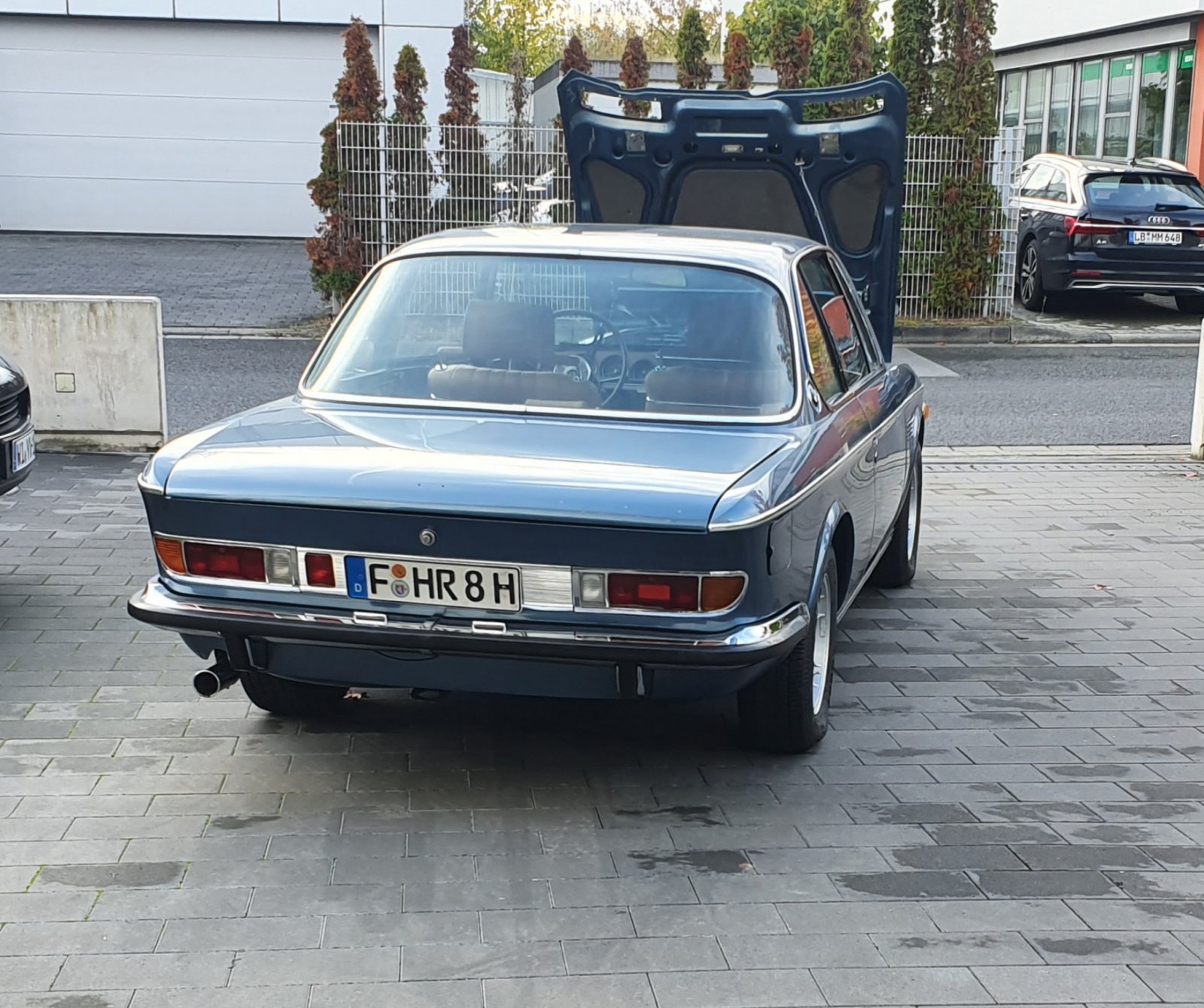

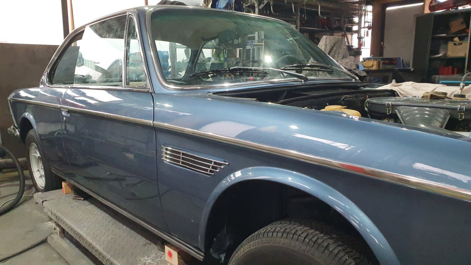

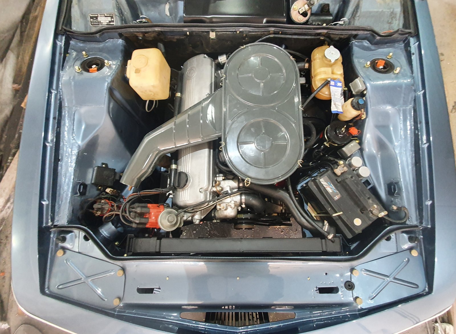

Since Friday she moves.
Not finish jet, a lot of odds and ends to do, but, she moves.
Don't found the hub covers in the mess...
Transmission works well so far, drive train also. (Shorten auto shaft)
Both has been knock down in the process, got auto trans bevor.
Breaks and clutch also works.
So, let's go to the final touch. (And found those f.... hub covers....) :-)

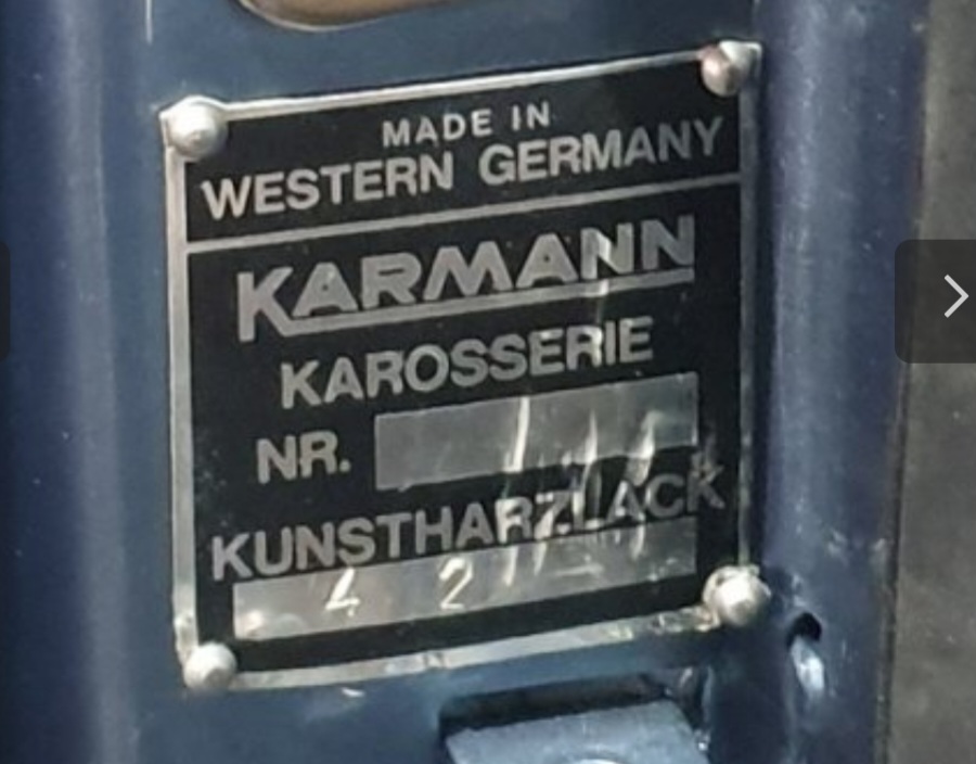

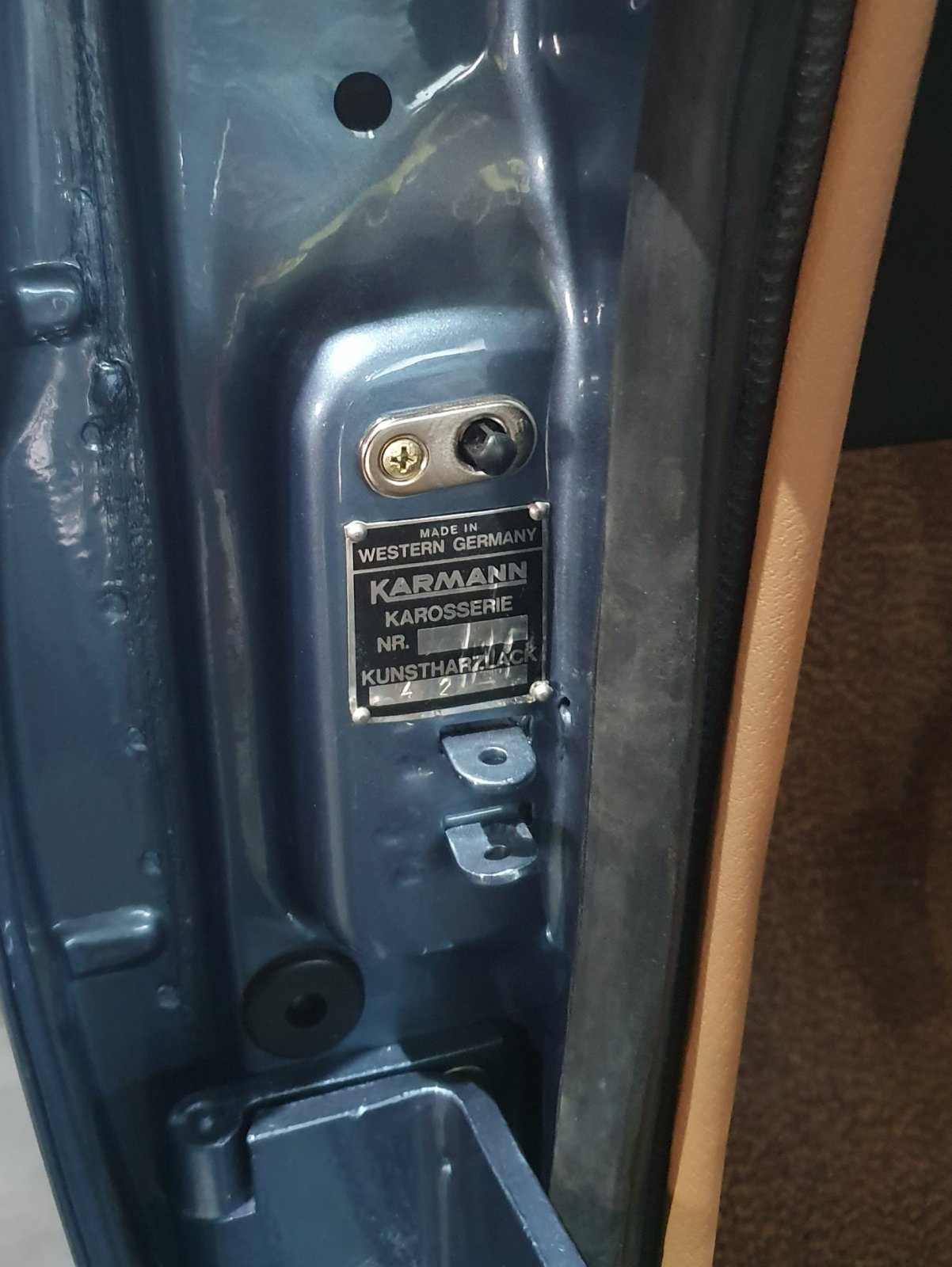

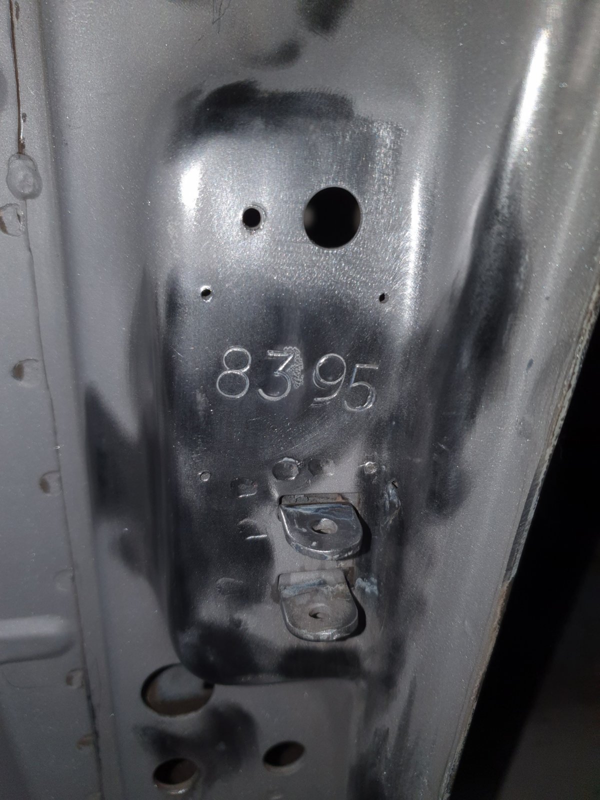

Question; did you remove the paint colurtab in the driver dooropening? It looks so nicely painted around it, that I think you removed it. But the rivets look like new; did you place new rivets?
If so, Where did you source them?
Looking good! Must be amazing to bring her back to life.
Quick, but still you keep eye for a quality job.
For sure, I removed it.
There rivets just a standard item.
Found them at ebay.
2mm x 6mm rivets stainless steel.
Unfortunately, in the years bevor, somebody hammered the door stop pin in with less patience... so the plate has 3 extra scarfs.
But that are patina.
