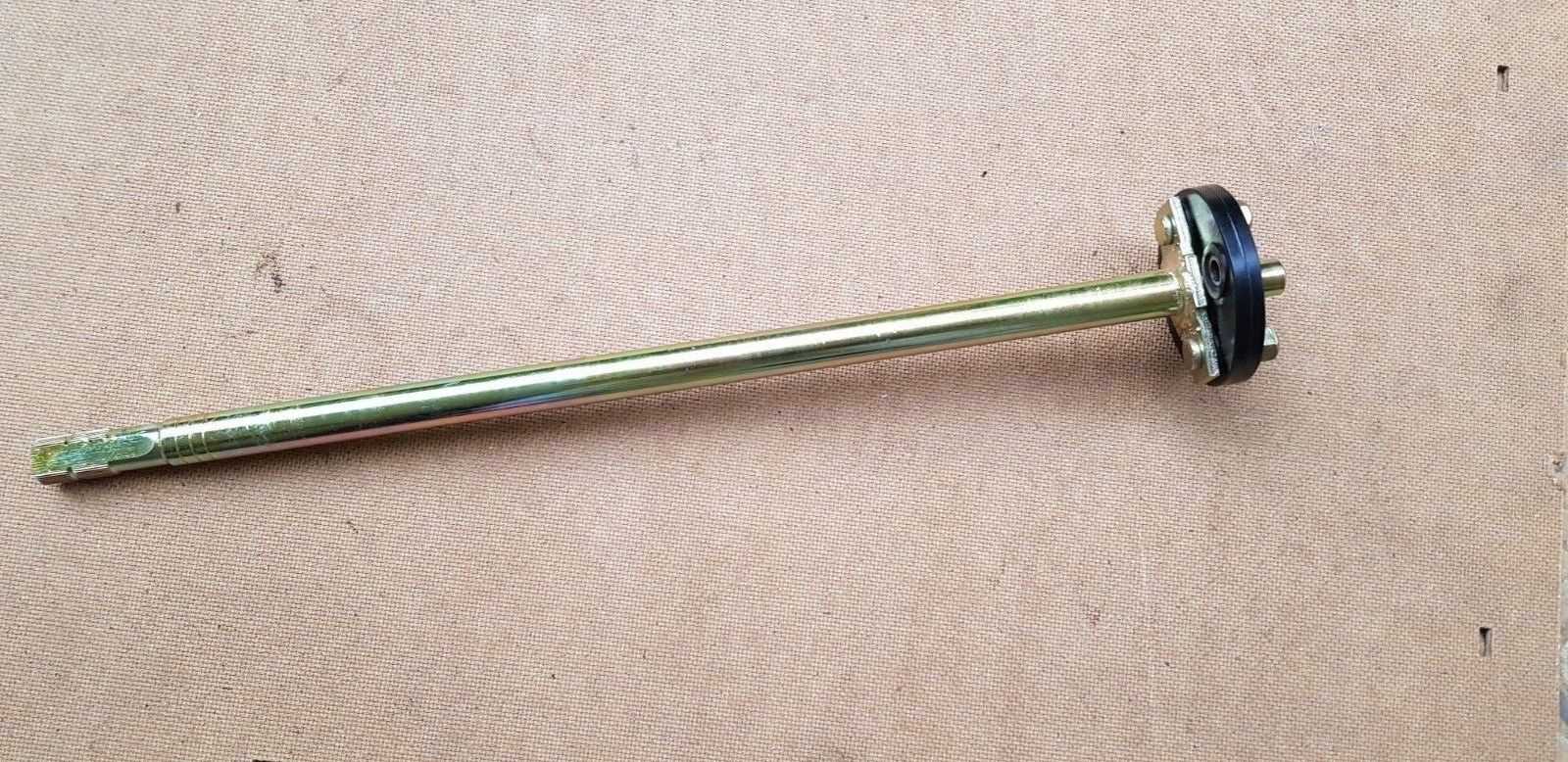

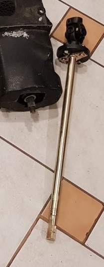

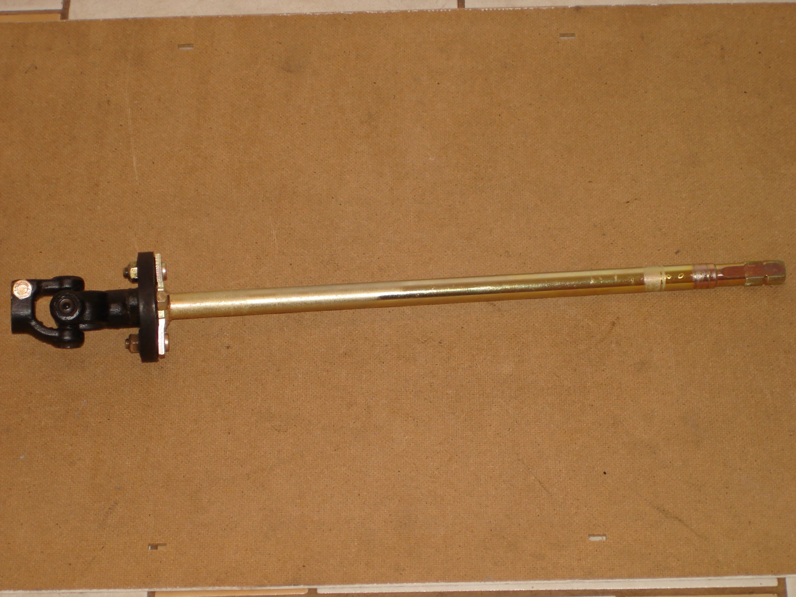

I'm not so sure with that grooves, take a look at my photo's of three different shafts, all three where from left-hand cars with hydraulic ZF & all three have three grooves on them.
A whole different thing is that three grooves shaft on your photo, look way different if compare to shafts from my photo's.:confused:

Not sure. That photo and text is from the blue book. The three grove shaft looks different because it is a RHD shaft. RHD cars have a collapsible section. I’ll revisit the blue book page to ensure that I didn’t screw it up. I don’t think that any non-uk cars had a collapsible section (not talking about 74 adjustable).

The problem with blue books is that most of the repair examples/instructions are showed on E3. And according to realoem catalogue E9 shaft from non-adjustable steering column are only for E9. With adjustable steering column E9/E3 are indeed interchangable.
32 31 1 107 706 - non-adjustable
32 31 1 111 965 - adjustable
That was my hypothesis on interchangeability. The e3 shaft looks longer but I haven’t found one free yet. If it is long enough I can have it resplined.
