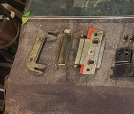

i have started to put in the door locks + latches. put a piece in, then take it out to get something else in. so for whoever has done this, what order would you put them in? i also have a question about the piece on the left. it has curved fork pieces that mounts so the latch to the right works between the forks ... question is, should the forks curve to the outer side of the door or the inner side? they will mount either way but i'm sure that one way won't work properly.
i guess that the lock and the inner handle assembly have to go on early, but not sure if its better to have the latch on before - i realize that the latch has to be on the outer side of the inner handle assembly so the spring works with the outer handle. and i realize that the lever on the lock has to insert into the hole on the latch. thoughts?

3. install the door latch fork piece (the item on the left side in the pic above). mount the fork with the tangs curved to the outside of the door.

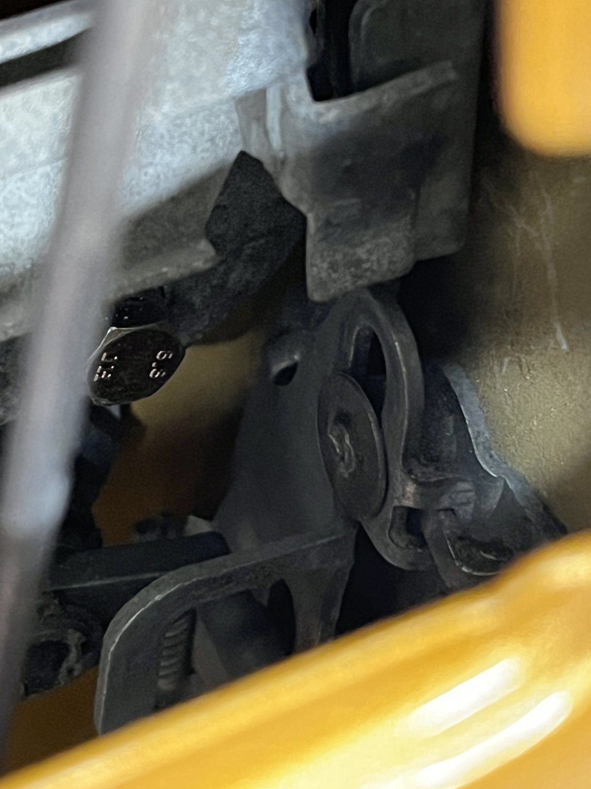

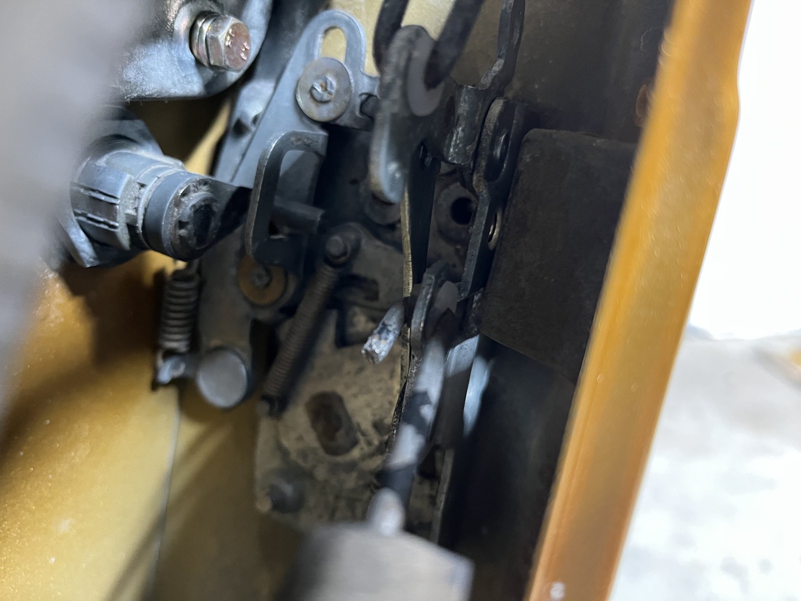

4. clean the door latch to remove old grease - i used Goo Gone, and it cleaned it up well and all pieces of the latch moved effortlessly. put new grommets into the 2 holes on the latch and a 3rd one into the arm for the inner door handle. install the tie rod to both pieces. install the door lock rod to the unlock lever. insert the latch into the door and use new stainless steel recessed / flat head machine screws (m6 x 12)
5. install the inner portion of the exterior door handle - mounts with 2 nuts / washers + lock washers (m6). be sure that the arm overlaps the tab on the latch.

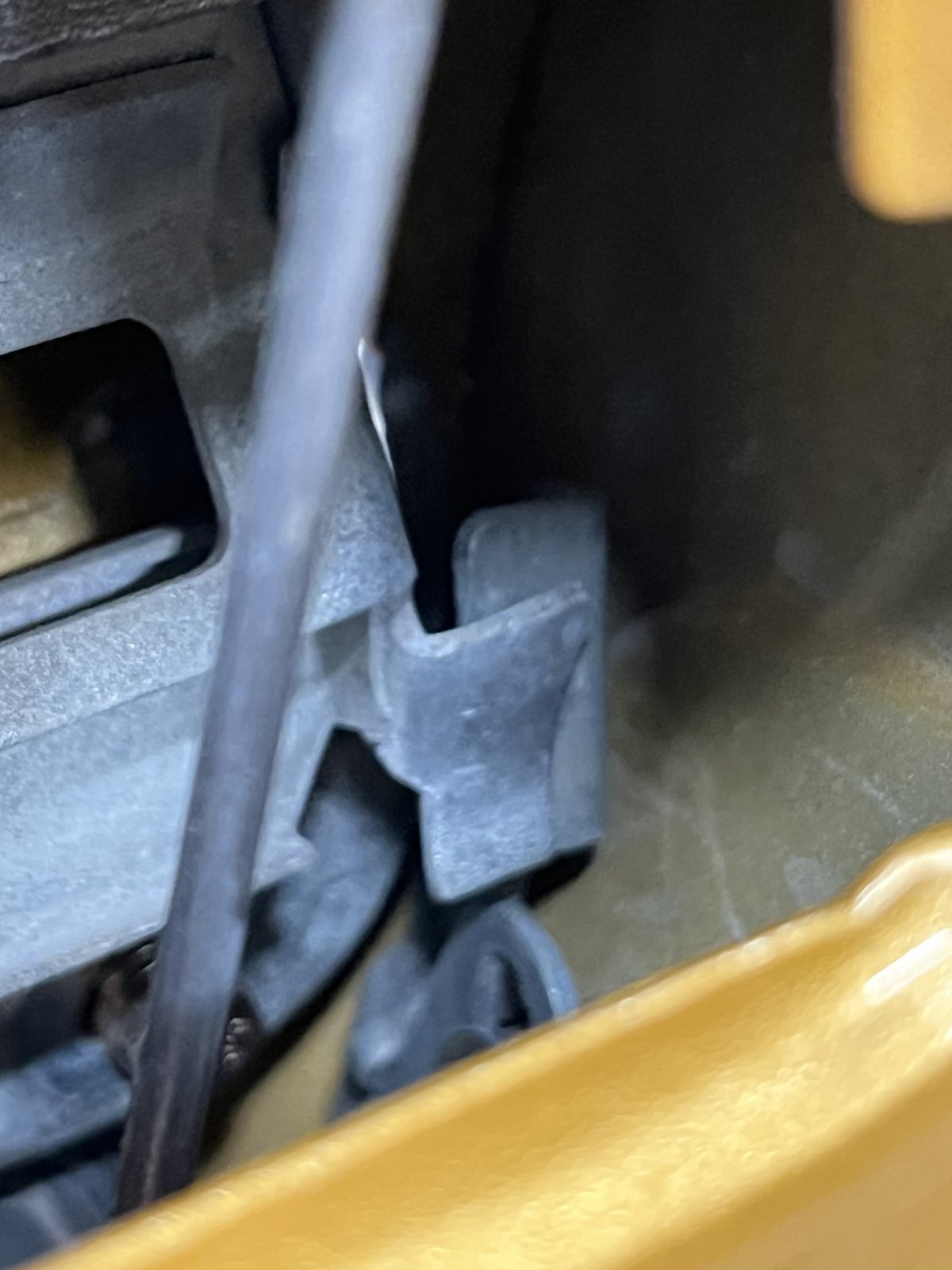

6. install new rubber stops into the door (from the outside of the door) on either side of the arms of the inner door handle. these are not easy - you have to work the rubber flange into the hole with a jewelers screwdriver, pressing it in as you push and go around. once you have it laying almost flat, use the screwdriver from the back side to get the rubber flange to seat.
7. bolt the arm for the inner door handle into place - the arm should move to the front of the car to properly operate the latch.

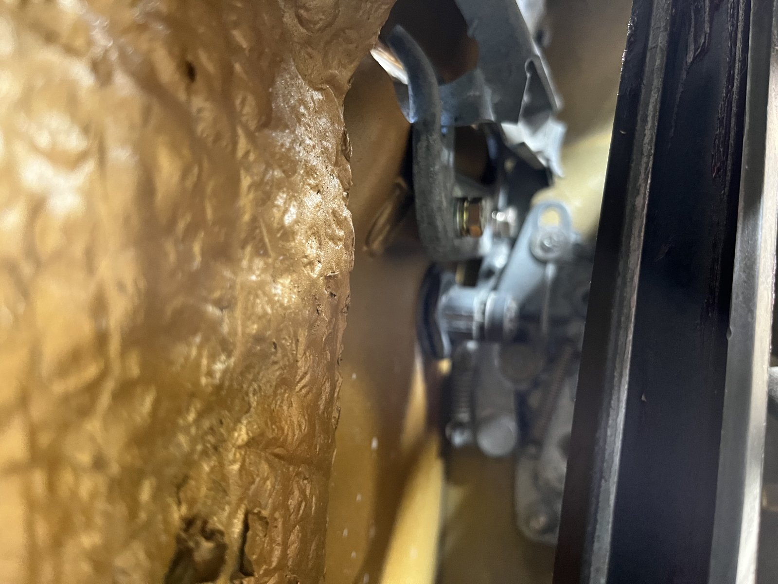

8. install the outer door handle - this requires a little patience. i put a wedge thru the top of the window slot to hold the inner door handle open - this raises the arms that go to the outside which makes it easier to mount the exterior handle. these use m4 machine screws with a phillips screw head - be sure to have a star tooth washer to lock it in place. once you get the outer handle on be sure to realign your belt trim.

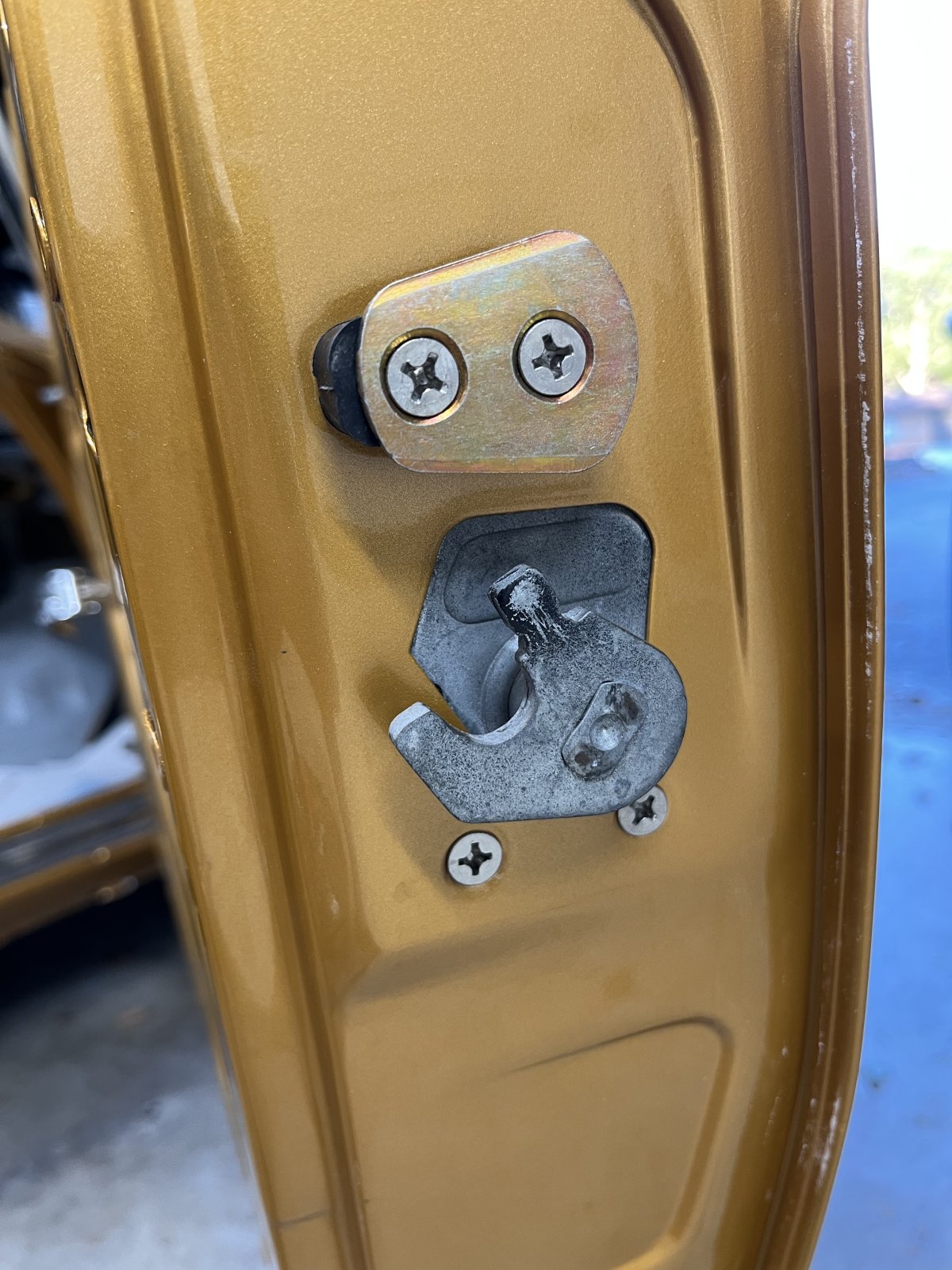

9. i still have to put the little sleeve on the latch arm. then you have to position the B pillar catch so that the door latches properly
