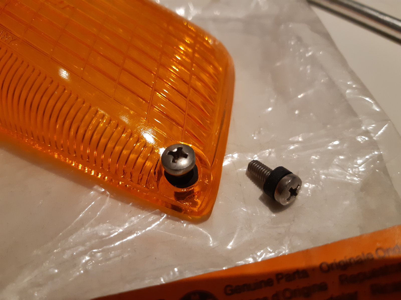

No hair splitting! These are the essential parameters that seperate the men from the insane. I'm clearly on the insane side: when you wrote that they existed, they needed to be found. So....

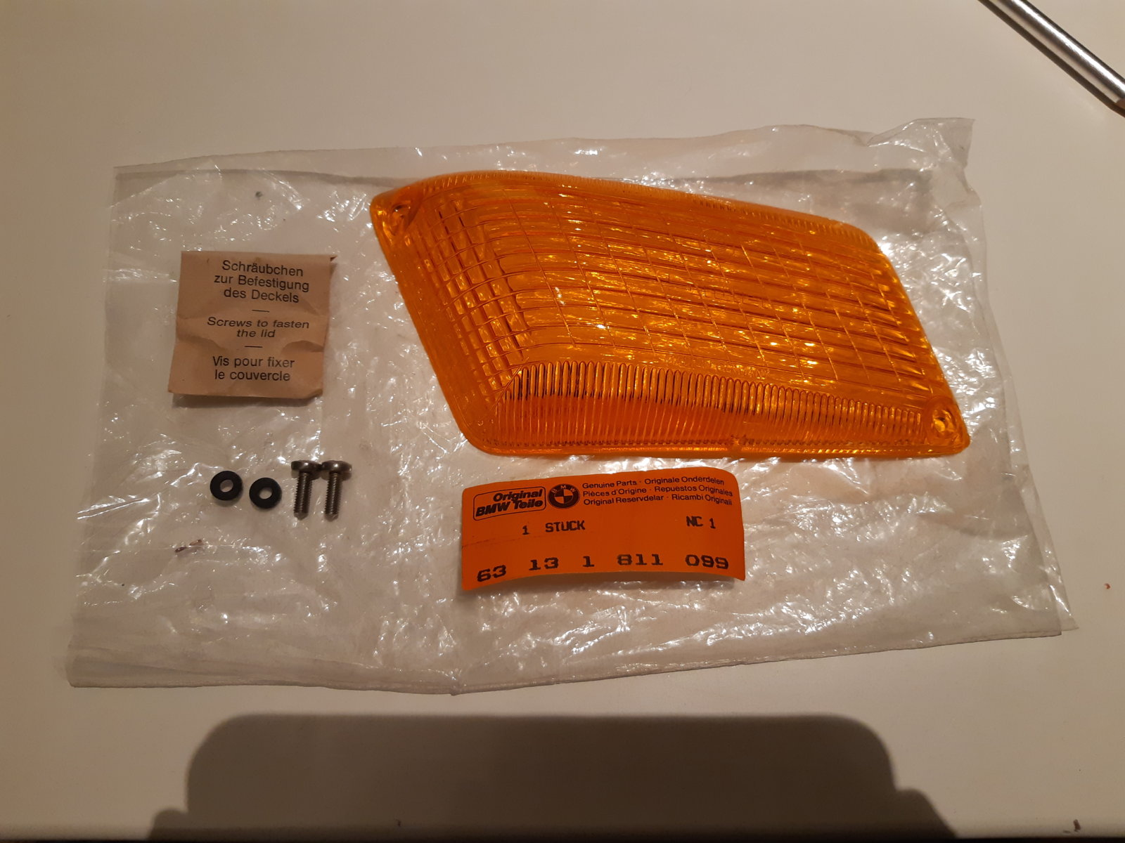

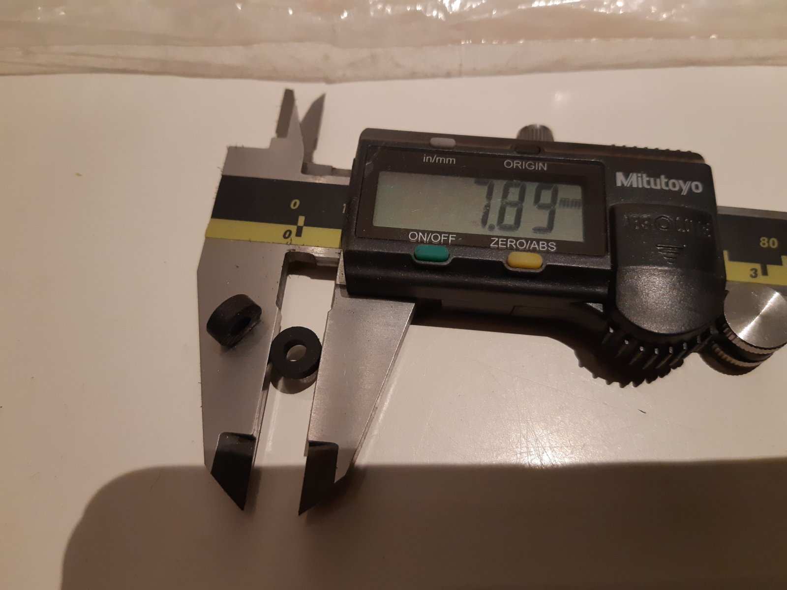

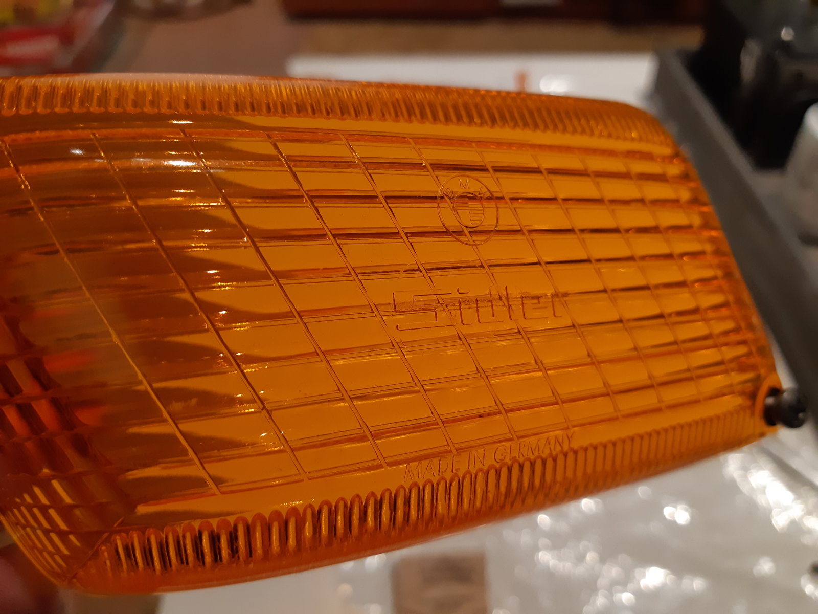

Found a NOS lens, original" Sidler " branded and it comes indeed with 2 rubber rings!
Flat style 3mm thick, 8 mm outer, 3.8 mm inner, (4 mm will work just fine).
Screws are stainless M4x12 with a Philip's (2?) Sized head.
Even more cool is the little paper bag with info in 3 languages. As if you would not know what they were when you got them out of the bag.
I just love how these things just find the light, after spending some 40 odd years or so on a shelf somewhere....

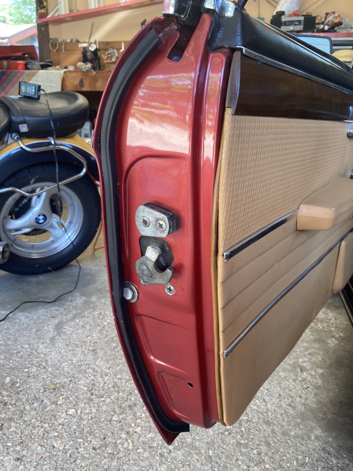

An oft omitted restoration detail is that door seal that goes inside the jam against the outer skin. Check some of the high priced sales on Bring-a-Trailer and you’ll see most are missing it. I can understand this as the seal serves little purpose.

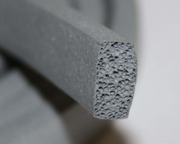

Checking out prices online for this PN (51 21 6 740 181 and 180), they were a bit steep, $85 to $165 each.
I found an almost identical alternative, PN 70-1111-73 from Steele Rubber Products, and a total price of $35 to my door for 5 feet, which was enough to do both doors.
Yup, not original, but if you look VERY closely at my car you’ll find a few parts from JCWhitney, and some adapted from E3 parts.
Now if Steele only made comparable door, trunk, and engine compartment seals.......
