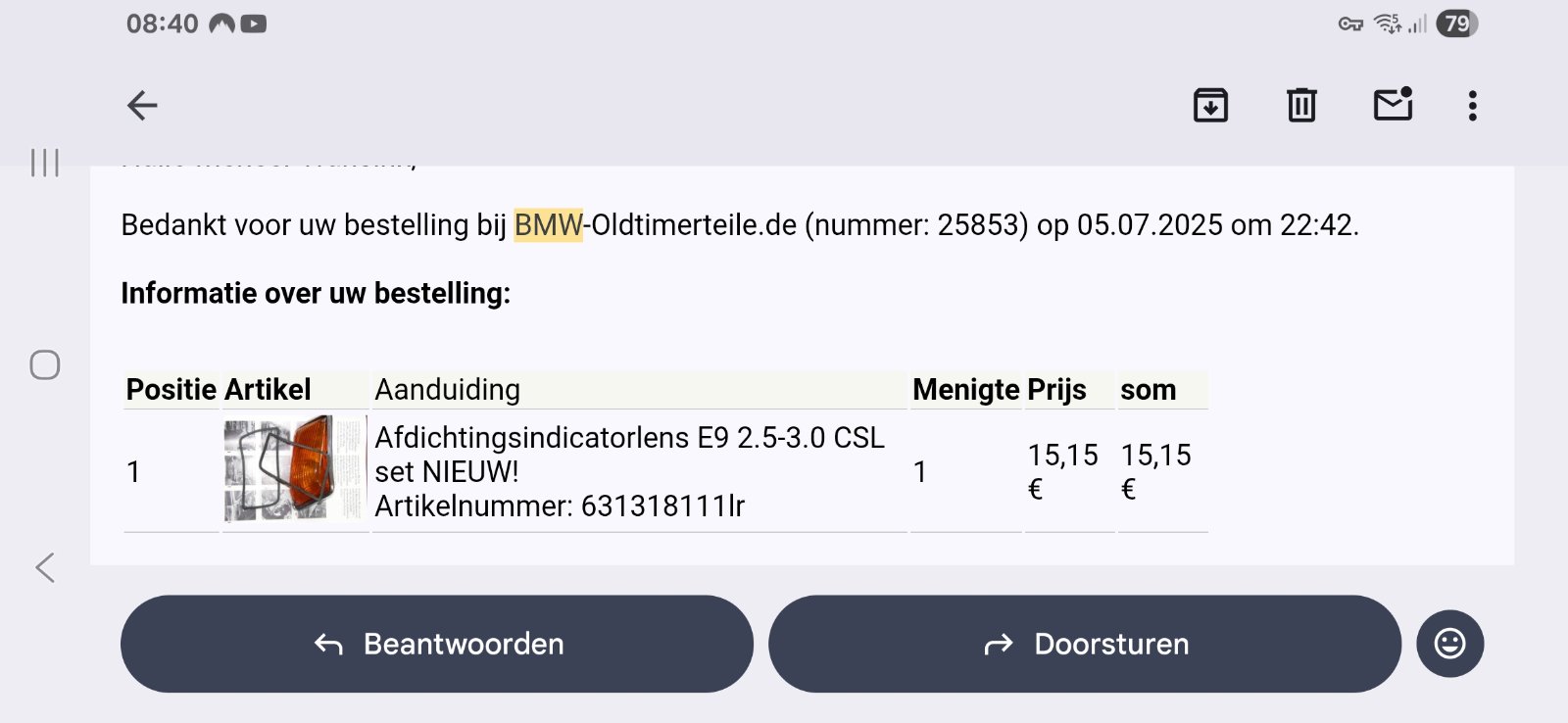

Front turn signals actually have two seals; one between body and chrome base (which I think you already have pic of), but there also is a rubber gasket that seals the lens to the chrome base. In the attached pics (From ebay, it's for sale for a dump ass price of @ 600 usd...) you see the body rubber as a separate part, and the rubber between chrome and lens is still in place inside the chrome base.
i am circling back to this post - i have looked and cannot find a part number or anything referencing the inner rubber under the lens for the turn signal. my car did not have them ... but that's not to say that they didn't turn to dust before i got the car. has anybody else seen these pieces? if they are supposed to be there, perhaps @alprada70 can make us some.
Is this Scott's?
Alvaro, the one you make is the one that goes between the housing and the body ... and it fits GREAT! the question is about a gasket between the housing and the lens, which would be smaller and thinner ... but like i've said, never seen one before.

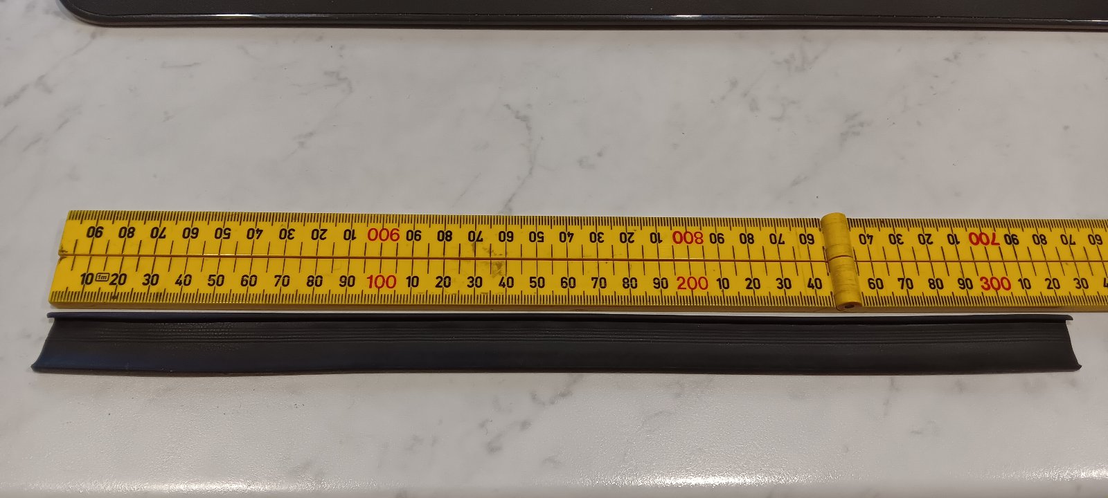

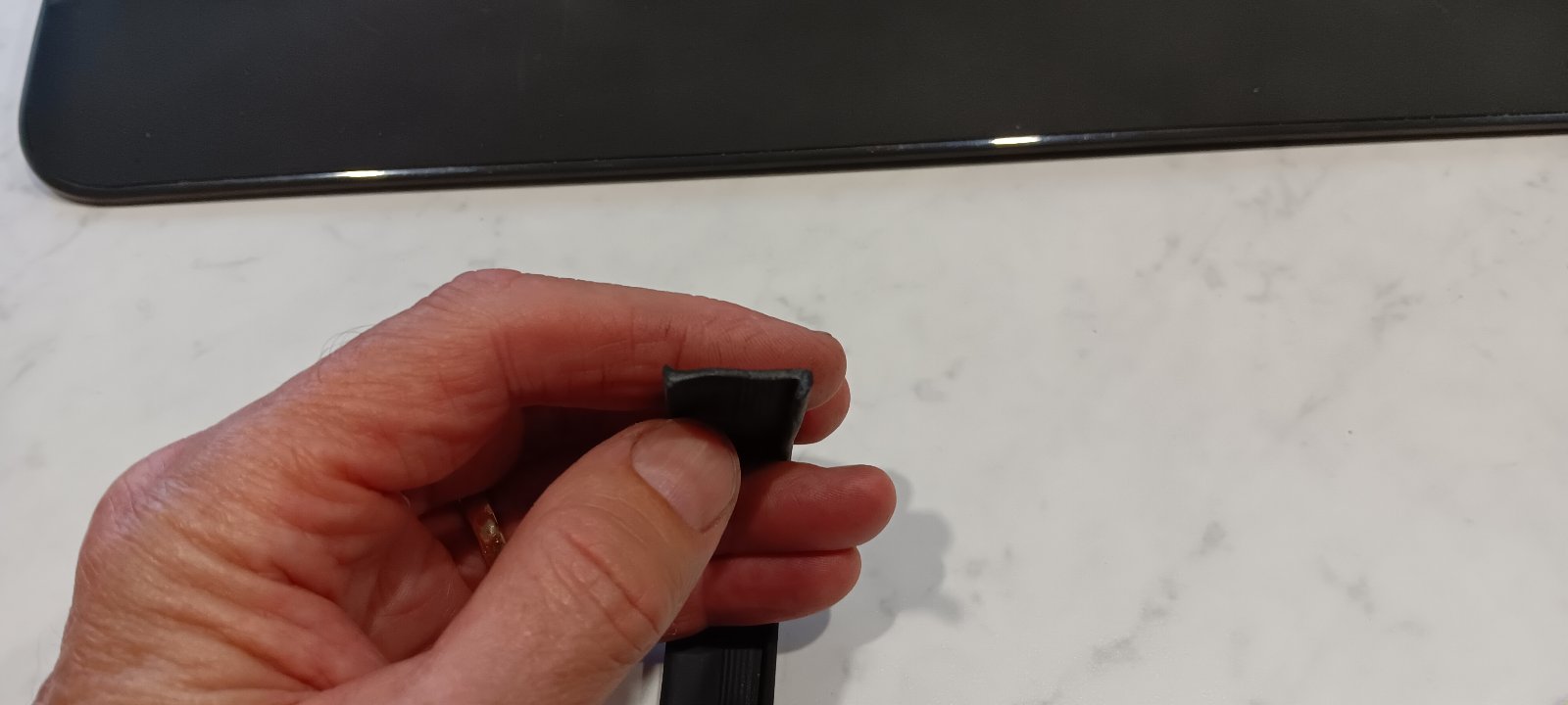

Hi All,
Great content, so thanks for a great resource. I am trying to identify the rubber seal in the pics. They (2) are 325mm x 19mm. Thanks in advance for your interest.
Thanks for the impressive reply rate; WOW. Yes to all. I believe it is that seal (oem 51216754323 / 4). I have found that the length is subjective in that many seals I am replacing are a little longer than required, so are trimmed to size. I found this with the leading edge seal to the rear quarter glass (what a joy that was to fit).
