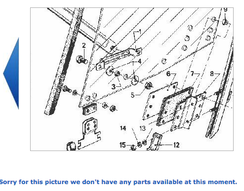

# 3 and 4 are NLA. I just took my door apart and there was nothing there but the bolt/nut. Assume a simple alternative exists to these? I can hunt down rubber washers but composition and thickness are probably important.

I have a bunch of rubber washers but not sure what you need. I can send them all to you and take what you need and return what is left. I think they are new. I will need your address.

# 3 and 4 are NLA. I just took my door apart and there was nothing there but the bolt/nut. Assume a simple alternative exists to these? I can hunt down rubber washers but composition and thickness are probably important. View attachment 62518
dear Bob,

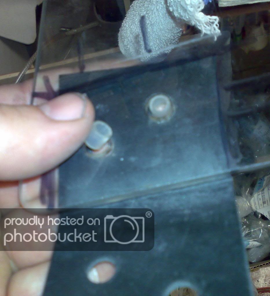

not anything will be usable, please lets be more precise, 3 is plastic, 4 is rubber
it is most important to use number 3 as it is a way to ensure that you will not break the glass, a piece of hard plastic tube of a similar size will do, i did use a tube and cut it to the size, just the thickness of the glass +2mm
a similar tube goes in the front holes too, here in this pic you can see them in transparent plastic, original on top, replacement in bottom
check my thread on the topic,
https://e9coupe.com/forum/threads/r...bbers-clean-and-regrease-of-mechanisms.13485/
as to the washers they are pretty wide, see them here, the tubes are already in place in the glass
if you can not find i can prepare a set for you, but i will need the dimension of the holes.
