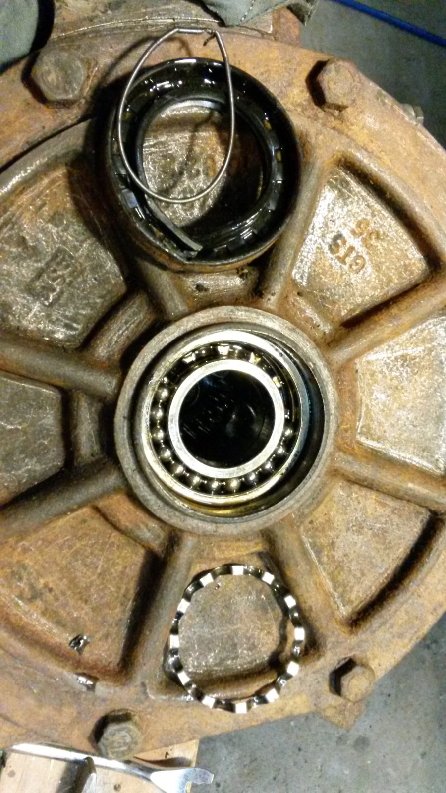

It does need to have the half shafts dismounted for it. In my side bearing I found a split (broken) ball retaining ring:

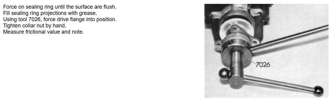

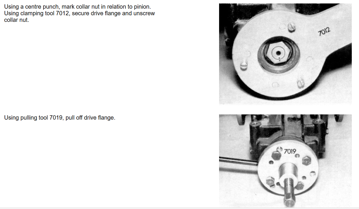

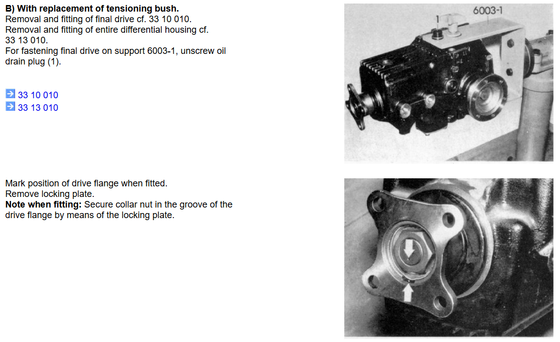

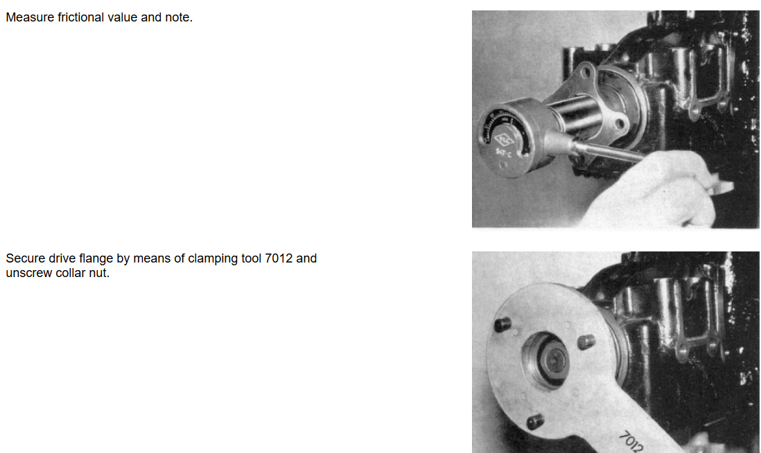

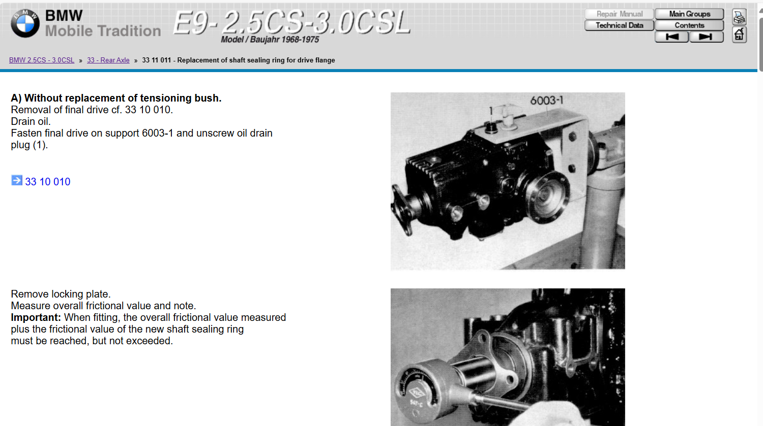

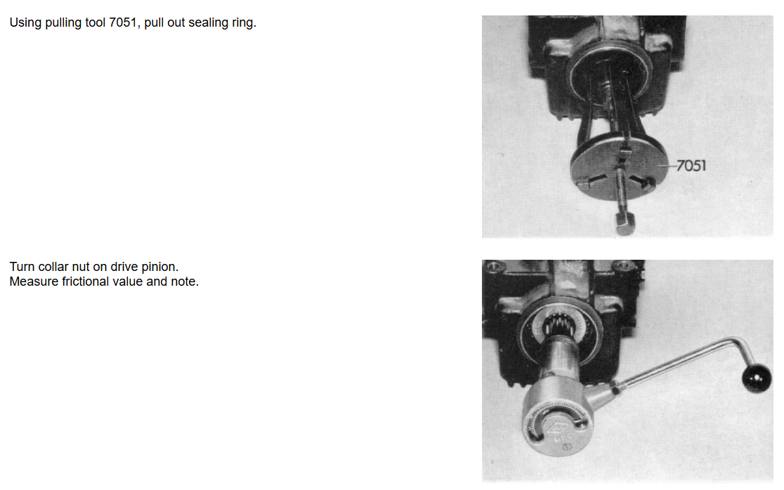

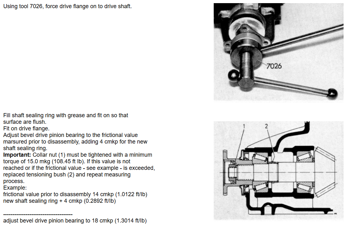

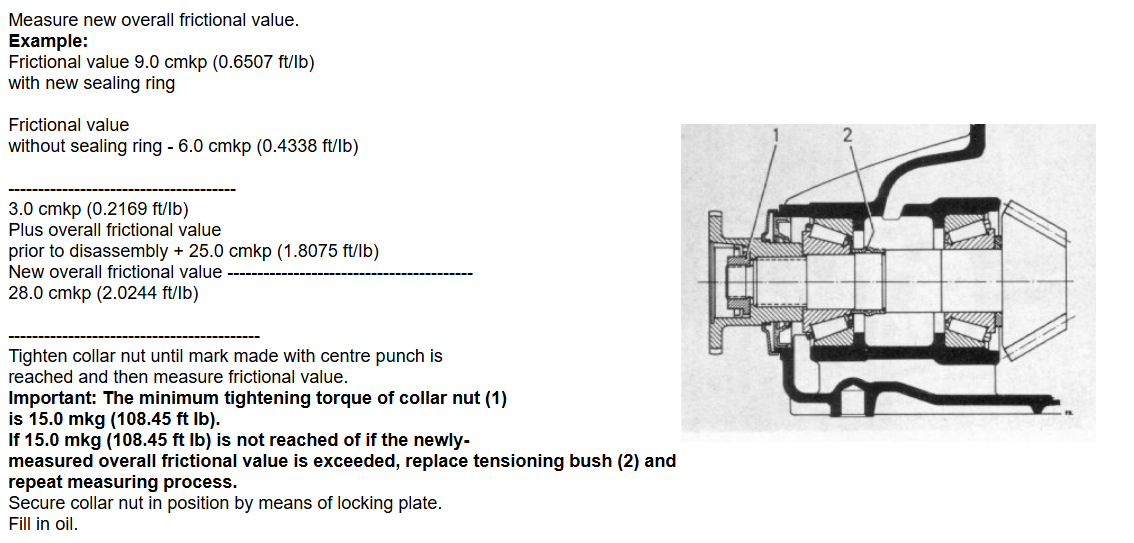

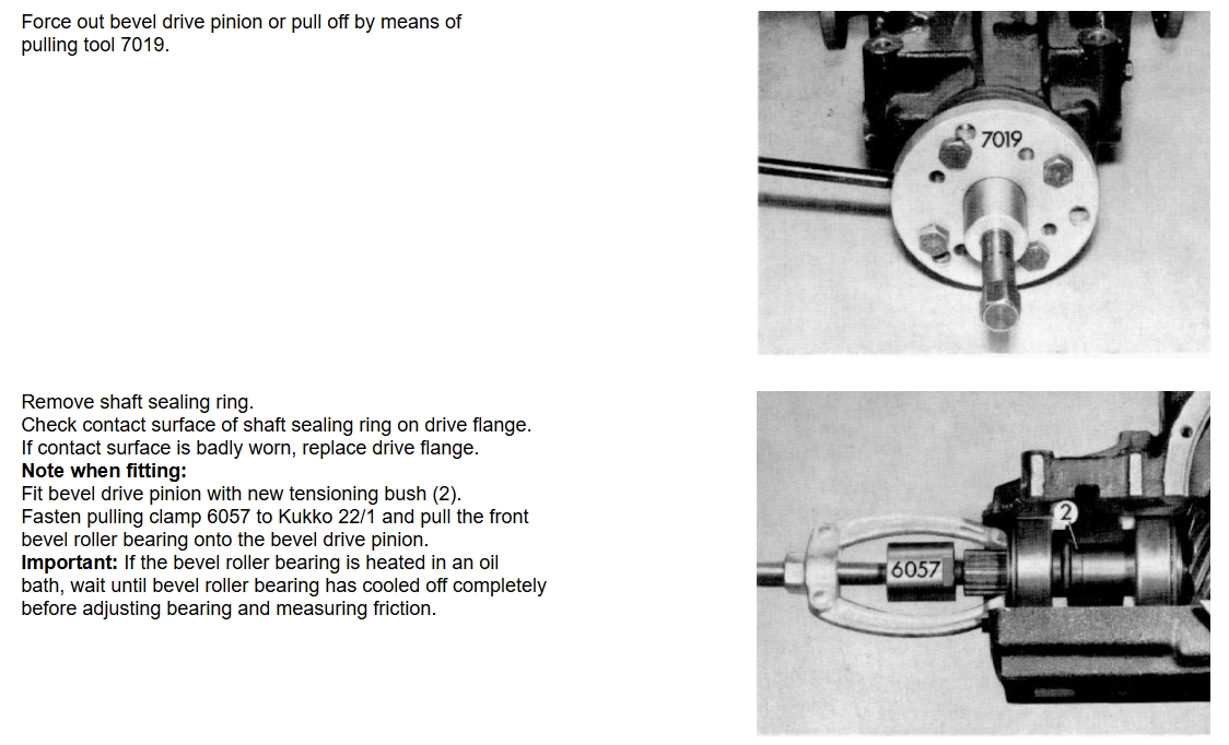

The bearing of the pinion wheel (the one in the direction of the drive shaft) isn't easy to replace as it requires a precise pre-load setting to be achieved through a crush washer that needs a precise torque and friction measurement in order for the pinion gear to match to the diff perfectly. The workshop manuals ("blue books") contain a detailed procedure for it.

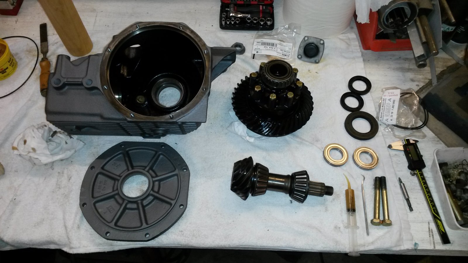

Here's my diff, pulled apart. I went for the "fingers crossed" option, keeping the pinion bearings and crush washer.

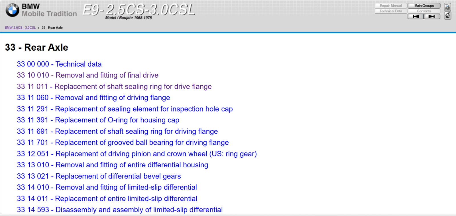

I also see that i bought a O ring from the dealer - check via RealOEM which bearings and seals parts there are, replace all seals.

Erik; You cannot re-use the crush washer. You can reuse the shims if they are put in exactly where they came out, but you will need a torque wrench capable of measuring small torques (inch pounds here, I guess Newton-centimeters there). Before you put the ring gear in, you will torque the pinion nut a bit at a time until turning the pinion shaft requires some specified small torque.
