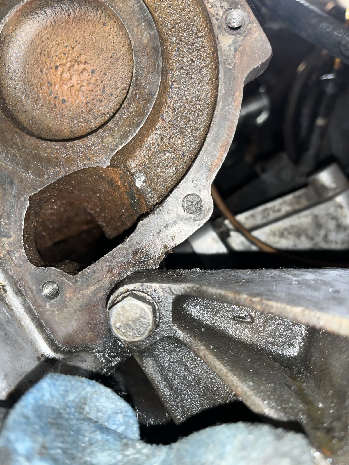

@boonies - I am now in that misery zone. Extractor tip snapped off inside the hole I made. Have ordered some tungsten carbide drill bits to get the sucker out. What a pain in the a$$ - would feel like I have accomplished more for all the hours if it were fixing a more complex issue lol!
Pic of snapped bolt
Assume there is either poor access or nothing to work with on the other side.
Can you cut the old water pump and clamp the part that goes there so at least you have a guide hole to work in instead of working with a flush surface?

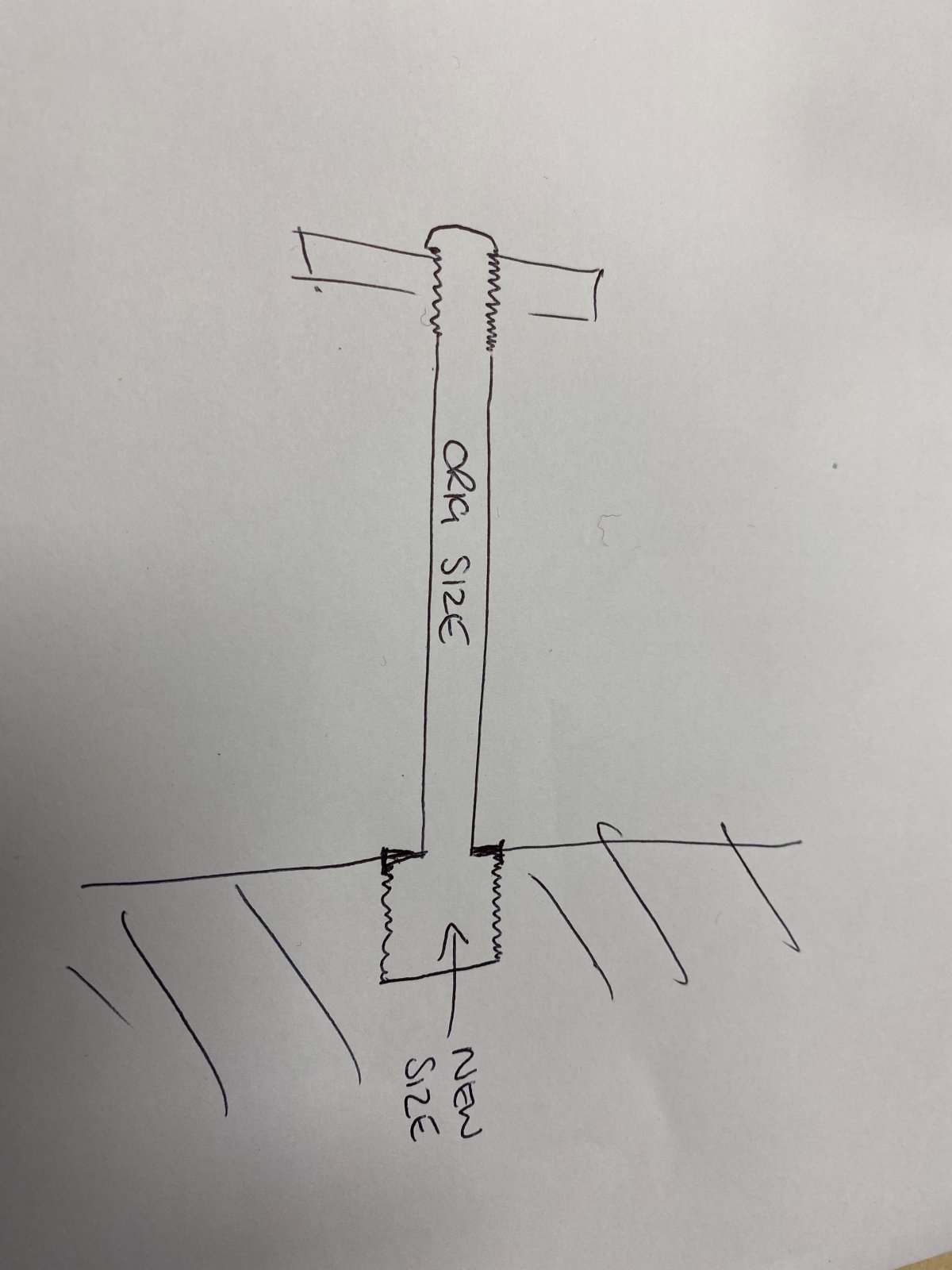

If everything you have tried has failed, and you make a mess of the original threads in the block trying to drill / pick etc – all is not lost.
I had this issue with an aluminium casting (UNC thread) with steel stud that broke off below the casting….
I did everything – but restored to drilling it out in the end
And I messed it up drilling out the stud off centre and caught some of the existing threads!
Drill out as best you can the stud, – you will find that once you have made a sufficient non centred ( by mistake) hole you will be able to pick out the stud remains but you will maybe have damaged the existing threads.
Drill out the existing hole to the next thread size and re tap – so if it’s a M8 go to M10 size.
Then go to your local engineering company and ask them to make you a stud the same size but at one end a bigger thread (or your mate with some bar, a lathe and some taps and dyes)
Like the picture below….
PS you may even have the new bigger end in Imperial thread size if you fancy…
You may just getaway with it if you are good at drilling by running a tap through it and the bolt still will have grip.
The only other option is to helelicoiling.
Hope it helps.
Marc

Thanks Marc
Yes as a last resort I’d drill a bigger hole and use a larger bolt with the right length this time!!
Tungsten carbide bits arrived today and will give them a try
