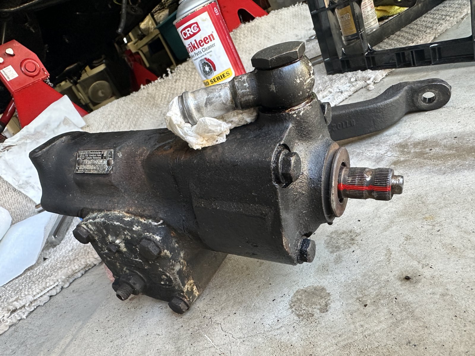

Shaft seal on hydraulic steering box

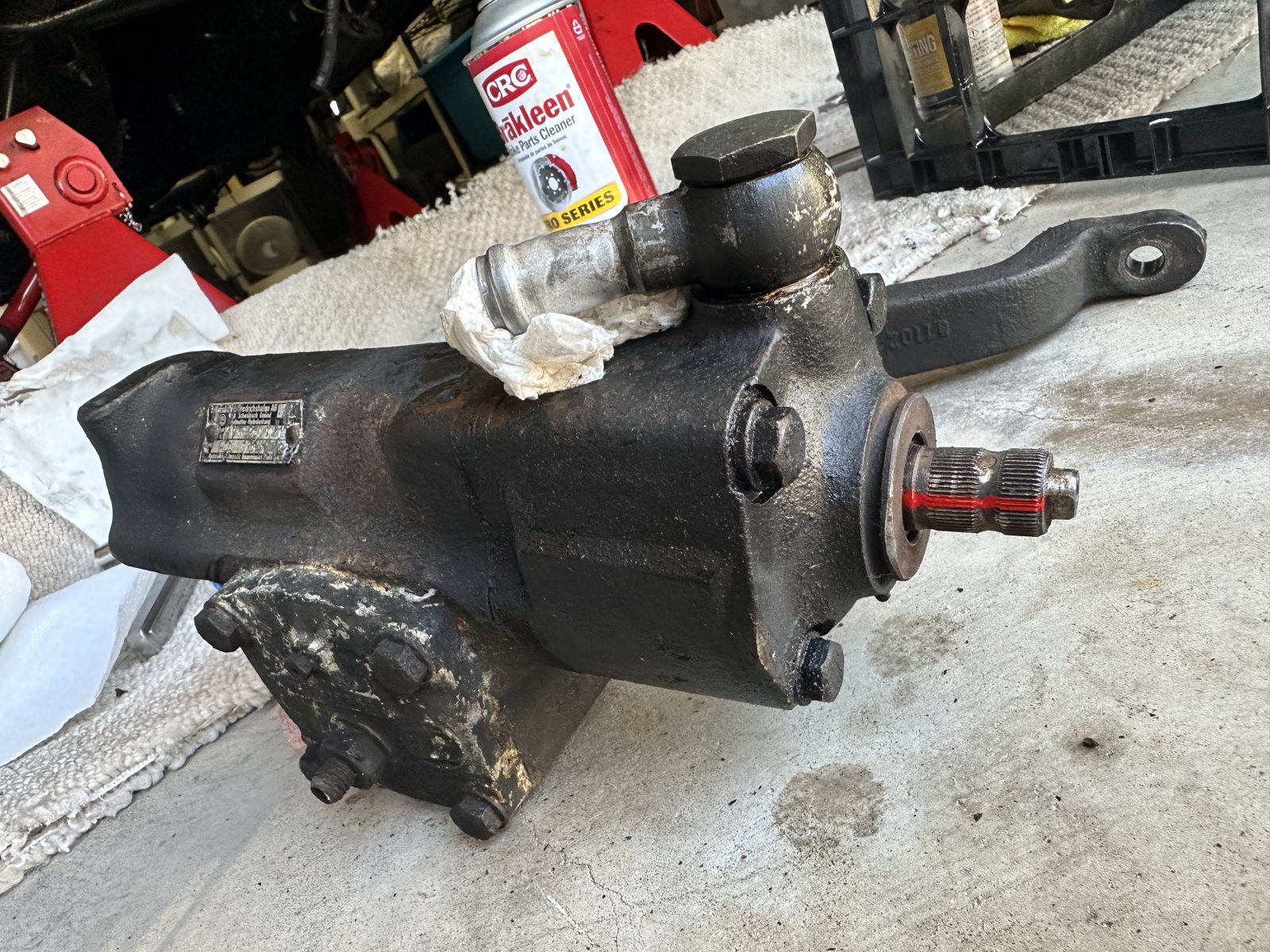

Well I pulled this out of my car today and I can definitively say there would be NO WAY it would have come out with the engine in place. The three bolt mount holes were rust-welded onto the dowel pins, as was the u-joint. Took 3 hours of sitting on the ground in the empty engine compartment with penetrating oil, blow torching, hammering and chiseling, and lots of cussing. It finally separated.
So now I’m wondering if the seals can be replaced DIY? This thing probably weighs 40 lbs so on top of $400 for it to be resealed by Jay, add another $200 for shipping there and back. It’s not leaking now but I bet it will start shortly after the engine goes back in.
Someone talk me out of this and just tell me to send it off. Next up, off with the master cylinder.
Oh yeah. That's how it works. No symptoms in a 50 year old, oil reservoir, piece of car, when access is optimum. Try to ignore best chance of rebuild before everything else is put back in the way, at your peril. We have all been there before. And I am sure this is why you ask. Better to bite bullet now, because we know how this movie ends if you try to just reinstall and hope for the best. Best of luck Steve!
After getting dizzy looking at the realoem diagrams and reading above about the needle bearing boobytraps lying in wait, the red flags are up. I’ve emailed Jay, no way I’m opening up this thing.

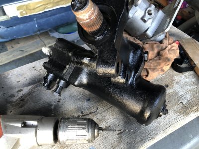

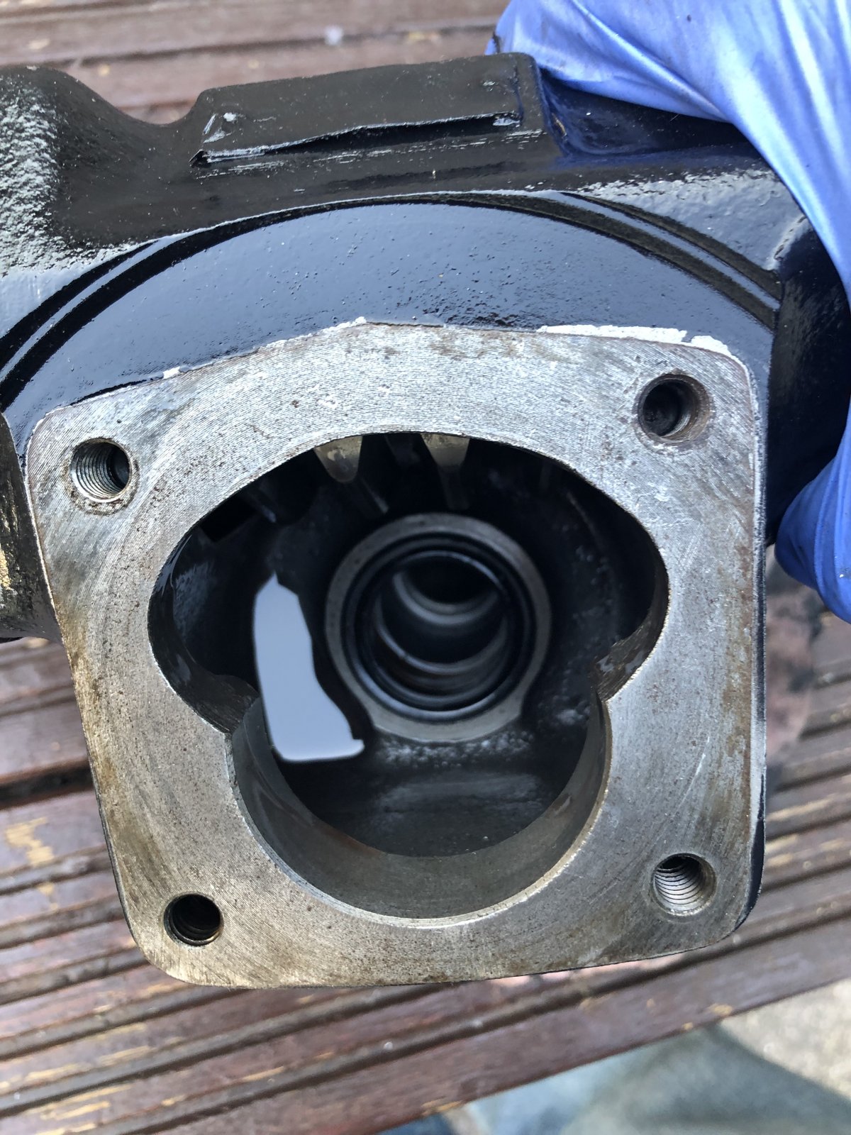

Hi guys

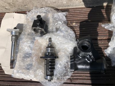

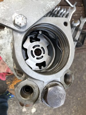

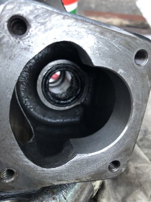

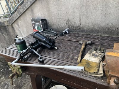

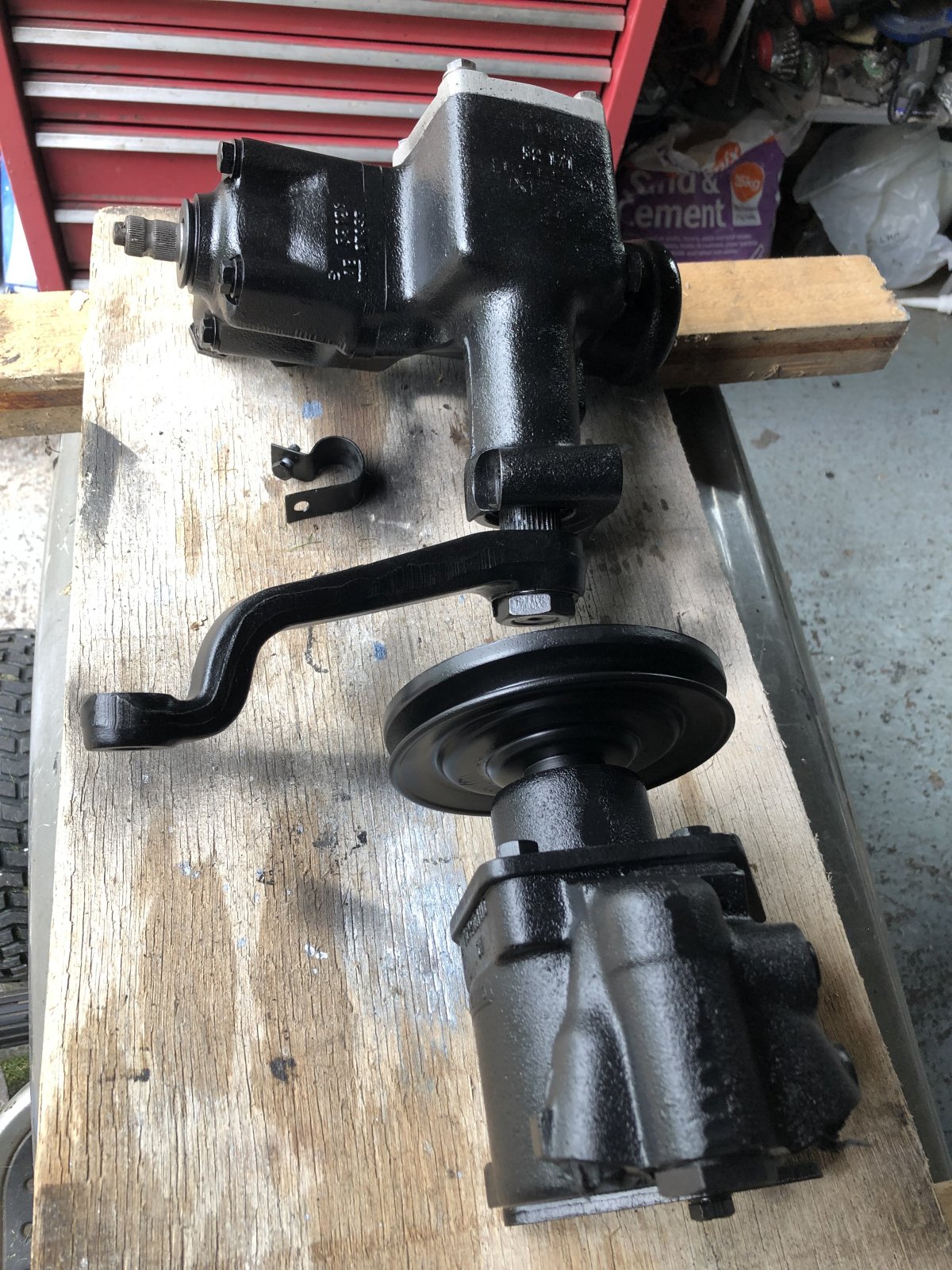

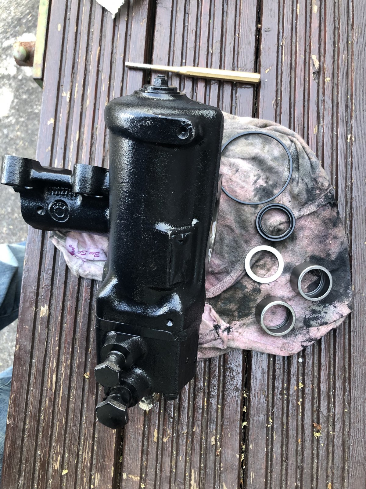

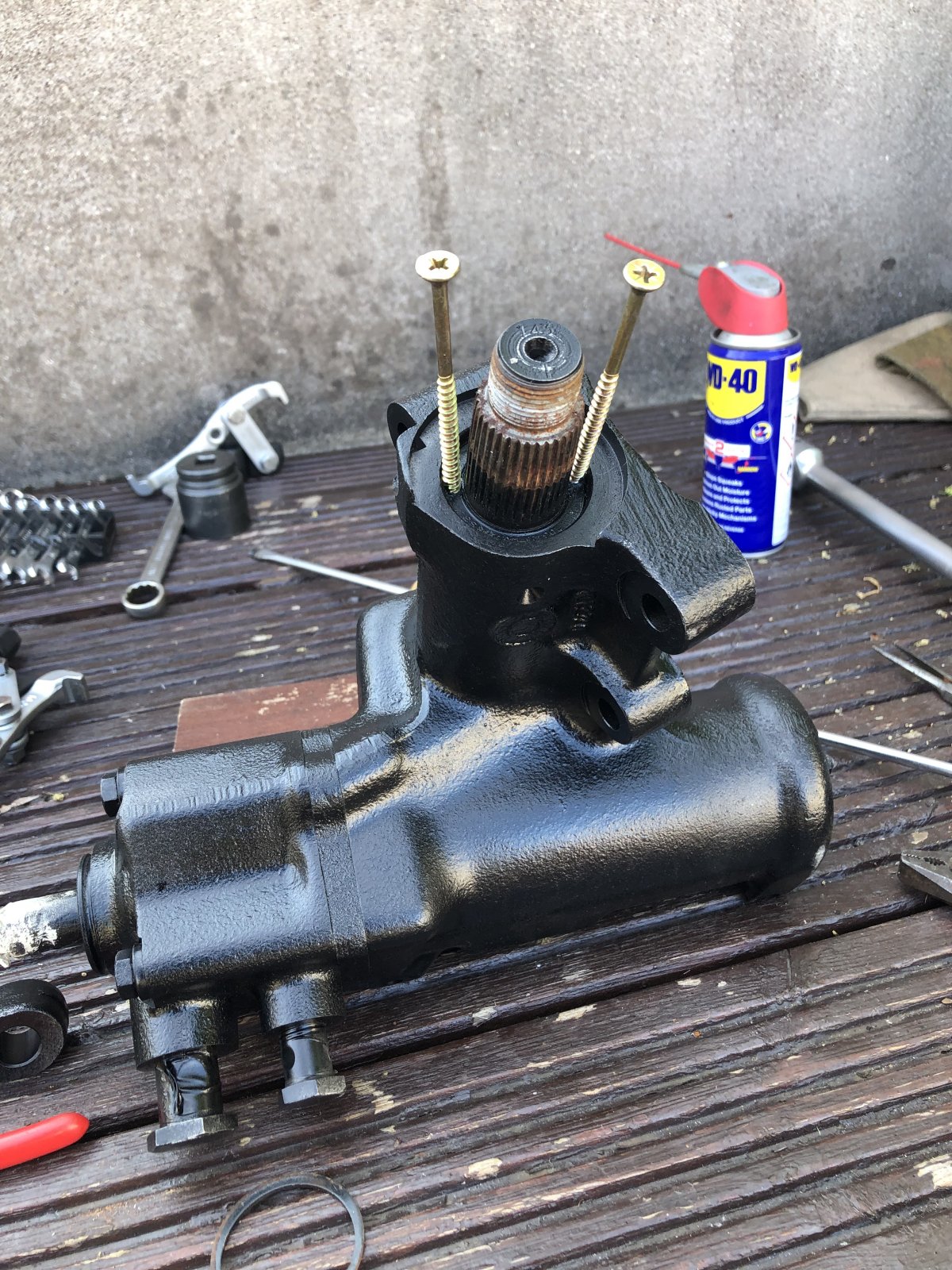

I rebuilt mine 2 weeks ago and reinstalled it this weekend.

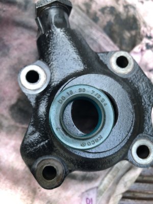

To be honest I only intended on replacing seal number 16 and o-ring number 6 as previously recommended .
Seal 16 went to plan all okay.
O-ring number 6 was a different story.

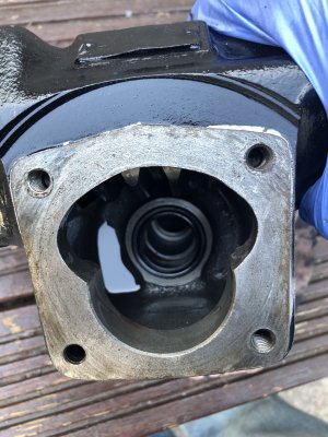

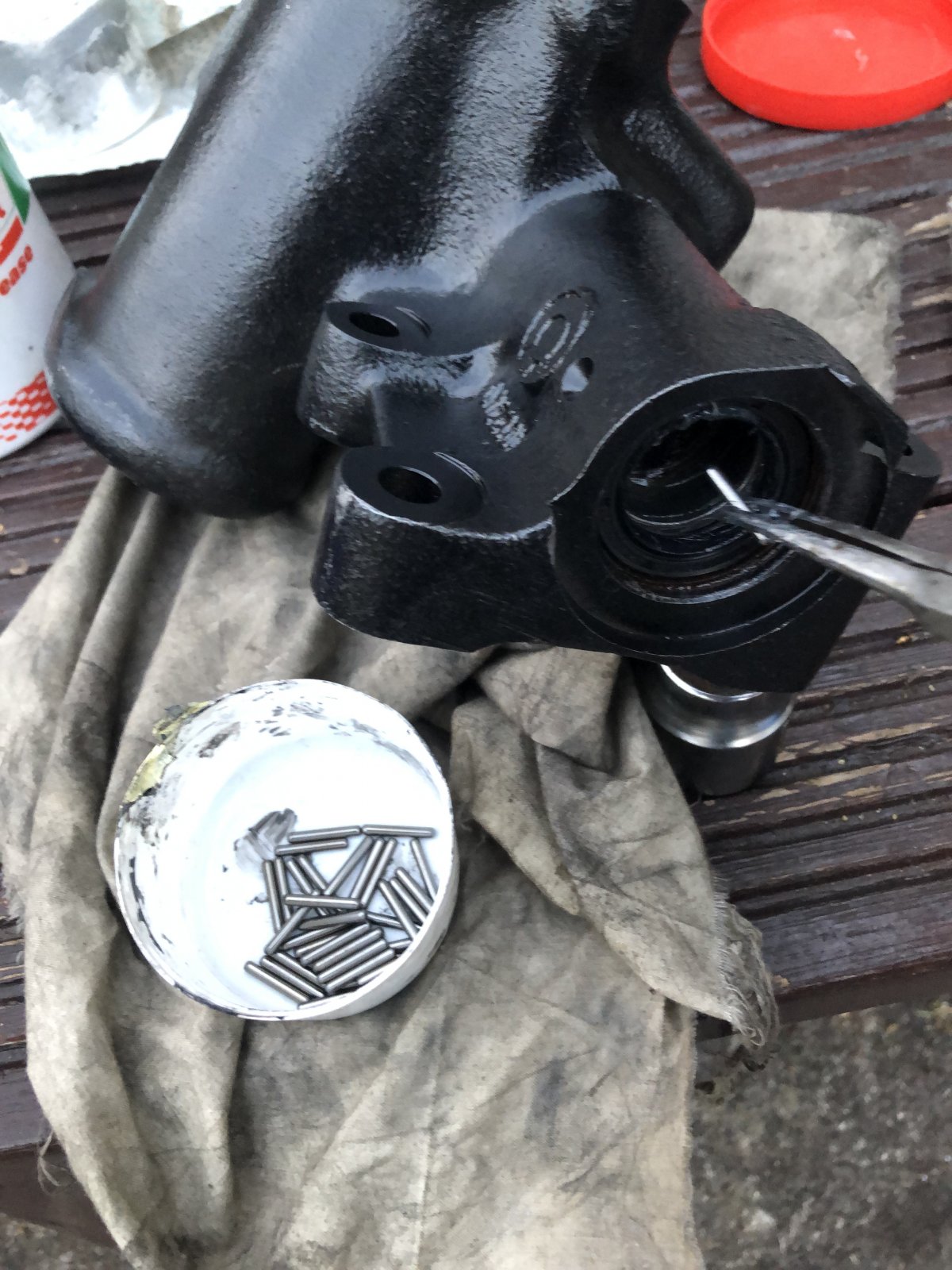

I thought that I could remove the alloy end plate to replace the o-ring and not upset the roller bearings.
I was wrong about that.
To my initial horror , some of the needle bearings fell out of their race and into the box itself.
So I ended up having to do a full strip down of the box to get everything back in place.
I did have a lot of worries to be honest, but if you take your time and clean everything it should work out okay.

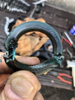

I was able to purchase everything I needed from a local seal and bearing supplier except for 2 outer seal rings , they are NOT o-rings and are not available new , so I reused them with a small bit of sealant to help them.
I am in Ireland so shipping my steering box off for a rebuild was never going to work for me and I couldn’t find any local hydraulic specialist to work on it or pressure test it , so I had to do it myself.
Now that it is done I am happy and I managed to purchase all seals for both the box and my pump for approximately €32.

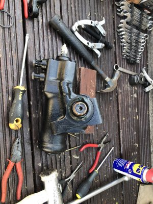

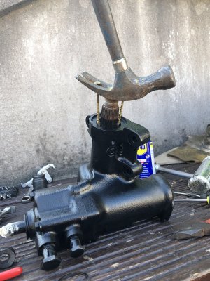

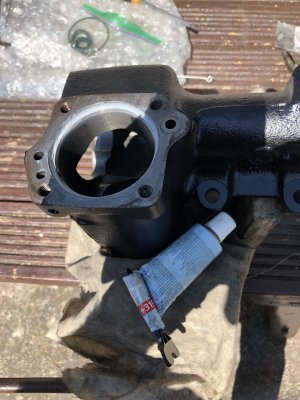

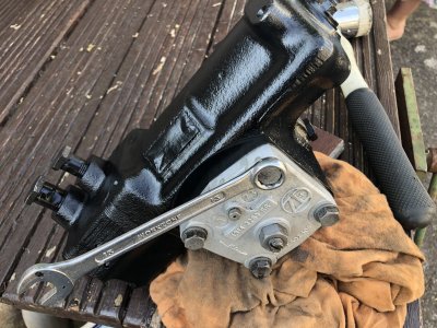

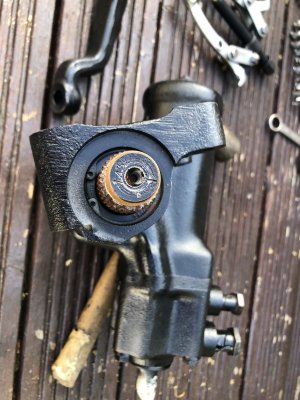

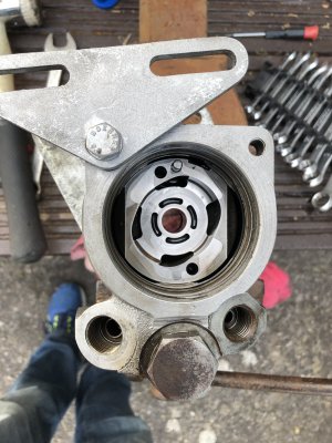

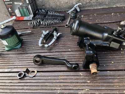

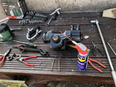

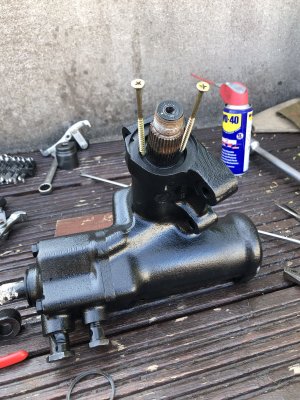

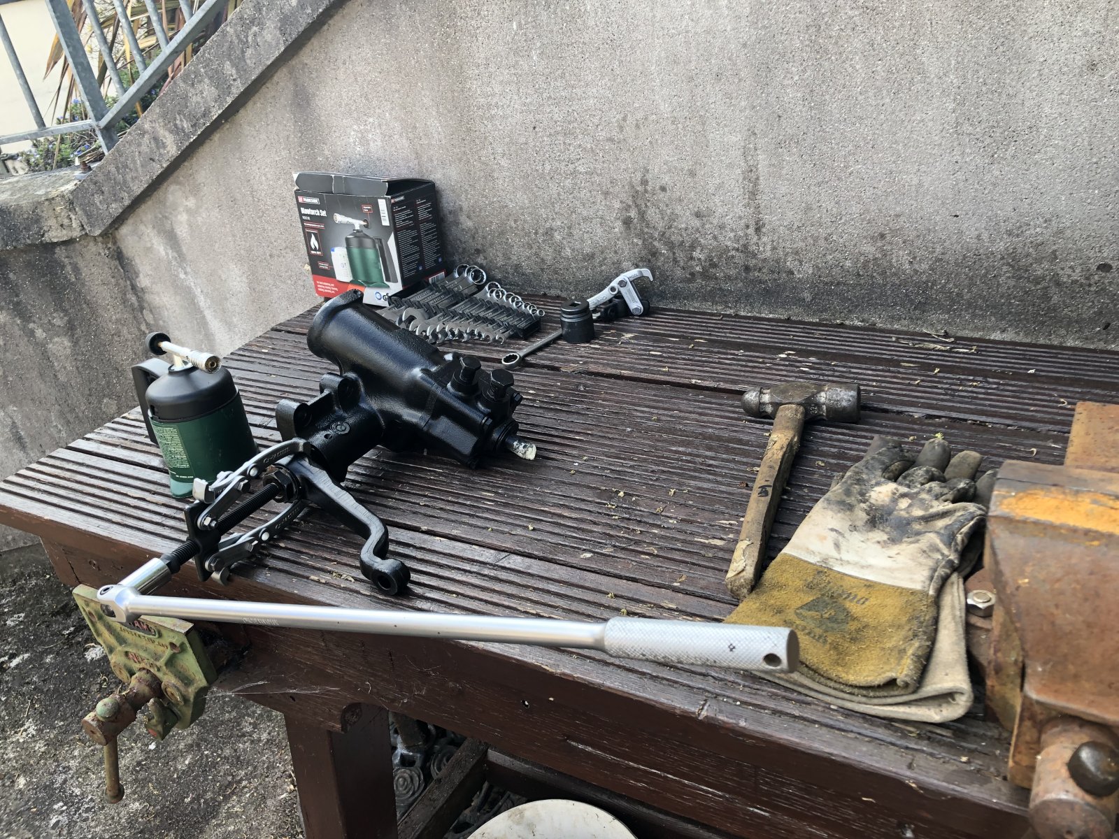

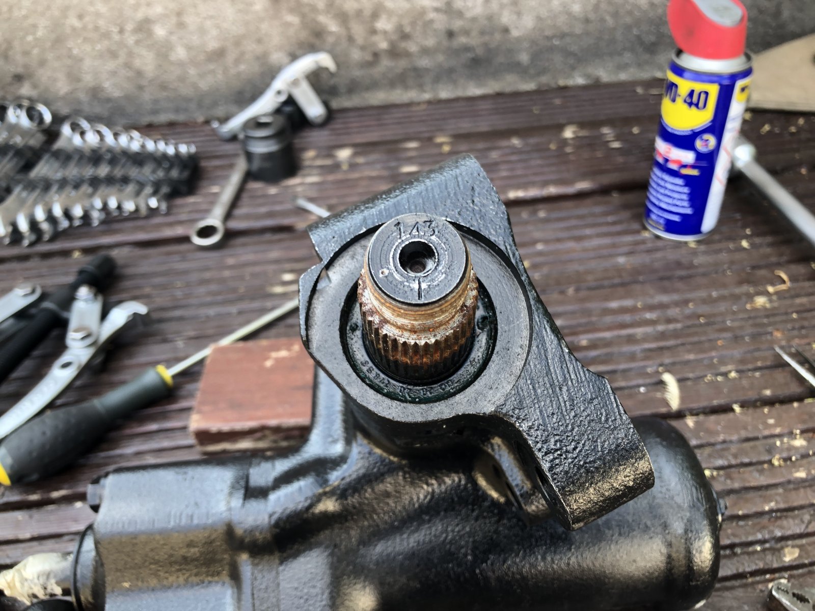

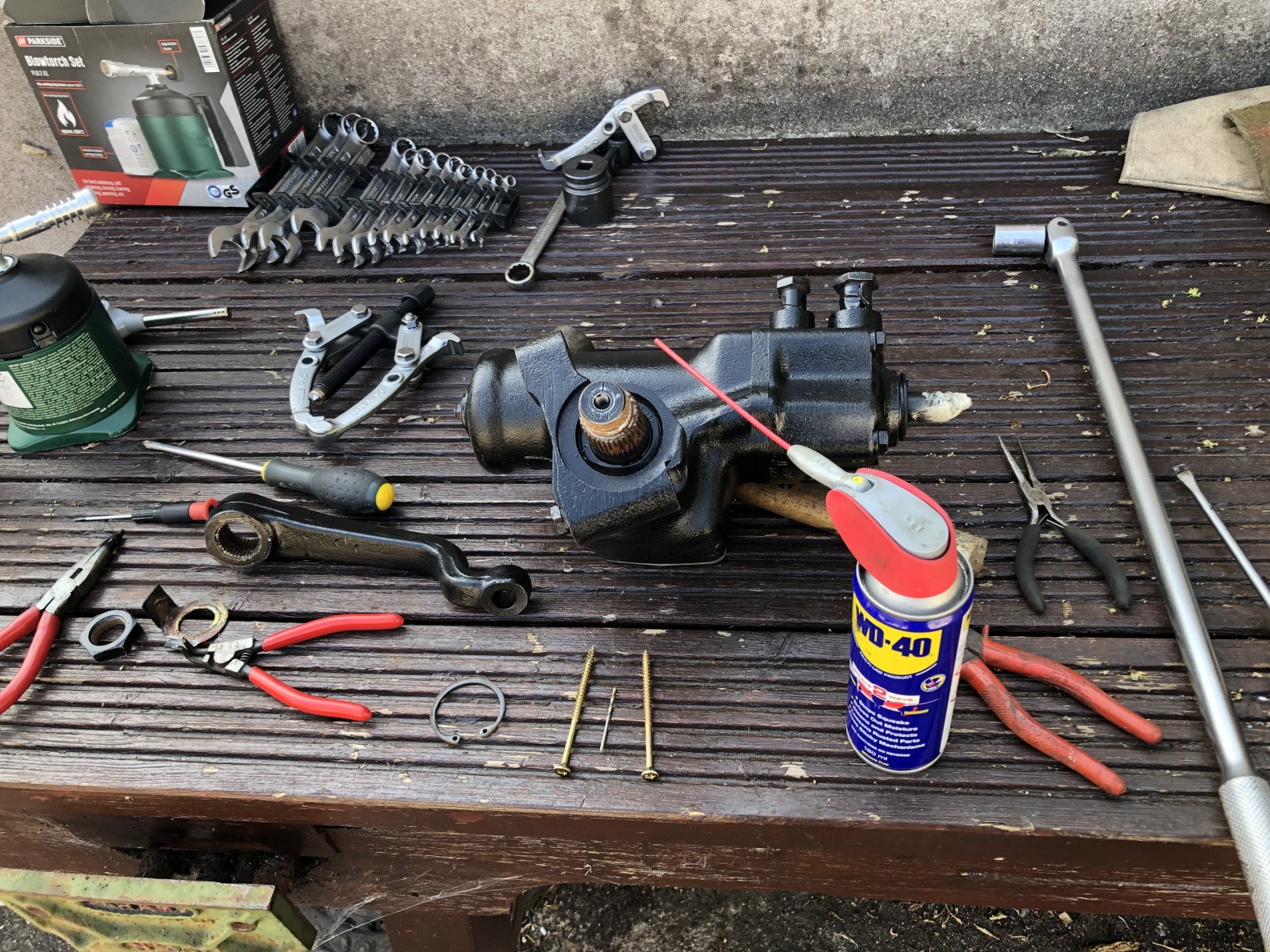

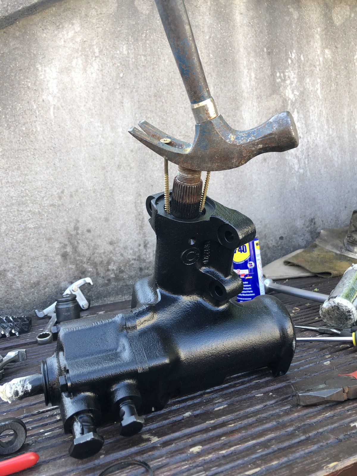

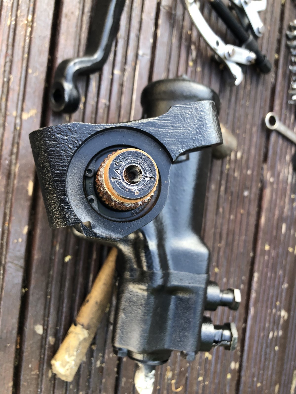

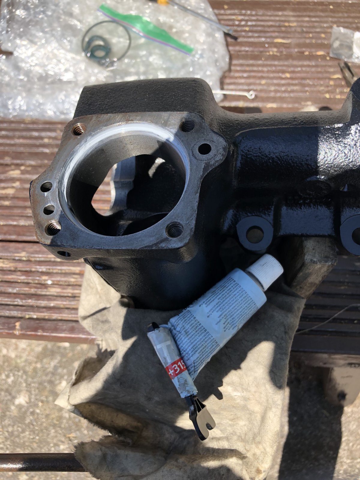

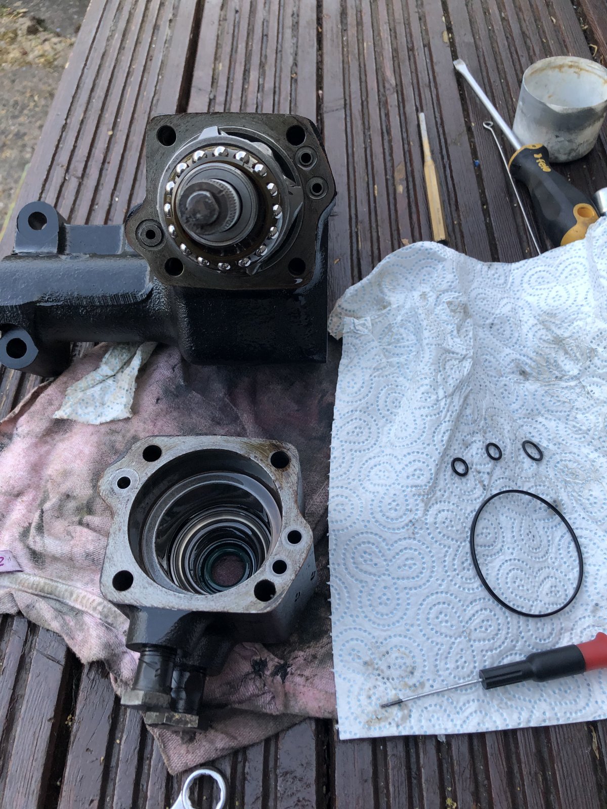

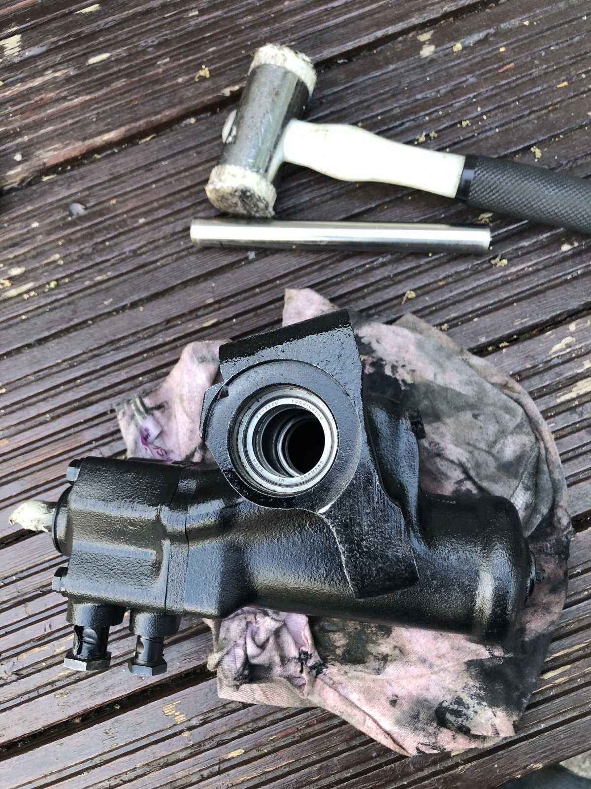

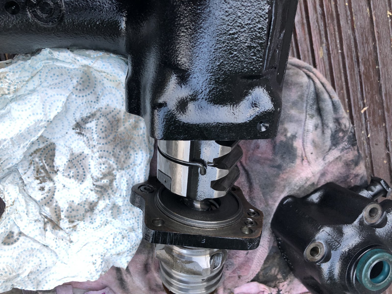

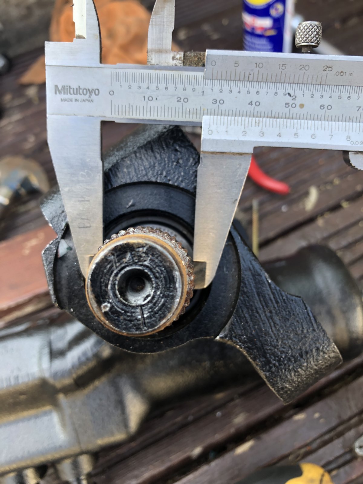

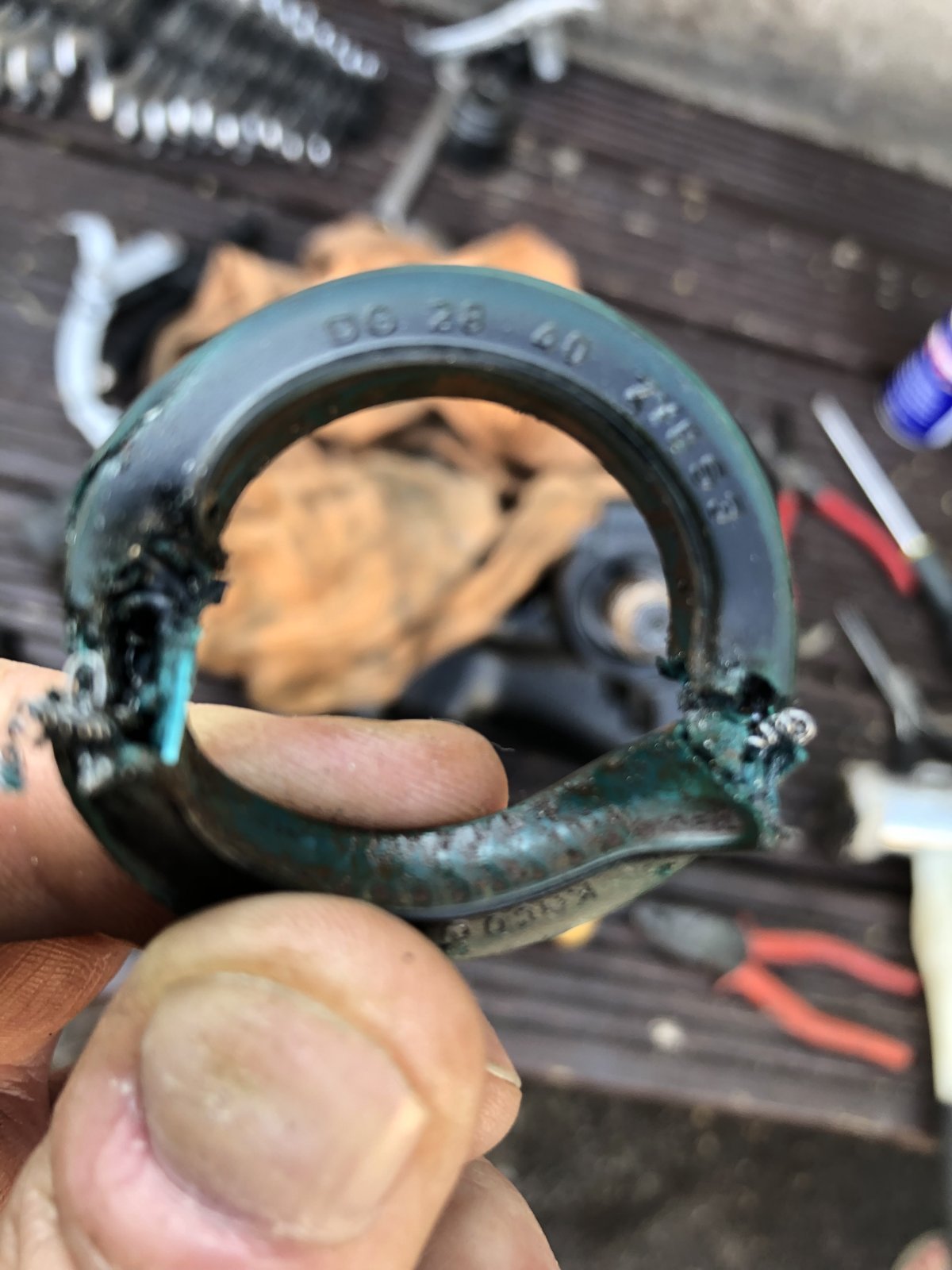

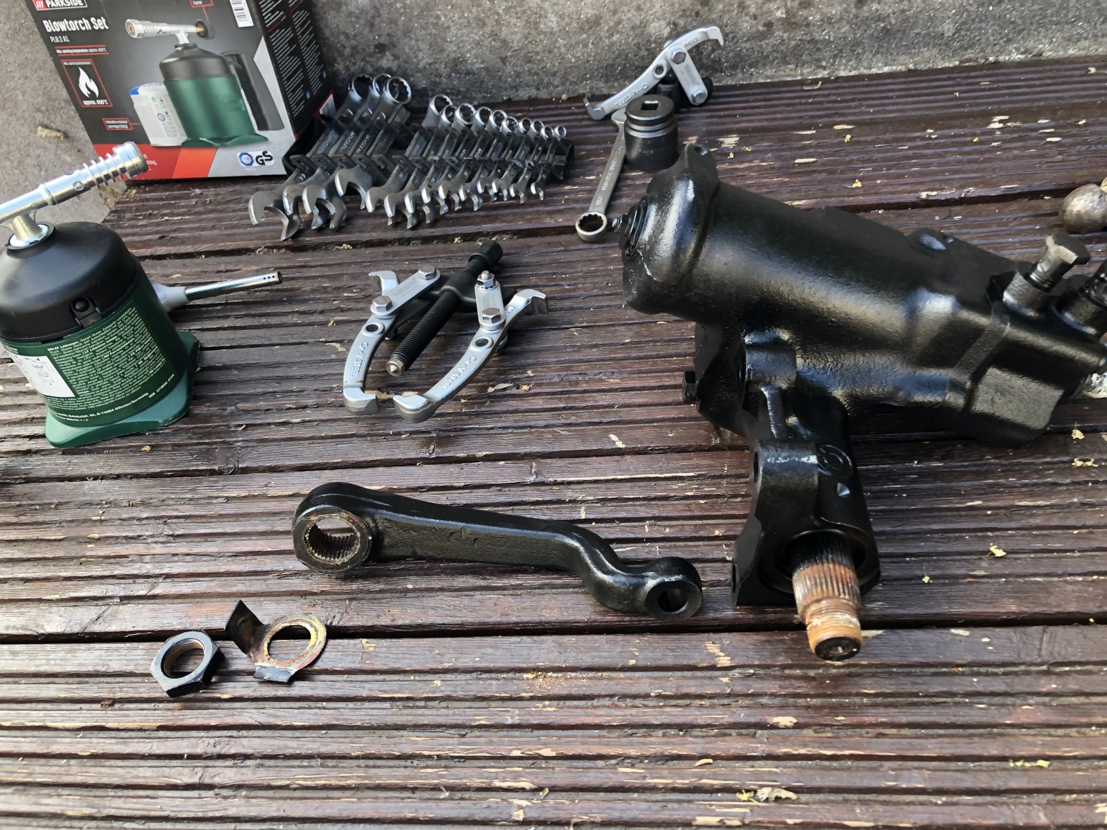

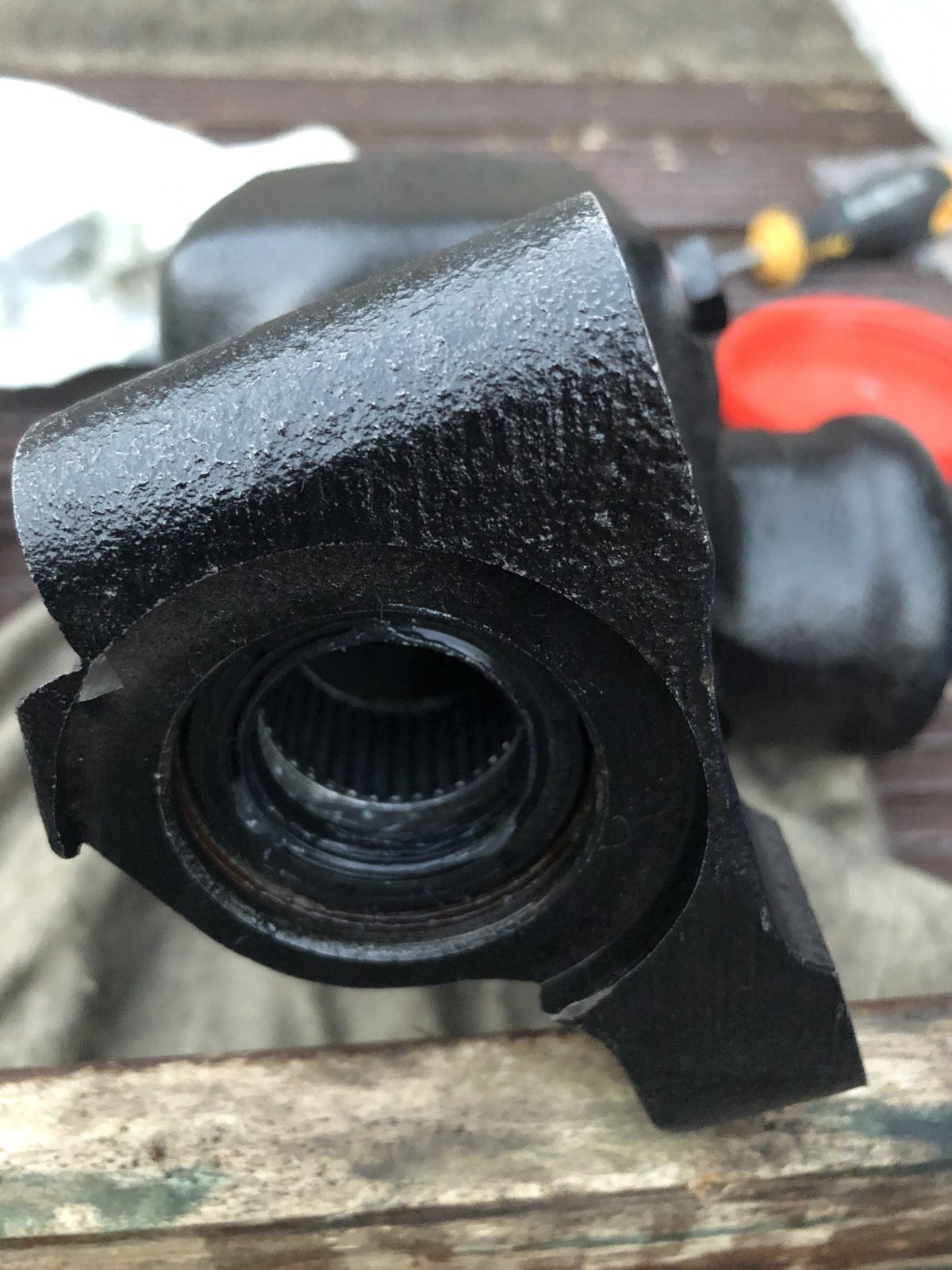

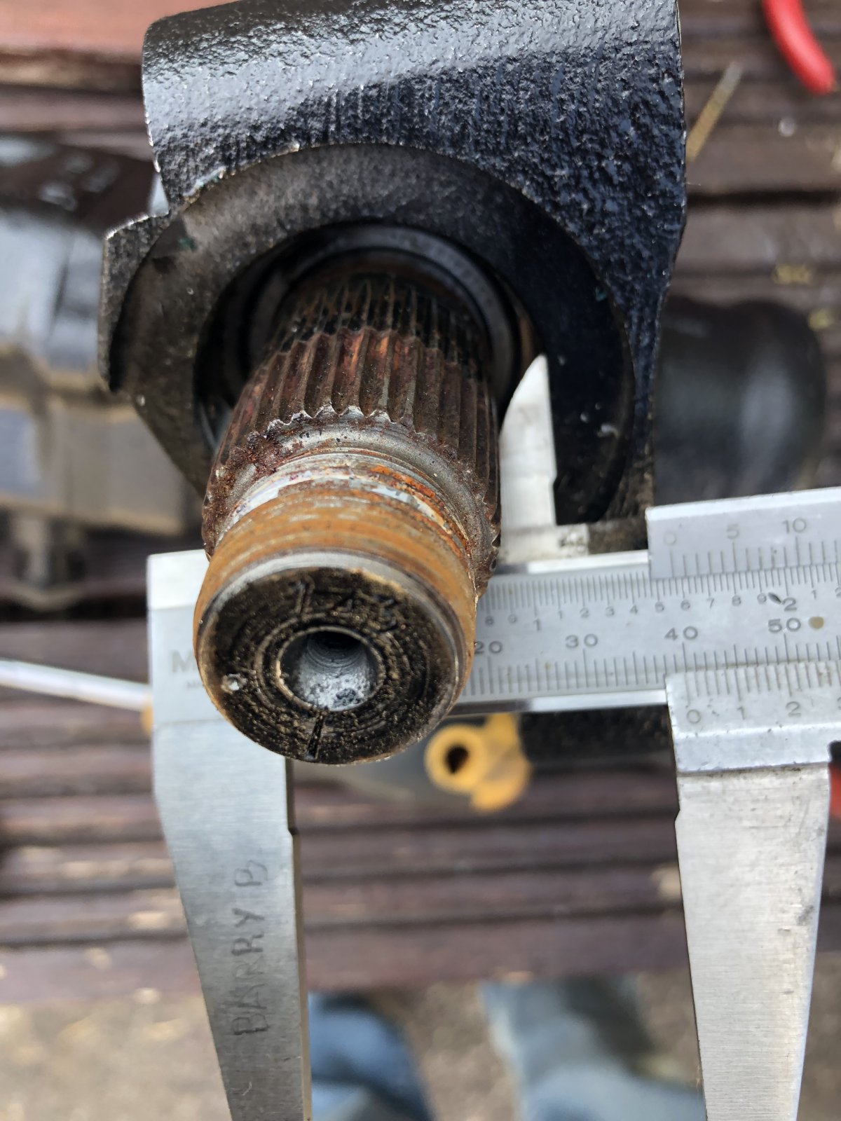

Hi Guys

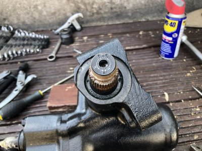

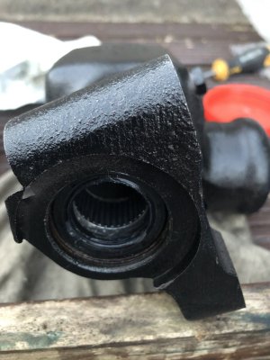

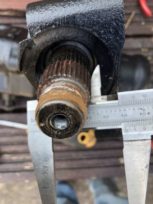

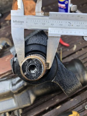

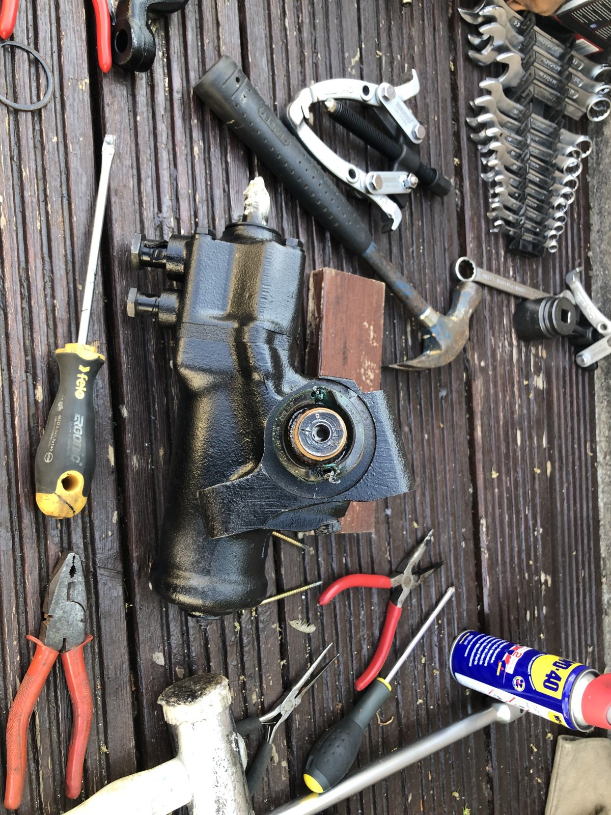

That last post showed removal of the seal from the outside.

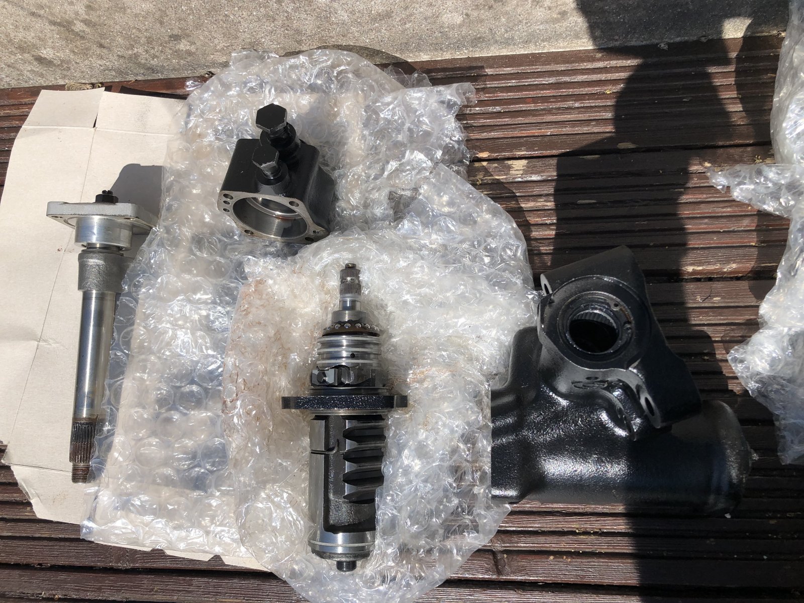

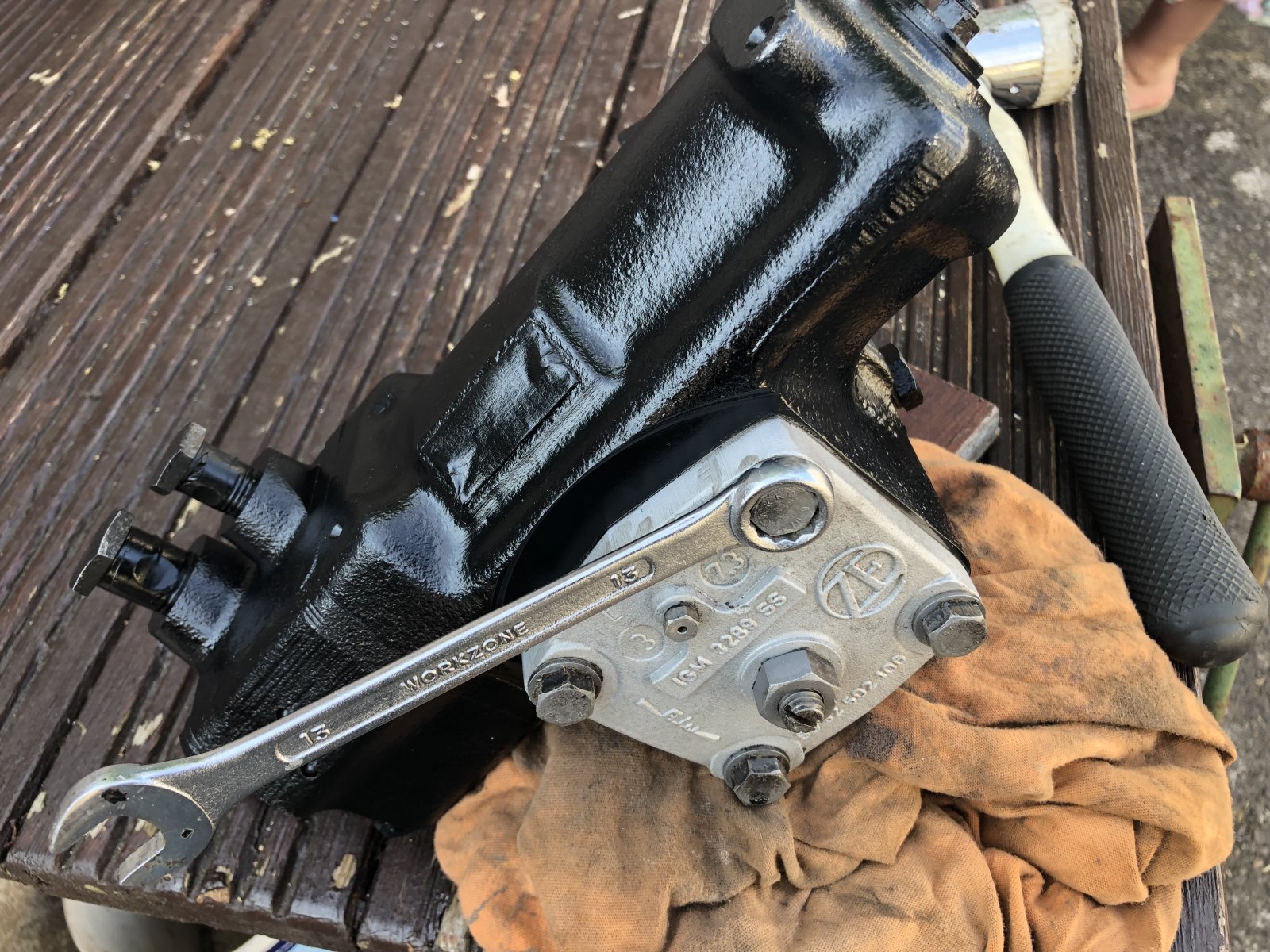

I used a puller with an extension arm on it and once the puller was tight I gave the arm a few taps with the hammer. Then with the nut still on the shaft a few threads once I applied some heat , the arm popped off.

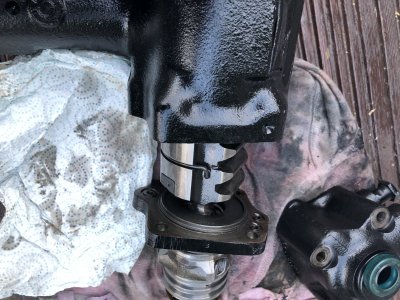

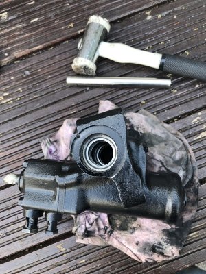

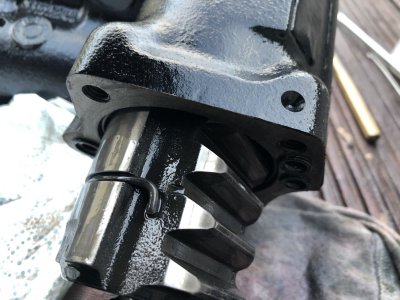

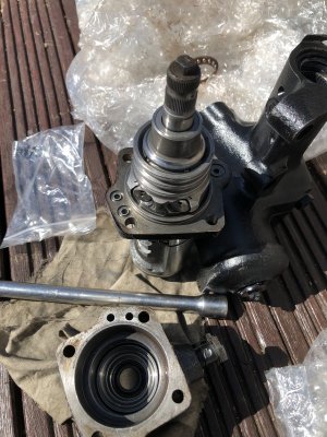

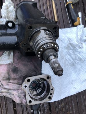

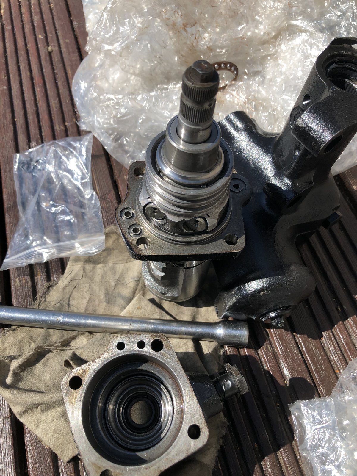

Once I removed the 4 nuts holding on the alloy end plate I was able to tap the shaft and end plate out together.

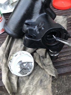

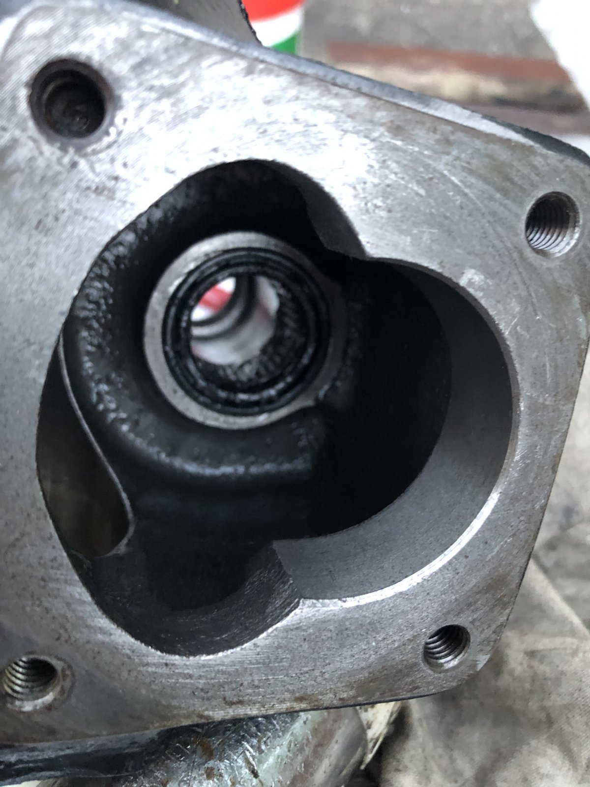

The needle bearings will fall out at this point be careful you don’t lose any !

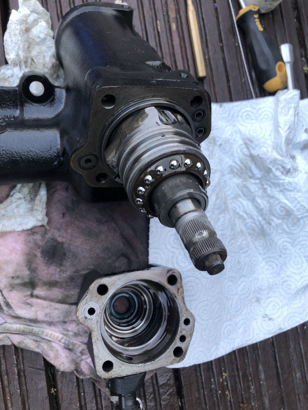

Once the shaft and end plate are out , you can then also split the input shaft side of the box.
Be careful with the 2 large diameter seals at this end as they are Not available from a seal supplier and you will have to reuse them , I put a bit of sealer on them when putting it all back together.

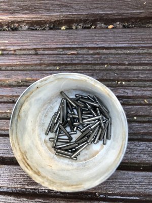

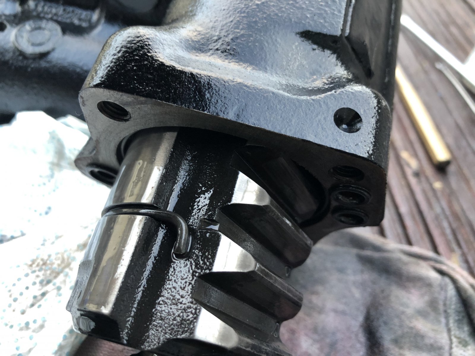

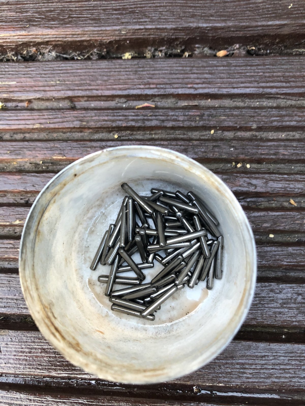

There are 66 needles in total , 33 per bearing. And if you grease the race and use a long nose plyers and carefully put 33 into each race the grease will hold them there whilst you re insert the shaft.
Inside in the box the 2 shafts make up a short rack and pinion when you have the rack in centralise it on the box then when inserting the pinion centralise it’s teeth so that you end up having the correct amount of travel in both directions inside the box.
This whole job is quite time consuming and a bit tricky to do , so if you have a specialist available nearby it might be easier just to pay for it to be done.
Also I have not pressure test mine yet as my engine is out but I am assuming all will be well with it.
I only needed to do the seals that could cause an external leak all other internals look good as they were.

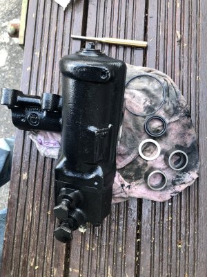

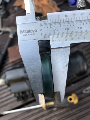

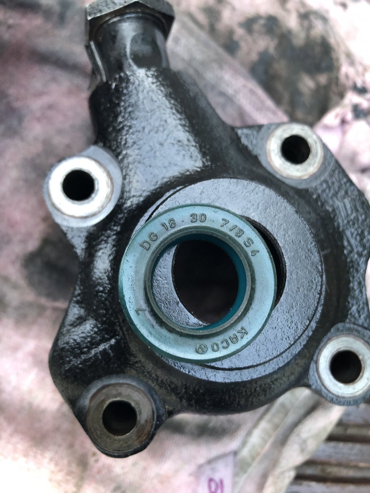

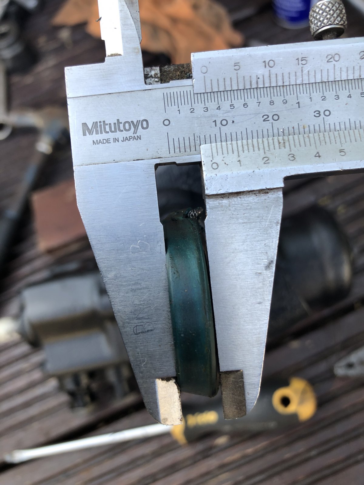

I have attached a photo of a list of seals I used hopefully this will help you out.
It also contains the seals for the power steering pump ( except for one seal which they did not stock ) I cannot find the receipt for that seal , I think it was a 28 x 38 x 7 oil shaft seal.

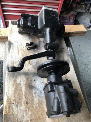

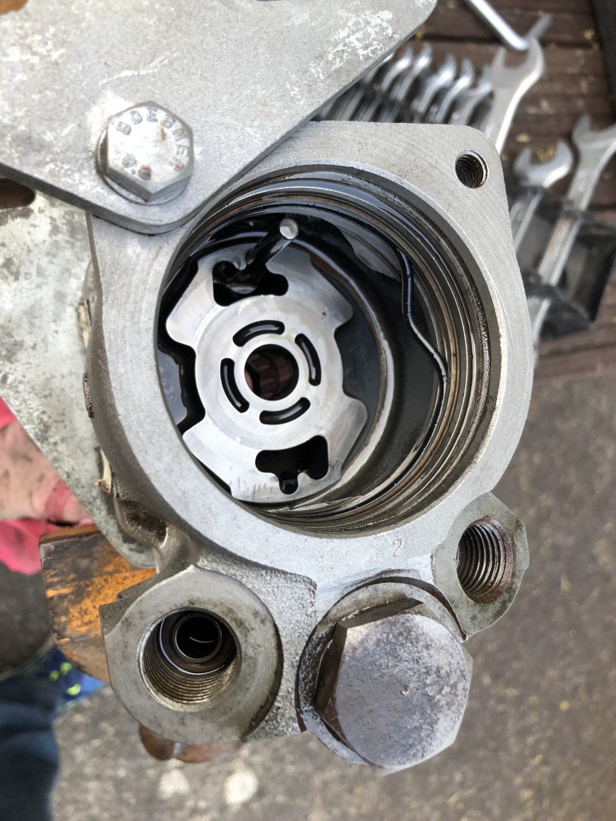

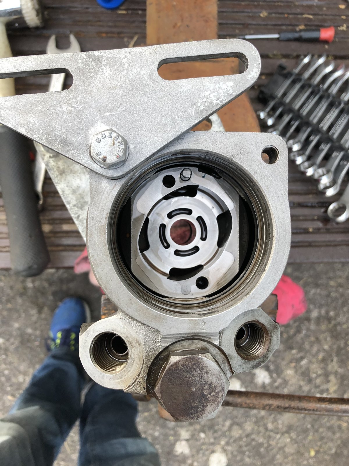

Hi again

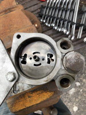

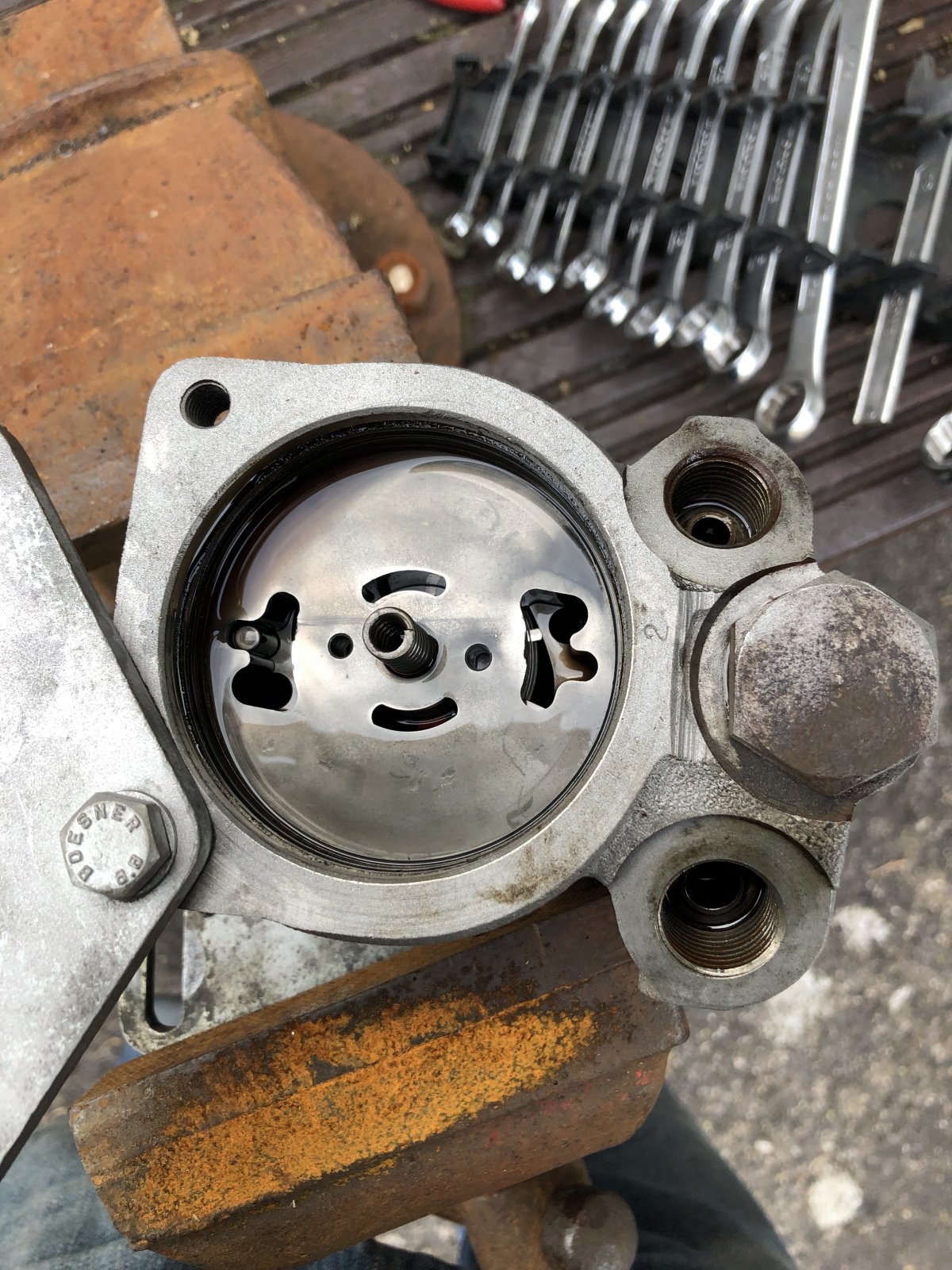

I took less photos of the pump rebuild as it had been covered a few times before and documented here so thanks again for that guys !!
Here are the few photos I took of the inside of the pump.

These are the seals I used for both steering box and power steering pump
( as mentioned you also need a 28x38x7 shaft seal for the pump and it is not listed on this docket )
