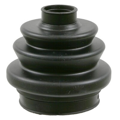

these are the CV boots that i used. Direct replacement.
1985-87 Ford Sierra XR4x4 2.8 (UK/EU) + many more Fords
FEBI BILSTEIN 03312
  • Inner Diameter 2 [mm]: 62
  • Inner Diameter 1 [mm]: 25
  • Length [mm]: 81
Particularly for those in the UK, this site is great for CV joints + any associated parts required (108mm)
