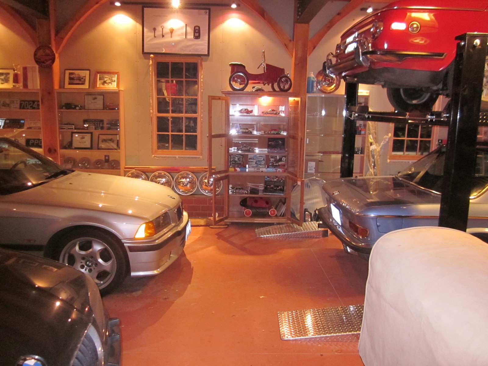

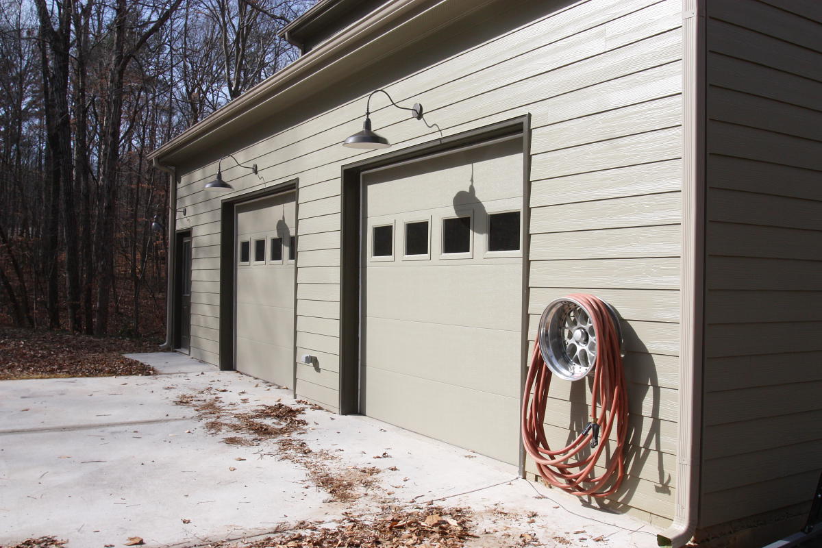

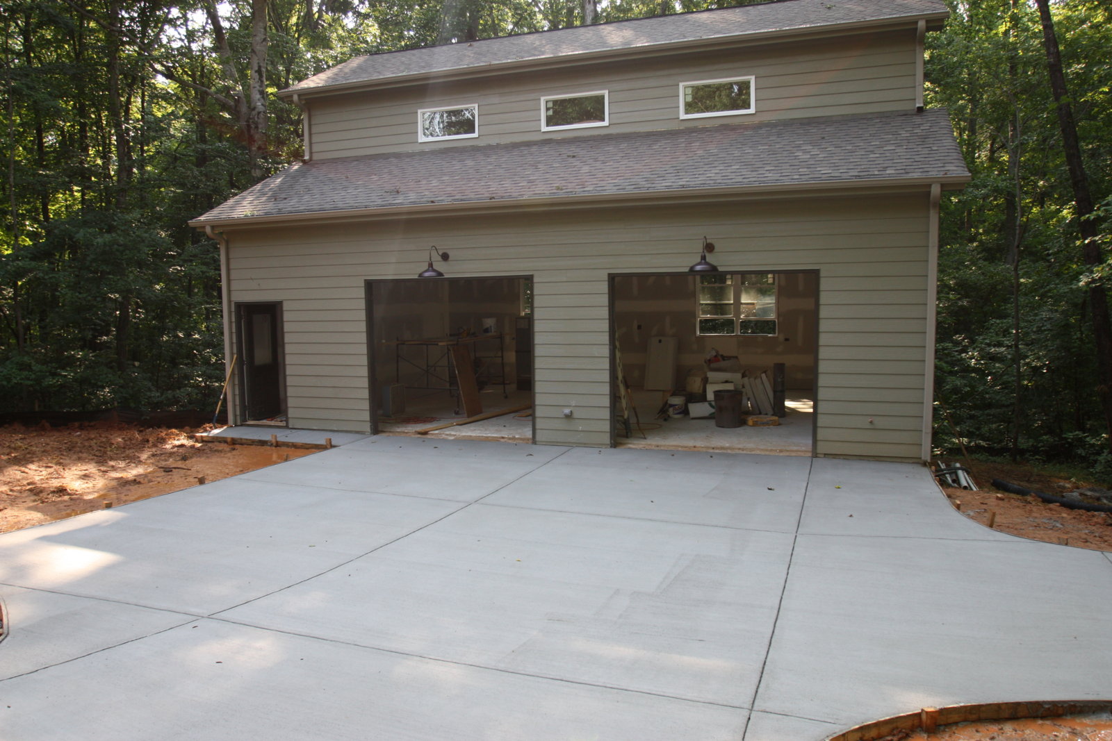

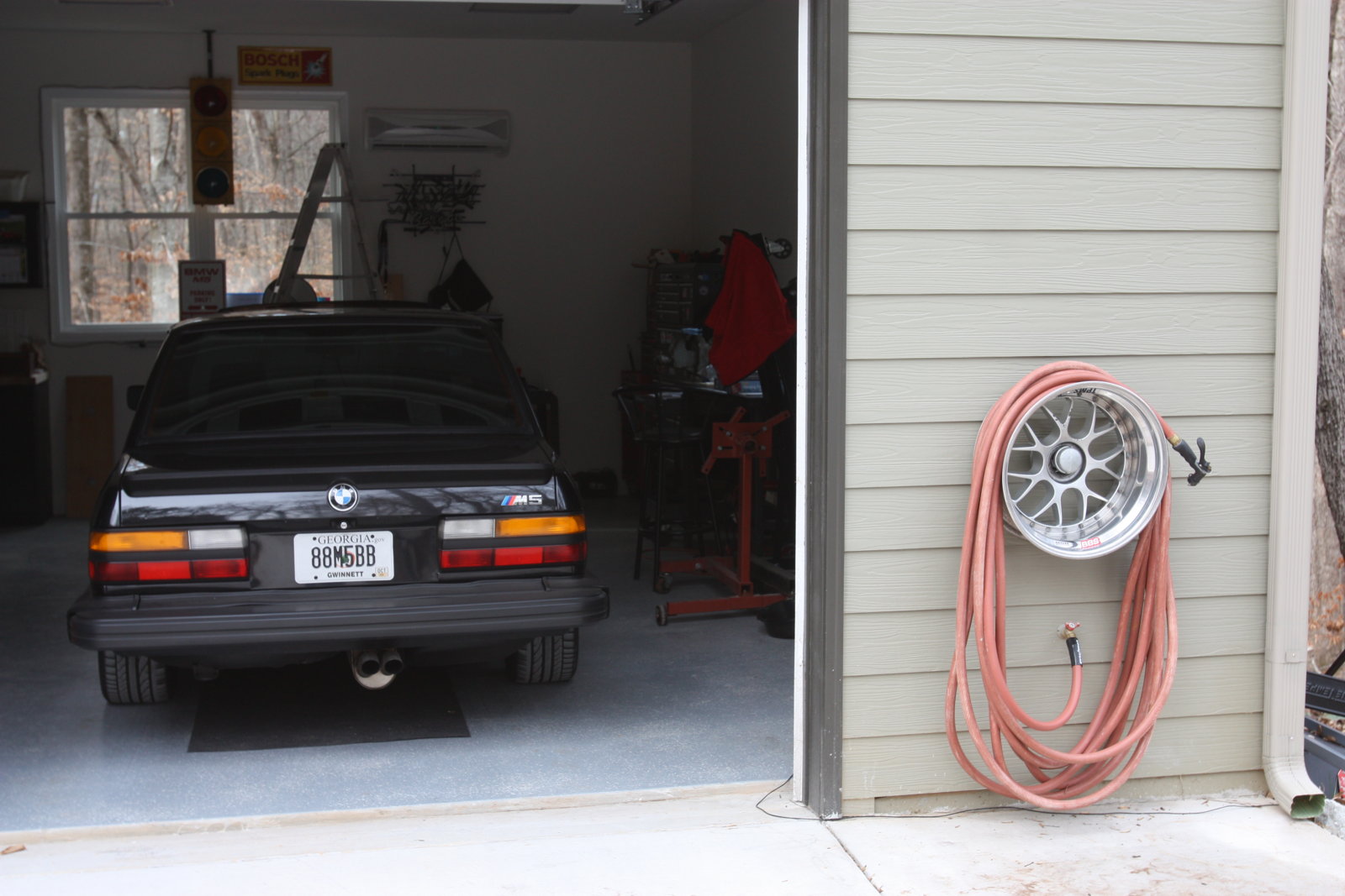

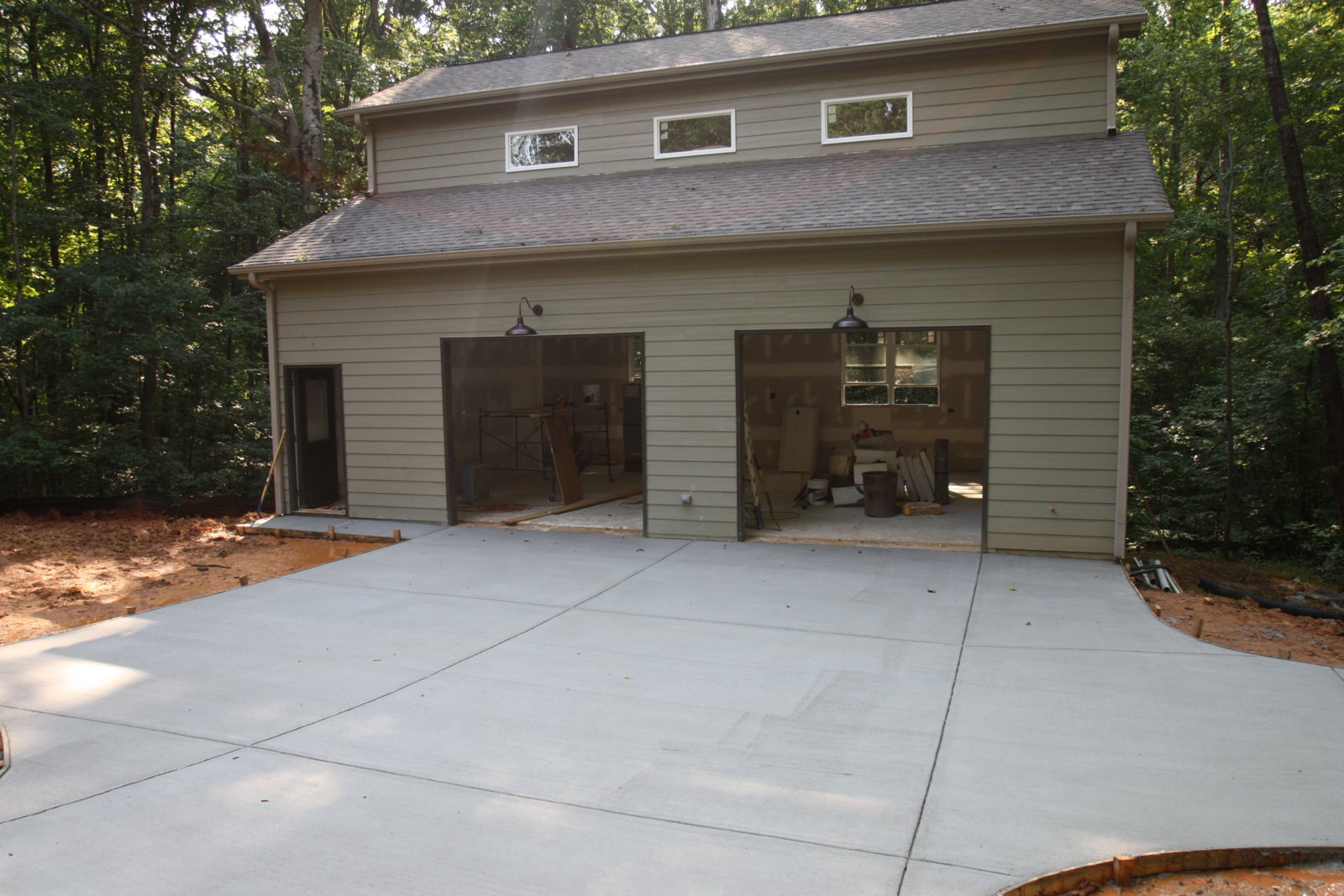

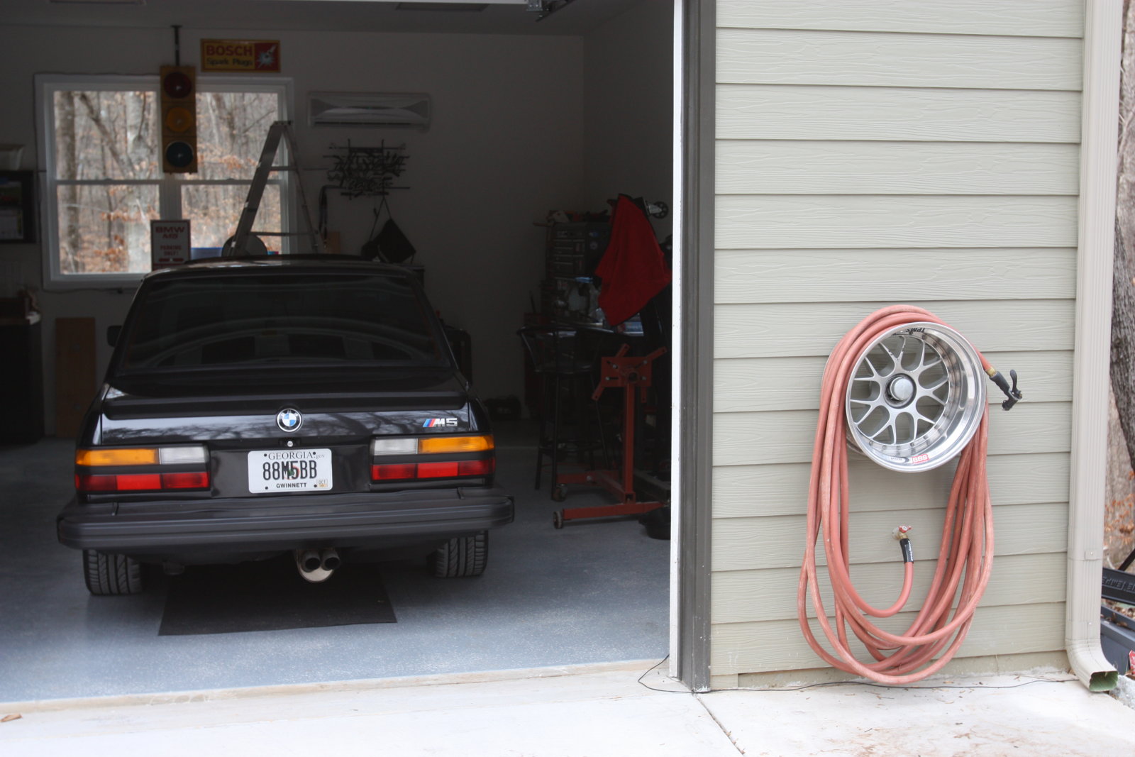

I built a 34x24 garage behind my house in 2009. Originally intended to be a garage on one side and a wood shop on the other.
Woodshop tools still pushed up against a wall.
I have a lift, a loft area and a bathroom.
All space is controlled by a split mini system.
One compressor out back and two air handlers inside.
I live in Atlanta and gets hot but fortunately the garage is heavily shaded in the afternoons so cooling is not a problem. Around $40 a month average for power.
Air compressor (80gal) is out back under a canopy. I hate listening to them.
Floor slopes to doors (very important) so any spills or water runs towards the door and not under your stuff.
I have a desk in the corner and a office chair. No separate office.
I have a slop sink on the main floor. Good for hands and many other washings. Parts cleaning cabinet with mineral spirits is next to sink. Handy.
The loft is a separate stairway inside the building and the loft is approximately half the floor space of the garage.
Great for parts and storage. Bathroom is up there.
You NEVER have enough room. My footprint was limited.
Walls and ceiling insulated to max.
Big stereo and speakers with CD player, Sirius XM and radio. No TV.

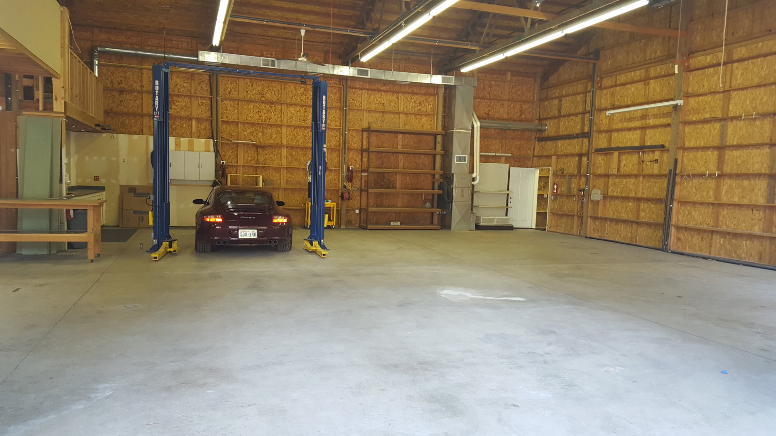

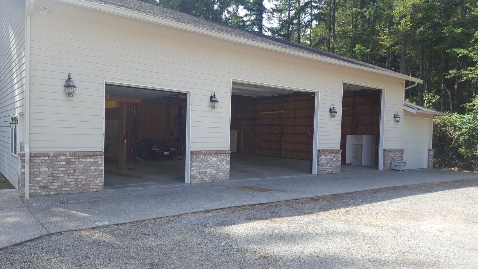

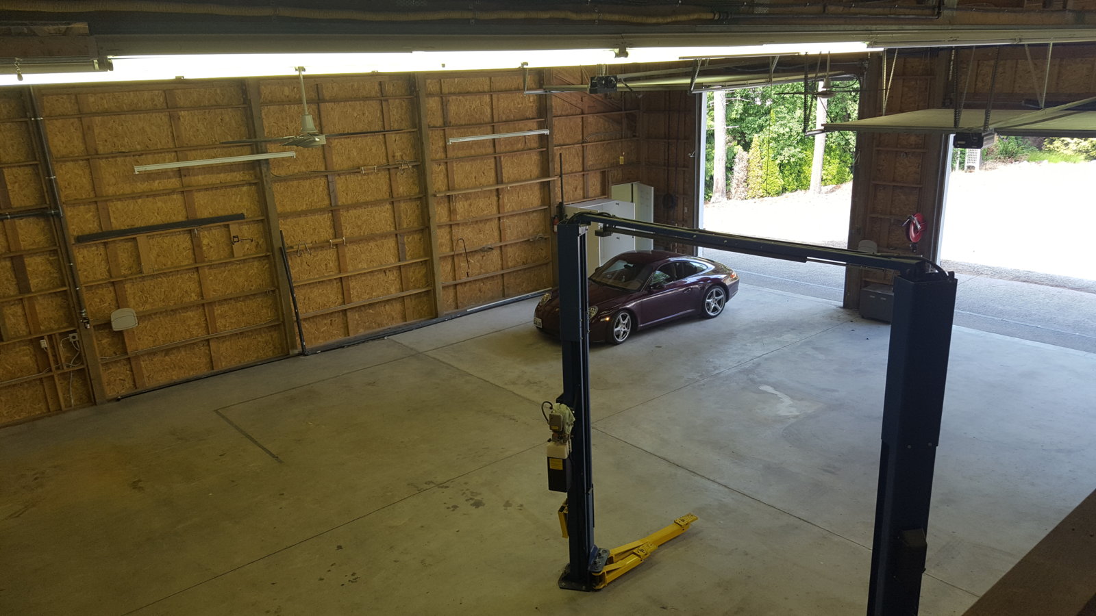

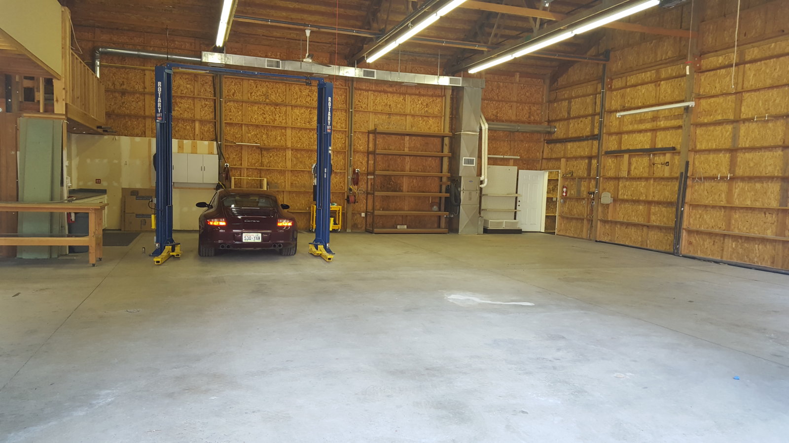

I have a 52'x70' shop behind my house. The fella I bought the place from built NASCAR chassis in his 'spare time' - as best I can figure.
The shop ceiling has 16' clearance to the floor - with a loft along the left side (one stall wide). There is laundry and full bath below loft. The loft is where my office and AV room will be with a balcony opening out to the main body of the shop (via a glass garage door).
See enclosed pics. I am in process now on finishing out the interior of the building.
If you do intend to do 'work' in the building - I agree with creating separate room to keep the mess to a minimum.
I do have a commercial spec air compressor as left by the PO. Works great.
I will post pics as I progress in my completion of the building - if you are interested. I am in the middle of that now...

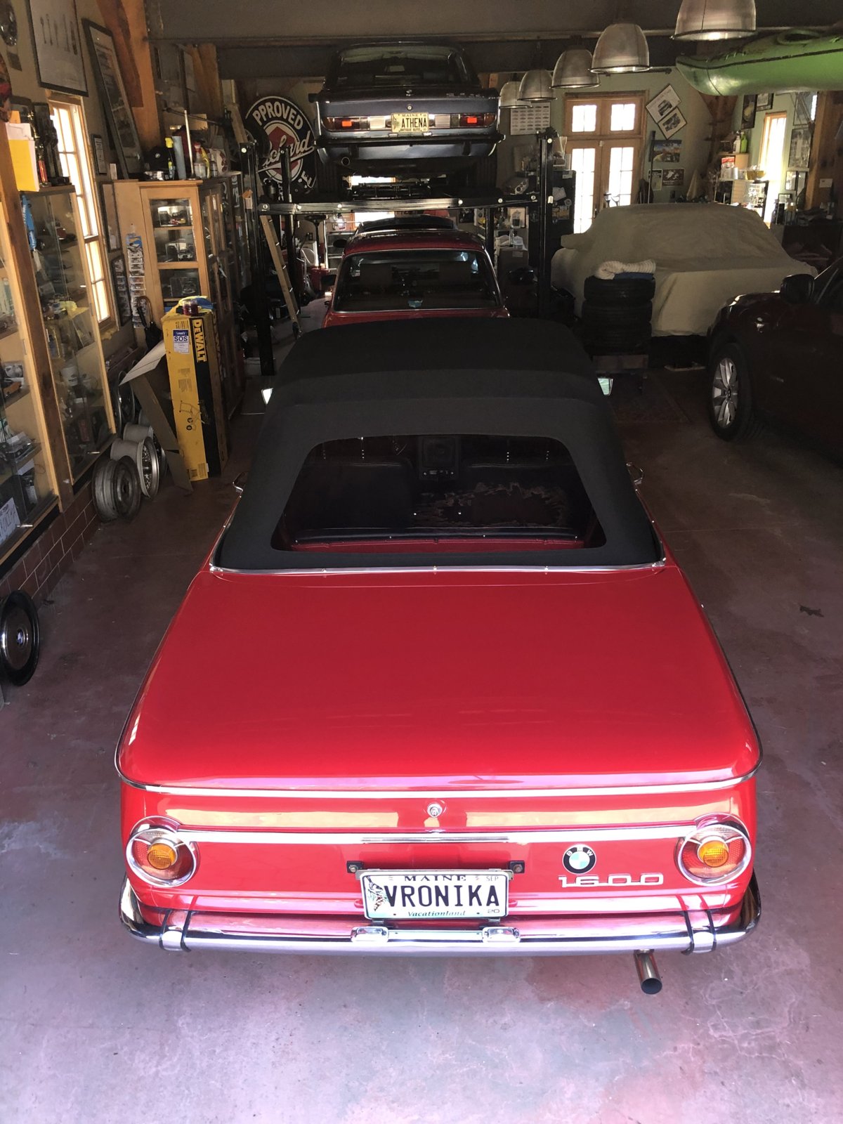

Mine is 60' x 45', with two office spaces and a full bath which takes up 900 square feet, rest shop. Lift, compressor, bead blaster, welder etc makes for a fun area to kill alot of time for the BMW's.

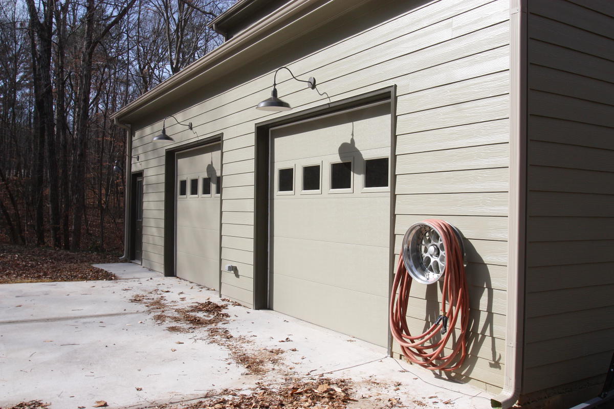

By far the best hose spool I've seen!
