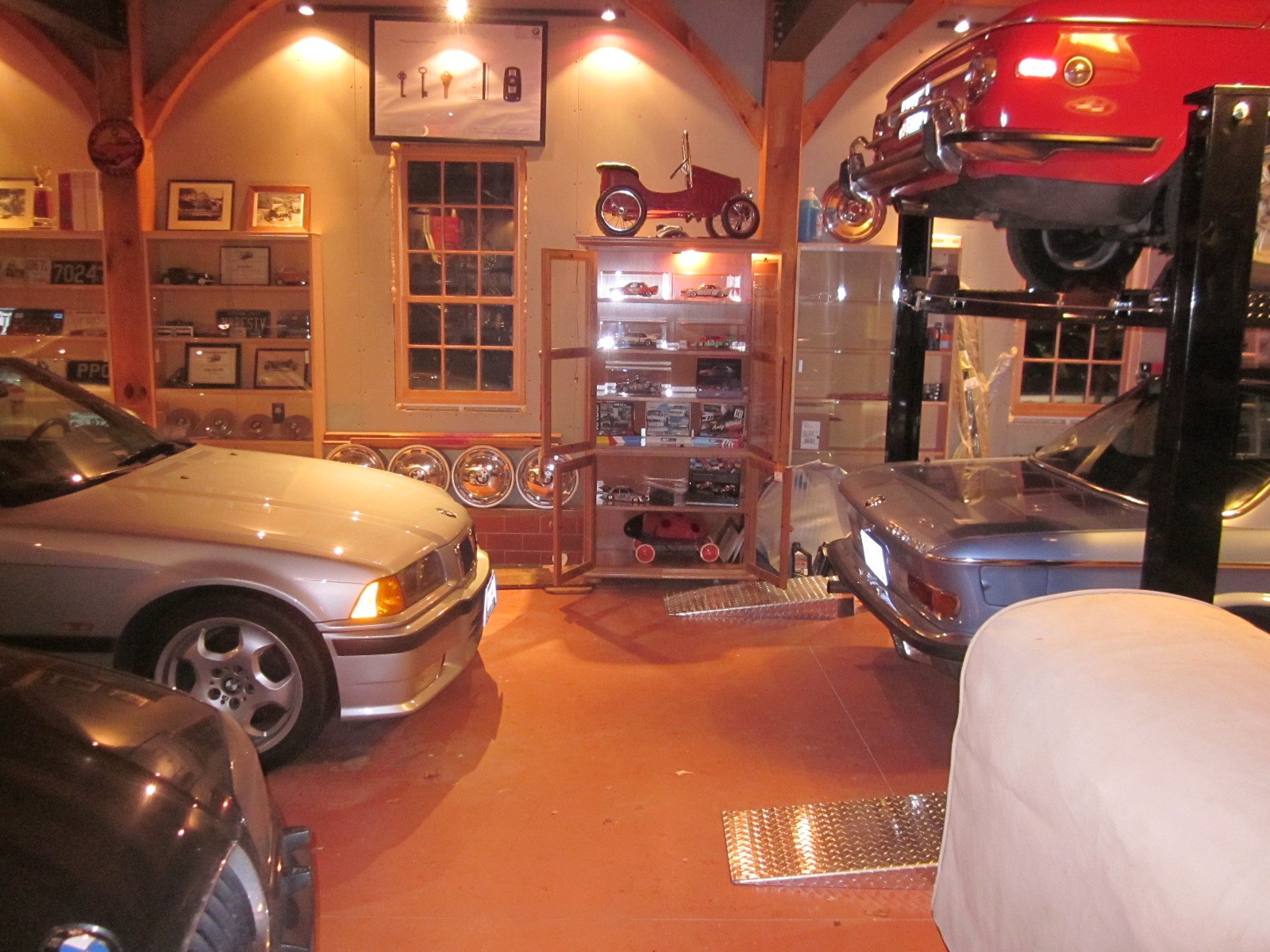

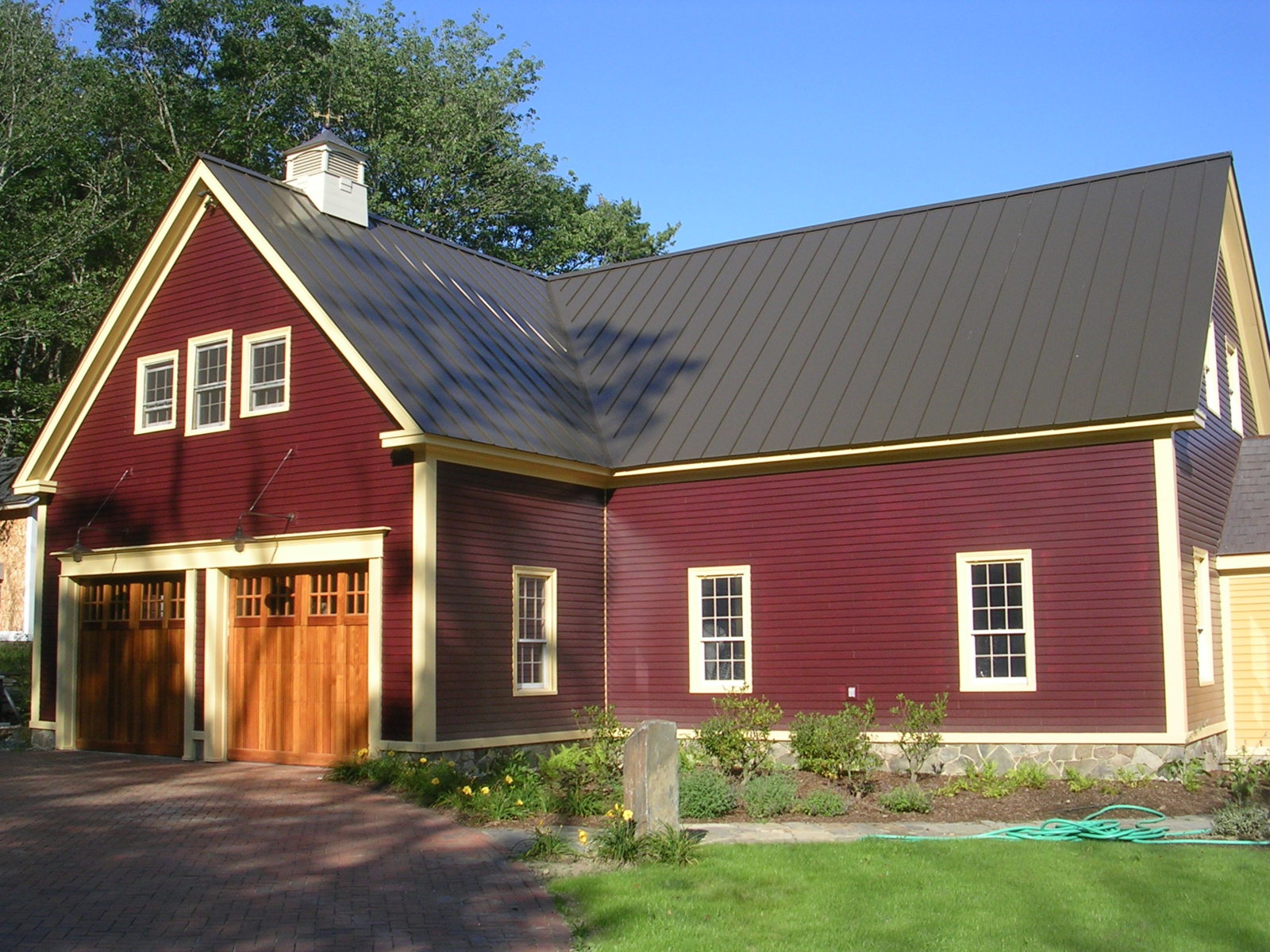

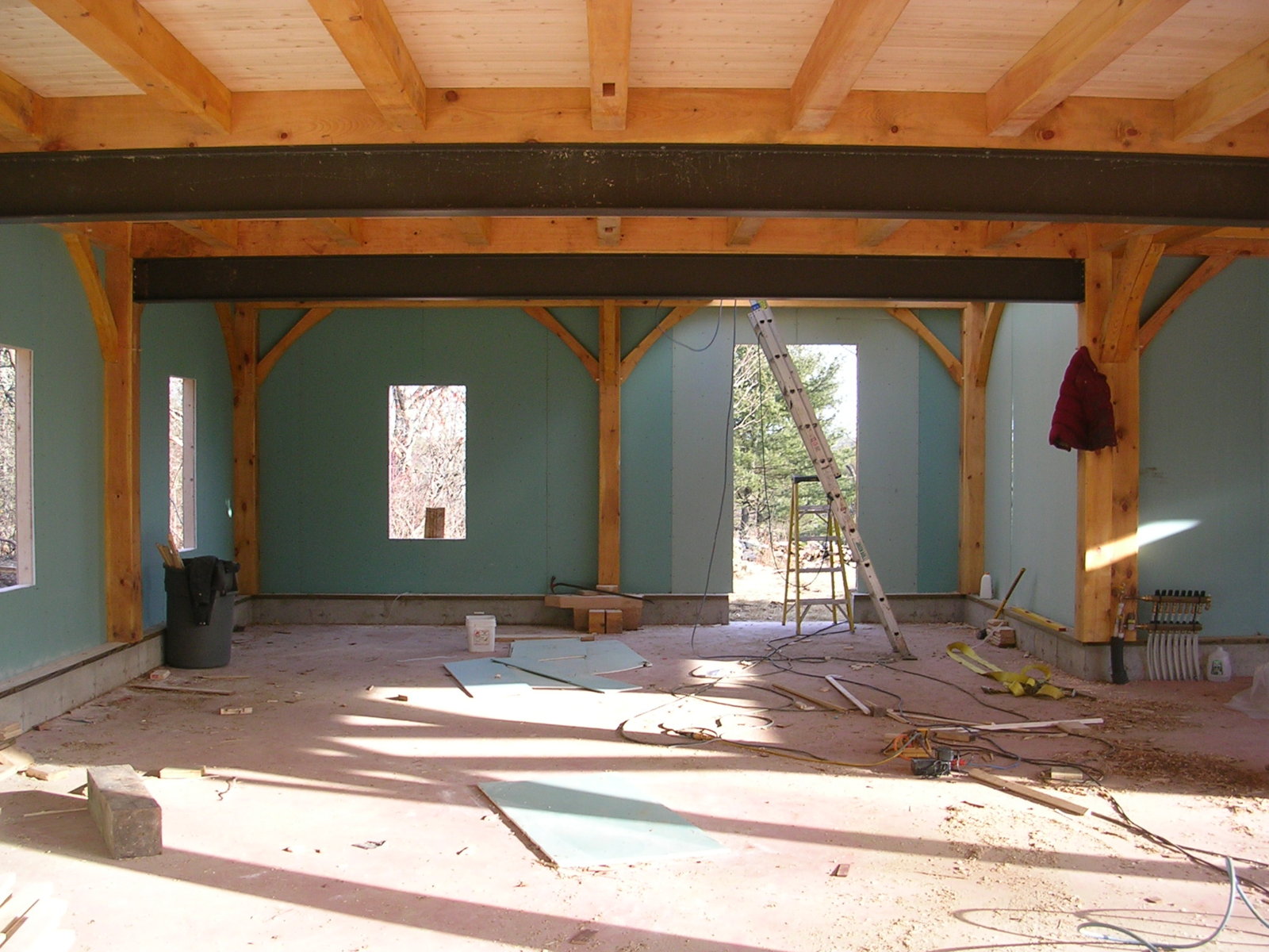

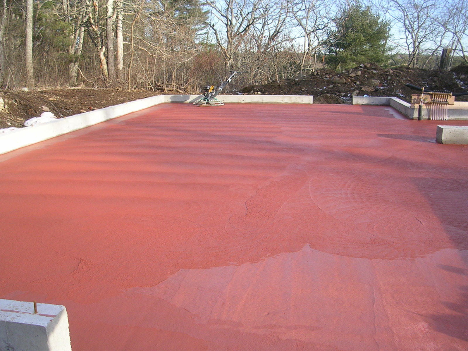

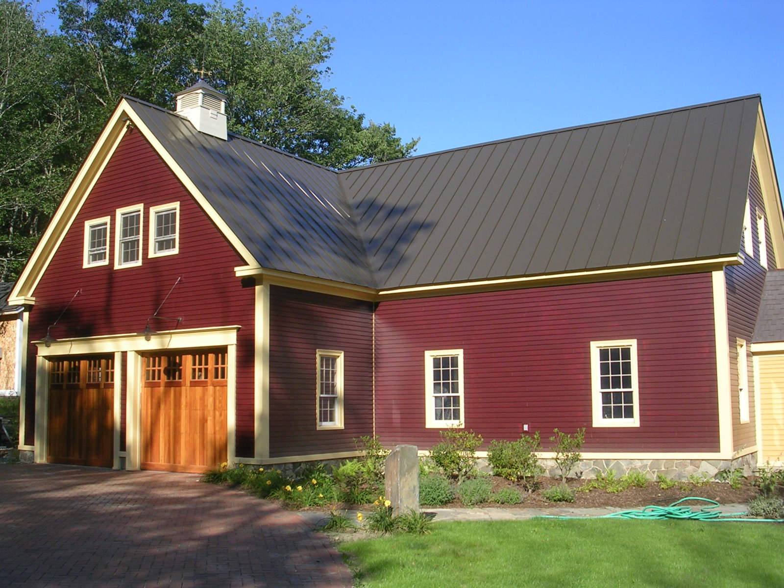

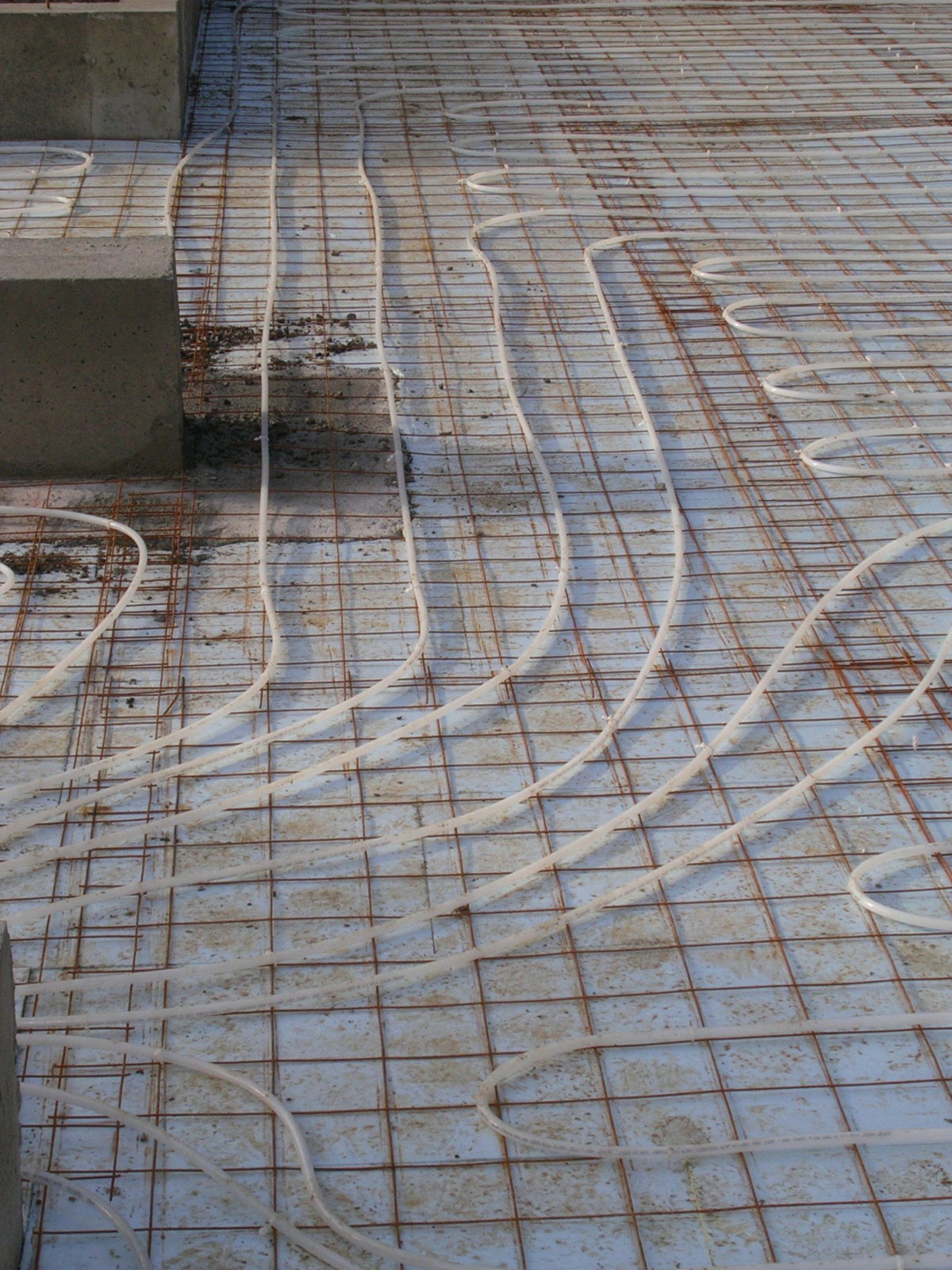

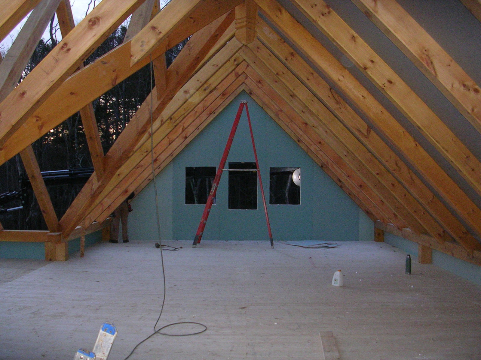

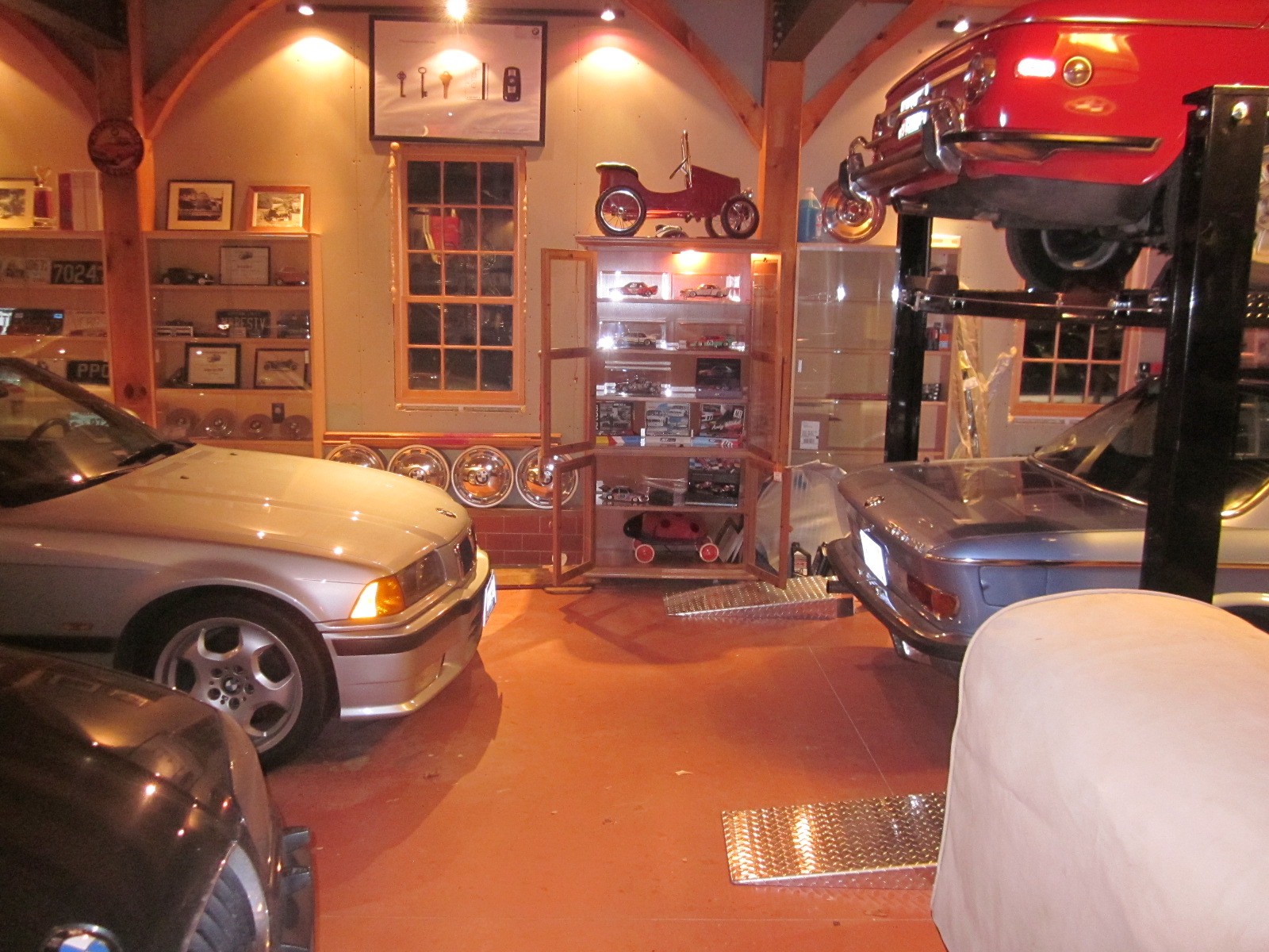

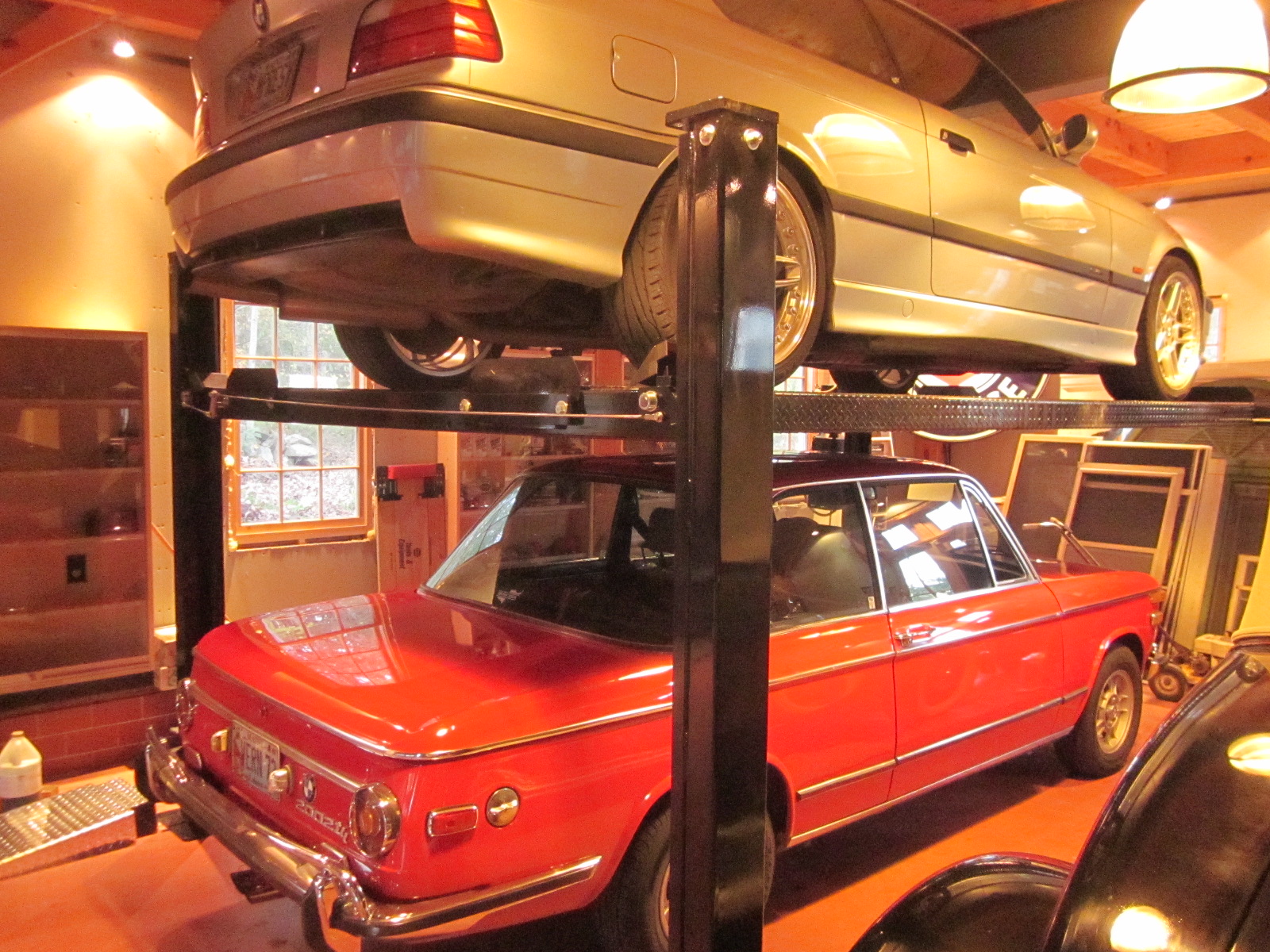

In 2006 & 2007 we built our 24 x 48 with a 24 x 24 ell garage, 1,750 square feet on the 1st floor.
Recommend:
6 inches of underfloor styrofoam insulation

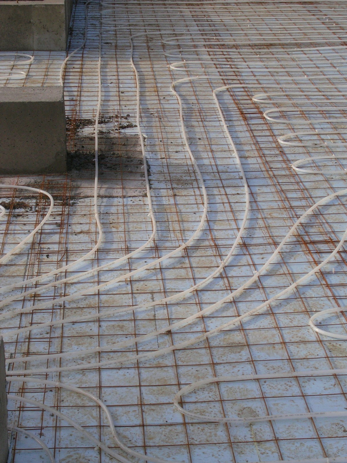

Radiant floor heat tied to 6 inch steel 6 x 8 sheets.
Dyed & dually reinforced floating slab
Metal roof
Wish I had plumbed a hose inside.

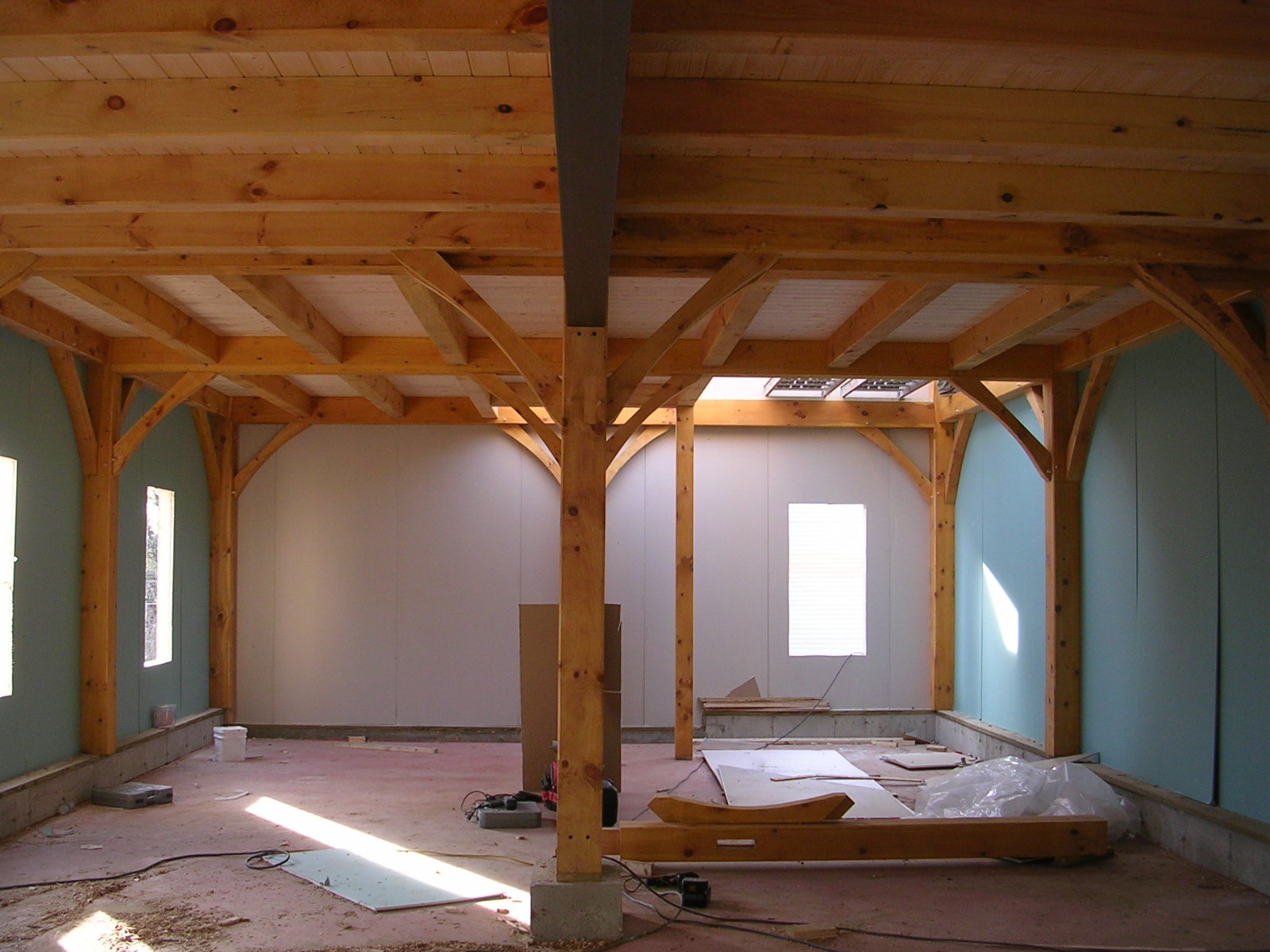

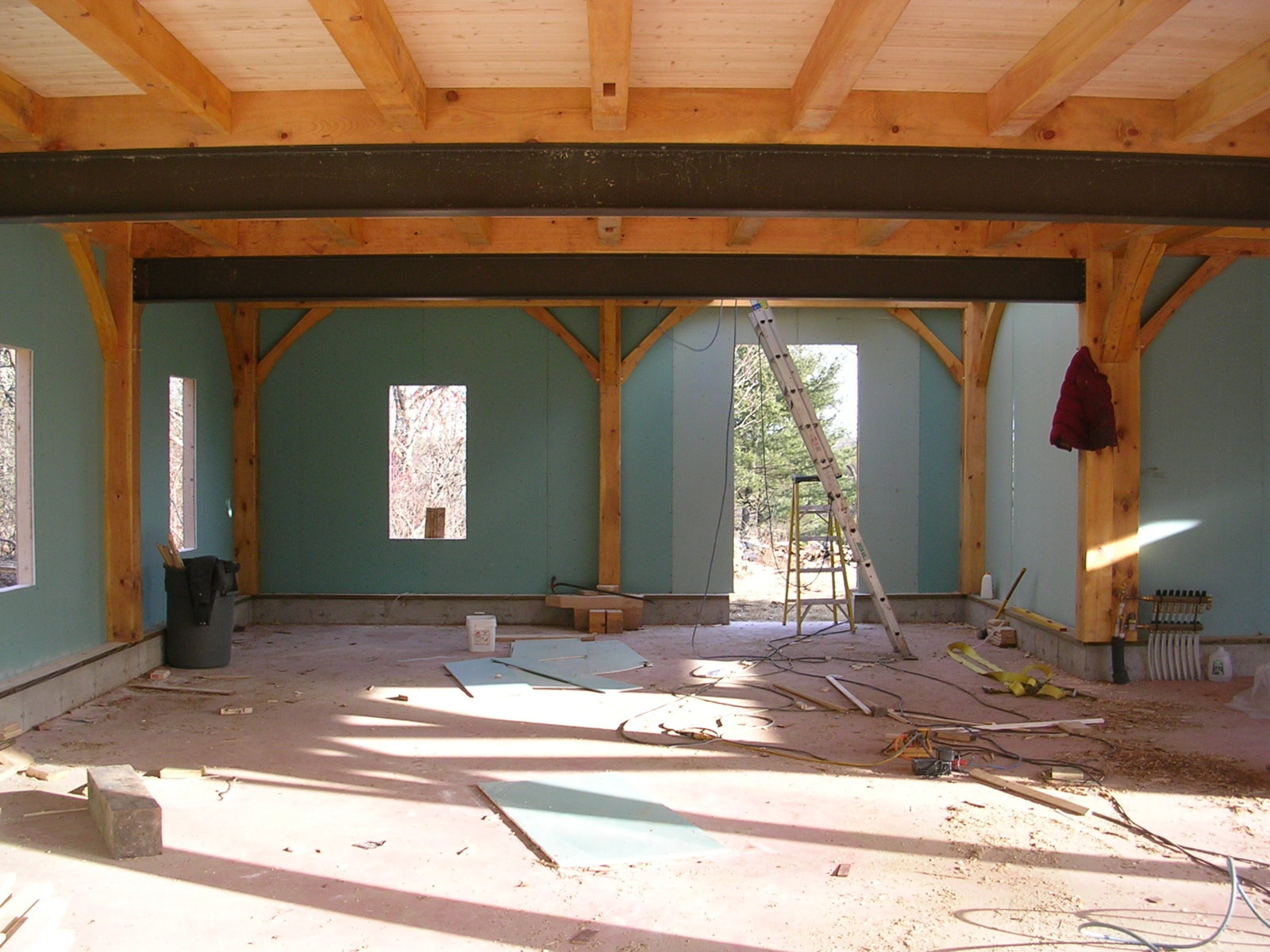

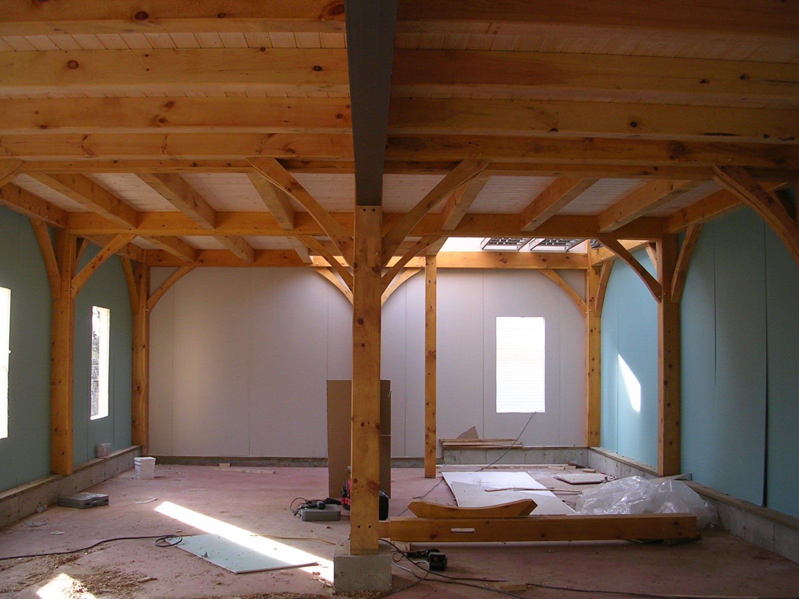

Consider a Timber Frame with Super Insulated Panels or SIPs. The overall cost is similar to stick building.

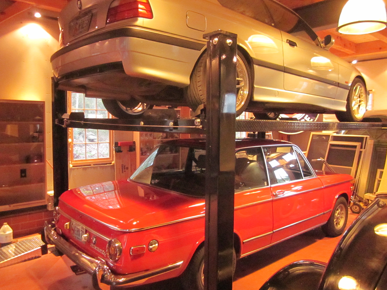

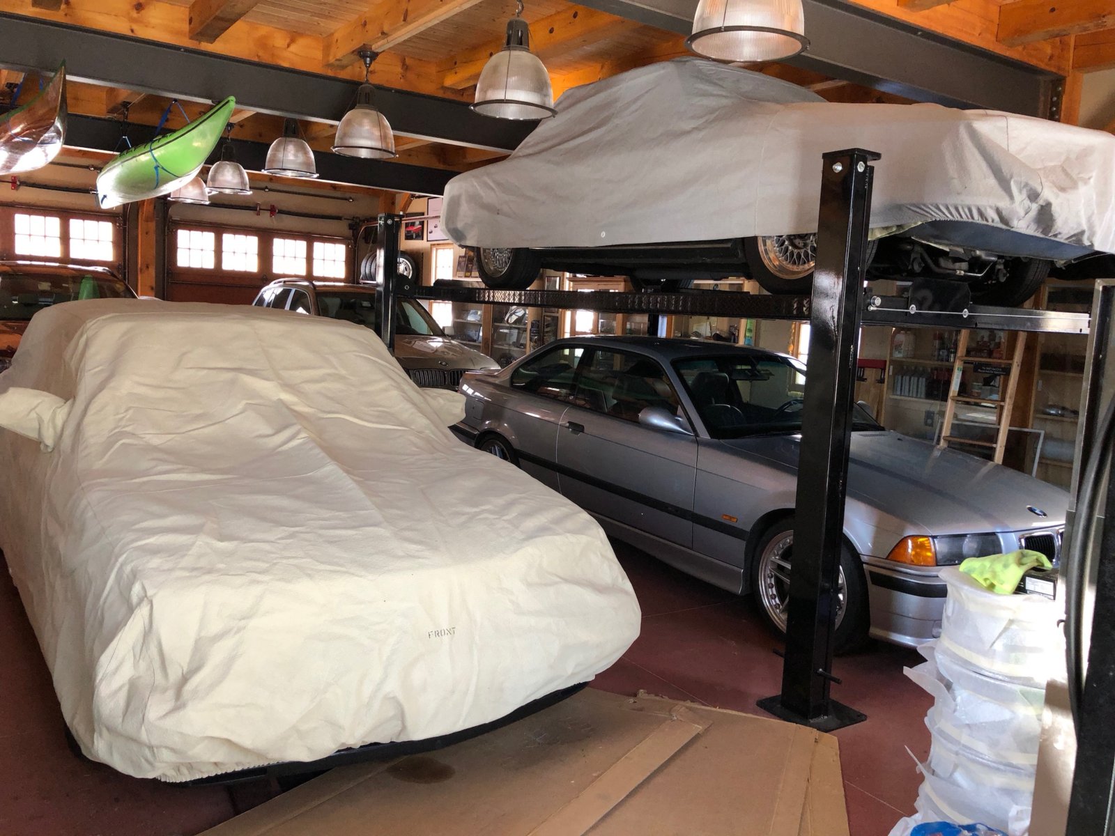

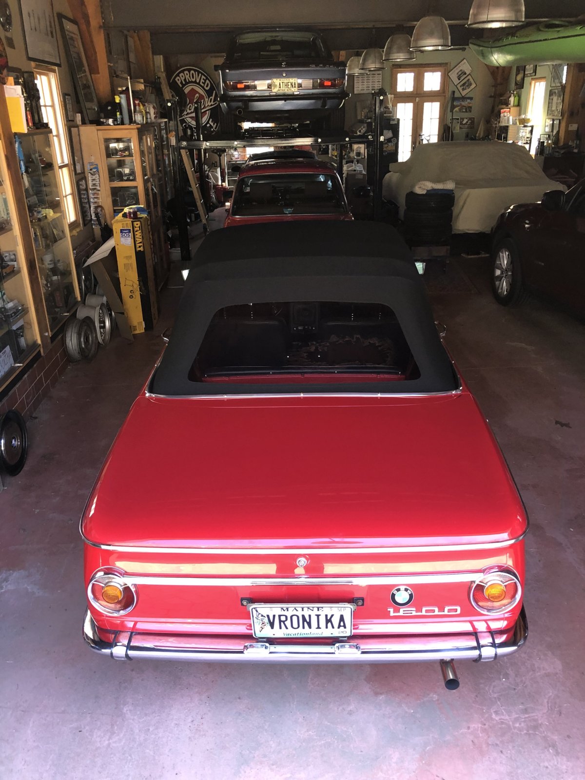

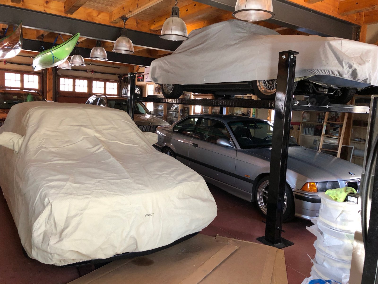

Room for 7 cars with 1 lift, 8 cars with 2 lifts (2nd on back order currently)

One day, I'd like to live in a house with radiant floor heat. Now that is a shop!! With those steel beams a nice rolling overhead hoist would be nice for lifting big stuff on tables or carts. I have one I bought used that can handle 1000 pounds.
Recommend:
Metal roof

Just beautiful, Andrew! I love seeing pics of your garage. The wood and steel beams are incredible together. I fear the only thing we'll have in common is the same mitre saw stand and a coupe. If we ever get out of this covid mess, though, I'd happily come spend the night in your shop!

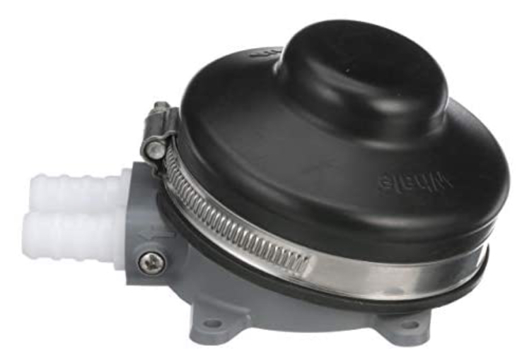

This is the kind of thing they use at portable/mobile wash-up stations at Watkins Glen. If combined with gravity feed (tank up in the attic), it would serve my needs for fresh water in a workshop. Here in NE is need to add a heater element in the winter, but those are cheap.
This is the cleaner I currently use, and which should be ok to dump into the ground: Stoko Kresto 87045 Hand Cleaner
View attachment 103899:
That's the one I have. Really works well
