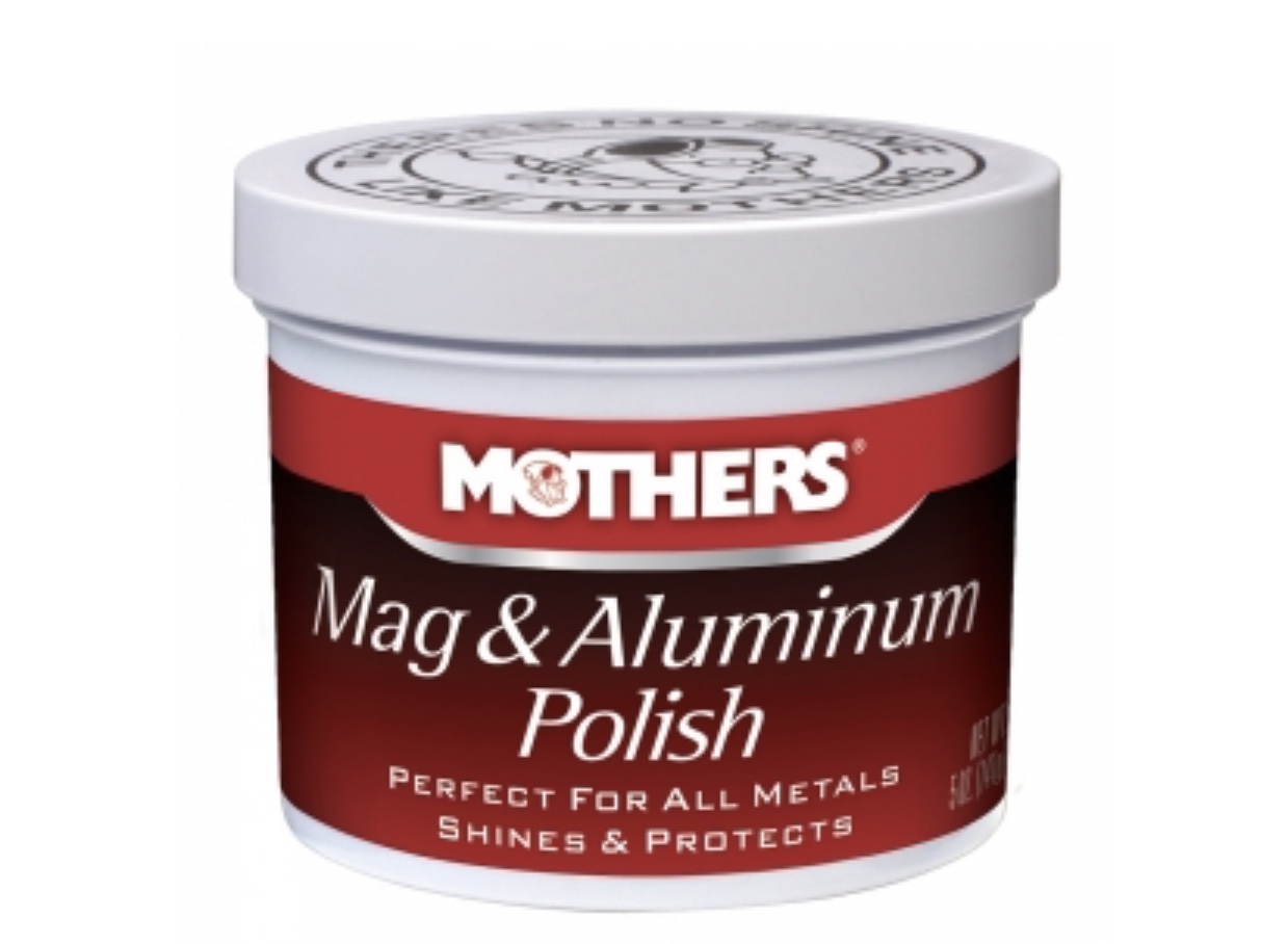

I will give you my 2 cents on aluminum, having had all the trim on the car done (at Speedway) and working on several motorcycles myself
I just bought this and gave it a go on my throttle tube. Surprisingly it actually does clean the alloy up but with a lot of effort. I attacked by hand with this paste, a cloth and a toothbrush for the indented areas. I will need a lot more time and elbow grease to finish it, but I think result should be ok. Not nearly as good as a professional approach, but the upside is I don’t need to remove parts off my engine.
(btw tied a few other metal polish products, all of which had no impact)
