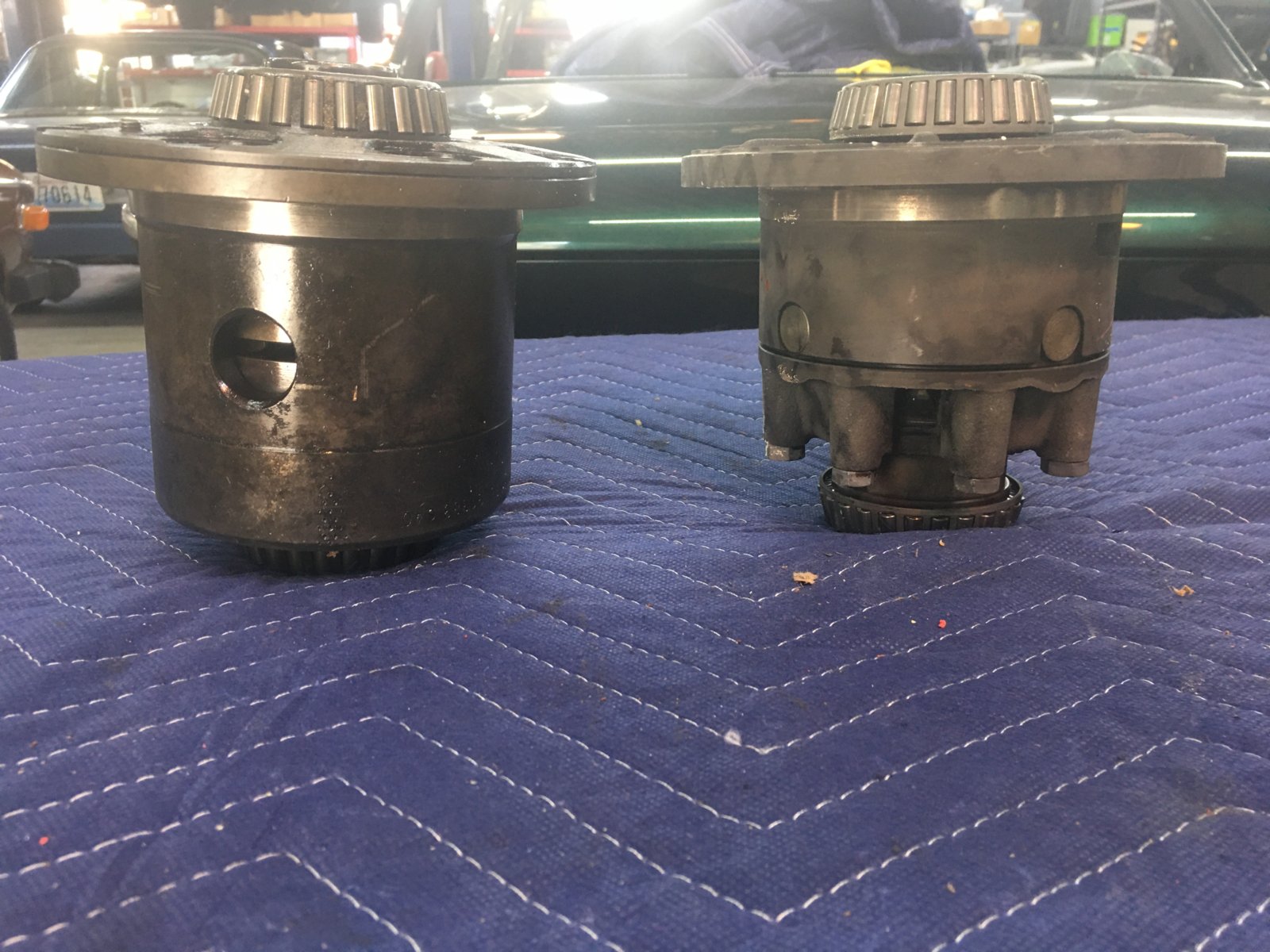

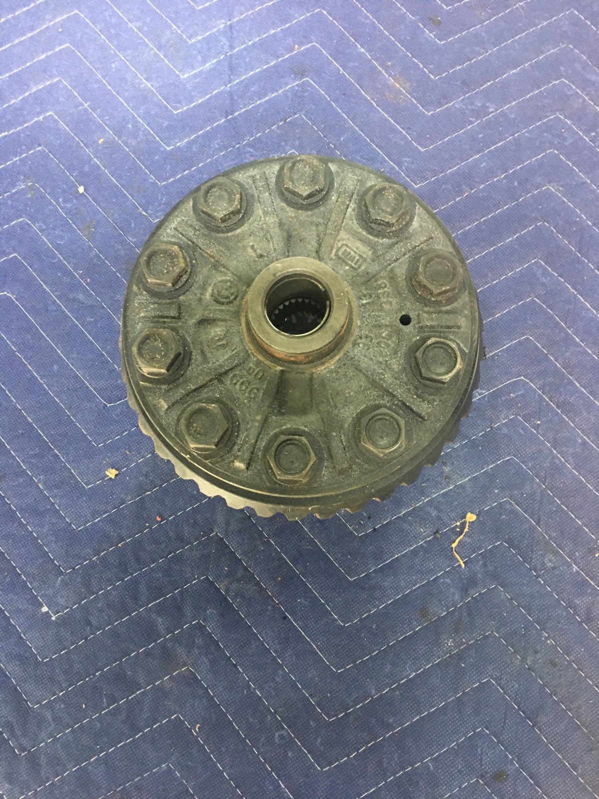

Pics for posterity…
This is Early LSD unit versus early open
8 bolts.

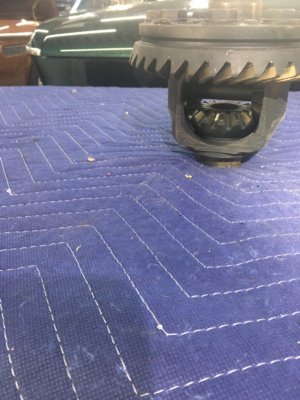

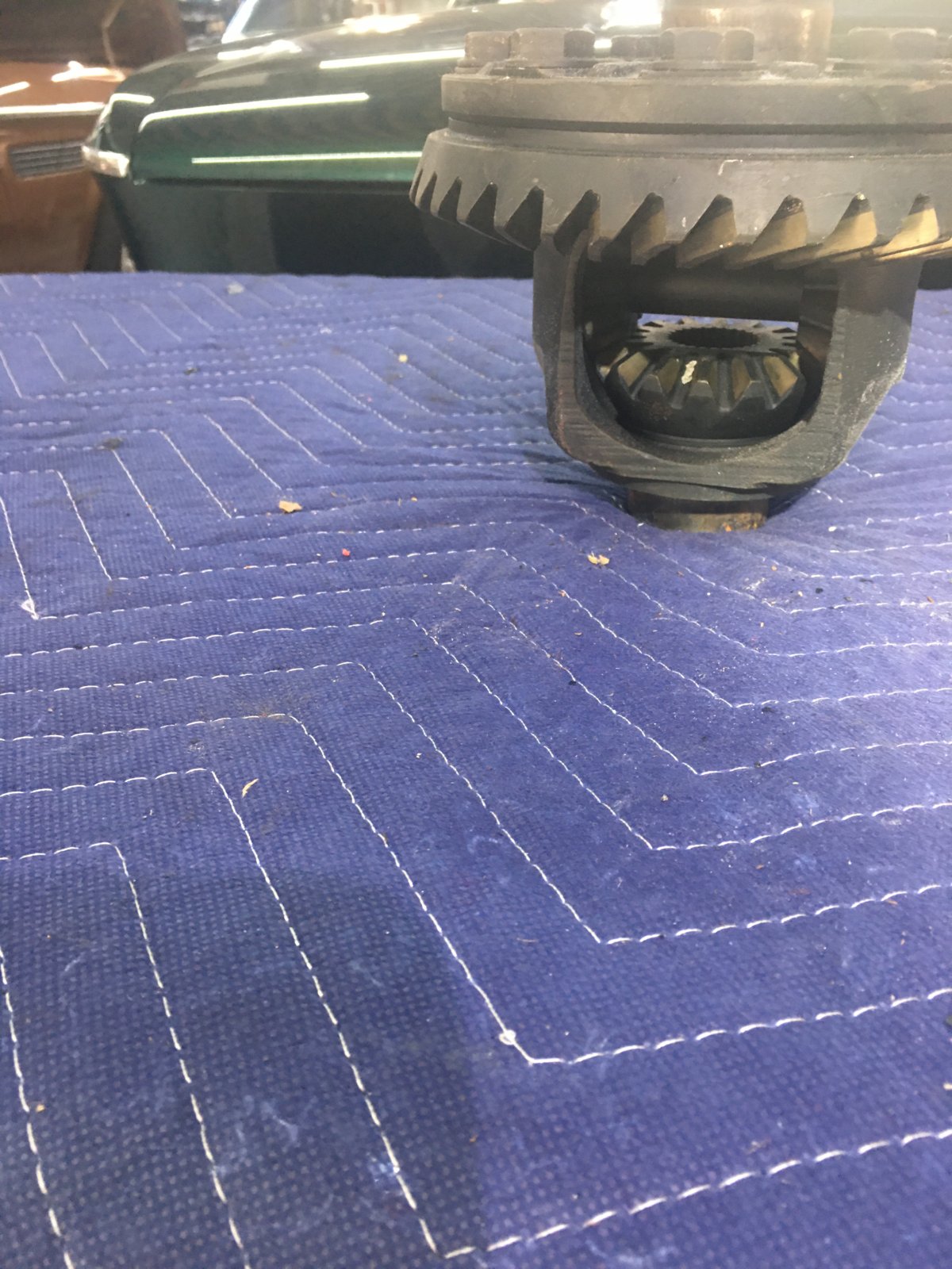

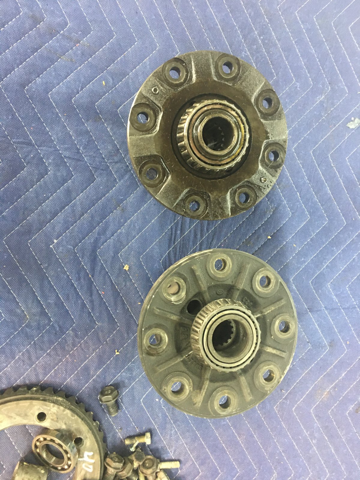

And now a later 10 bolt open unit
