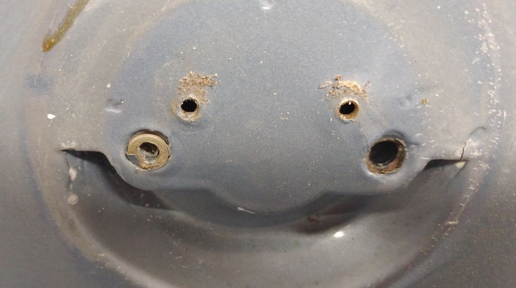

You can hog out the holes on the base, but the holes on the base line up to the wholes on the body.
Haven't checked as my car is at my other house, but the holes for the base to mount to the body are those countersunk holes, right? I'm hoping THOSE line up! I was just planning on hogging out the holes for the emblem pegs.

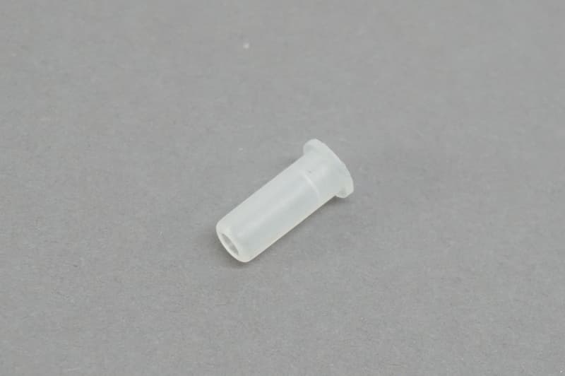

c-pillar-holes.jpg Curious if anyone has successfully found a suitable subsitute for the plastic inserts?
They're almost $7.00 EACH! Was thinking of using a drywall anchor perhaps?

Sorry to dig up an old thread, but did anyone figure out if there's just a bad batch of new emblems with the wrong spacing, or did they actually change the spacing at some point without changing the part number?
I ordered two from FCP euro. One was in a loose bag and fit perfectly and the other came in a more typical BMW parts box and the pins are absolutely too close together. I'd have to widen the holes in the bodywork to get it to fit. They've been really responsive, ordering a new one and doing a swap, but I am starting to suspect we're just out of luck. I'd refinish the old handpainted ones but a metal pin on each snapped off during removal.
