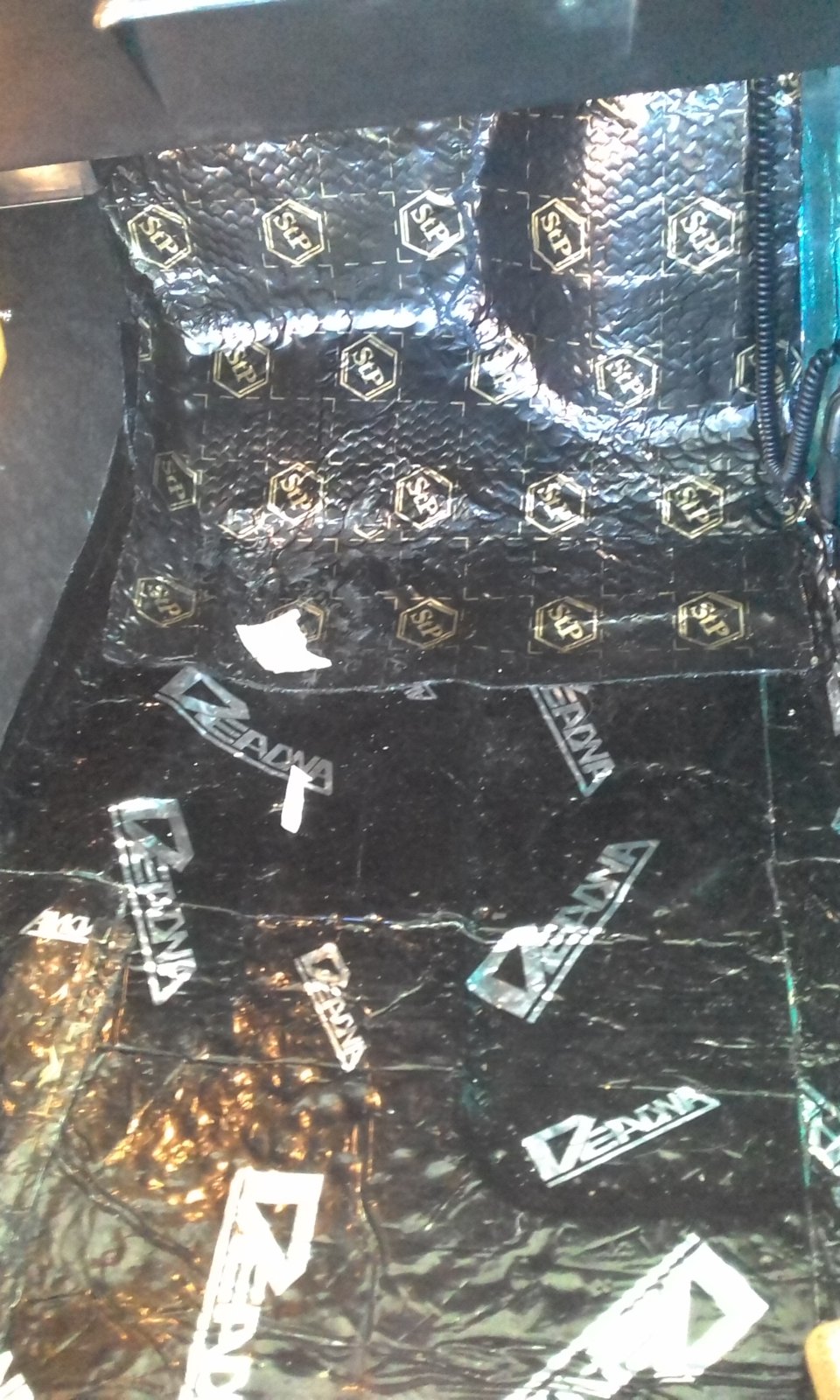

I just bought sound deadener for my winter project from second skin, my recollection is that I calculated about 32 square feet. that was for the adhesive tiles, spray will be more especially if you are doing front and rear cavities and the ceiling.

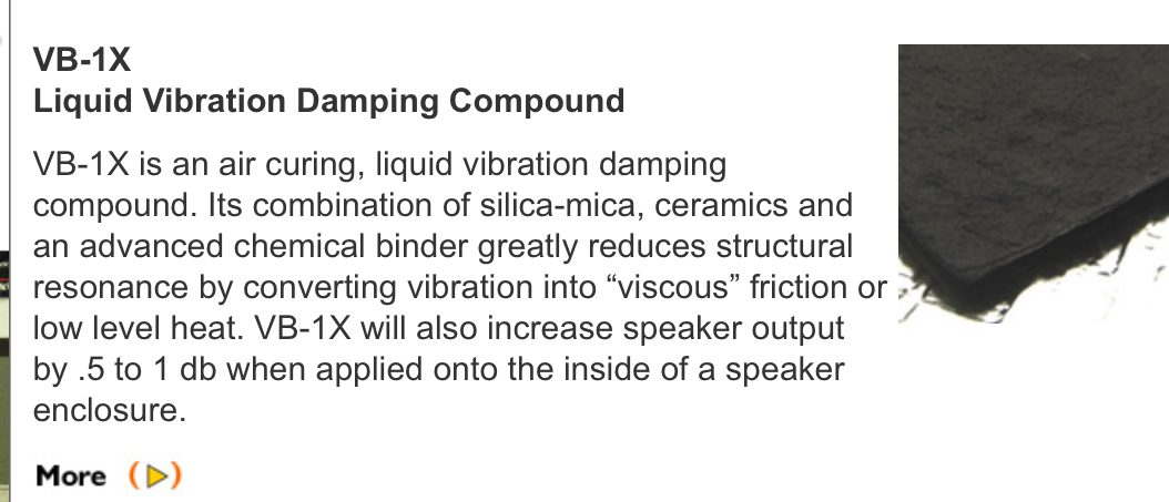

This?
i just bought gallons direct from the vendor over the phone. $256 for the product. Shipping was quite expensive to get to California ($110)

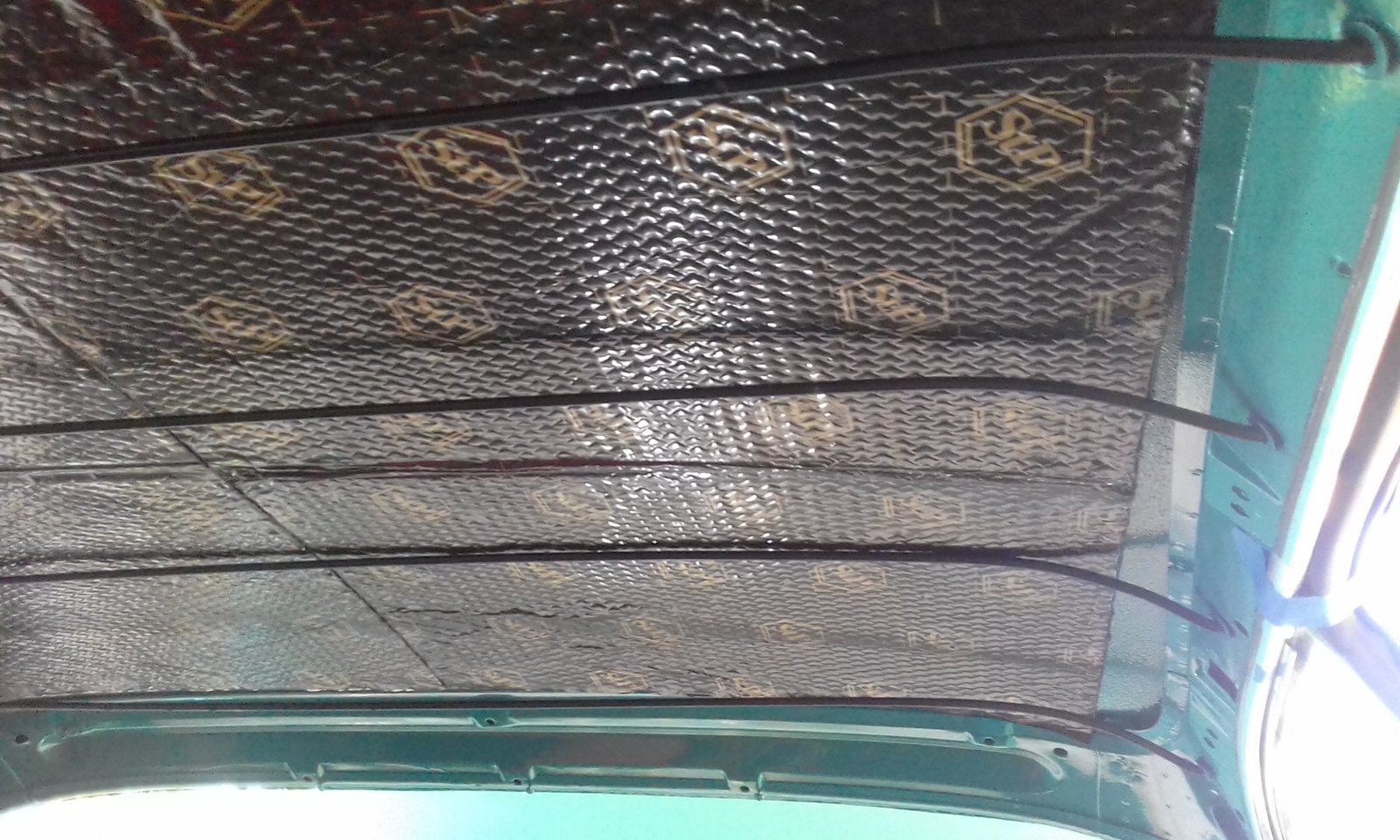

Thanks all. I used Lizard Skin heat shield, and Lizard Skin acoustic coating. But want to put Dynamat or similar in strategic areas since it is a bare metal shell right now.

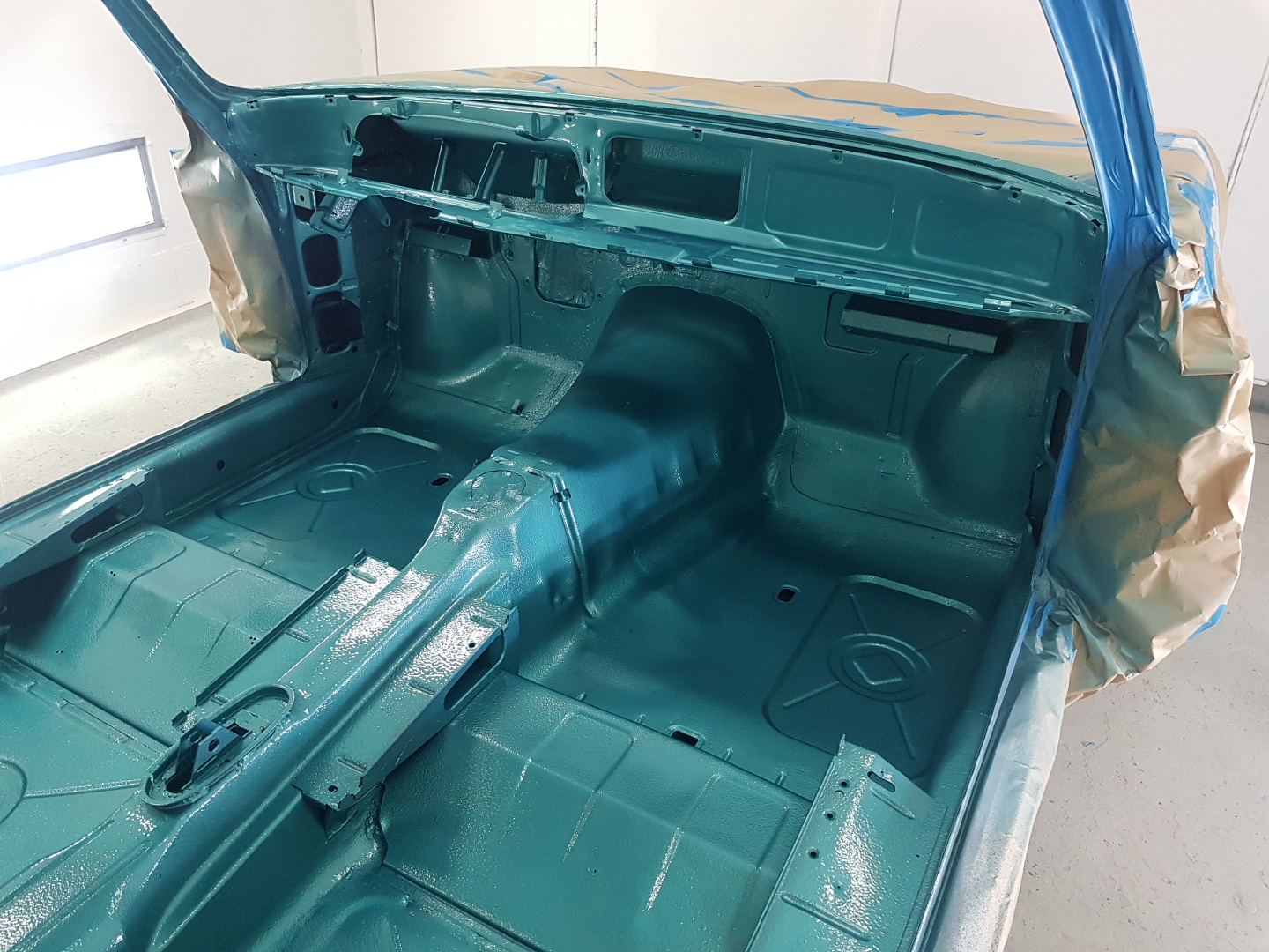

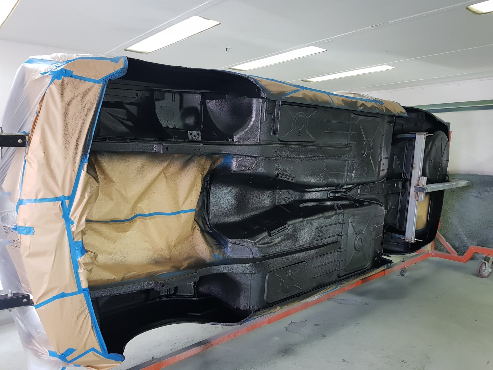

My car was Dominator coated inside (including roof) and underneath (including inside fenders as it has 3 properties Acoustic/anti corrosion/wear protection (it's as hard as.) You can tint it any colour you like. See Pics I then used Dyna Mat internally floors/firewall/inside doors/and special acoustic dyna mat in the roof. I then placed felt over the dyna mat (on the floor) and carpet over that. I have absolutely no road noise at all (can't even hear tire noise) and no firewall heat what so ever. Very happy with the set up.

This looks nice. Good job Mike.
I used a similar product called Lizard Skin.
Used in many hot rods in place of matting type materials.
There are two products.
One for heat abatement and another for sound.
You can apply one over the other.
Actual build up is probably 4-5 mils thick and has a texture.
It's white so your painter can tint it any color you like. Mine is blue like my car.
You can do the roof as well.
Seems to work well once I got all the air noise eliminated in my coupe.
Was not cheap.
Product cost was over $300 plus cost for painter to spray. Cheap though compared to Dynamat and all the labor it takes to install.
I used this based on many good reports all over the web.
