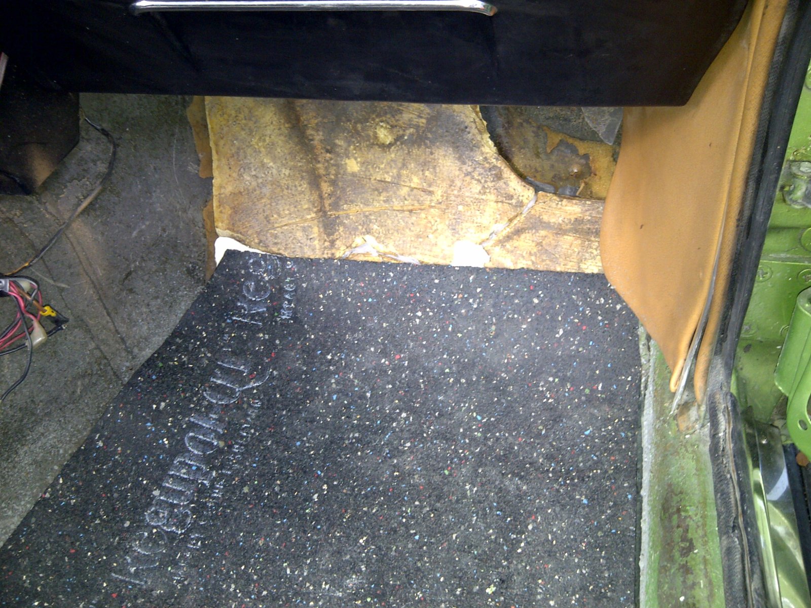

When I replaced my carpet I wasn't overly concerned with the sound deadening (I wanted to hear my triple Weber's at full song) but I did want to fill the recess in the floor pans left from the original material that I removed for both heat insulation from the exhaust and to level the surface for the new carpet. I used 2 layers of the rubber flooring material used in athletic training rooms.

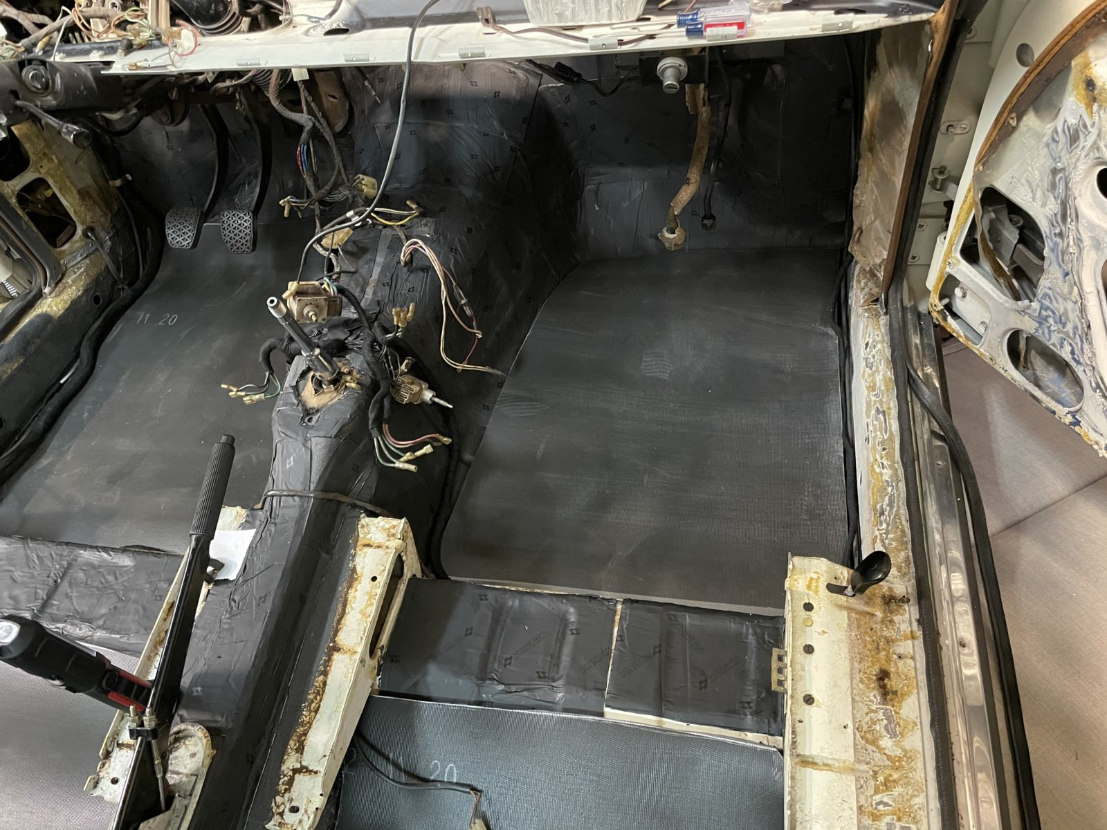

I have installed a spray/roll on heat shield, then dampening mats on the floor, and rear wheel arches and inside the doors. After that I have a dampening foam under the carpet (picture below). All of those products are from a company called "second skin audio."
