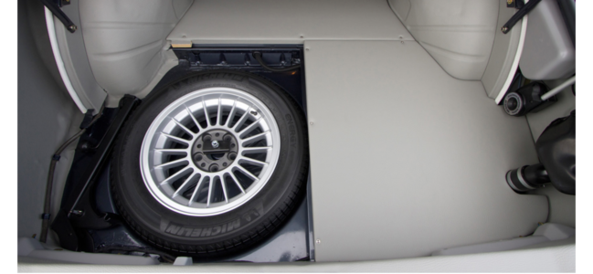

OCCoupe
1,943
1,299
Monterey, California

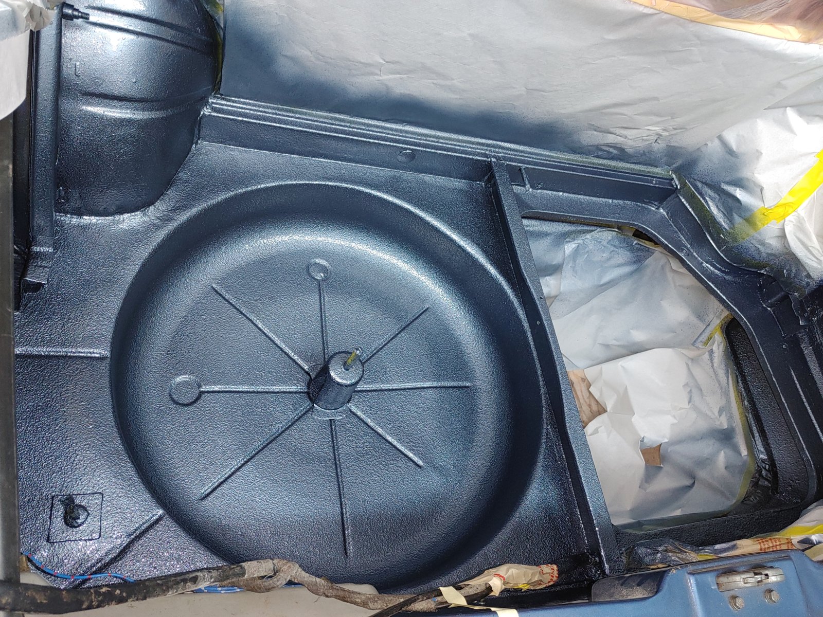

bluecoupe30!
2,160
1,314
You can put a spare wheel and tire in there? I thought this was the place for contraband when coming/going over the border. Otherwise, in case of a puncture, just call Hagerty for a flat deck trip home. ;) Just added a new spare wheel well floor :
