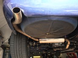

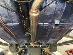

I am quite pleased with the results. I wanted SS but with a bigger bore so it was less restricted. I found people to make and fit for £450. This was a through a mutual friend so might have been good pricing, but still, great work for a fraction of the costs elsewhere. Guaranteed for life.
Finally - someone who did not add a few percentages to the price when they know you're restoring an E9.
They also think they can produce steel headers/manifolds but need a car there to ensure they fit and match up to the exhaust ports. I am tempted.

How does it sound?
Does the guy want to make a run of them?
Group purchase anyone?

That is a great price. It looks like it's all mandrel bent tubing. I would consider participation in a group buy as well. Like Stan I have Stahl headers and don't need a downtube.
It sounds quite nice. It does make the car sound like a performance car. I don't know whether shipping and duty might make a group buy expensive unless people are in Europe. I am happy to ask the people. They are called Cybox and based in Bromborough in NW England.

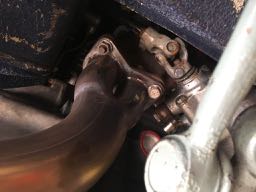

its tight but just possible, only when cold though. Headers are ceramic coated inside and out but still v.hot

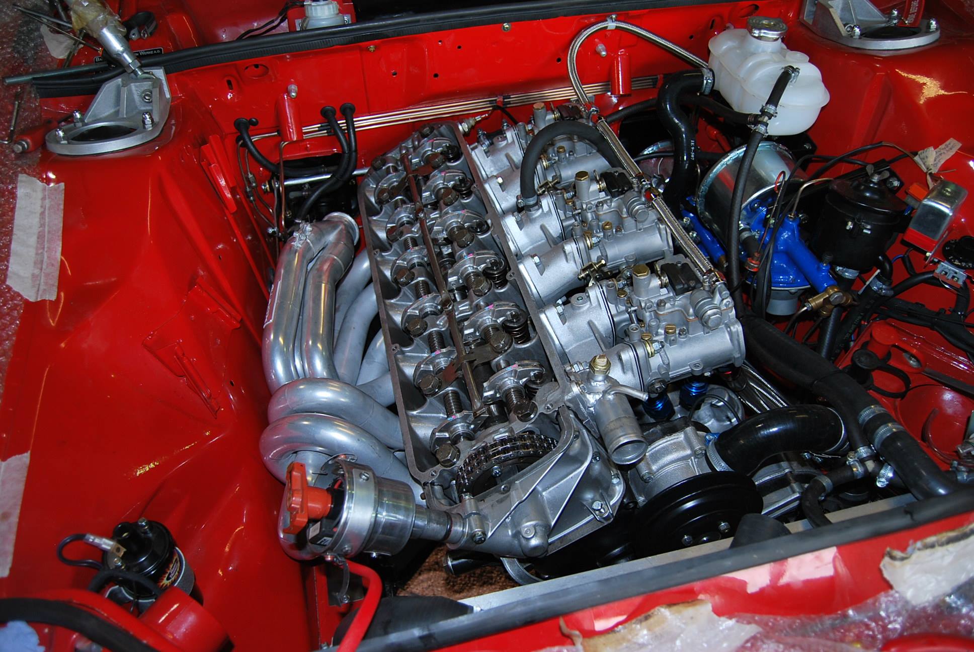

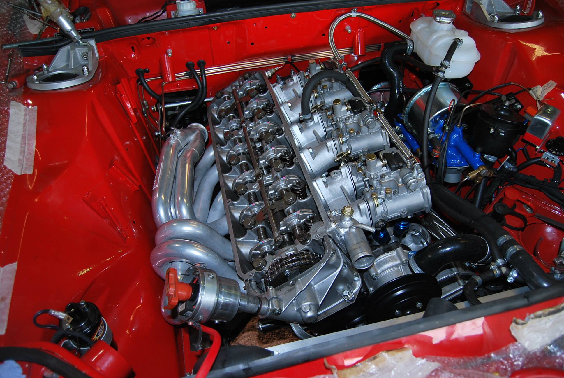

Hi Rek, these are my headers on my RHD CSL, they are this way to keep equal lengths on each tube and to clear the RHD power steering box, connected to a 70mm stainless exhaust
Mark
