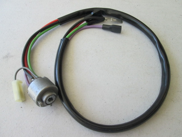

Your key and the mechanical tumbler insert into this switch which has five wires coming from it. It is held to the mechanical switch by a tiny set screw which needs a jewelers screwdriver. You can see the tab where the set screw fits once inside the lock housing at bottom left of the metal housing in this pic. Jiggle the wires, see if it is loose. If it isn’t making contact with the mechanical switch the key will do nothing. The tab on the mechanical switch wears out the female receiver inside the electrical switch or it has backed away from the key switch.

sfdon
8,264
4,618
sfbay area
The set screw is on the outside, not the inside
Loosening the set screw releases the electrical switch.
#7 in the pic
