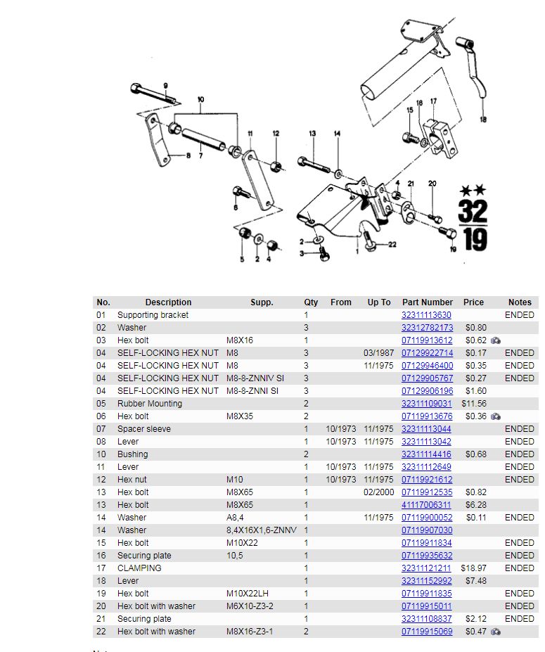

wanted to ask about telescopic steering column. I know that this type was available in E9 from 74'. Just wonder - is it desirable or is it worth of assembling in my 72'CSI? Or standard non-telescopic steering column in your opinion will be a better choice (have both of types)?

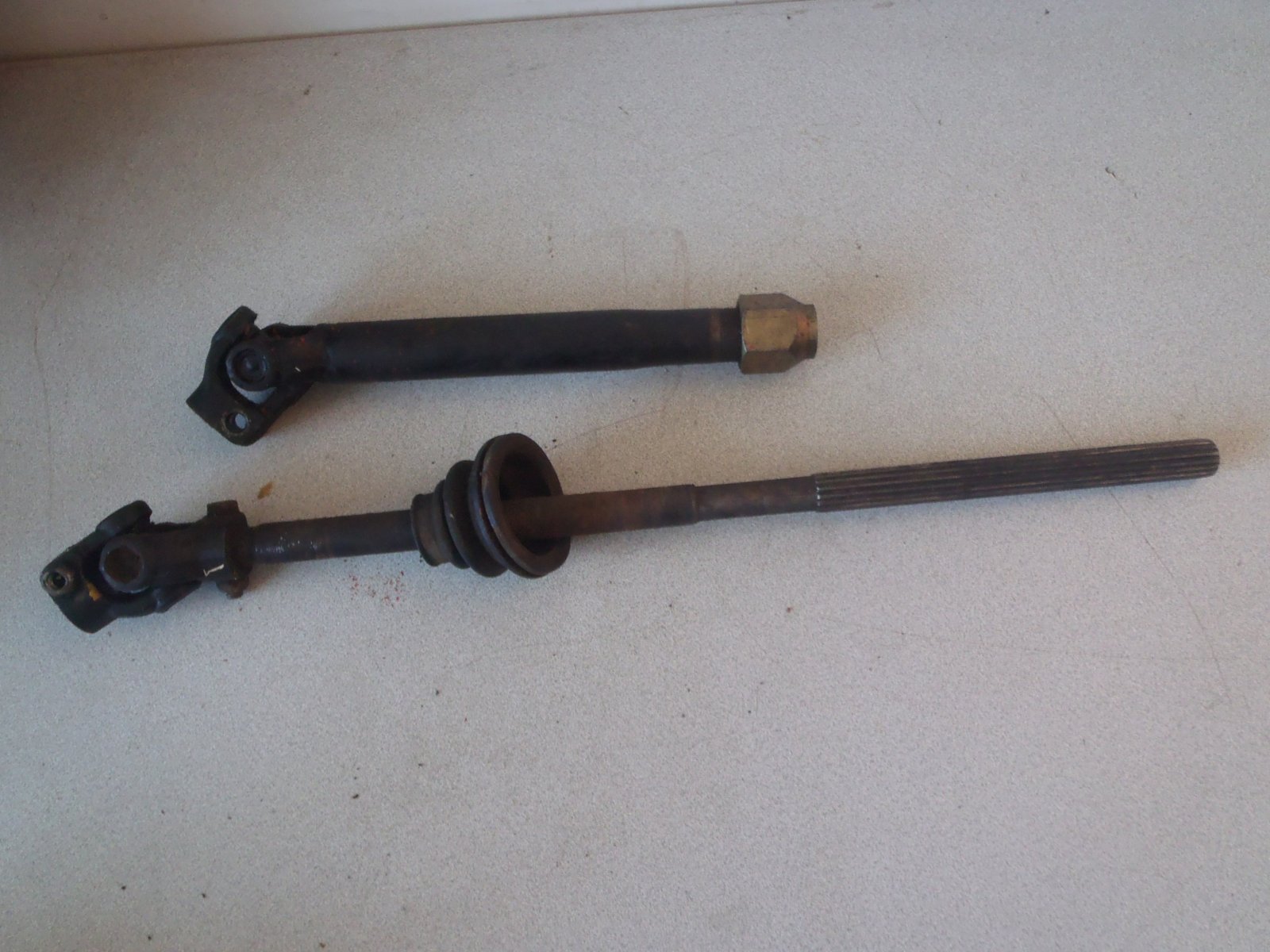

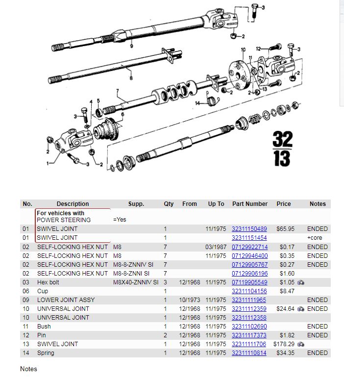

Also wanted to ask if anybody know the difference between standard steering columns showed on photo - one have wall another one don't (marked with red arrows)? Saw 3x E9 standard steering columns without the wall, so don't think it was just someones modification.
No big deal, have one on my 72 coupe ( retrofitted by PO). It only telescopes up and down, but there is no tilt feature. The column adjustment lock lever necessitates a different lower steering column cover.

one word of caution to anybody thinking about this - you need a different underdash panel for the telescoping column. it is different than the standard '73 and older panel. they are hard to find in good shape. it makes no difference if you use '74 turn signal switches or '73 and older ... the steering column cannot tell the difference. the PO put a telescoping column on my 2800cs and it has the old style switches ... and they work fine.
