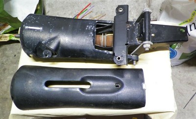

Some photo's of telescopic mechanism vs standard. With lower cover that Bert mentioned it will be complete set.
Here you can see how rod change the length depending on pulling back/forward of steering column.
And column main mount/pedal box

I don't know how it is exactly with US versions, but in EU standard pedal box booster mount is the same as in telescopic (so they are interchangeable).

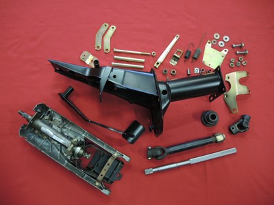

here is the adjustable steering part - from more views. you can see that the attachment to the body is very different than the fixed one in Wladek's 1st post of this thread.

Interesting, but Scott's mechanism looks slightly different than orignally posted. E.g. Scott's doesn't seem to have the "accordian" crash type of bracketry:
74-steering-2-jpg.84058
And Scott's doesn't seem to have a U-joint near the lever pivot.
