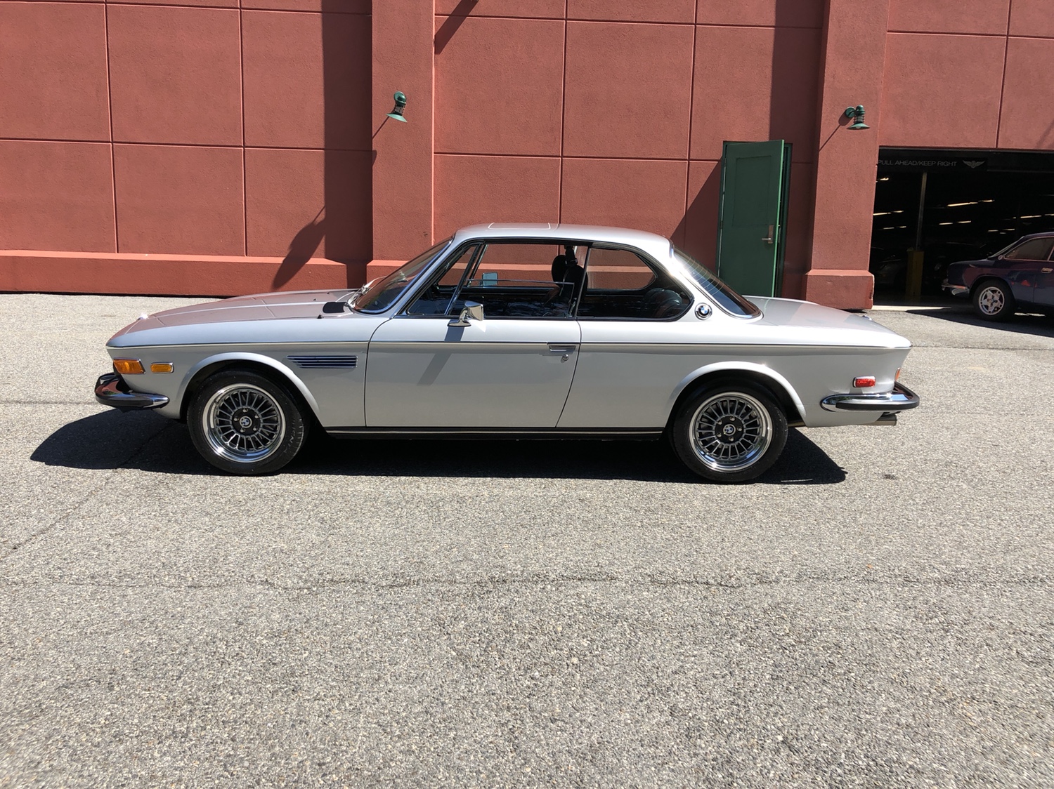

I replaced everything and went with Hardy Beck suspension. He was the original west coast Alpina tuner and created the valving spec for Bilstein. Car is fantastic and no rubbing -not too stiff which can be a detriment to these fragile chassis’
