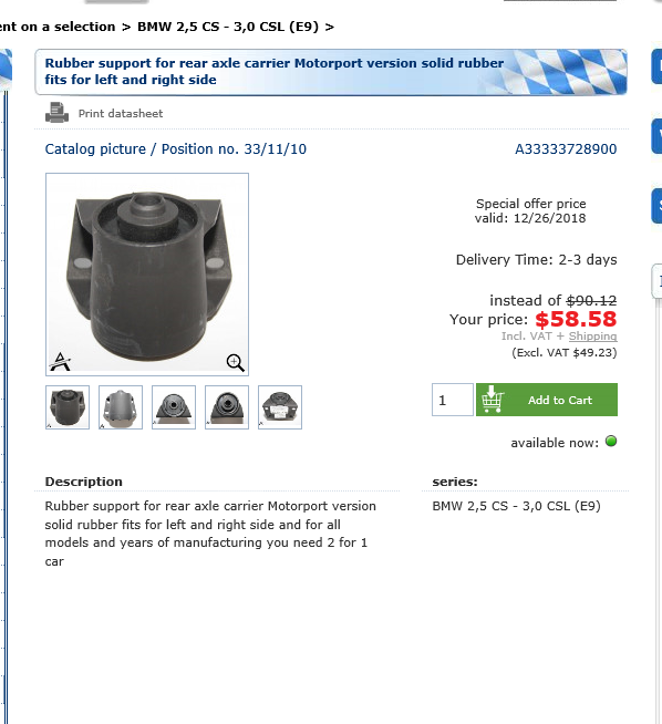

Any thoughts/experience on these subframe mounts? Been hand-wringing on what to purchase, and I'd hate to miss today's price.
Lots of wrestling to get those out/in. The main bolt is under the back seat and pressed in and quite difficult to free up. In the end, my old ones looked really good after 100K so it may not be worth it. You can stiffen them up a bit with poly inserts that are sold by Ireland Engineering.

Any thoughts/experience on these subframe mounts? Been hand-wringing on what to purchase, and I'd hate to miss today's price.View attachment 57383
I use them on my car, have only driven it one summer so can't speak about the quality, but they have done their work so far.

728900 units are solid.
Poly inserts have no where to go.
