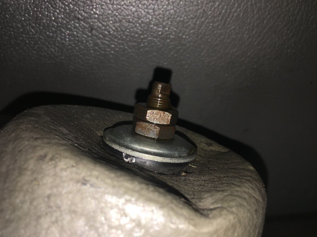

The shocks look like they were sprayed with the tar based undercoating and it's rubbing on it making it look shiny and wet...maybe?

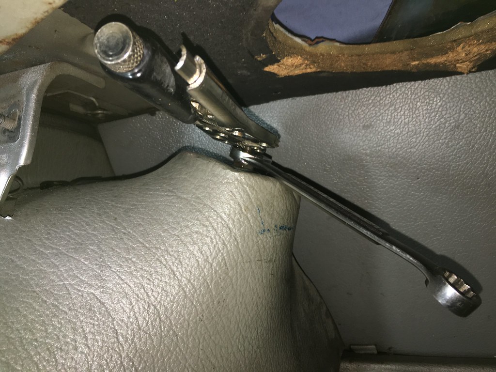

Finally going after the passenger side shock:
Vice grip on the shaft and wrench on the nut:
That's my default on this car, but it is just gooey enough (almost like burned grease) at the top of the shock cover, that I'm leaning toward a leak. The coating appears to have been sprayed with a fire hose. It's been a pain on mechanical & aluminum pieces it shouldn't be on, but I think it saved the car.
Bilsteins have a hex key hole in top of shaft to prevent turning so not sure you need to use the vice grips? Unless those aren't Bilsteins...
Actually those are bilsteins. They had a slot in the shaft. Anyway despite the ability to rebuild them I pitched them.
My recommendation is to use two skinny 17mm wrenches. Having a hex key hole at the top would be huge help!
Mine looks like your picture. Like my fitness, I'd forgotten my bike tools--would need to check if I have multiples, but I have narrow 17mm spanner ratchet.
Cool, now make sure you have two! I didn’t have one...
I use one of those ratcheting spanners for the nuts along with the hex key - don't have to take the wrench on and off after each small turn while my spine slowly locks up from working in that position - ba da bing!
