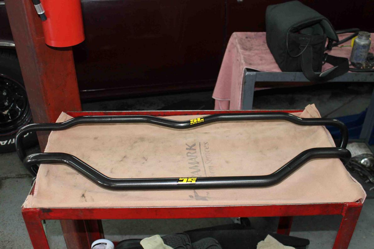

Saturday morning with an empty shop was great for sway bar install. Time to go over all the input from others (all printed beforehand) and it was very useful. Front and rear are installed, handling has improved a lot, the impulse response feels like moving sideways instead of rolling, which is great.
Will measure roll with the iphone app probably tomorrow when I get a willing passenger to operate the iphone and camera.
Here are some pictures. Thanks for all the help.

^^^ A lot more attractive than the ugly electric lime green bars I got from La Jolla. F%$^ing lit up the underside of my car, felt like I should have had chromed coffee can mufflers sticking out the back.......They couldn't tell me why theie supplier had such bad taste in hardware color. Primed and painted they look OK, hope the paint lasts :mad:

After the black paint started to get some chips my ST sway bars were - lime green underneath. I try not to look at it.
Funny I like that color on the sway bars. It's like when a lady (or maybe less than a lady...) is wearing a garter belt. You get a glimpse of fun but not a statement.
Of course my ride could not be accused of being original.
Nice way to put it!

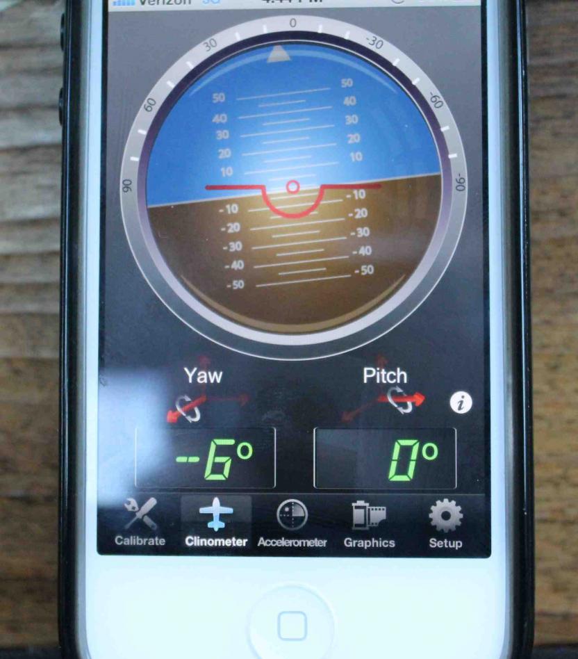

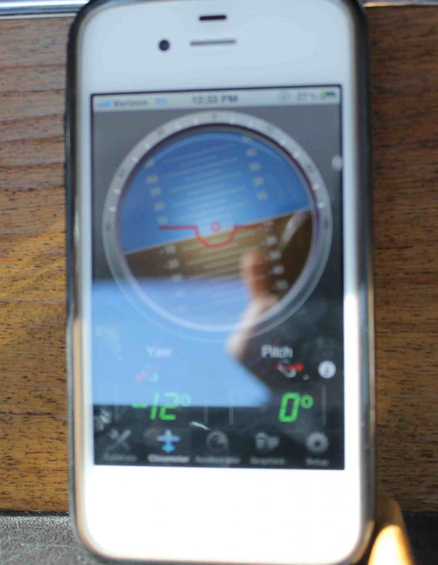

OK, project complete, time to close this thread with hard data. ST sway bars reduced body roll at highway speeds in half.
Went from 12 degrees at 75mph to 6 degrees, and from 17 degrees at 85mph to 8 degrees.
Instrumentation was crude, but intuitively confirmed by the feel of the car. Recommended upgrade for sure. Thanks for all the advise received here on options and installation.
Oh, the 1st and 2nd gear acceleration of Verona read a bit above 1/3 of g, which means it cannot go up vertically, bummer.
Here are the pictures:

Nice closure using objective measurement Arde! BTW: I have the CN bars/springs with Bilstein HDs and Alpinas on a 2800. The setup simply kills the stock setup on my CSL. I did not have the install hassles some described since they were installed at LJI.
that was good, real data !
the result is fabulous !
thanks
you know the funny thing, the app used was developed by a guy in spain...
arde, a question, do you think it will work in the ipad ? i have the version number2
i do not have an iphone
deQuincey according to the search engine the app also works on ipads as long as the OS is appropriate. It would be great to see that bigger screen mounted on your console...
