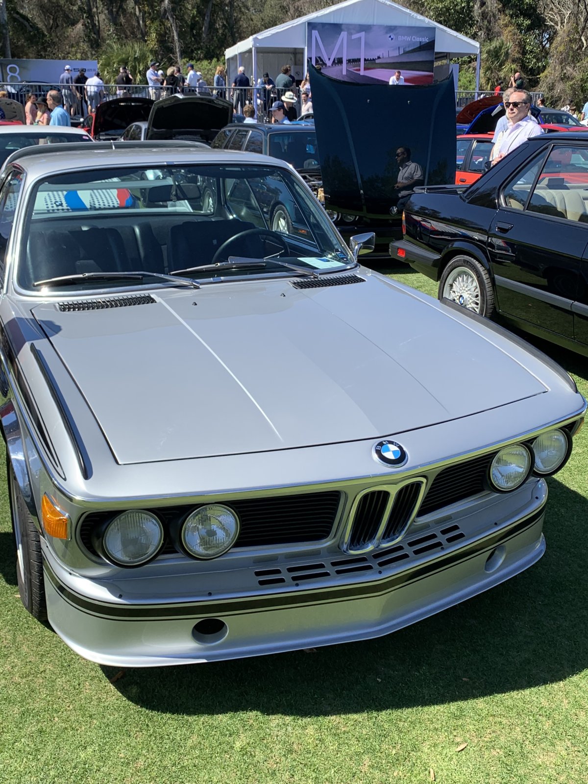

Met some wonderful e9 folks, and took a look at the car, but unfortunately, I will not be bidding on her.
tightbox
251
104
NorCal
That was Scott’s very pretty Polaris CSL (he also brought the M1 at the factory booth).
His wife drove it down, while he trailered the M1 - fabulous group of enthusiasts!

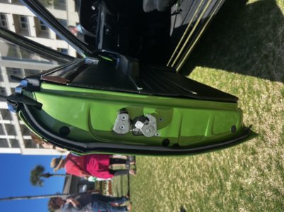

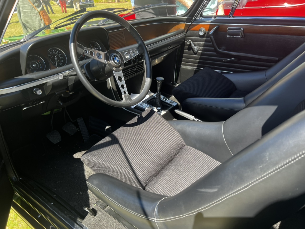

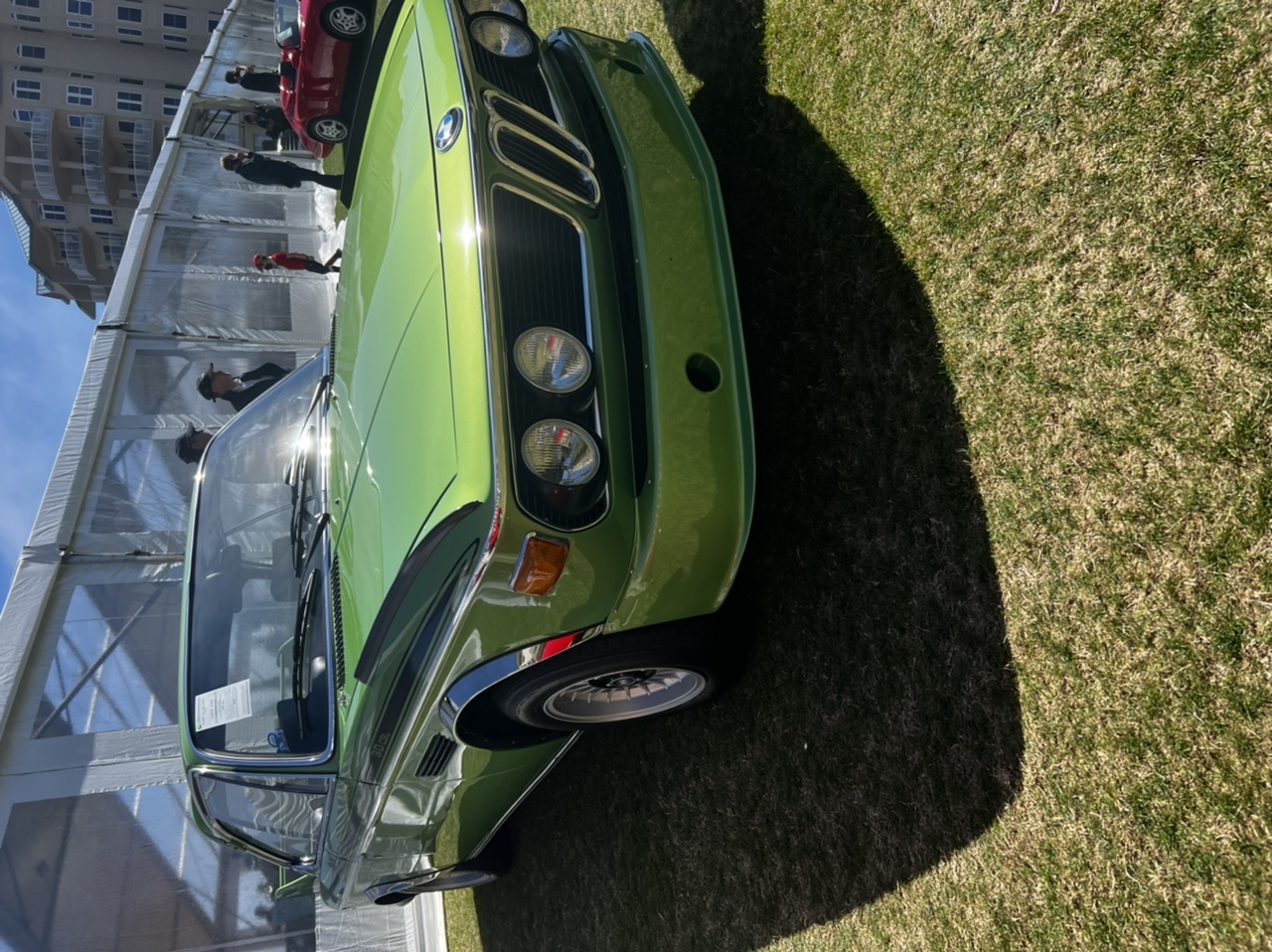

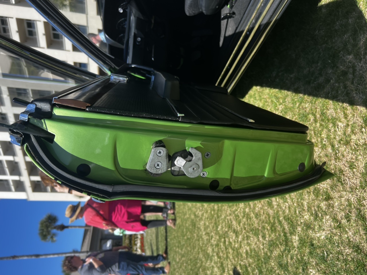

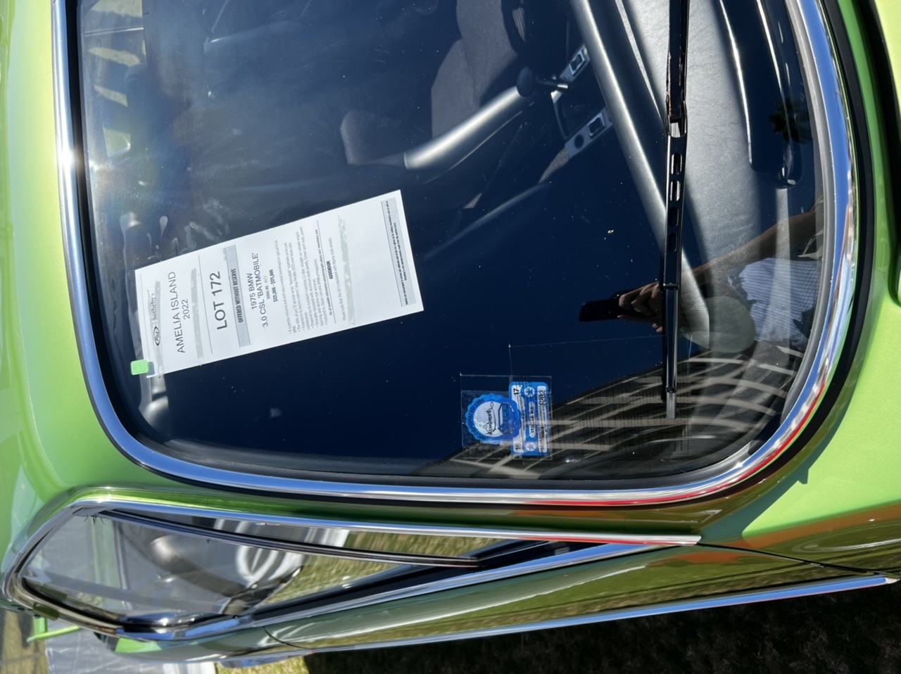

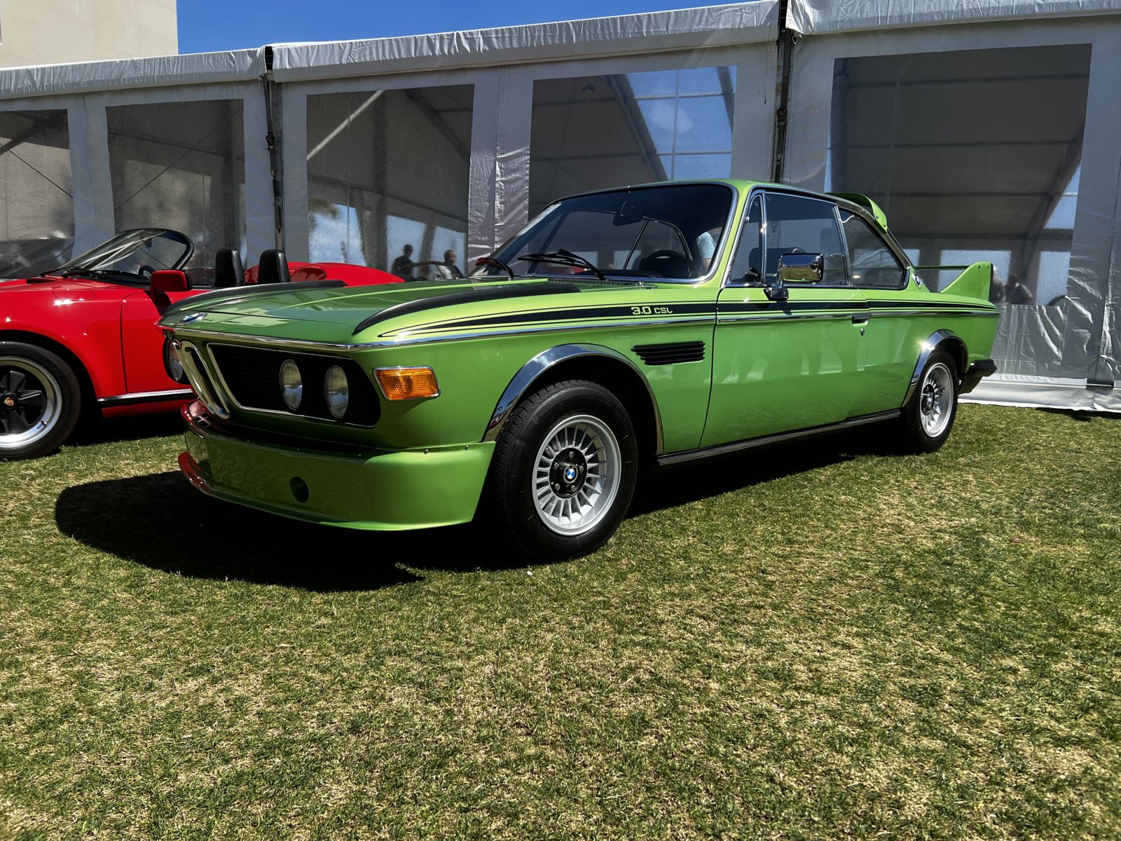

I wasn’t able to pop the hood before it went on the block, but Scott mentioned the fender welds were incorrect.
Here are some additional pictures I snapped - you can make your own judgement:

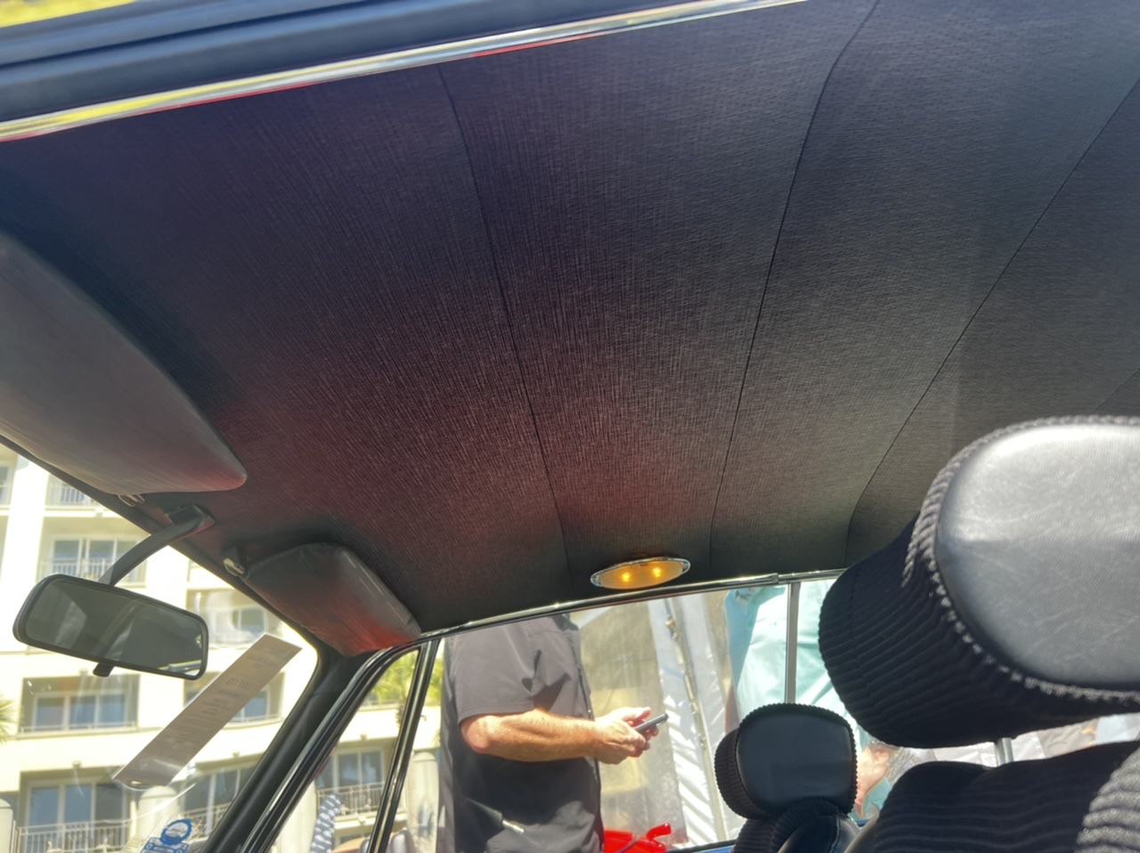

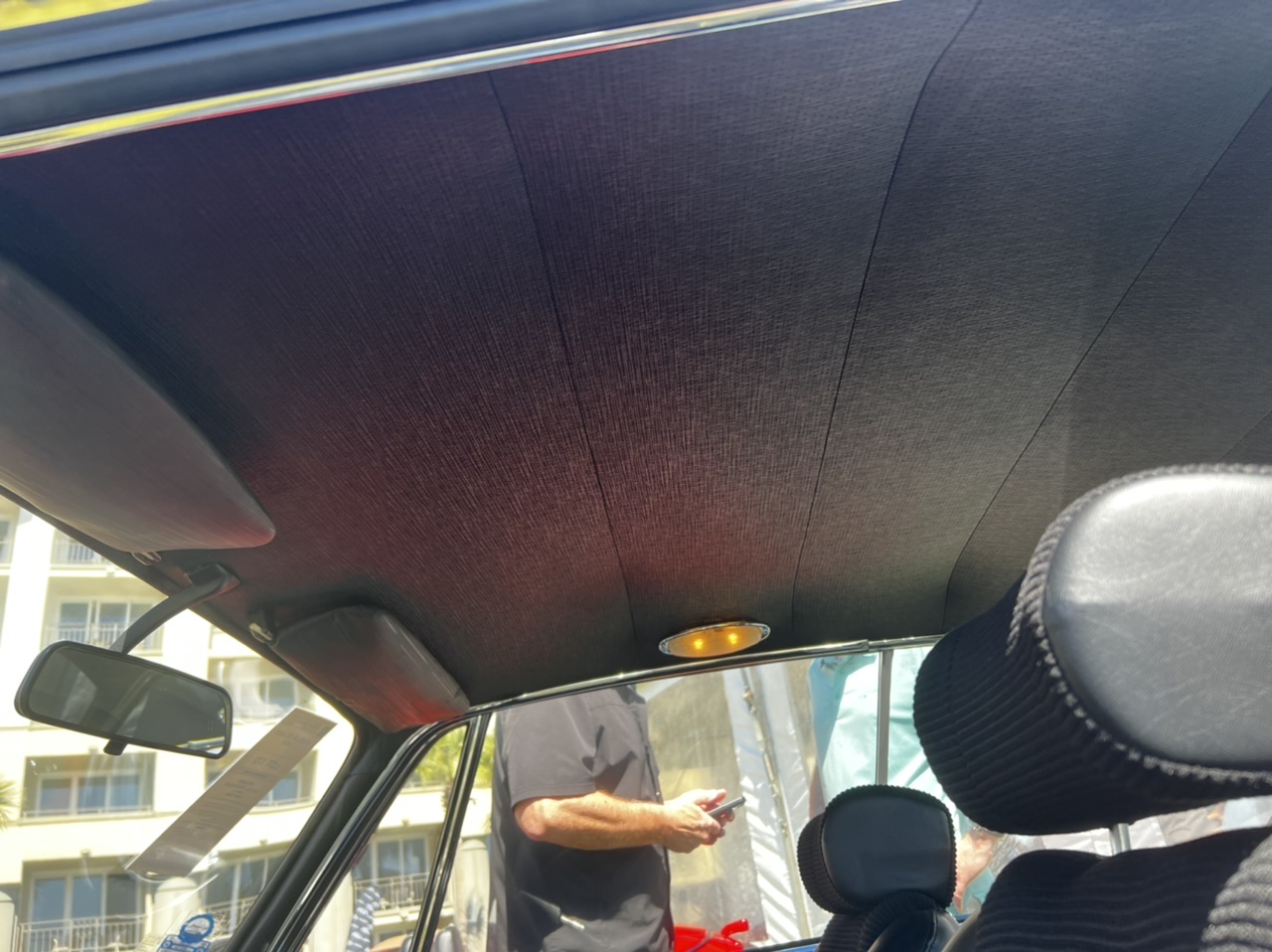

I had to miss Amelia this year due to other commitments. Tell us what you saw and what you didn't like. The inner fender welds were done wrong, and that is not at all easy to fix. What else did you see? The headliner looks like correct material to my eyes from the pic above. But totally weird ride height. Four bar grill. Tired dash wood, old tires I bet (not XWXs), less than crisp presentation overall with a resto that looks 20 years old. And no views from below in the auction listing. How about the rear wing setup?

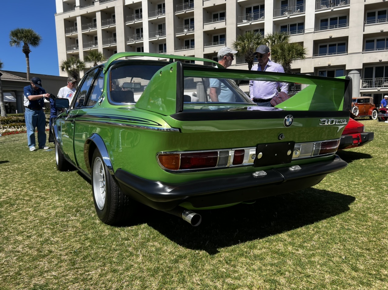

Sounds like Pete inspected it earlier in the UK.
I ran into Scott Hughes while admiring his CSL. He clued me in to the subpar fender welds on this car, and that really killed my enthusiasm before seeing it.
The paint was fairly well done, and may have been recent. Scott’s son-in-law (who has campaigned his Grp 2 e9) knew the local painter personally. He spoke highly of his work in general.

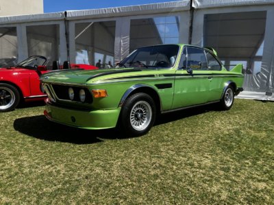

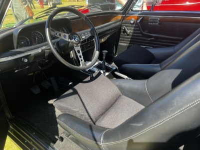

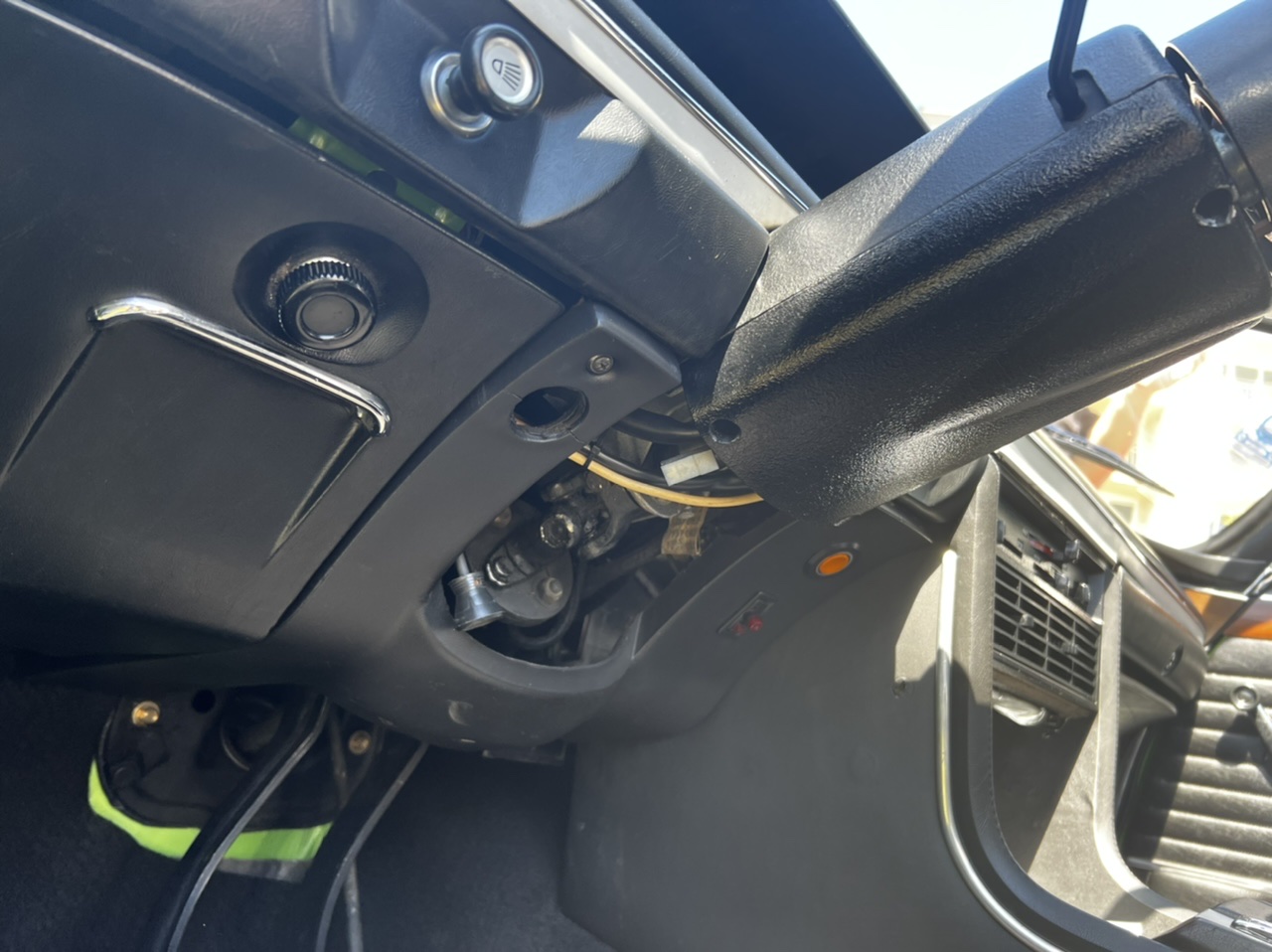

Here are some additional pics highlighting what else I saw (trying to be diplomatic here):

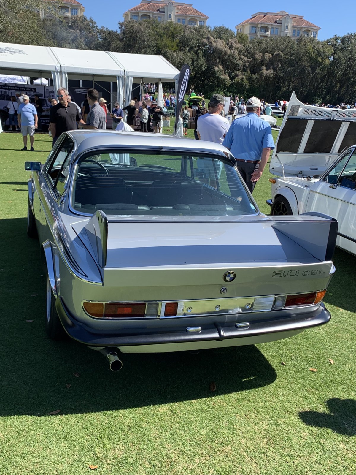

Trunk/spoiler and hood alignment. Color. Air dam. Wipers.
